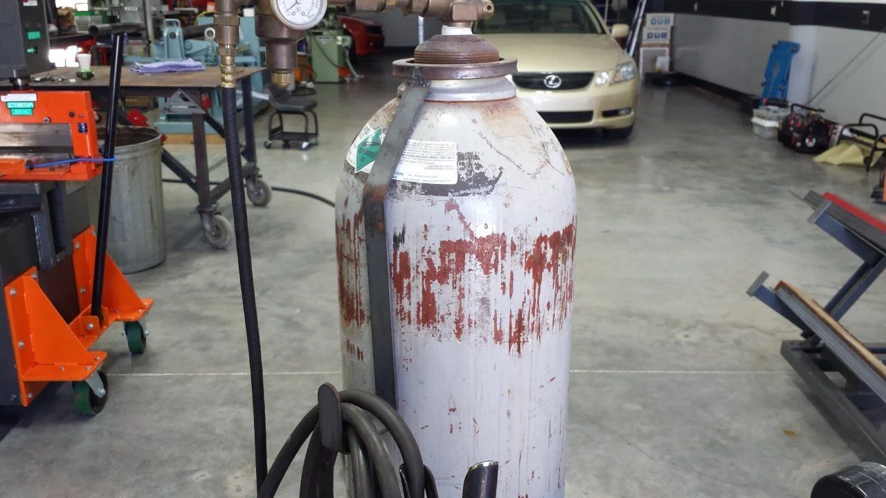

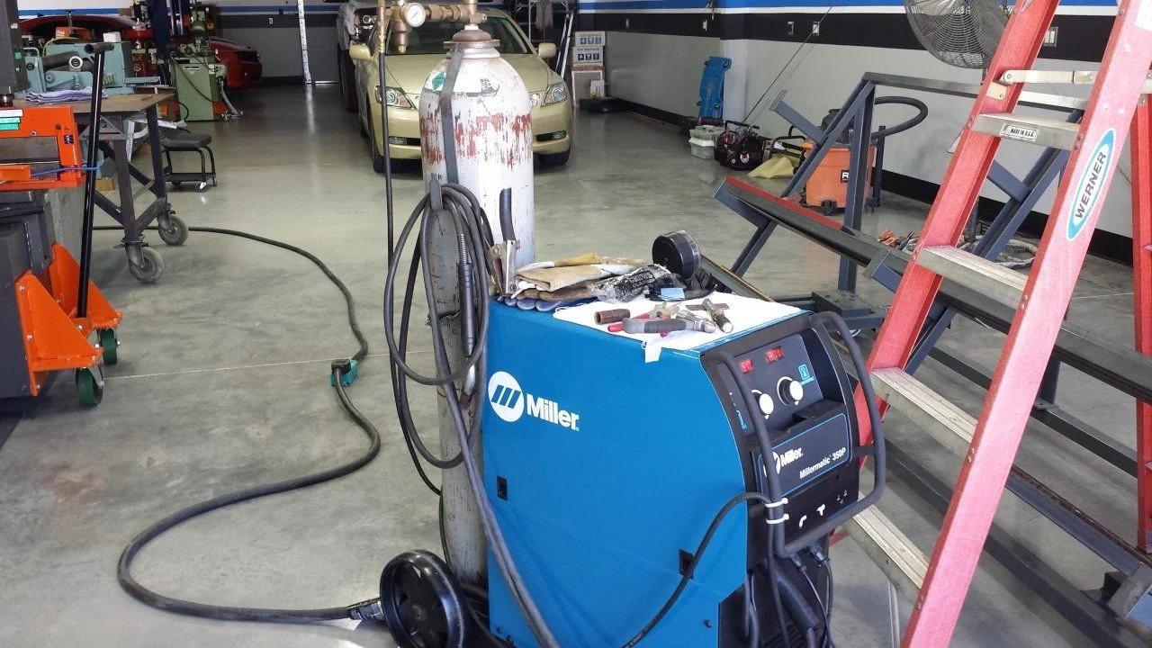

I made a hook that is welded to a ring that fits over the bottle to store my MIG cables. I have used similar on other machines over the years.View attachment 1054661View attachment 1054662
I use to make my GTAW rigs similar to this. 4" sch 10 for the bottle valve ring and then bent 1/2" SS tube for the hose reel with a kickstand to keep the hose off the bottle on the lower end. Would hold 50' of 1/2" argon/purge hose.
