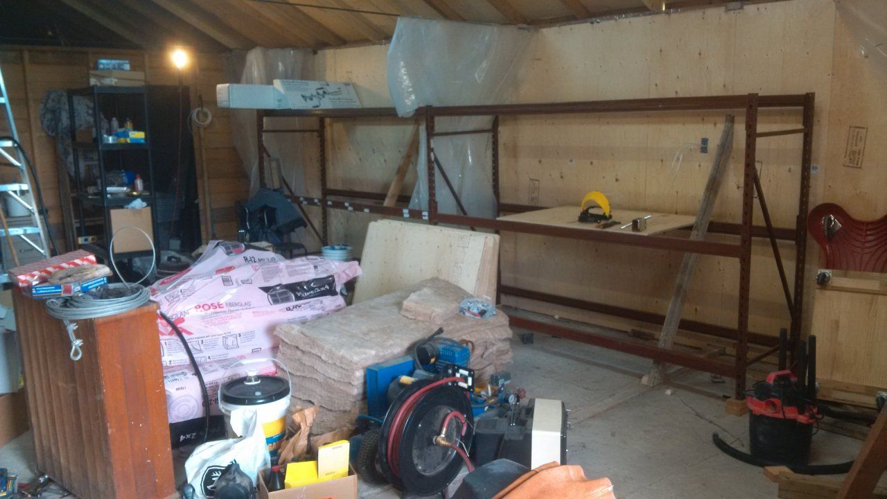

Working on my organization skills. It looking like there will be lots of free time this summer/fall, any cans of energy left over from the Troopy build? :p
(I'm anxious to get back at Spot, but things will go better with the shed gone through)
Excellent plan! Things always go better and faster when things are organized.
And when you have enough space to be organized.
Looks good!
