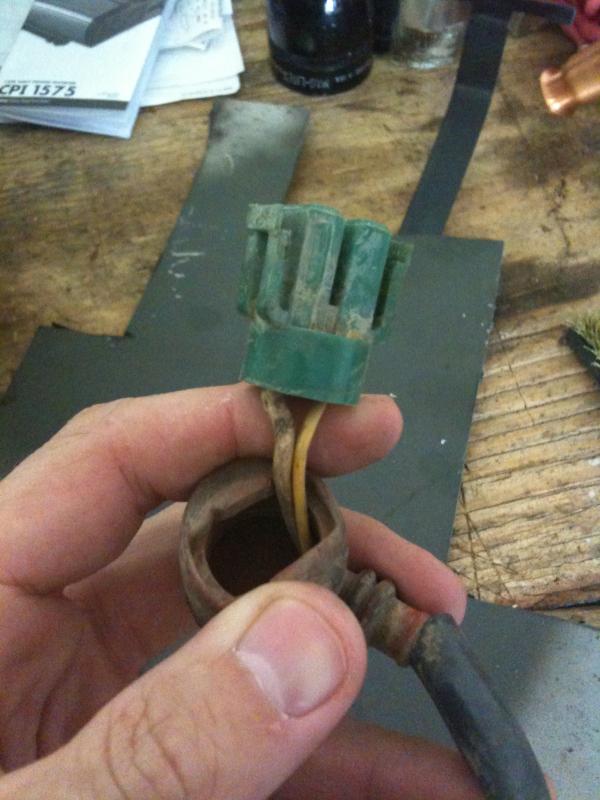

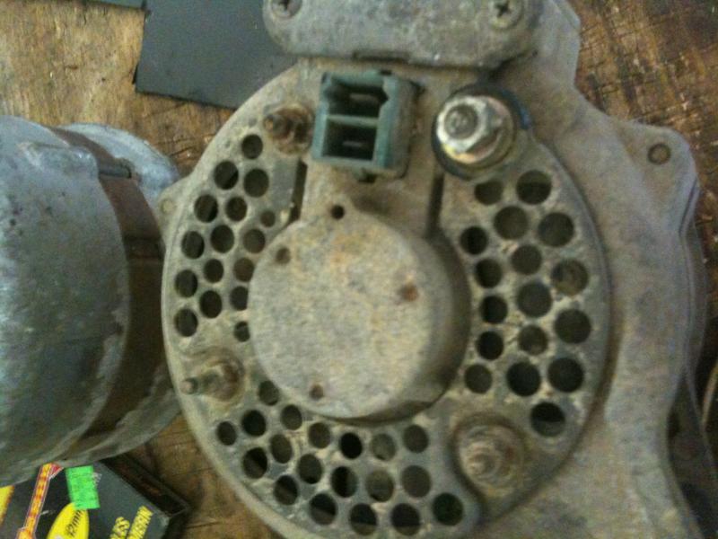

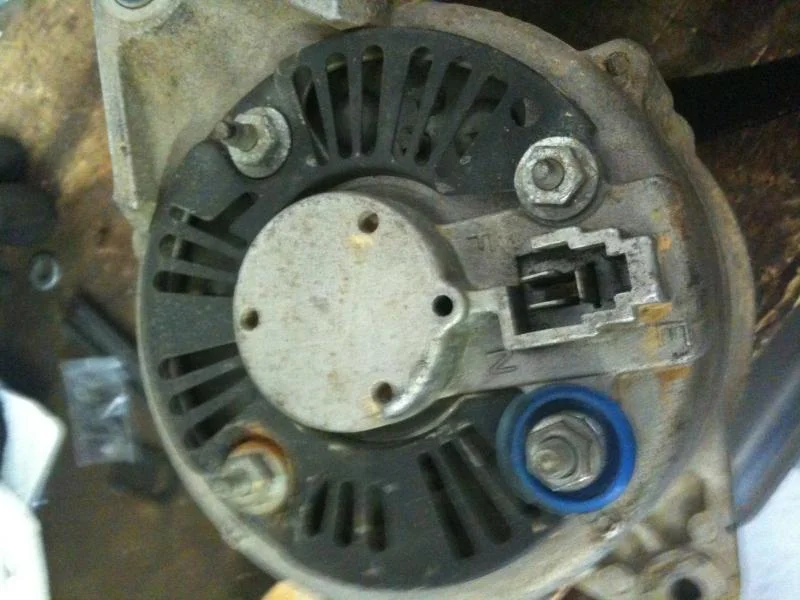

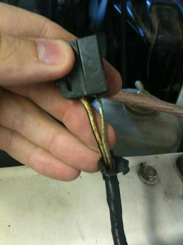

The stock alt has a 3 groove plug, where as the 60 alt has a two groove plug. Each plug only has two wires going into it. The stock alt has one larger white with black stripe wire, and one smaller white with light blue stripe wire. The 60 alt with two groove plug has one larger white and one smaller yellow wire. Does anyone know how I need to hook up the stock wires to the 60 alt two groove alt plug? Is it possible to reuse the 2 prong plug I currently have or do I need a new one?

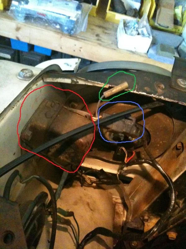

Also, is what I have pictured the voltage regulator? Do I just unhook and remove this? It is located just behind the driver's headlight. It seems to match a picture I found in the 40 section but I thought it would have been mounted closer to the alt or on the firewall.

1976 FJ55 alt with 3 groove plug
1983 FJ60 alt with 2 groove plug

Suspected voltage regulator - is behind driver's headlight. Suspected volt reg is circled in red, plug circled in green I think is for a stock stereo for noise reduction (is currently unused), and plug circled in blue goes into the stock wiring harness. Can I just remove this sucker?

OK, I had the same situation. I was going from piece of junk alt that came with my f motor to a donor fj60 2f alt that jimc dug out of a pile as a result of headapalooza 2010. Anyhow, simple as this, unplug the external regulator, the one on the inner fenderwell, behind the headlight. Throw it away, leave it, whatever. On the pic of your 2f alt, the 2 prong version, take 1 wire from the connector closest to the middle of the alt and wire it to the pos side of your coil. Take the ground on the 2f alt and connect it to the old ground on the f alt. Simple as that. This is how jimc told me to do it and has worked fine since swapped.
