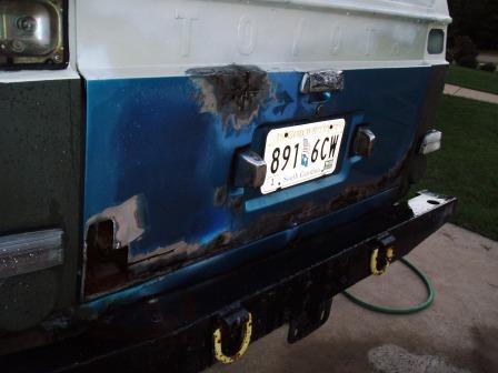

Pillars painted white - everything taped off so I can paint the roof once the white sets up a little more and the wind dies down. I started working on the tailgate which is pretty rusty. I ground off what I thought was just paint but once again was THICK bondo. It looks like I am going to have fun cutting out the entire bottom of the tailgate. Hopefully as soon as I get the rust cut out of the tailgate the wind will have died down enough for me to start painting again.

I got a fair amount of work done today. The exterior of the truck is now painted except for the hood which I hope to take care of tomorrow - the tailgate also needs to be painted but I have to repair some rust first.

Pic 3) tailgate under construction

I would like to get my tailgate finished before the Pumpkin Pig Run but I don't know if I'll get that done or not. Mudrak's seal will have to wait until after PPR when I'll hopefully replace my rear main at the same time.
