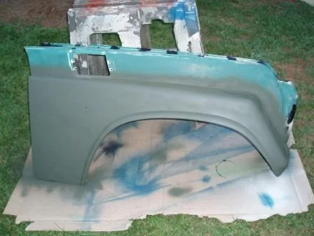

I painted the lower passenger's fender ODG last night. Before I painted I sanded, cleaned, and then slapped on some POR across a few rust spots. I probably should have cut some metal out on the lower fender where all Pig fenders typically rust but since I plan on making tube fenders this winter I just slapped a good coat of POR on both sides and called it done. I'll paint the upper passenger's fender white today and clearcoat both upper fenders if work allows.
I did experiment a little with painting directly over POR. I believe according to POR you should use their primer to topcoat. I have had (so far) decent luck painting over slightly tacky POR. Yesterday I tried to paint over wet POR and no dice. The ODG didn't adhere one bit. So, I put a fan on the fender (remember I'm in hyperdrive) and let the POR turn very tacky. I then put several VERY light coats of ODG over the POR and everything seemed to work well. We will see how it turns out several months from now.

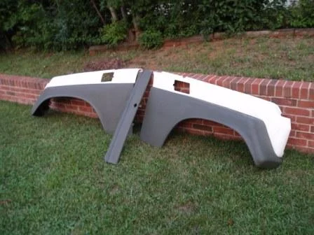

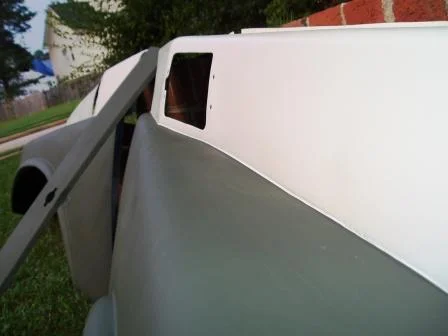

This evening I finished painting the fenders. The second one I did (passenger's side) is definately better than the driver's side as I had a slight learning curve. I would call it a ten foot paint job. I did clearcoat the white which I think will help with durability. I did find out that wind and bugs don't help much with applying a smooth paint job. When conditions are right a rattle can job can look pretty good!

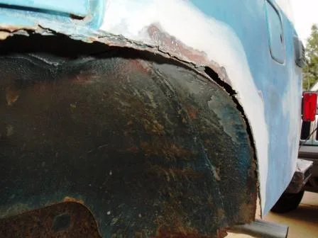

I'm also trying to figure out how to approach the driver's wheel well. I think the best thing to do will be to cut out thin, previously rusted metal on both the outer body panel and the wheel well and then weld back together. There is some pretty thick Bondo here that I've been having to sand off and feather down.

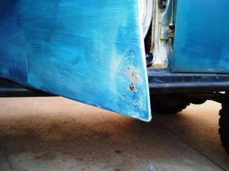

Pic 4) Rust outside driver's door - might have to cut out metal but will try some POR Patch.

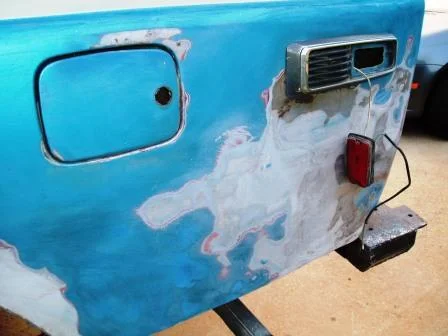

Pic 6) Work on driver's rear quarter. This is about ready for paint. I will need to cut out just a little bit of more metal on the bottom near the bumper. Bumper needs to be straightened also.

Pic 7) Driver's wheel well. Before I say much I will say that the passenger side is MUCH better and probably won't require any metal replacement. The driver's side will require some metal replacement though on both the rear quarter and the wheel well. Right now I'm just trying to get a good grasp on how much I'll have to cut out. I don't plan on recreating a lip which will make things easier on me. Again, lots of POR will be in order.

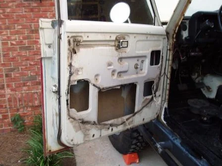

No pics but got a little done this afternoon. I removed the driver's door. I think I can handle the rust on the door. There was some rust on the A-pillar that has me worried. I'll cover it with POR on the outside but there isn't much I can do about the inside. The door is stripped, sanded, degreased and drying right now. I'll hopefully have time to etch it in the morning and apply some POR to selected areas. I won't have time to fully paint it until next week. I'll use POR Patch for the first time on this door to fill some rust holes and some holes a PO drilled for larger van-style mirrors.
