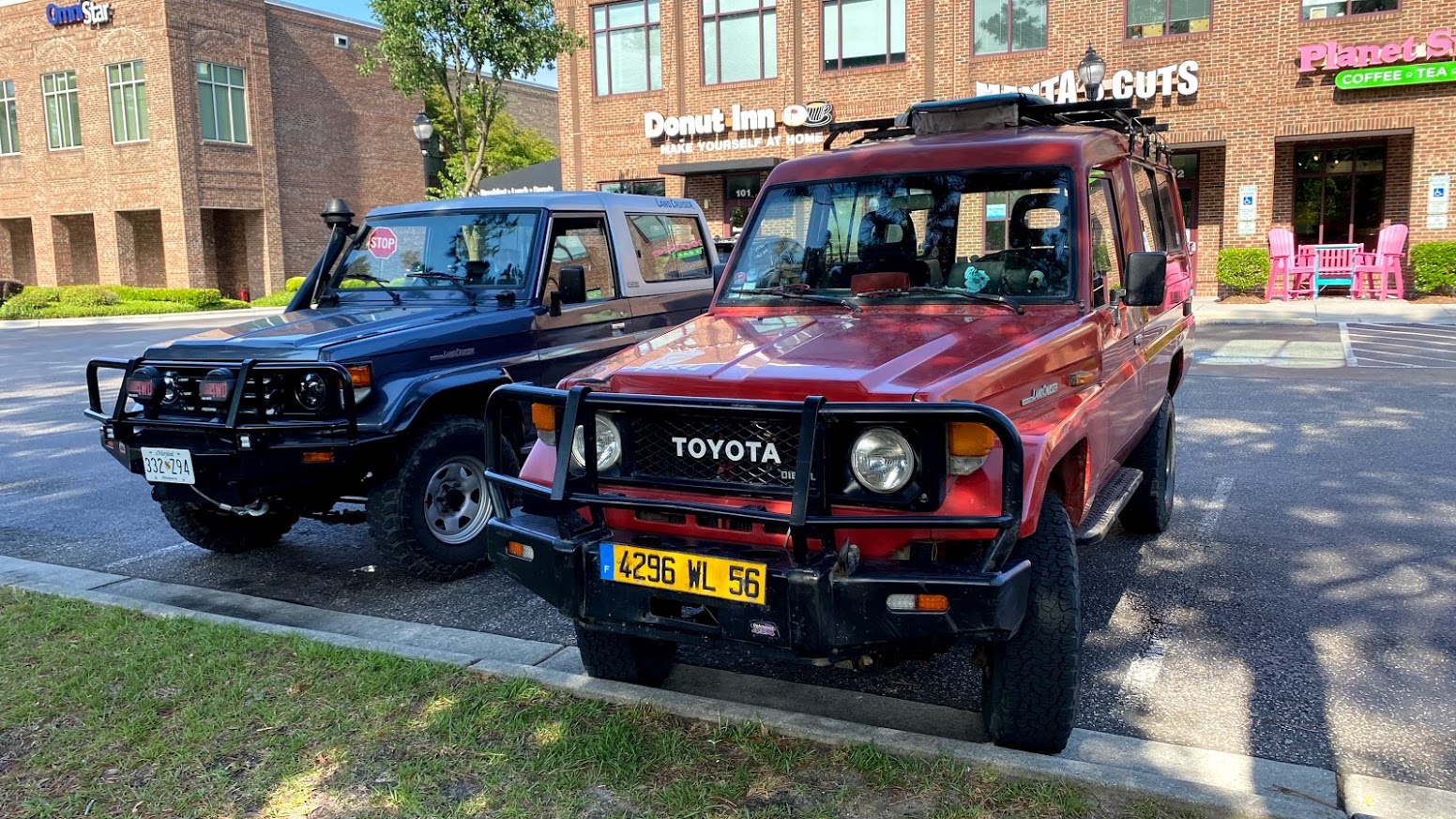

Also unrelated but I was checking out a 1988 Isuzu Trooper for sale for my buddy and all the sudden a pristine BJ-74 just pulled right up next to the troopy!
