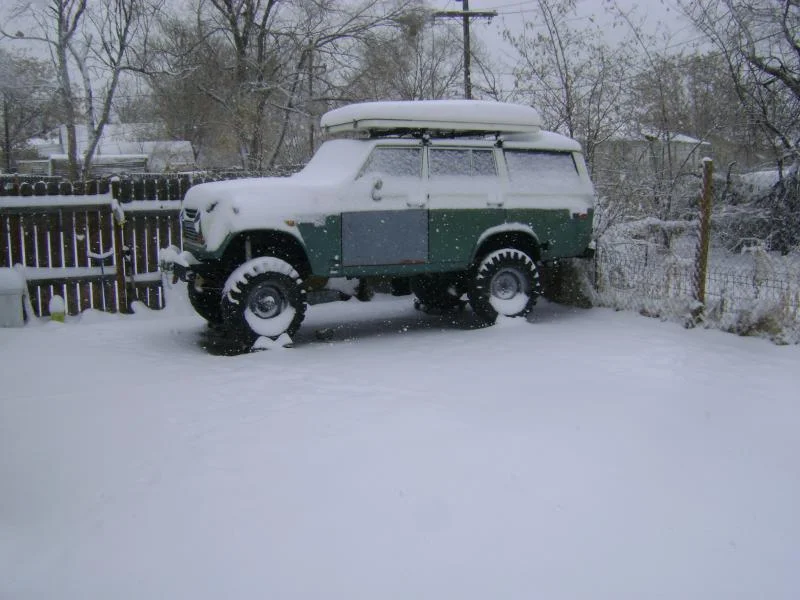

Ige, question: is it the Pickle, or the Pig-kle?
I had the same thought earlier today...or while I was dreaming last night ;)
It's green & wrinkled...it's a Pickle
...but then it got shot down :doh:
