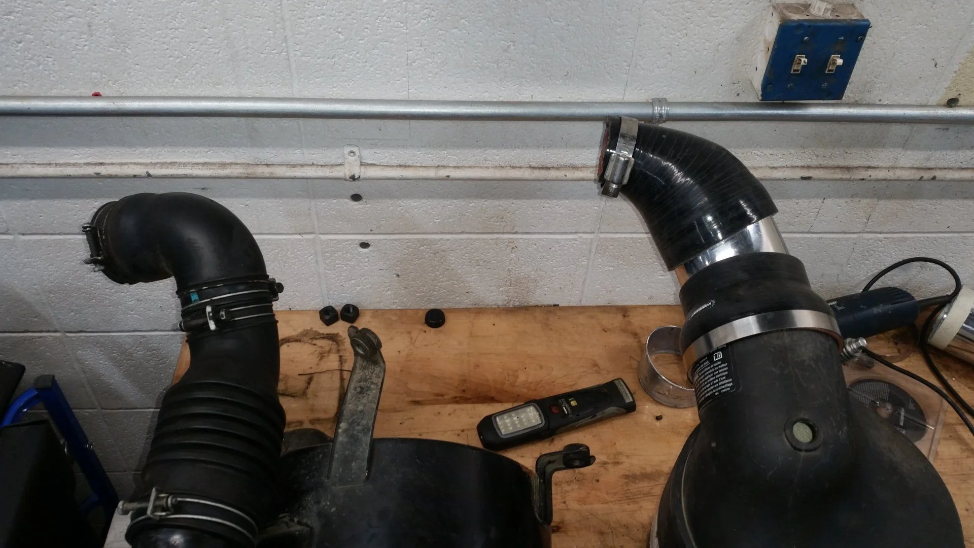

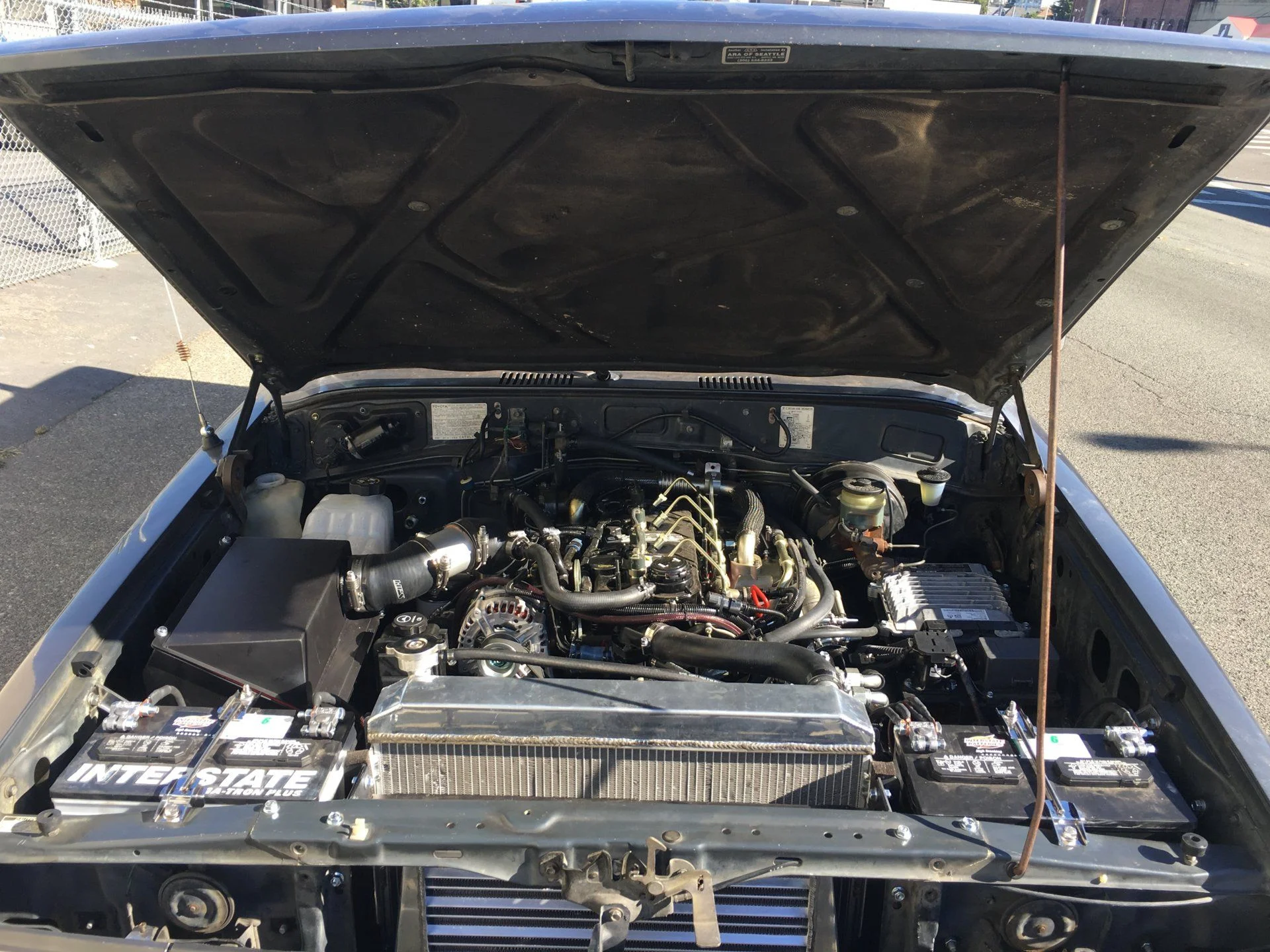

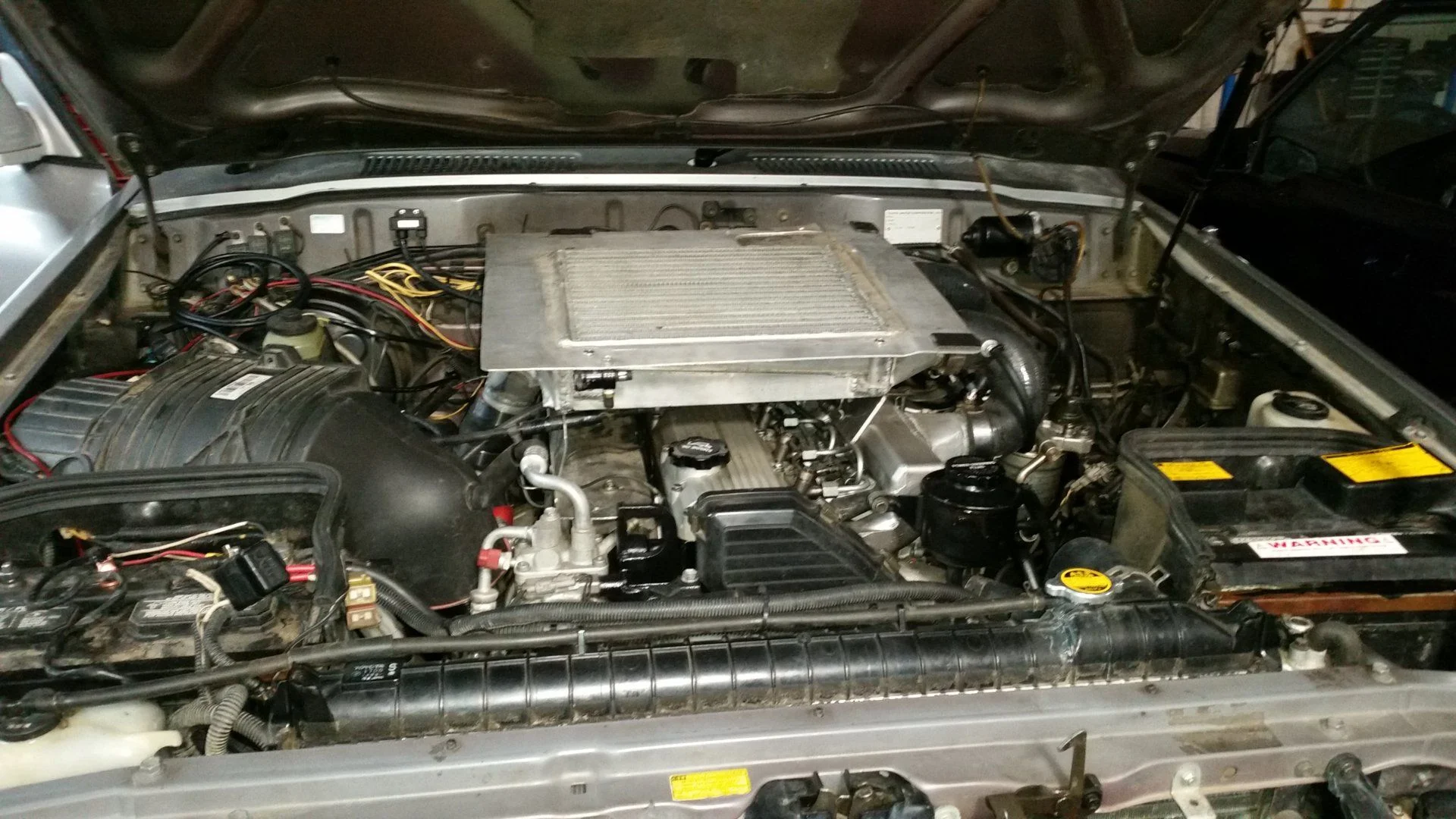

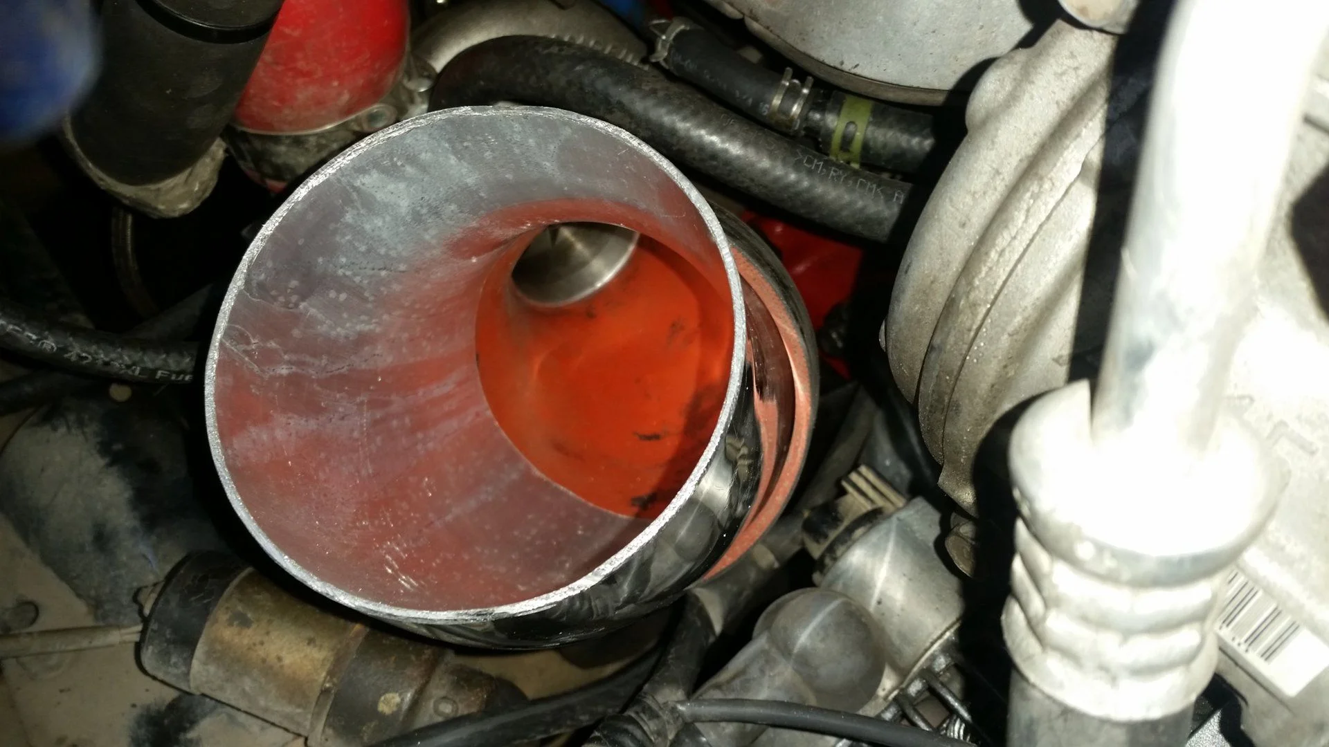

Here's my PDI airbox. This thing is huge! We had to cut some of my ARB battery box out to fit it in there. We also had to slot the mounting holes a bit. (@FJRanger ) But, it fits in there pretty nicely. ... tight but nicely. Low boost response seem very good and running 22PSI on my new turbo with this box seems very easy and uneventful. After my next trip, I might bump boost up to 24 or 25psi.

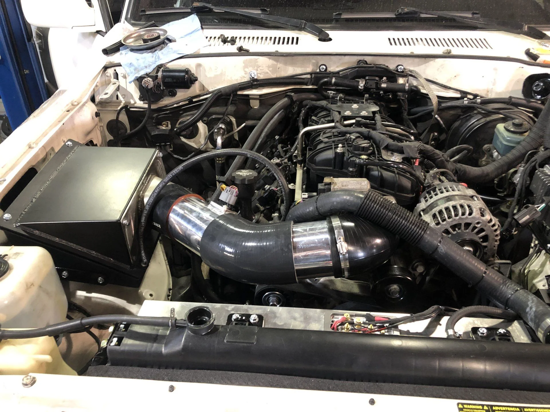

Duramax Airbox Installed in 92 HDJ
I recently installed an airbox from a 2010 Duramax in my HDJ81v Landcruiser. Large airbox intake and a 5" outlet. Attached to 4" tube with as few bends as possible. Tapered silicone adapter to turbo.
Significantly better turbo response. EGTs down about 100degrees. Pretty tight and simple. It took 2 evenings to measure and fit the airbox. Under 200.00.
