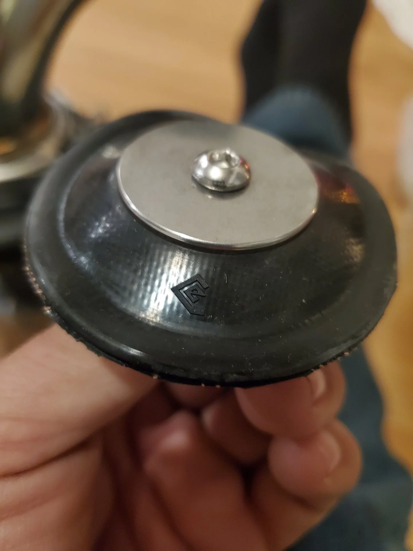

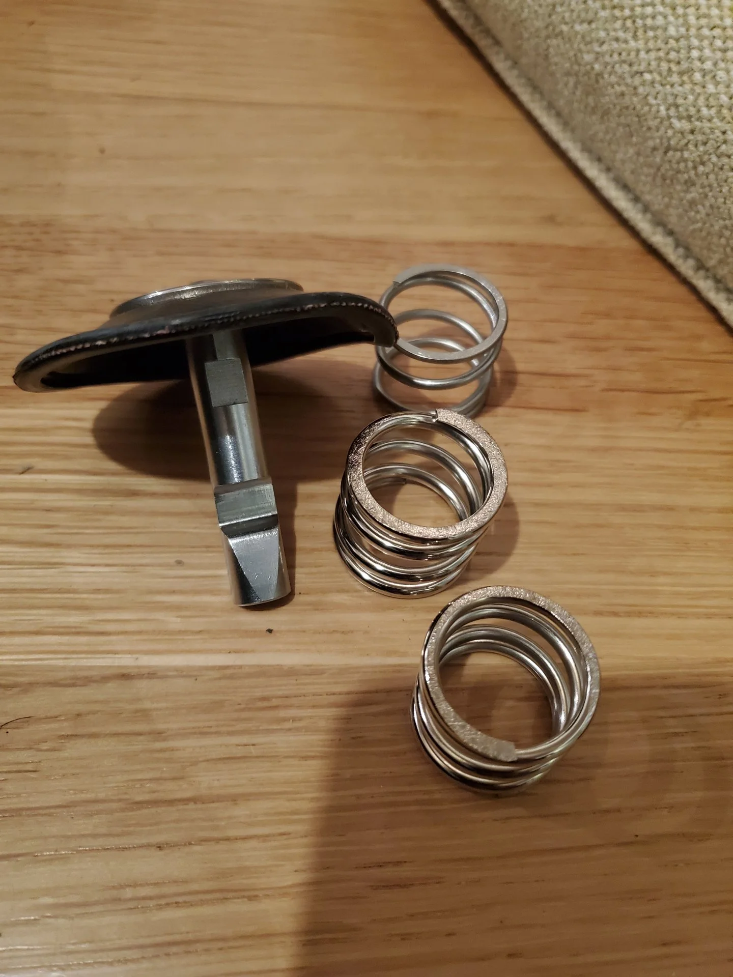

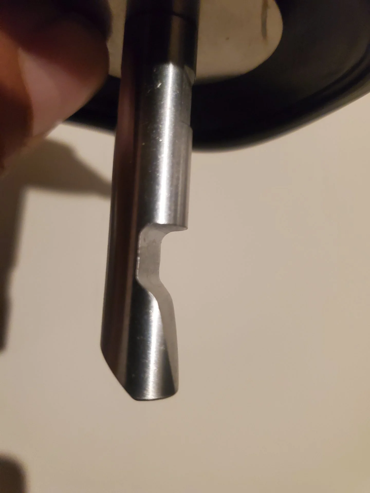

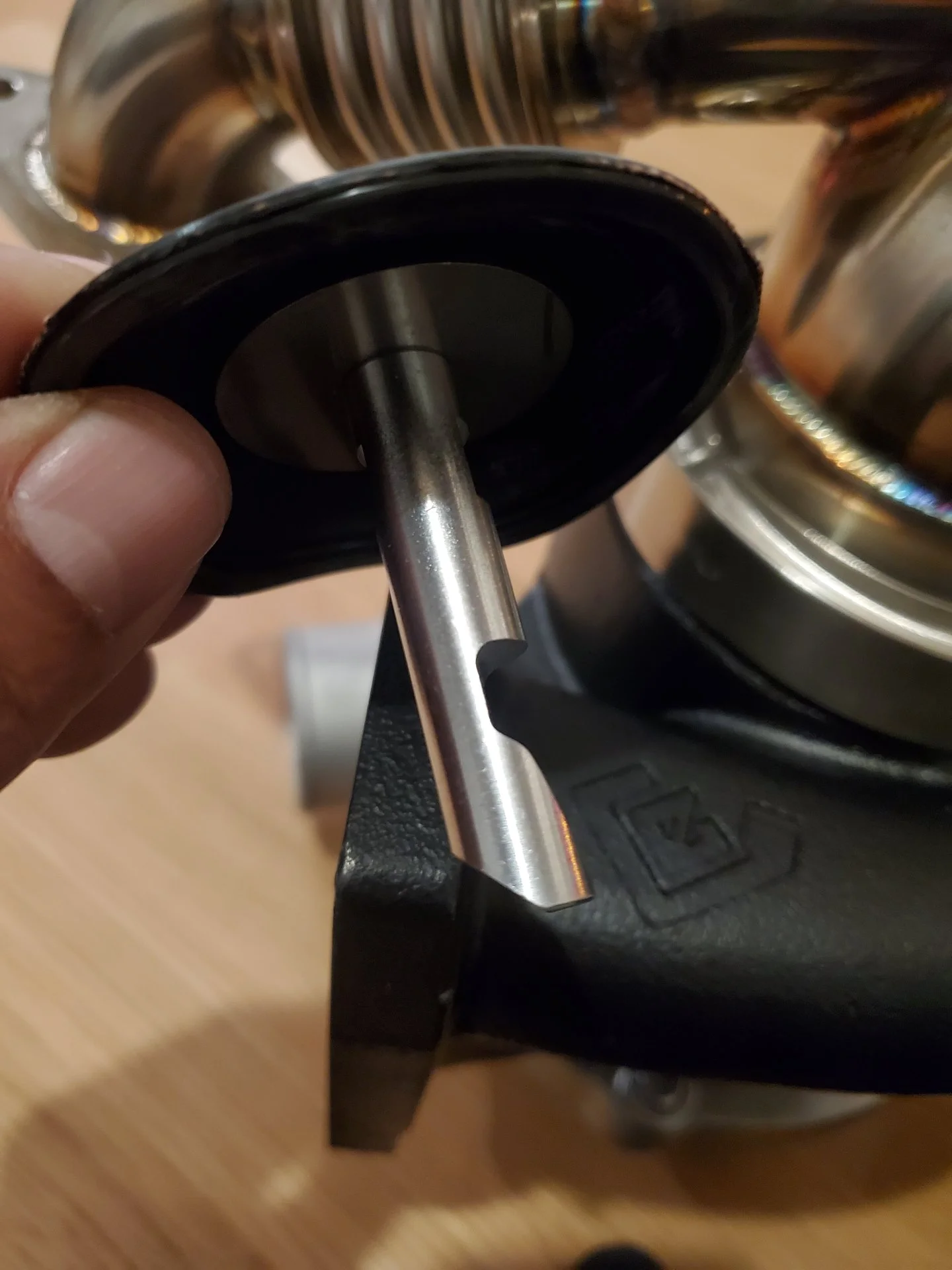

Machine shop finished my aneroid pin. Works great so far. Multiple ramps on it and tested for correct hardness.

Post a clear pic of one from a couple of feet range, it's easy to scale it and put some measurements to it

I'd like to see a clearer pic of the eclipse pin taken at 90degrees from the side to side the profile so it isn't distorted
