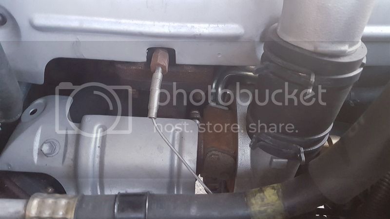

@Lumpskie Do you have the ECT button, and O/D off buttons in your truck? If no, you've likely got a fully hydraulic A442F ('90-92), no electronics. You would normally only have torque convertor lockup in O/D with this version, but as it's a wholesale automatic unit it could have the upgraded valve body in it, and lock up in 3rd &/or O/D, you should ask Tor if he knows if that's the case. Whatever the case, make sure you get a trans cooler ASAP if they didn't retain the one in the truck.
Adjusting the cable is very easy, just need a 14mm wrench, half turns at a time, adjust, test, adjust, etc. My last truck was a slug when I got it, I figured this out when we stopped in Calgary, so too late to enjoy in the mountains sadly. Really improved how the truck drove, the boost lag previously was brutal, made it dangerous to pull across a lane of traffic. You should be able to downshift with the gas pedal if properly adjusted, and it will hold gears longer as it's all dependent on that cable's adjustment.
@IanB
You got it. It's the older full hydraulic A442 and it has the lockout in 3 and 4. The trans cooler looks pretty standard so I don't know if it's OEM or a generic... but at least there is one in there!
If I get time tomorrow, I'm going to read up on adjusting the cable. Hopefully I can get it fine tuned before my commute on Monday! (Especially because my boost controller should arrive Monday!)
@IanB Thanks for your suggestion on adjusting the kick down cable. I adjusted that and I can get my rig to shift down much better now! Also, with that, my EGTs dropped 100 degrees on the hill by my house. At this point, my EGTs on the hill near my house are down to about 1000. My Dawes boost controller arrived in the mail as well. I think I'll have time to install it late this week.
Thanks again,
yup, that's the best spot for it.
Based on that, and your EGTs after you tweaked the auto kick down cable, you probably have quite a bit of room to improve the tune and add some fuel to liven it up a little. See what a bit more boost does, but 1000*F is very safe.
