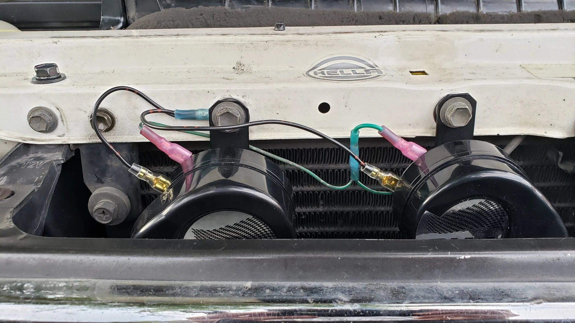

I have the Hella Supertones. I'm happy with them. Some people don't like them because they sound European (think loud Mercedes horns). They were mostly plug and play.. I think I made a little ground jumper for them.

Perfect ... just bought them. I assume I will need a relay since the factory horns have constant current?

@thatcabledude @inkpot ... I have the 2 wire 4-note Cadillac horns. Do I just wire up the one wire to power and the other to a common ground on those and they should be good?
Probably, but I’m not sure. I’d definitely run a relay. Always wanted a set, but have never got around to finding some.
