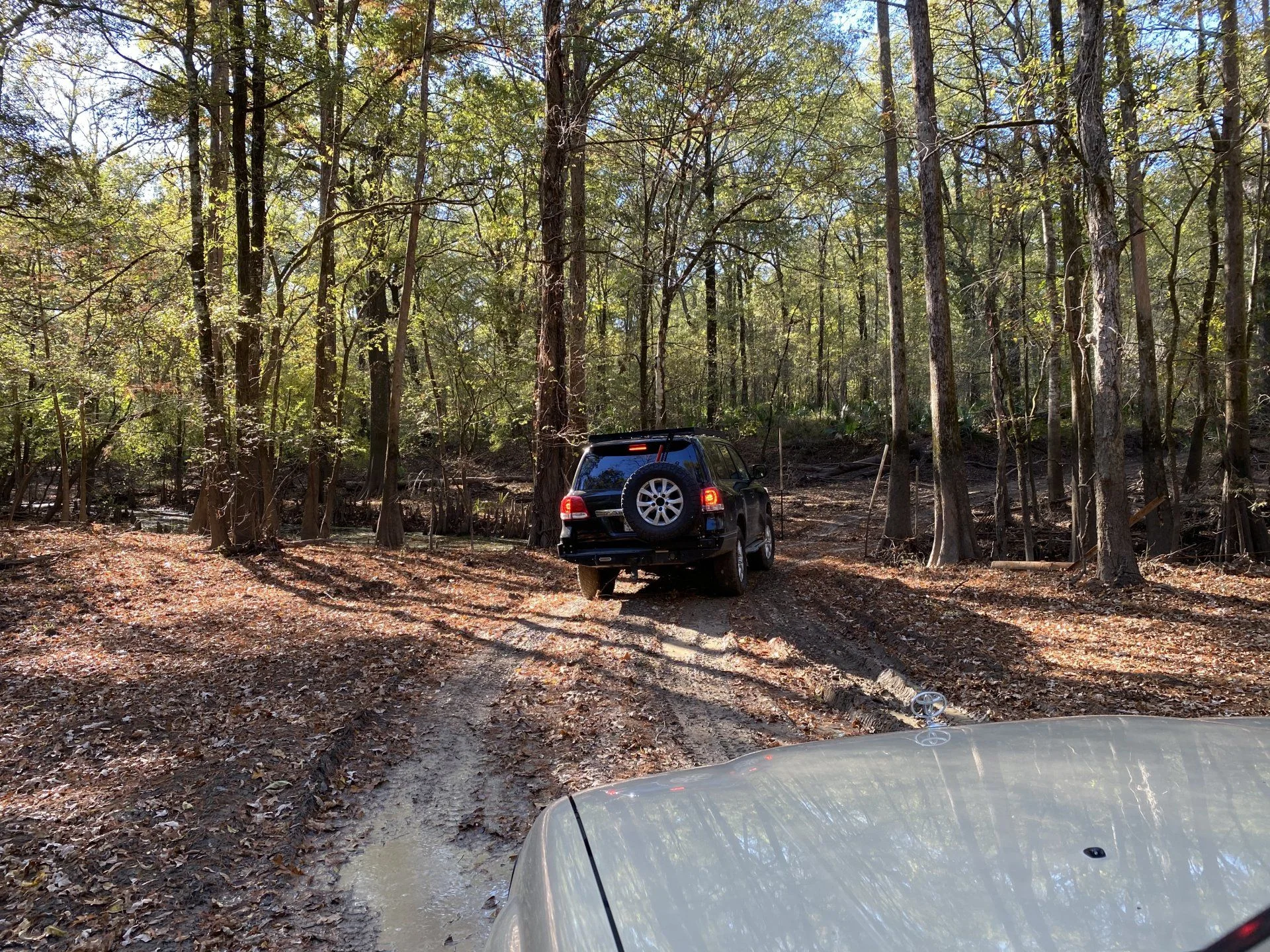

Excellent tuck and excellent droop on those flexy pics.
I have been trying to make sure I did not overload those “stock replacement” OME springs. Not adding bumpers is key to get to use these babies.
The Bilstein shocks are also impressive. This truck has almost zero body roll or dive on braking.
We ran 75 mph to and from on the interstate portion which was about 300 miles at 2900-3000 RPM and I got an average of 14.5 mpg.
Not bad at all.

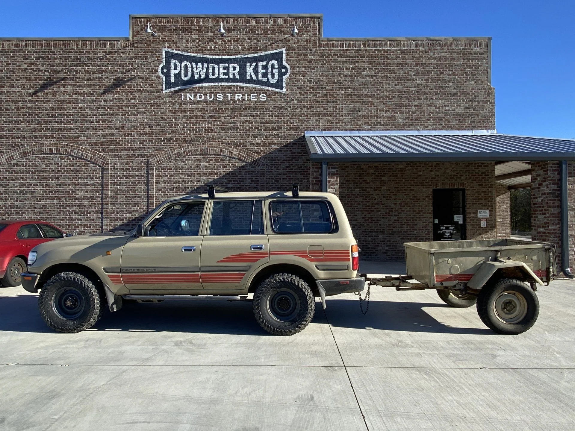

So whats the game plan with the trailer? I still think you need to swap it to a 6 lug axle with matching wheels... That would be the Bees Knees!!!
I’m keeping it 5 lug but am powdering the wheels and adding Yokohama’s. The wheels look close enough to “match”

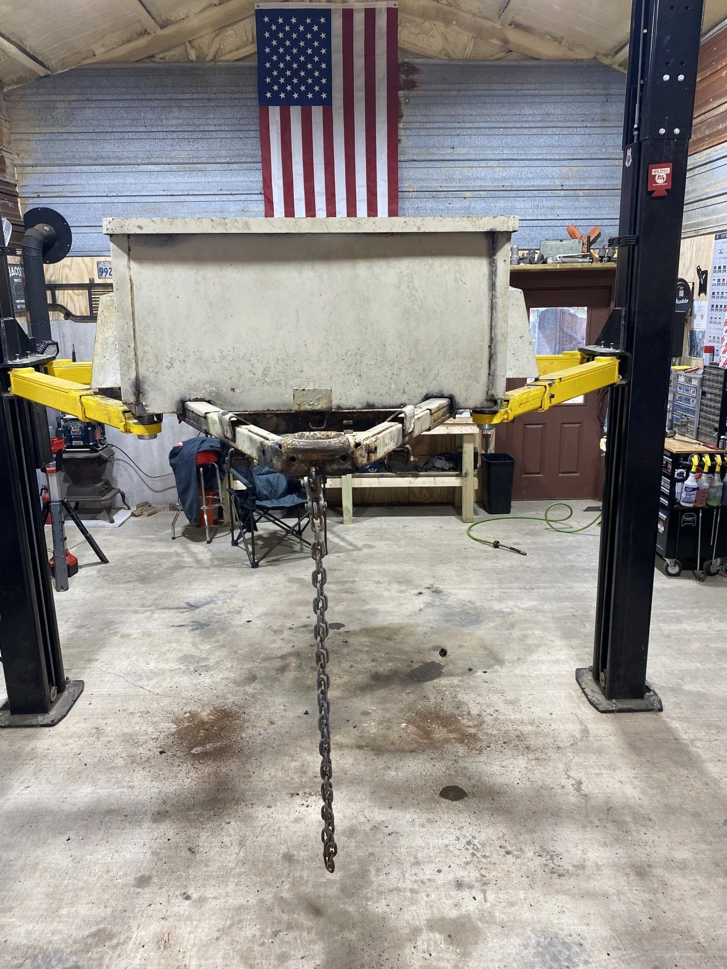

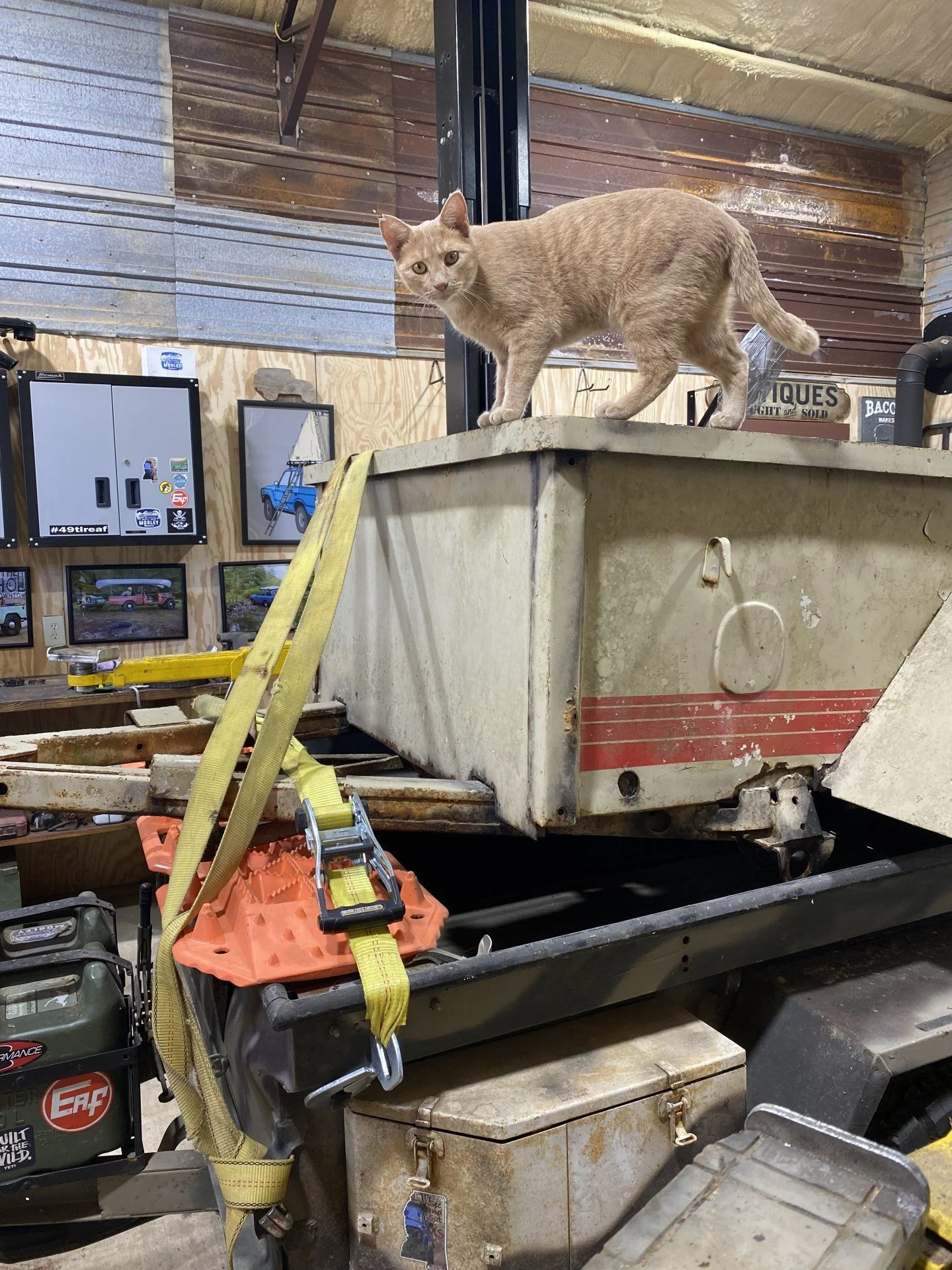

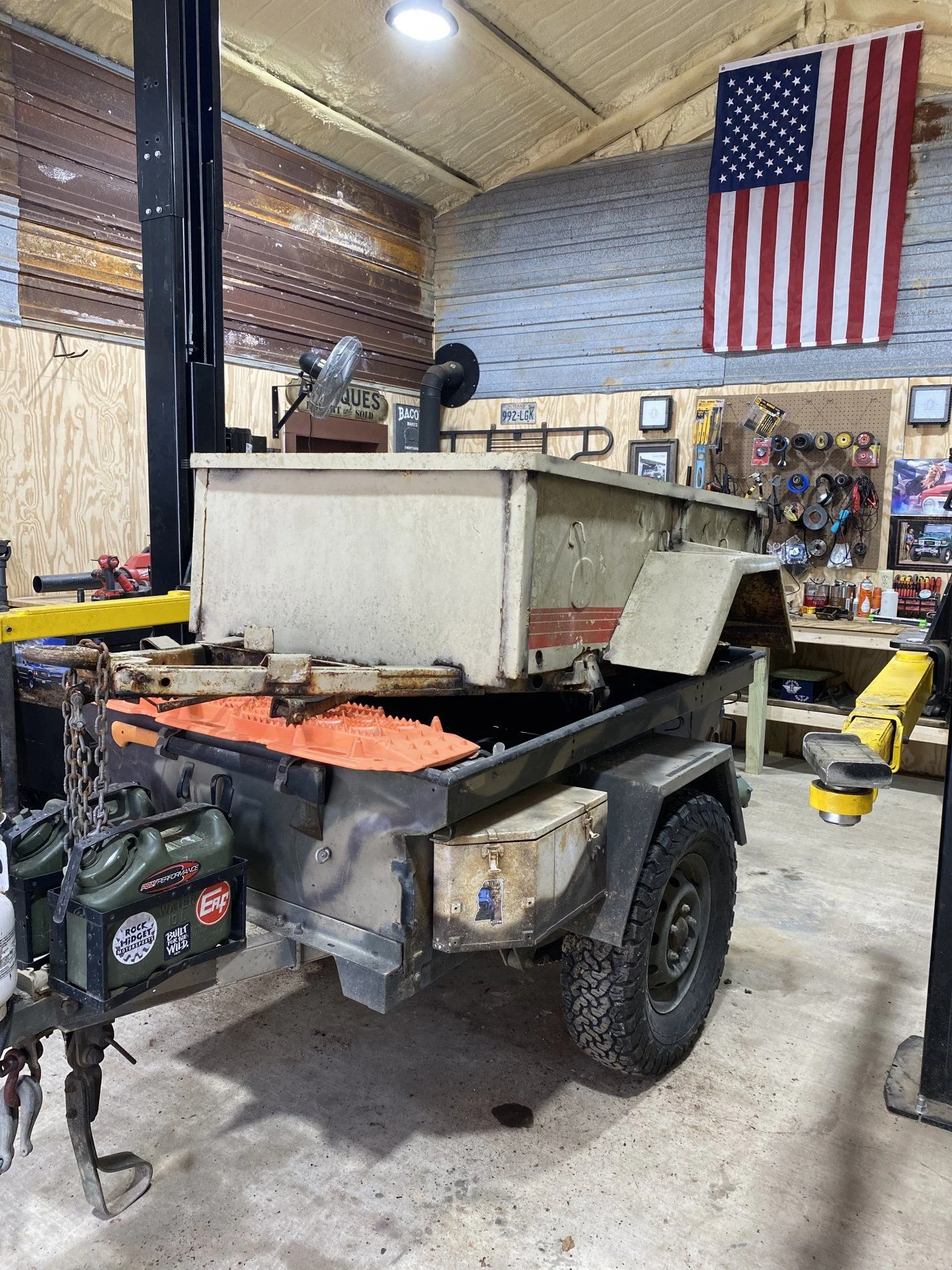

I just finished breaking down the trailer for blast and powder. I will be doing an epoxy primer powder. That way I can protect it. Cut out bad spots then repaint it the color of the 80 and restripe it.
I am going to spring it under when it goes back together. Not going for a show trailer just looking to be confident in it and preserve its unique history.

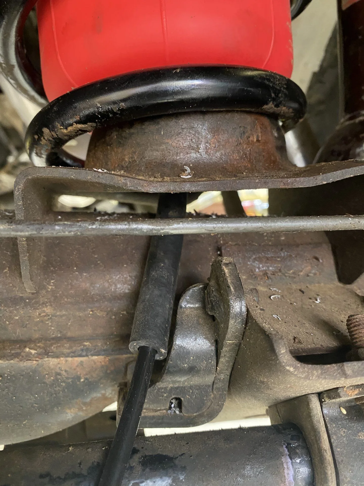

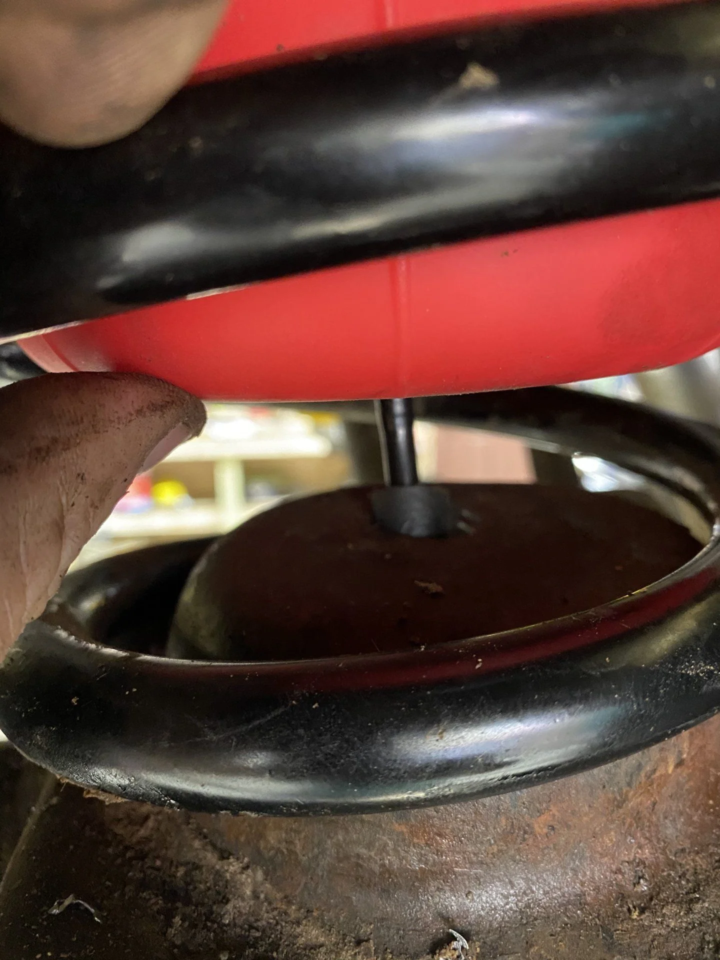

All of my coil sprung trucks get a $100 set of Airlift 1000 bags. I like to run them with very little rear rake and light Duty/soft springs so these little guys do Great work when the truck is loaded down.
I drill out the holes on the bottom of the perch with a 3/4” step bit. Sleeve the cheesy air like with some 5/16” hose.
They always look like they are way too short but when weight goes back on they fit just right.

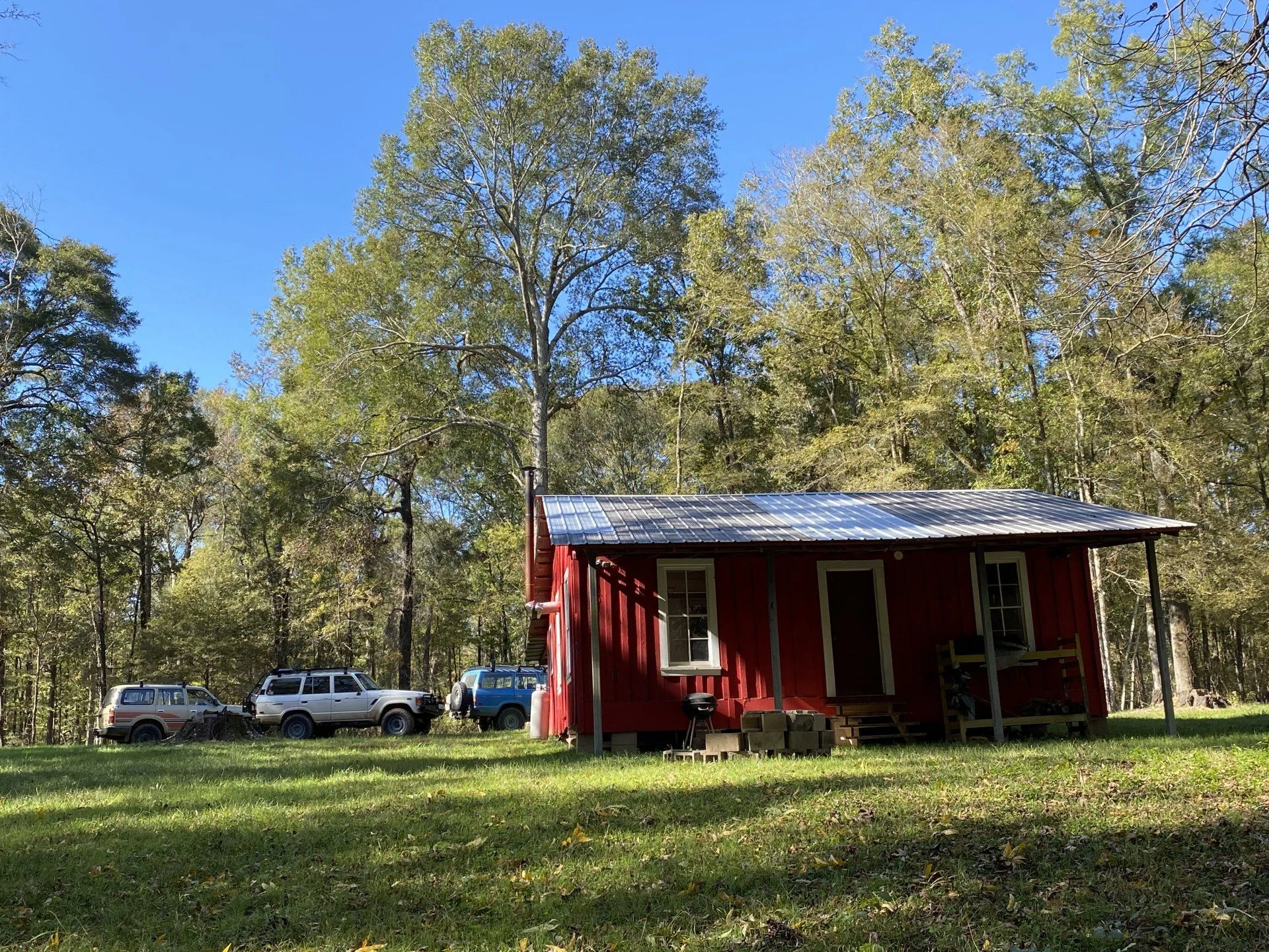

Taking the OddBall80 camping this week so I took advantage of having some tall Boy Scouts at the farm put the tent on.
