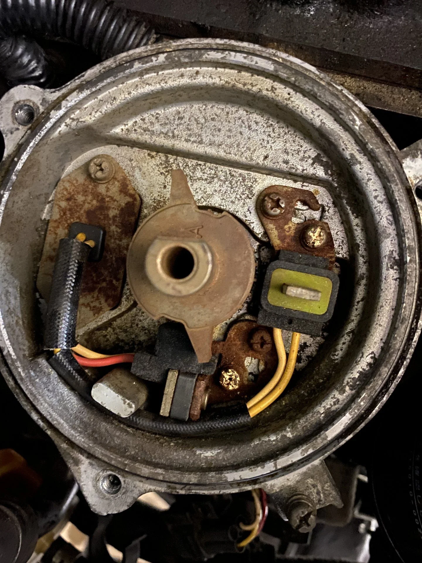

But it still won’t fire. I think I disturbed the pick up coils in the distributor when I attempted to clean it in the truck.
I will try to find a good distributor to test and see.
Of course, I can’t get the distributor out. I had to use a hammer to get it to move at all clock/counter but it won’t pop out. I Hosed it with Kroil and am calling it a day.
Dustin’s dad did a fine job repairing my AFM boo boo.

To review. Truck was running good before I messed with it.
During the Desmog I changed the cap, rotor, plugs and wires for OEM.
Igniter and coil on this truck are late 2F style igniter and generic round coil (all worked when parked)
I had to use a 2F wire from coil to cap.
The dissy looked like hell inside. There was no gasket. I used a wire brush and air and a bit of Kroil to clean up inside the dissy.
I am getting 12.2v at the coil wire going into the dissy when I turn the key and starter.
No spark is coming out of the dissy.
Fuel pump setup I have is getting and sending fuel.
I’m guessing I messed up the pick up coils in the dissy when I cleaned them
