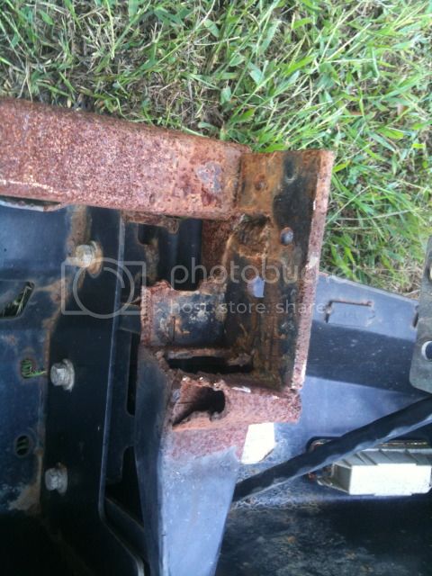

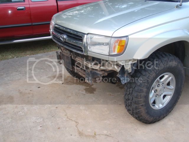

Did a little surgery on the 4runner a few weeks ago:
No accident, just prepping for this:
It needs some cleaning up, a repaint and a few other things, but for the $ I couldn't turn it down.

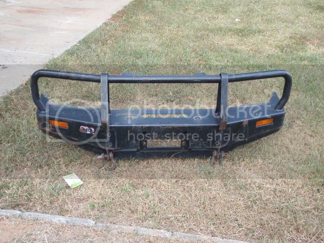

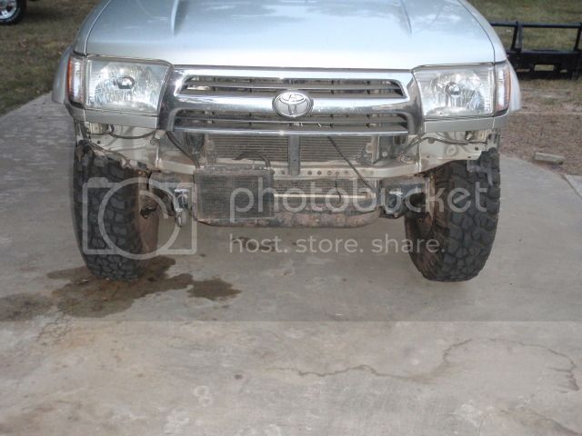

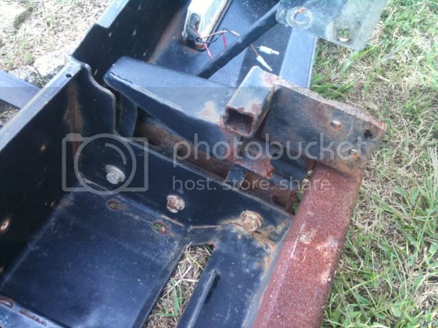

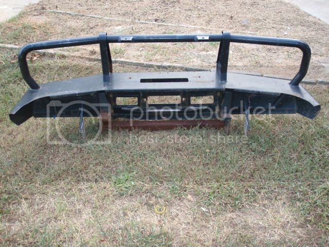

Went camping after UC's annual meeting and ran up to NC in the T100 and finally picked up a front bumper for the 4runner.
Working on getting some brackets as this one was modified for a 2" BL on a Taco.
Ghetto rigged so planning to get them reworked and done right.

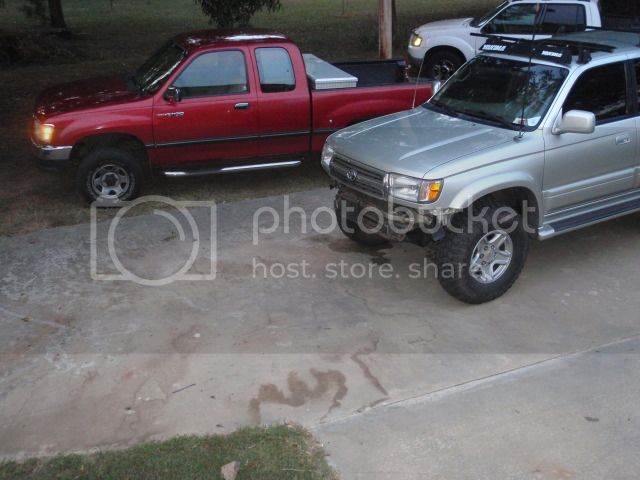

The fleet for now. (Sport Trac is my parents, we are doing a little work to it for them.) Hoping I can get some $ for an old car in the next few years. I'm starting to miss my old cars.

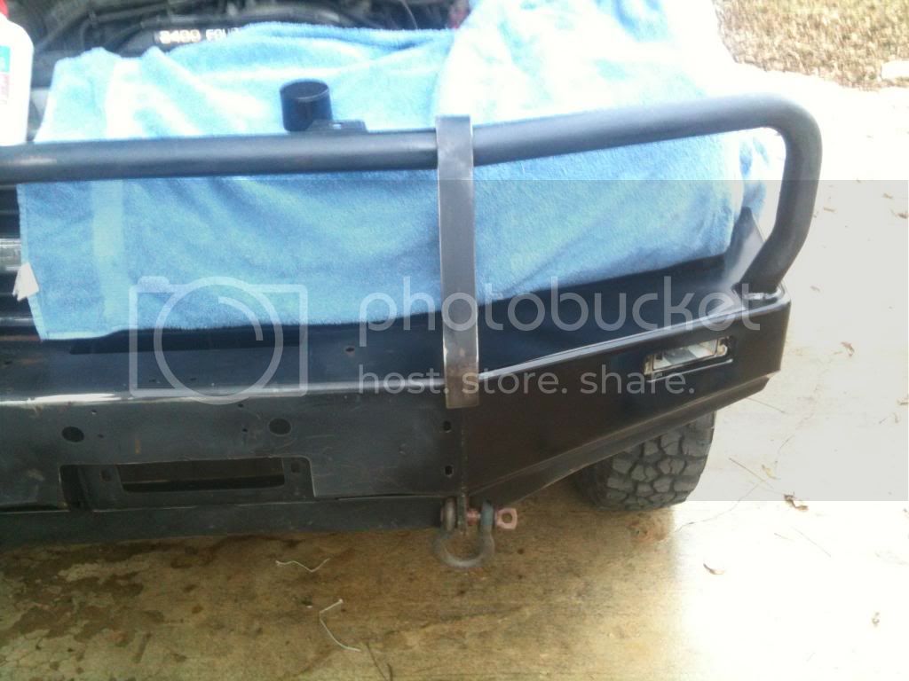

Progress:
Sure is nice working at a Technical College. :)

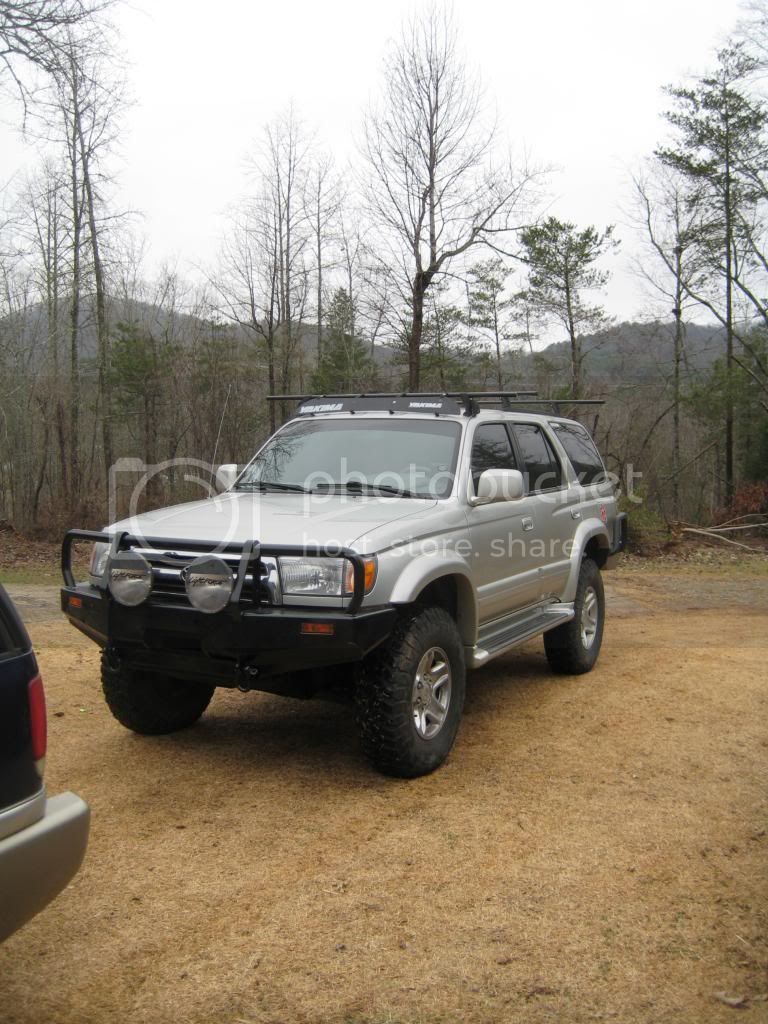

Plan to finish it up tomorrow. Its about as close as you can get it considering I didnt really have any decent brackets with it. I think it looks good though, its up nice and close, with just enough clearance for flexing/movement.
Then I can clean it up some and hopefully get it looking as nice as the rest of the truck. Hope to be able to have it on for the BRP run this weekend! :bounce:
Saturday? were you there saturday? How did I miss a bright green 45 :D
Truck is looking great Matt! the folks on the trail were gawking at the flex as we got on the trail. PS your driver brake light needs replacing ;)

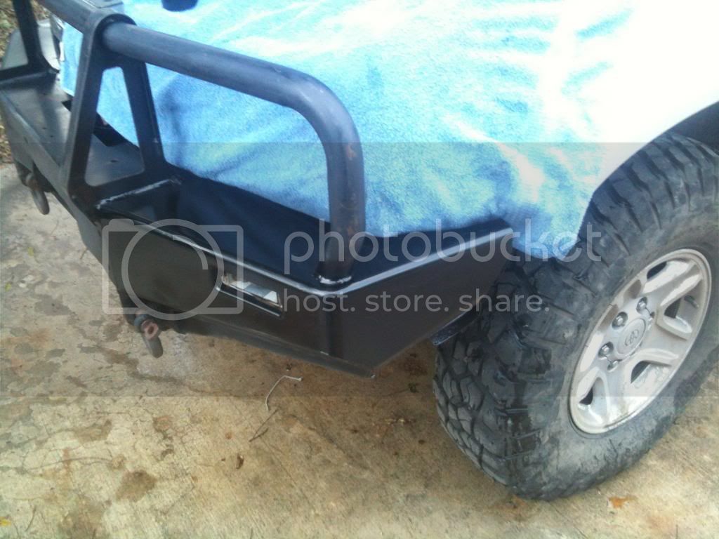

Bumper installed finally:
Sanded it down and painted it with gloss black, looked so much better:

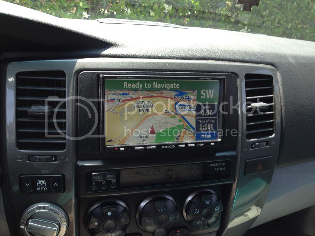

HU is installed but cannot seem to find the reverse signal wire to trigger the backup camera. Waiting on a little more $ so I can order the rear monitor(s) for the kids.

And for your reverse signal wire... the neutral safety switch is on the side of the transmission, you could get a signal from there. Or possibly from the signal wire to the Reverse dash indicator light, though I would be a bit wary of messing with that circuit.
