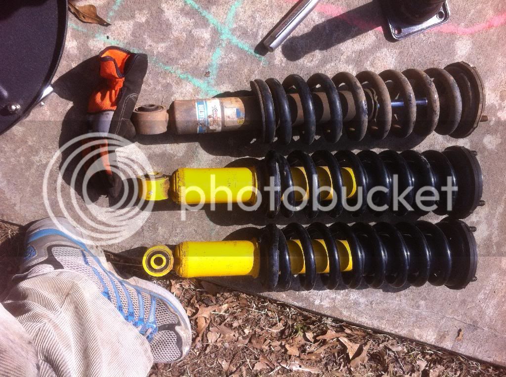

Now it is time to get the BL pulled off and the front suspension swapped over (I have some OME shocks and springs in the garage) and find some 265/75/16s to mount onto my Enduro XD rims. 265s seem to be harder to find in good shape used with enough tread to mess with.
Installed new front shocks and springs a month or so back. Huge improvement in ride comfort.
OME and 883's
