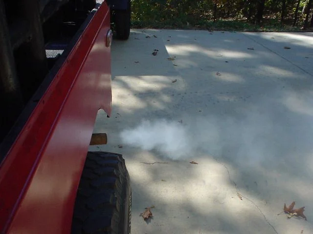

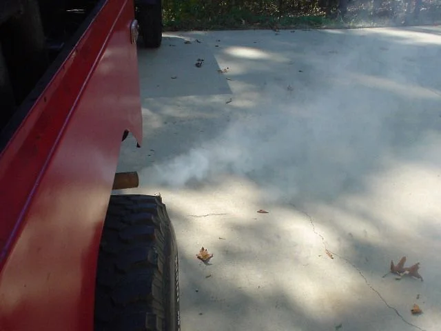

So today I did the SeaFoam thing. It did not smoke like I thought it would.
I poured a 3rd pint in the brake booster vacuum and shut it down. Waited five minutes like the can says and started it back up. Ran it until it stopped smoking. I though it would smoke more...
Using SeaFoam on Vimeo
Well, it apparently did something because I ended up with quite puddle of oil under the truck. Seems it cleaned out the crud to really let loose on the front side leak. Fxxx. I am pretty sure it is the front seal now. I think I did not properly center it when I seated the timing gear cover. Guess I will take a weekend and re-do that and the rear main. I plan on using different "goo" and all OEM gaskets.

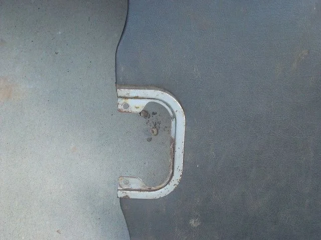

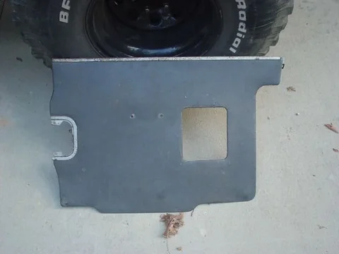

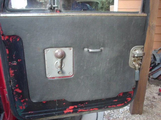

Also I took what appear to be factory door panels off the interior. I have never seen these on a 40 before...
They have to be factory because the door access panel to the rear of the window crank was sealed with clear plastic and tar goo like on today's cars.

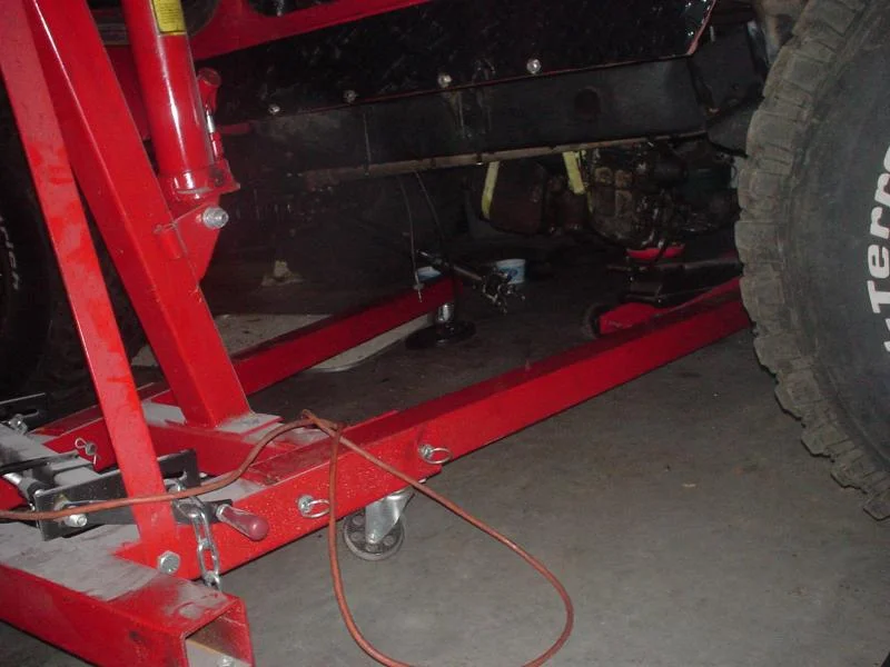

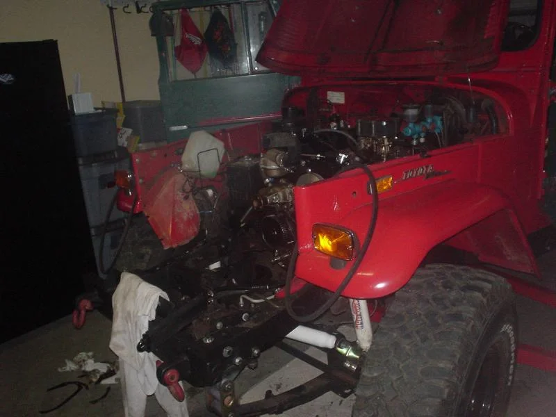

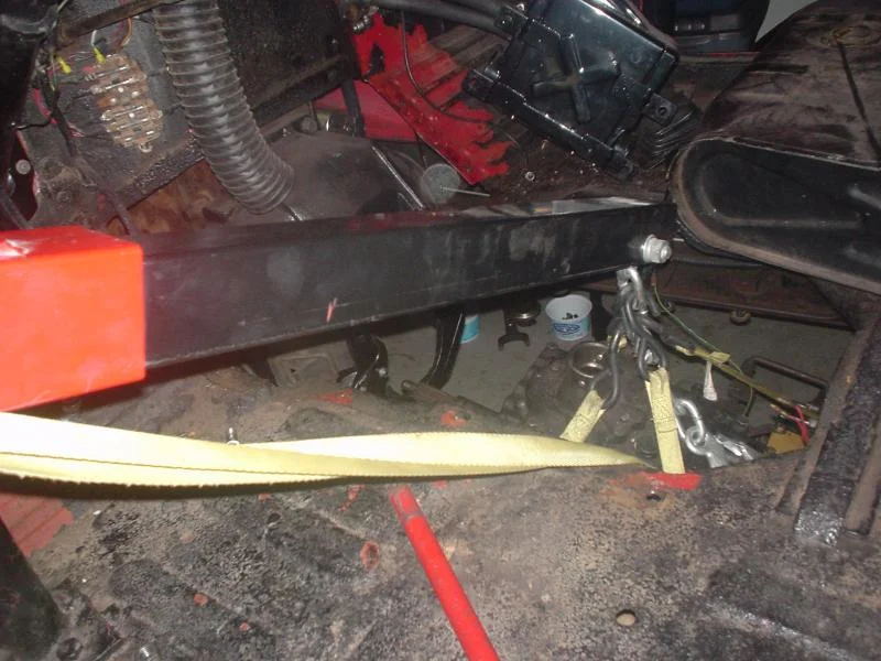

Well. I got another set of seals from Dan. This is gonna have to do it. Rear main, front main, timing cover gasket, a couple others. I am going to use something else as a sealant than the Permatex I chose. Pretty sure that is the main issue. I am not looking forward to the wrench session. My plan is to take the tranny out and the radiator but leave the engine in place. I do not know when I will get to it. but I have the parts and a plan.
I am back at it....
I worked hard today on the gasket and seal replacement.
What I discovered was that the rear main was seapping but hot badly. The oilpan gasket was leaking at the rear and a bit at the front. The front main was destroyed as I did not properly center it.
The think I do not understand is that there is quite a bit of oil inside the inner grooves of the upper pulley where it bolts to the water pump. The water pump should have no oil leaking from it. If anything it would be water. I can't figue this out at all.
So tomorrow I hope to get the rear main in and the oil pan gasket. This will allow me to everything back together to the rear of the engine.
I have a shop in the basement but that is filled with the frame off project so I am doing all this in the garage upstairs which means frequent fxxxing trips downstairs to get s*** I left behind and no airtools. What a PITA.

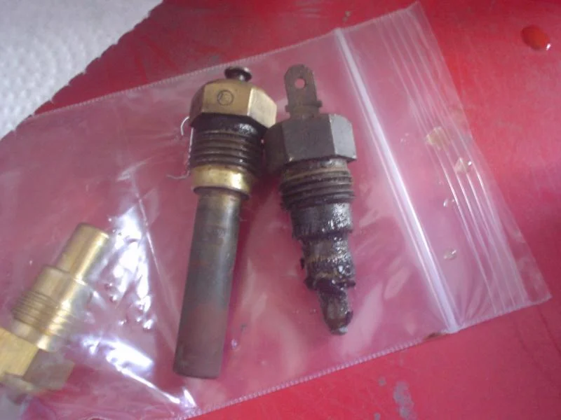

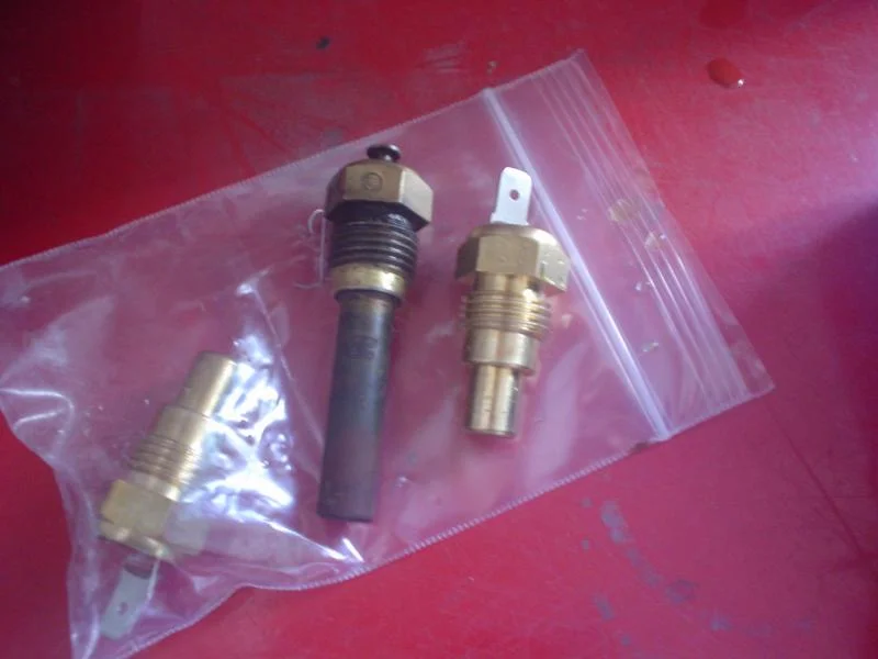

I also learned that early (on the left) and late (on the right) temp sensors are not compatible. I do not know why but the late one will not work with the electrical system pre 9/72.
Below, on the right, is a very old, very deteriorated sensor. :doh:
Rear main, oil pan, side gasket, front main, timing cover all done and seem successful.
