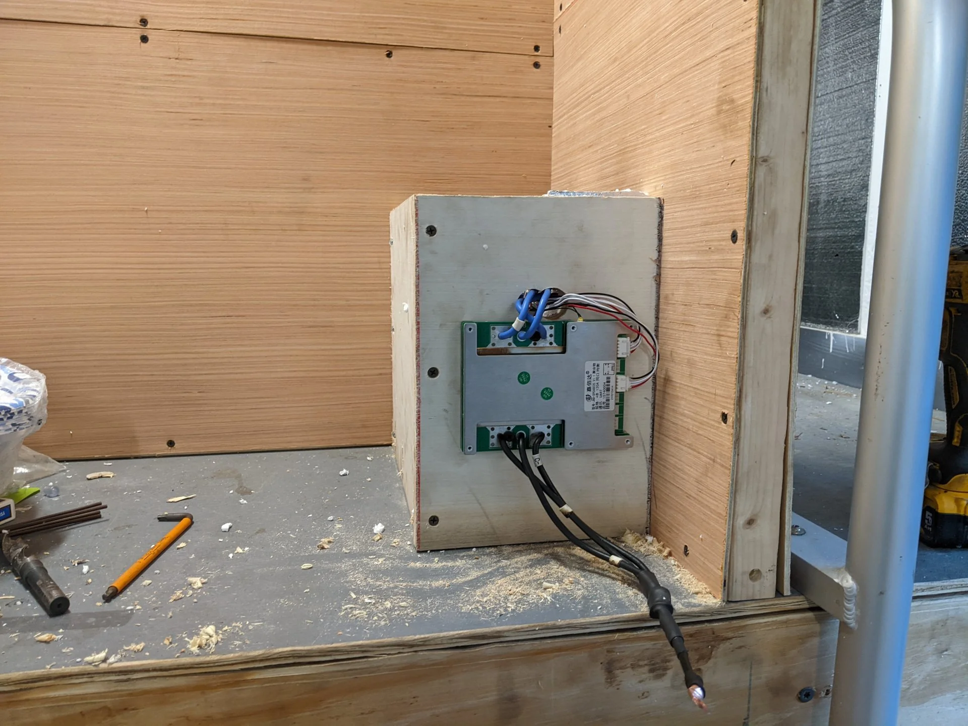

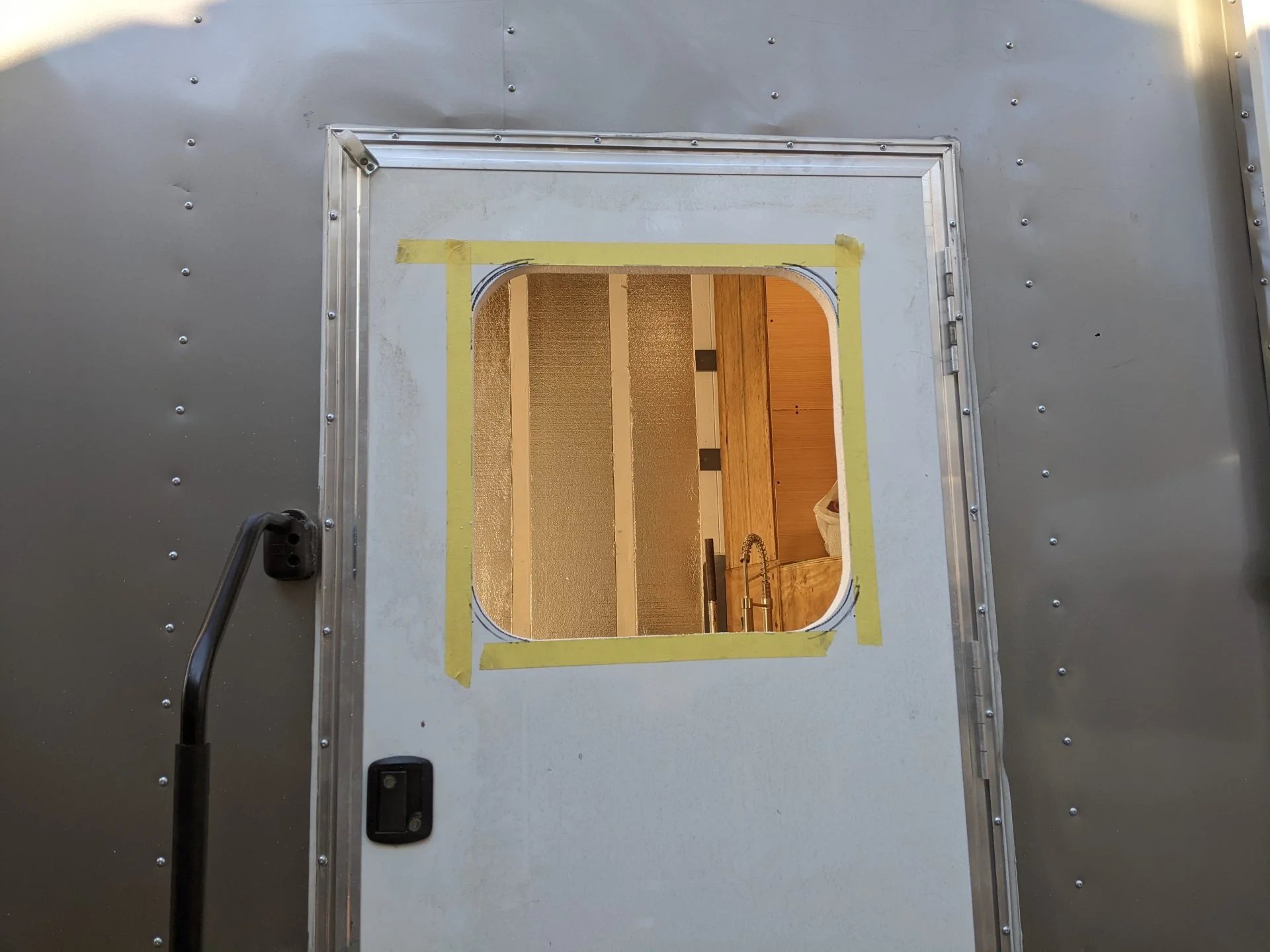

Window installed in the entrance door, roof mostly insulated, battery relocation started. Good afternoon.

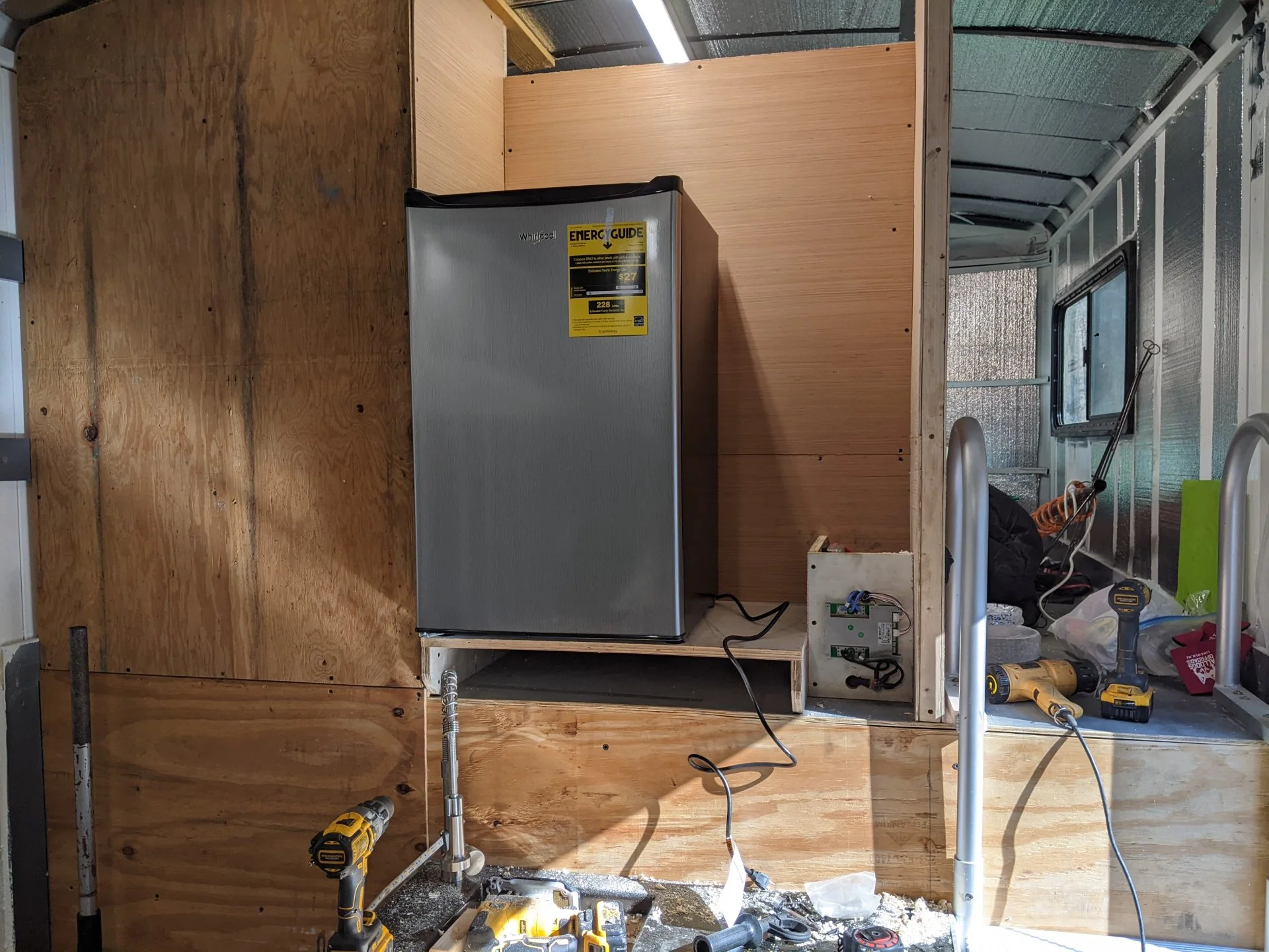

Fridge installed, battery relocation finished, working on inverter install.
How many extra fuses are you gonna keep in the box? Askin for a friend...
Zero. Wire and fused for 130a, but the bms cuts off at 120a within 3ms.

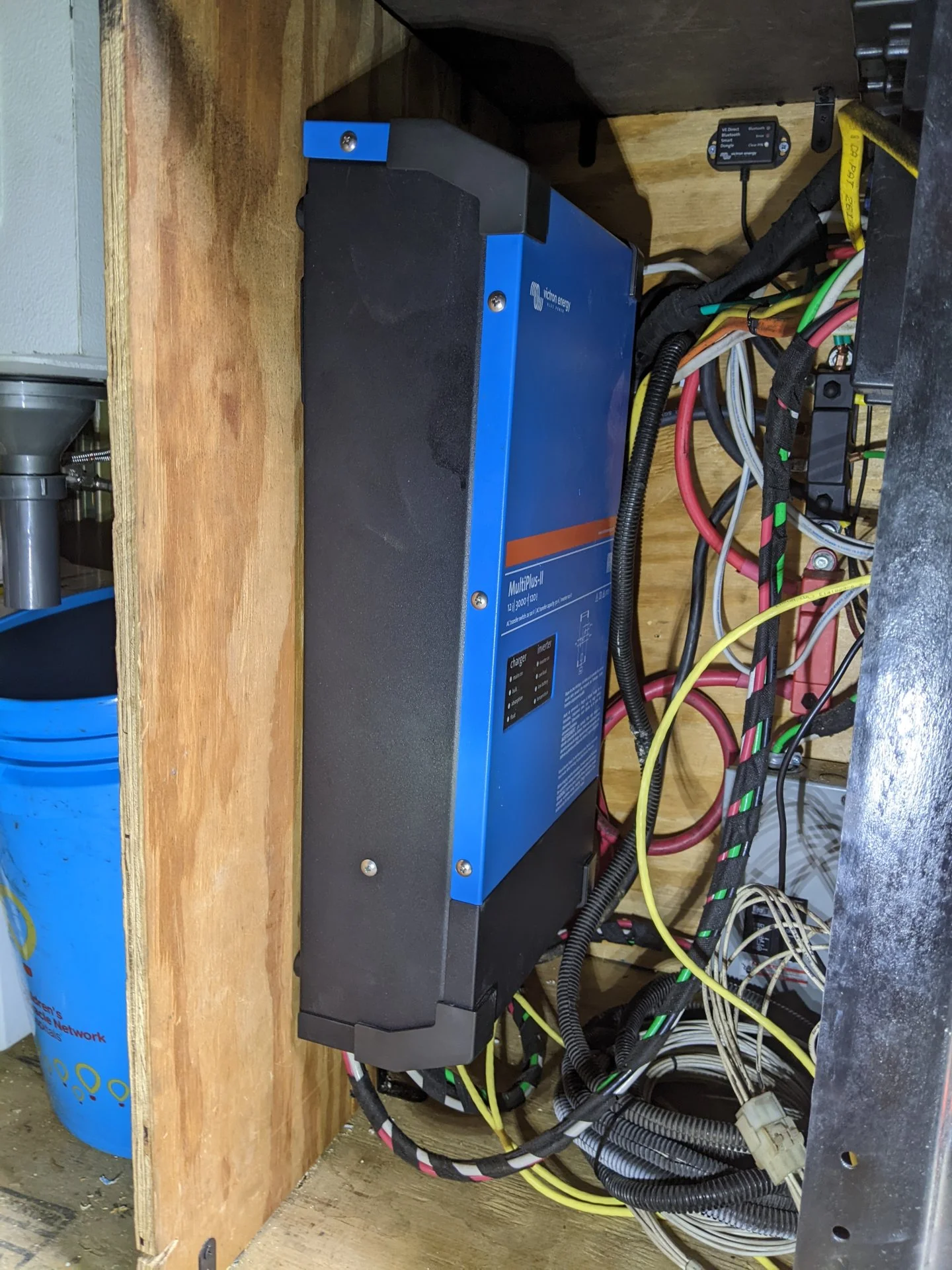

Inverter in and working. Pretty stoked, but it was a challenge to get it all to fit. Lots of wires in a very small cabinet.

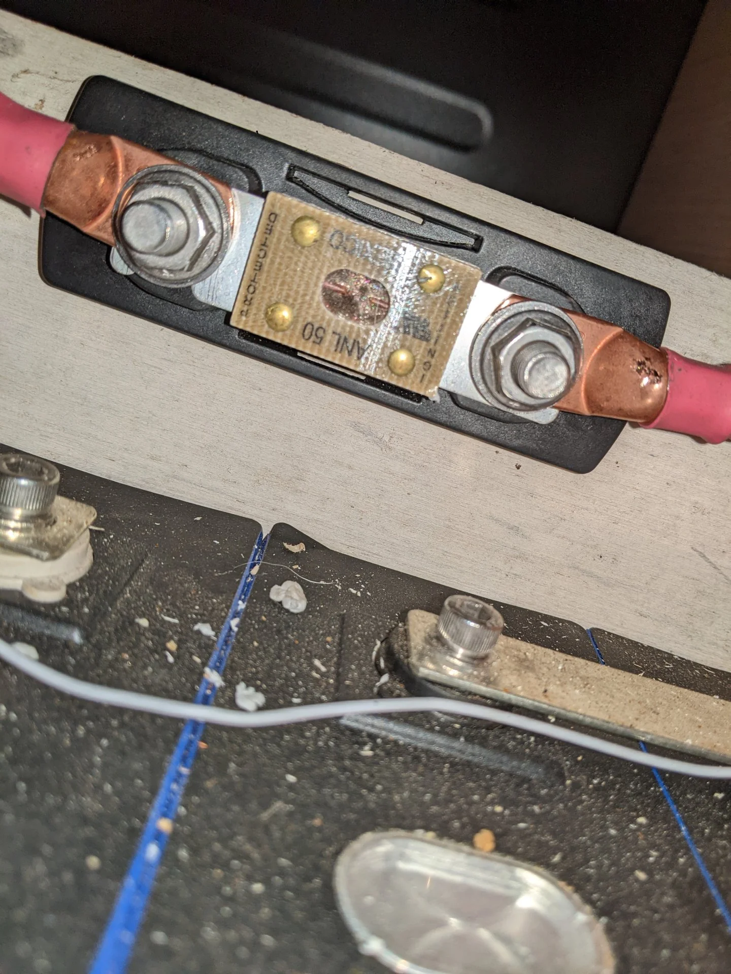

While playing around with switching things with the inverter, I turned on the rooftop Ac and ended up popping the temporary 50a ANL fuse protecting the battery. The permanent 130a fuse is en route, but it was exciting to see everything 120v running off the batteries for a bit :D

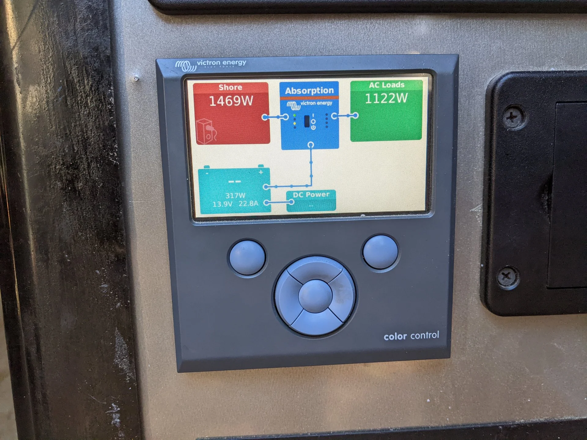

With a new 130a ANL fuse, everything is working as expected. This display allows me to see what the inverter is doing and set settings. Nice to finally be able to use it!

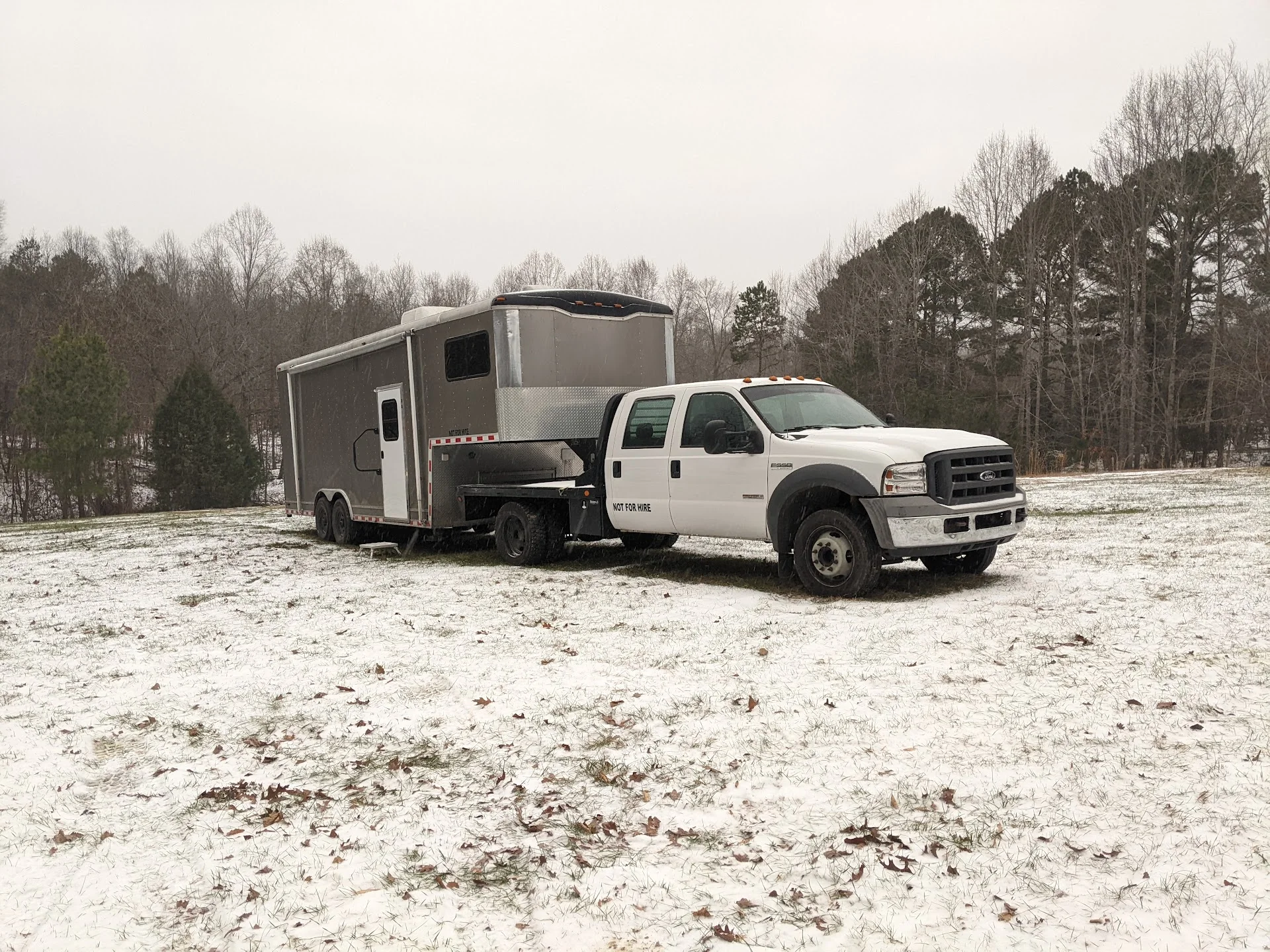

Took it camping a couple of weeks ago, woke up to snow:

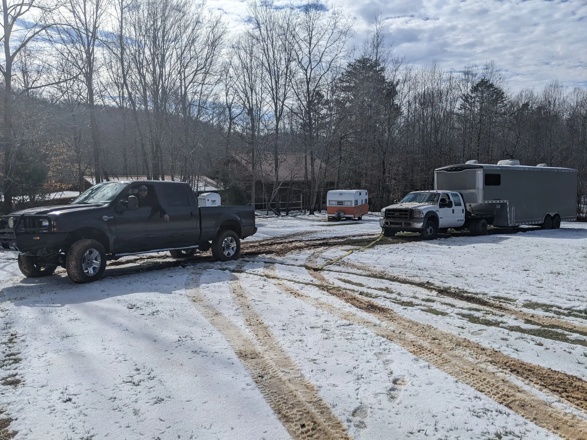

Waited three days for the snow to melt (it didn't) and it was a dumpster fire getting out, lol. @SFROMAN saving my ass as usual :lol:

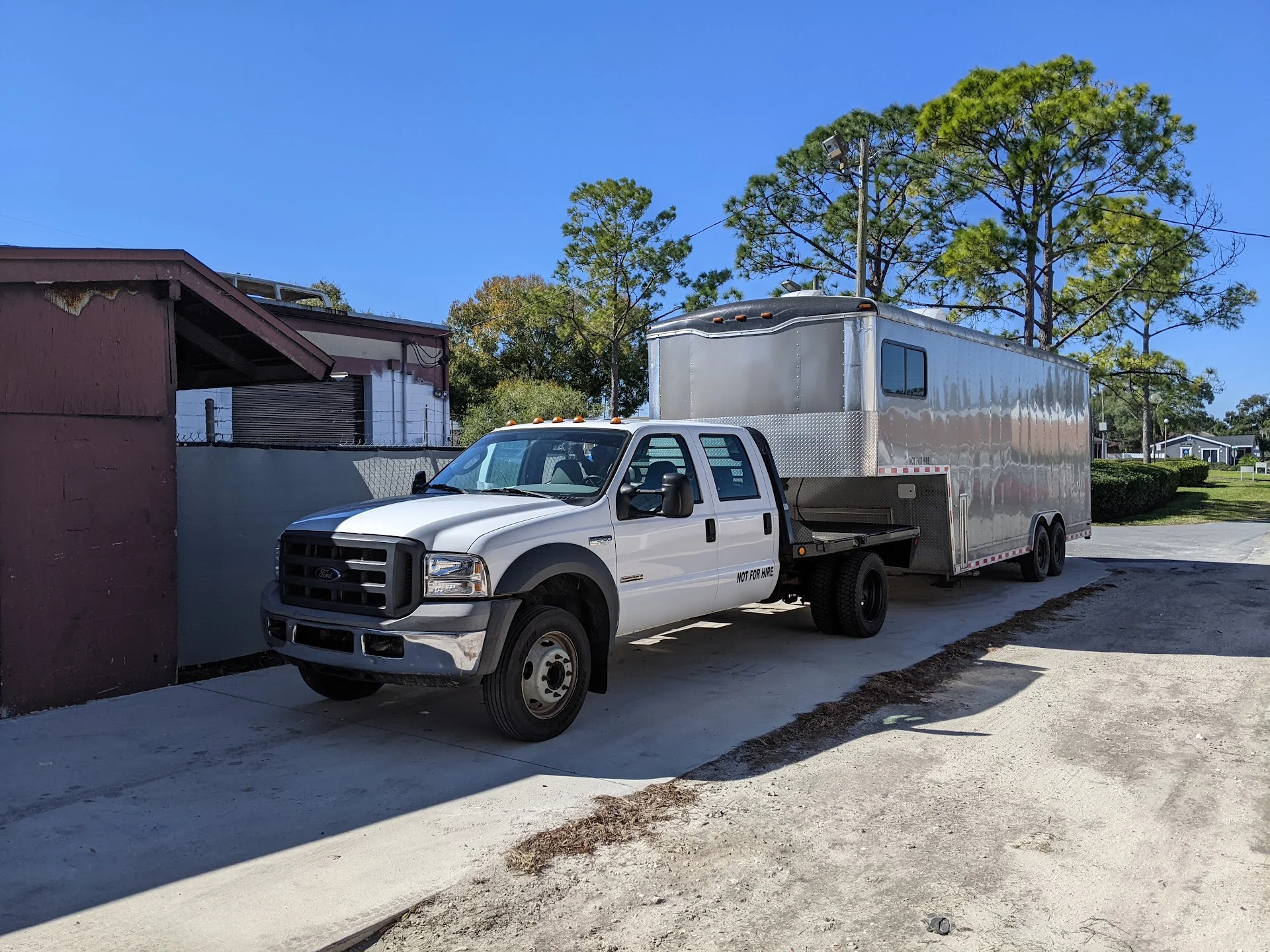

Just got back last night from a trip to Winter Park + Daytona Beach FL to visit a buddy and see the rolex 24.
Camped at my buddy's shop:
