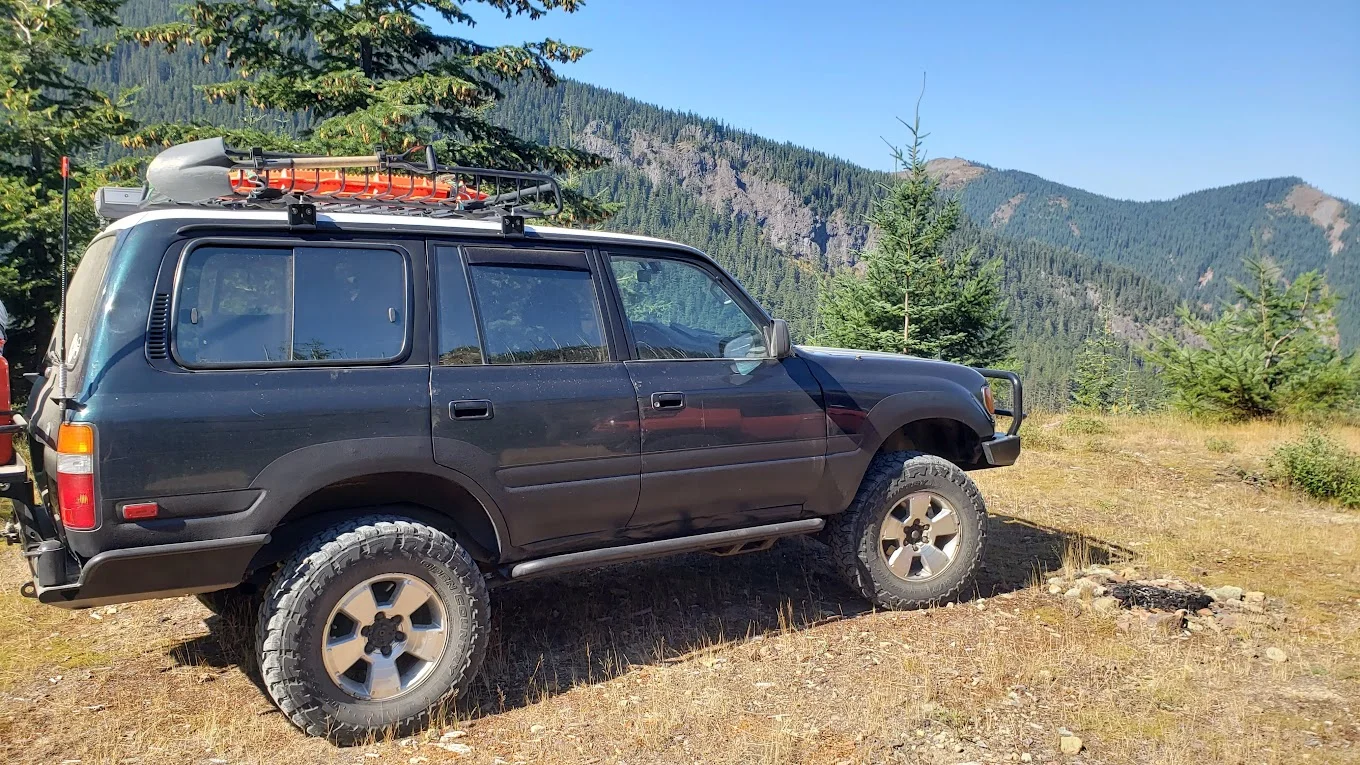

Here's mine
The color is Killer Bee
@Broski yours has been that way for a while right? I forgot. Looks good.
