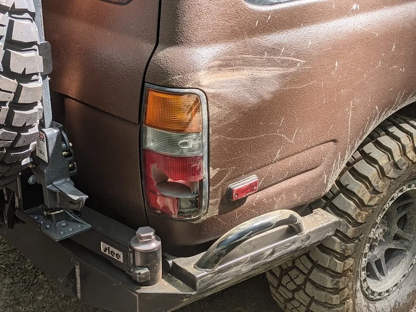

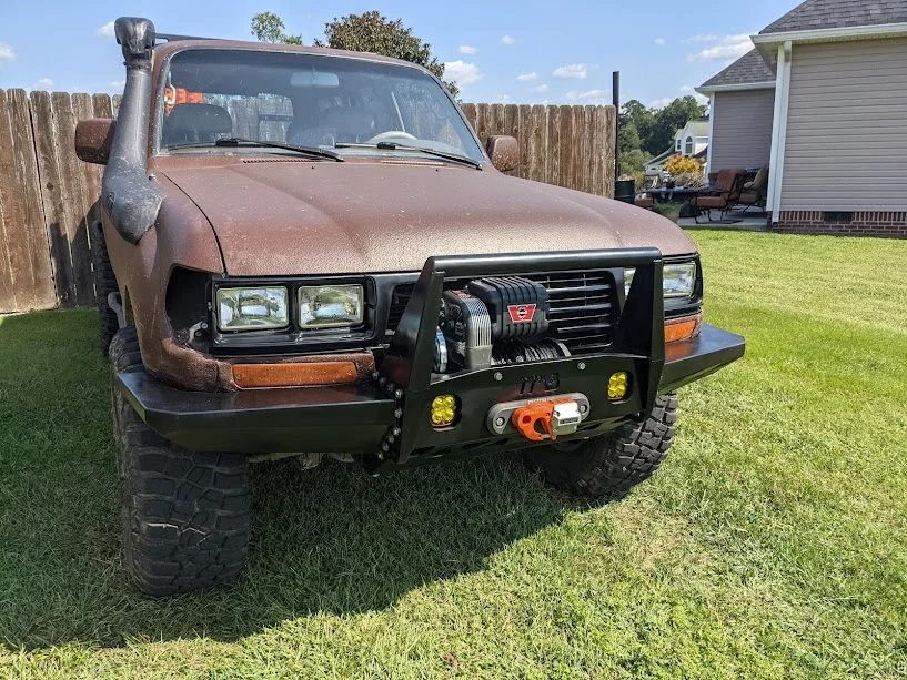

This stuff is amazing, I've added 4-5 dents and tons of scrapes and the monstaliner is holding up great! Sadly the rear quarters, tail lights and headlights aren't as tough...lol Got my front bumper installed so hopefully my quads will hold up better moving forward.
I sanded the grill and quad buckets with 180grit and sprayed them with satin black to keep with the black out theme (krylon colormaxx - after spraying with self etching green primer).

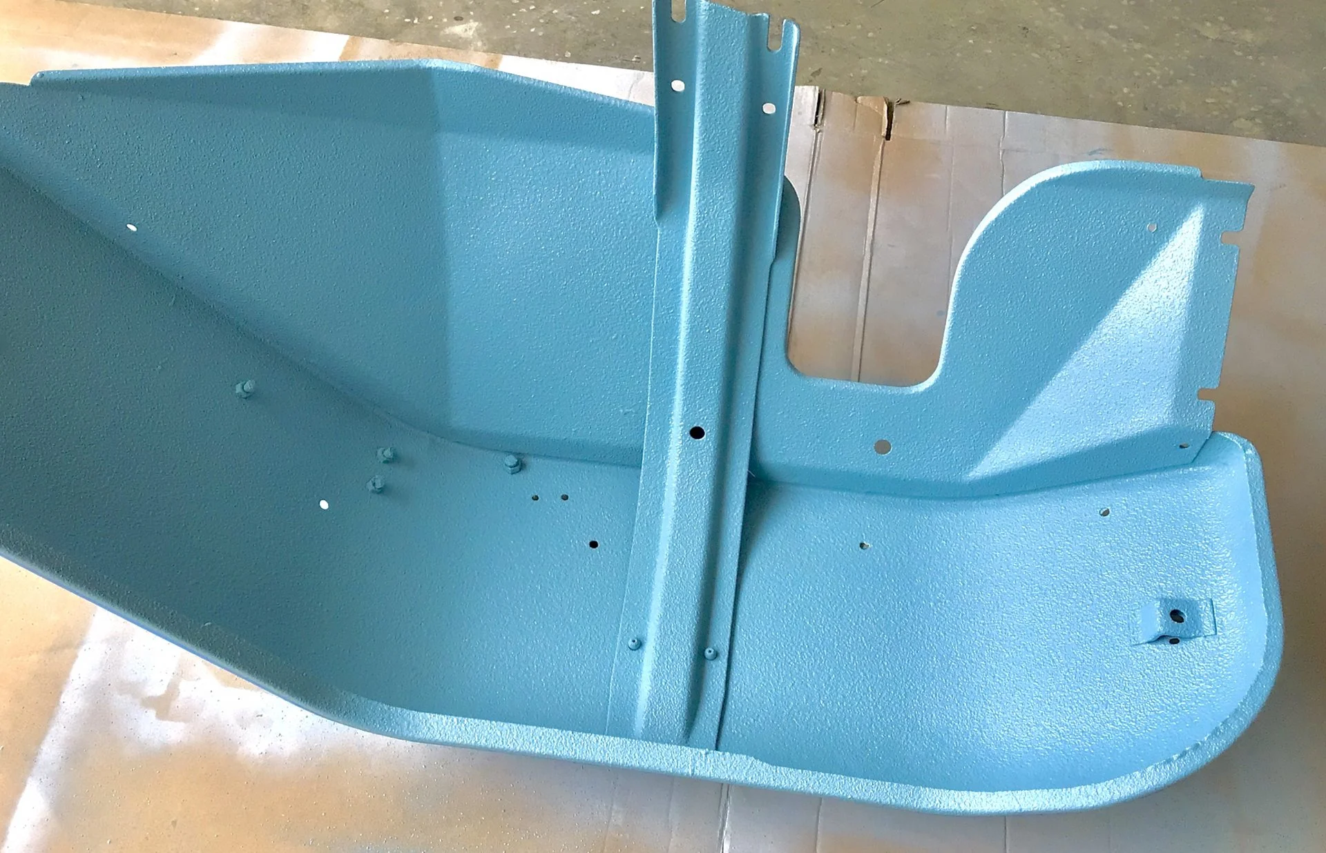

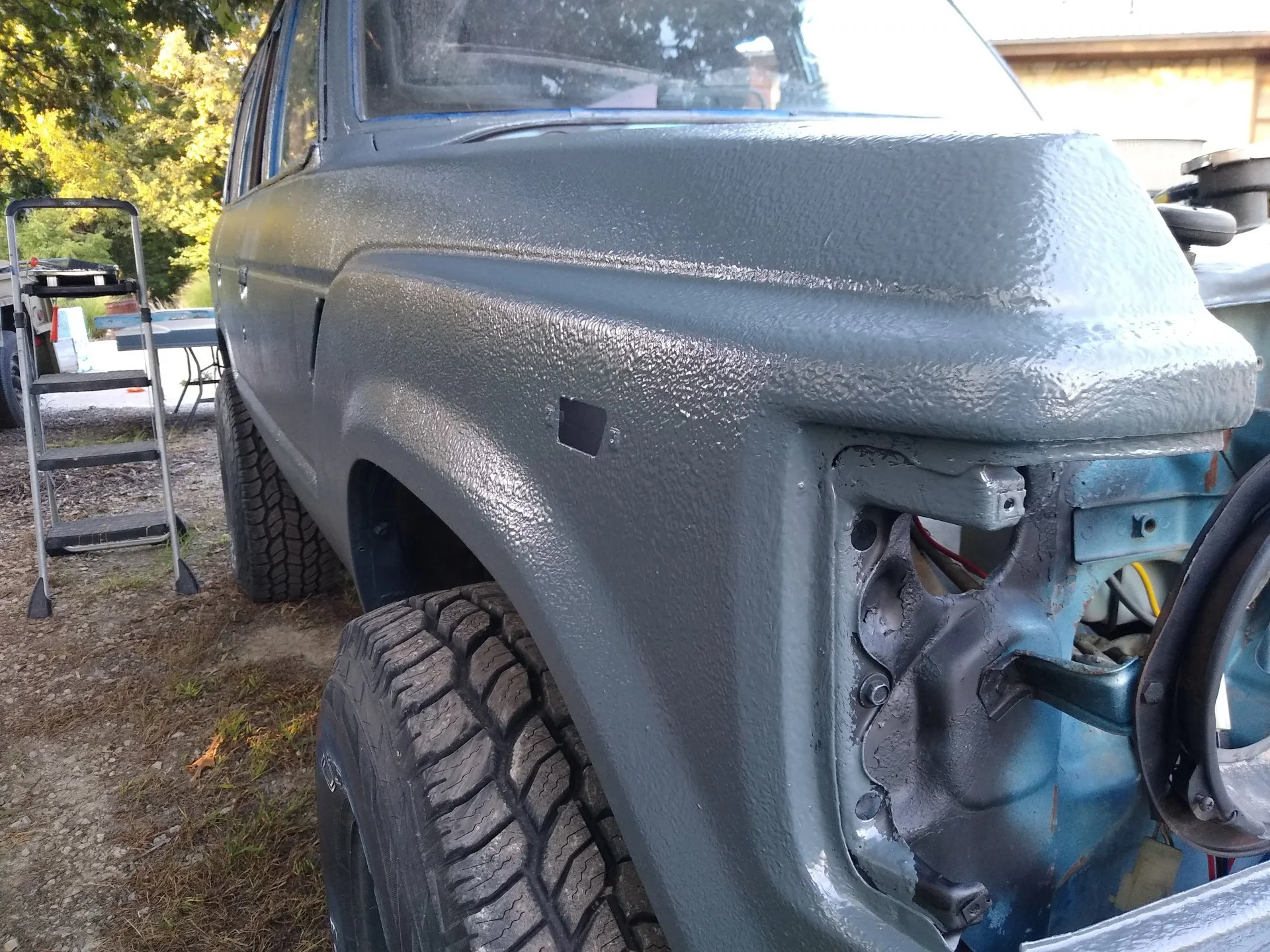

front fenders. after playing around with a bunch of different angled attachments for the schutz gun i decided to brush on the liner under the fender lips in stead of fighting to spray under there. after a couple coats, i then went over everything with the gun - turned out much better

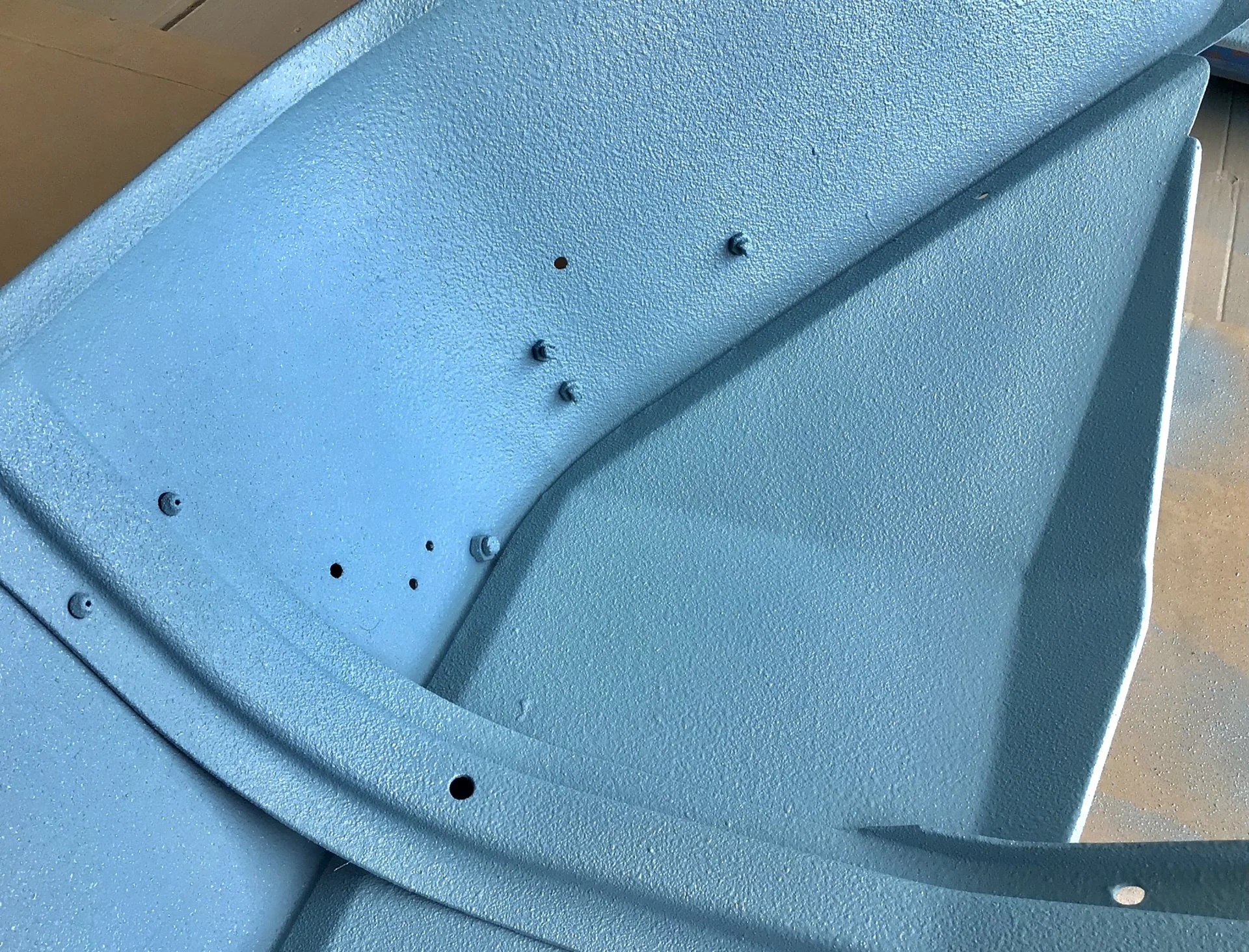

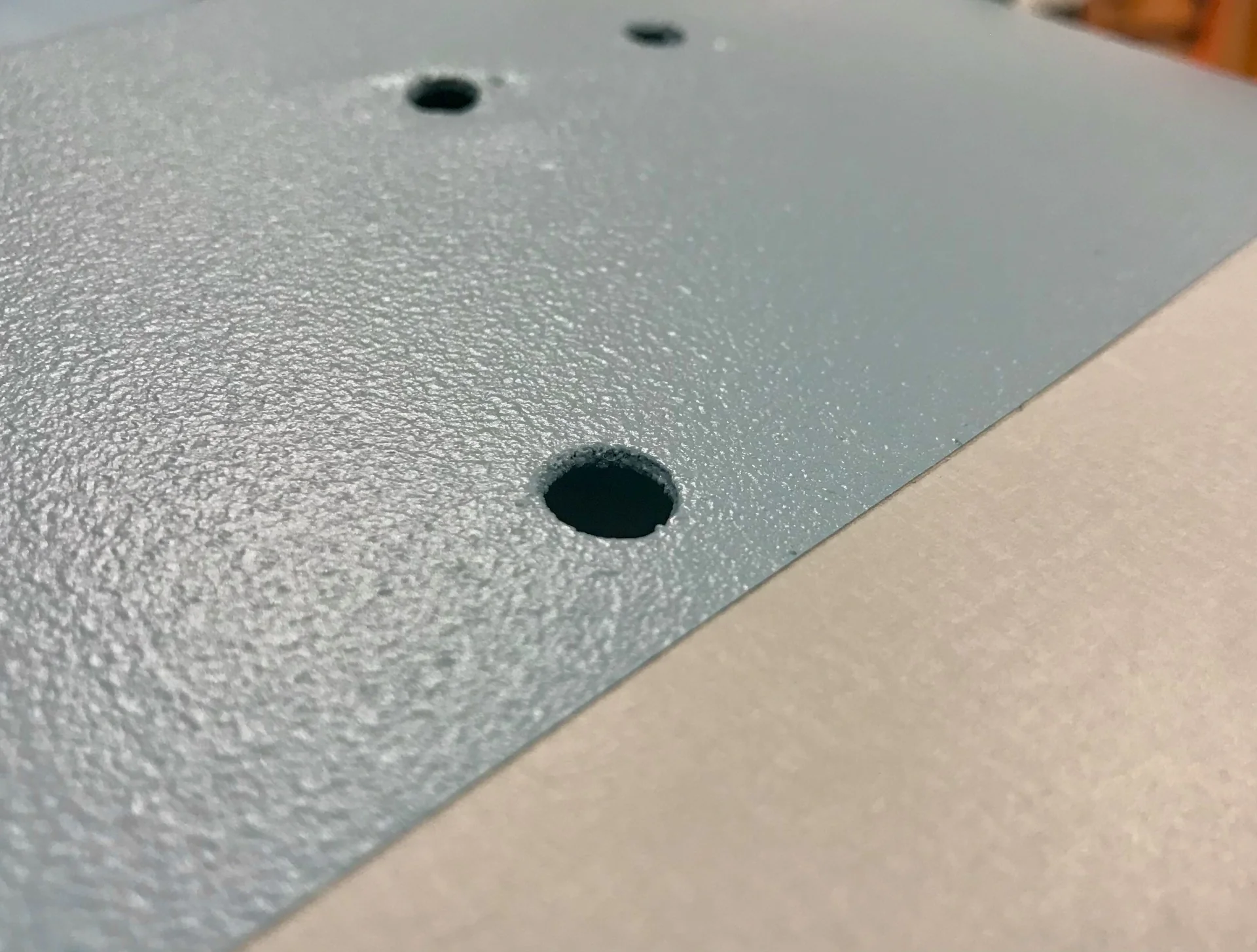

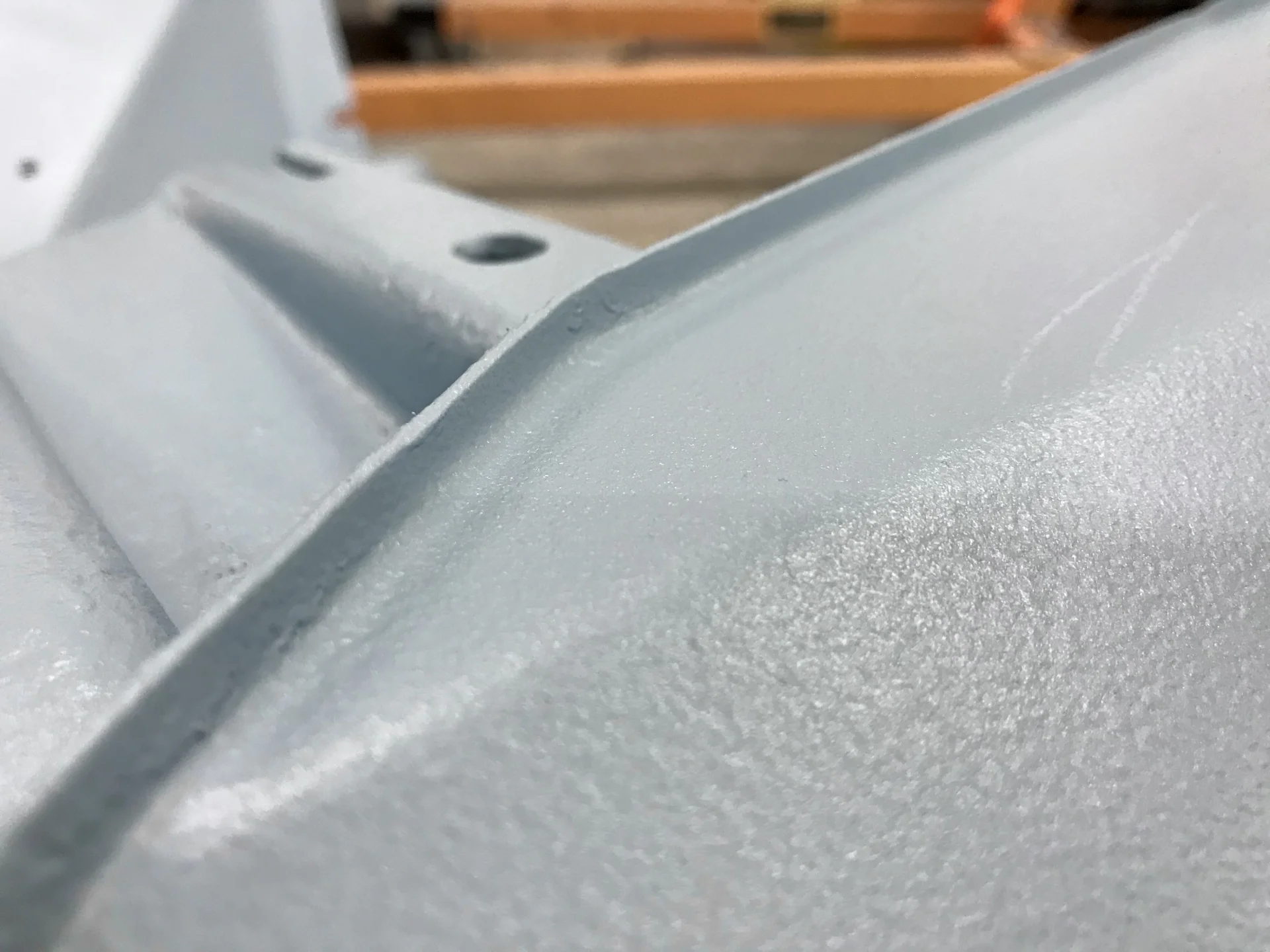

i'll double post this just in case there's someone outside of the 40 forum that is interested. here is the inside of the fender with the liner thinned a little, sprayed out of a modified HVLP gun (drilled out to 2.0mm) at about 35psi. it's slow spraying it out but could achieve a more uniform coverage and finer texture
