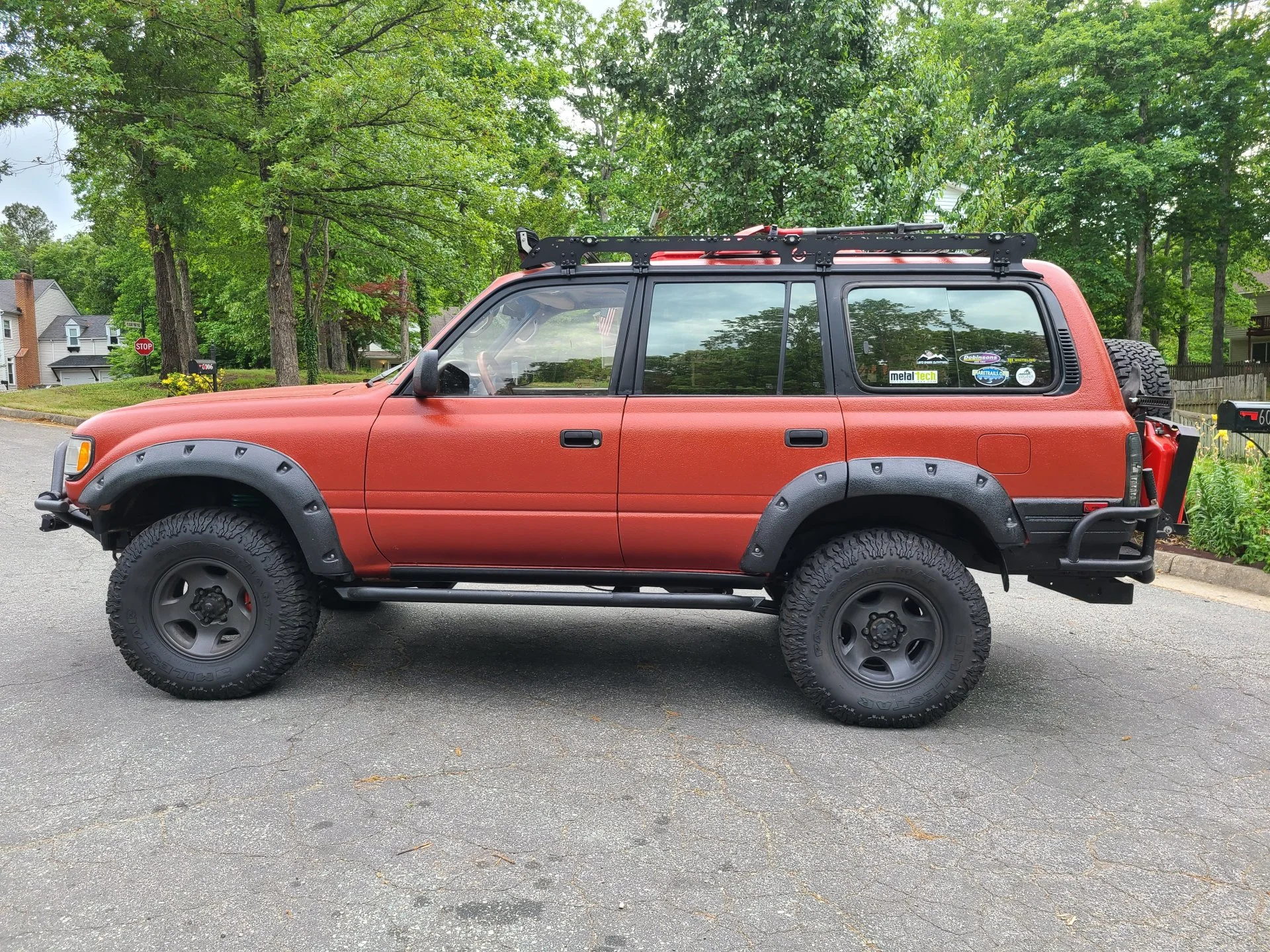

Finally finished painting my truck with custom tinted Rhinoliner. Took it wheeling last weekend through very narrow trails with lots of bushes and trees. All the other drivers had scratches on both sides of thier trucks, not a SINGLE scratch on mine. Very Happy with the overall finished product. I love it when people say "you will never be able to resell your truck". My answer to that- When I am dead, I could care less if my estate has hard time selling it. They can bury me in it as far as I am concerned. Just as long it's on top of a mountain 😀
Looks good. Im on the edge of keeping mine when I retire to Japan. They already told me ill need fender flares. Been eyeing them for a while. Hows the install and what do you think about them?
I would think you could find good flares in Japan. I like the look of the flares, but they definitely don't fit perfectly and it was a chore installing. I sprayed them with black Rinoliner which makes them look alot better
