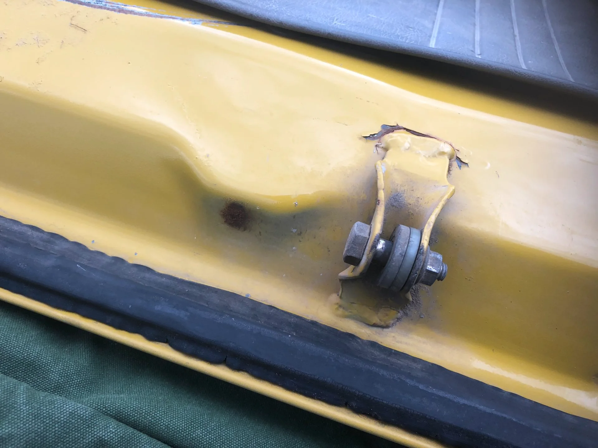

I was not aware of the dome light bump. I have the bump, but no switch! What does the switch look like on the tub?
Dome light that operated off a switch on the A pillar is different. It requires second wire going thru the windshield frame then across the door header. The dome light has a three position switch not just two.
I found a couple pictures with mount for the A pillar switch. Switch itself was used on other Toyotas.
My NAS '83 FJ40 and all of my Aussie '81 and newer 40 series also have a dome light cut-out on both B pillars with the passenger-side one covered by a plastic blanking plate. Interestingly, the Paki Pig only has a cut-out on the right and no pin mount on the A pillar (though it does have the door-side bump) despite being an Aug '82.
