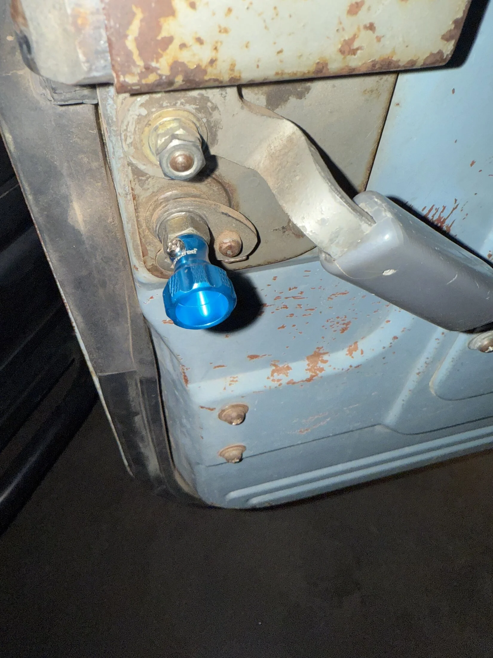

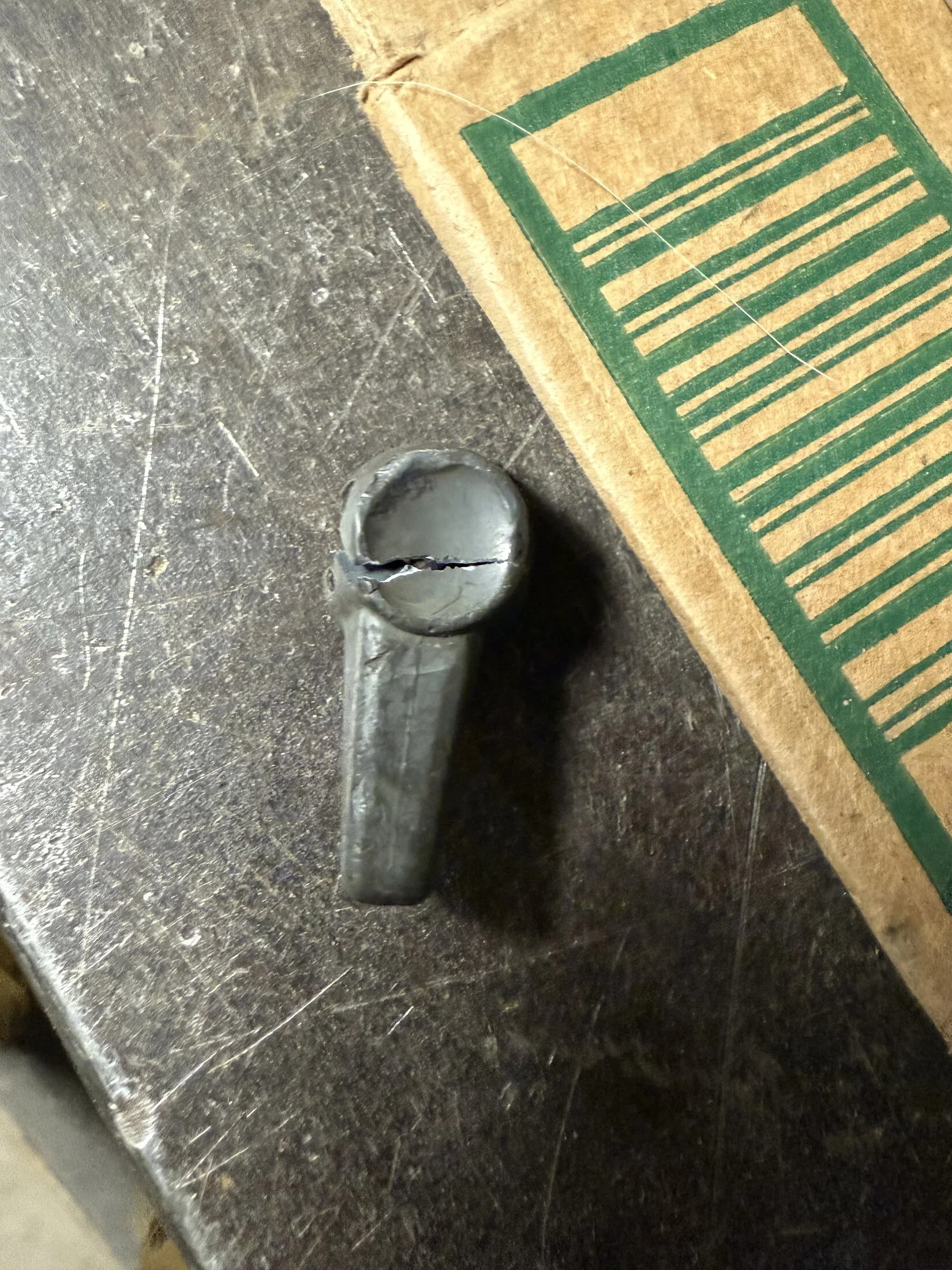

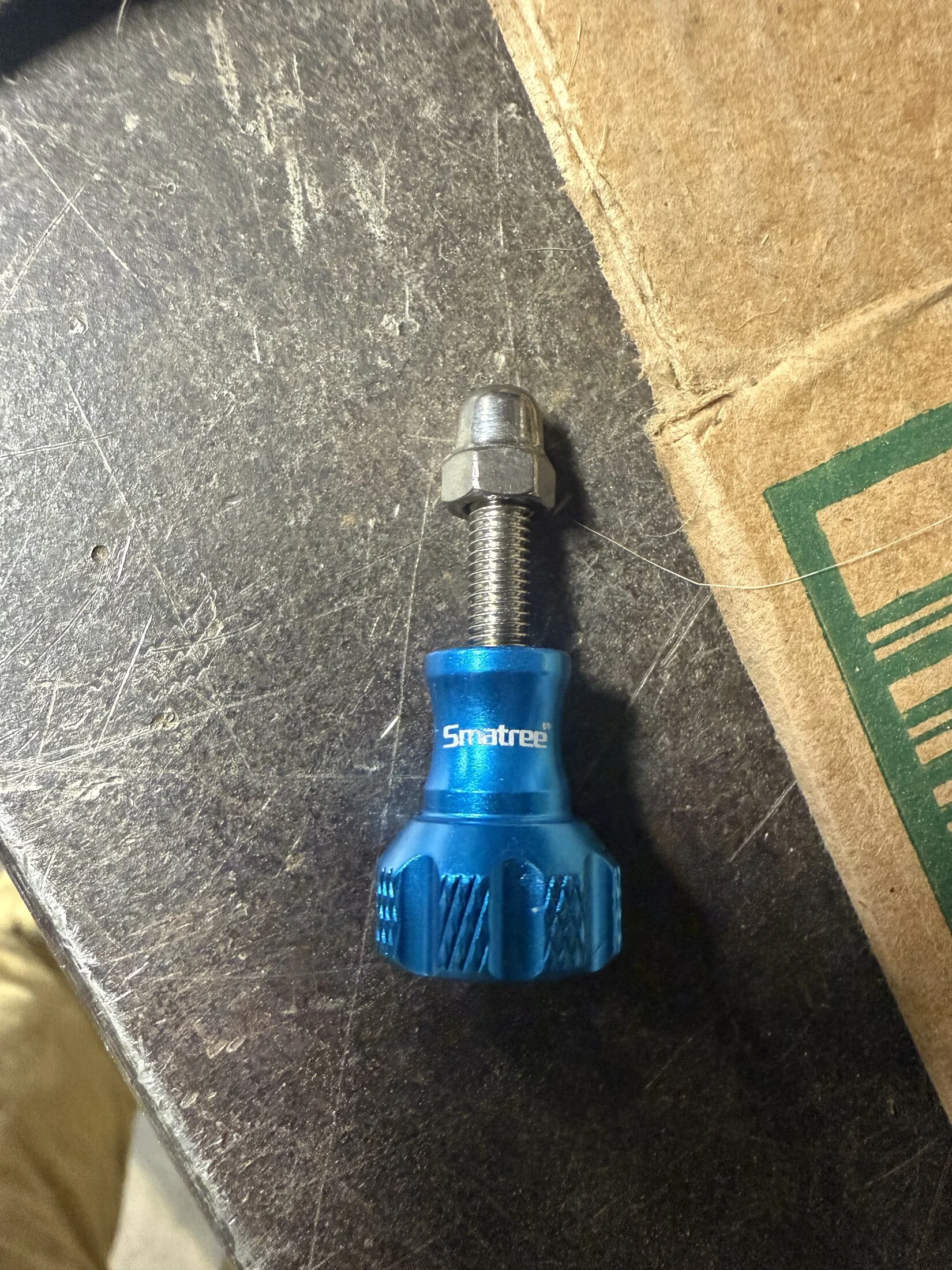

The original plastic lock lever split today.

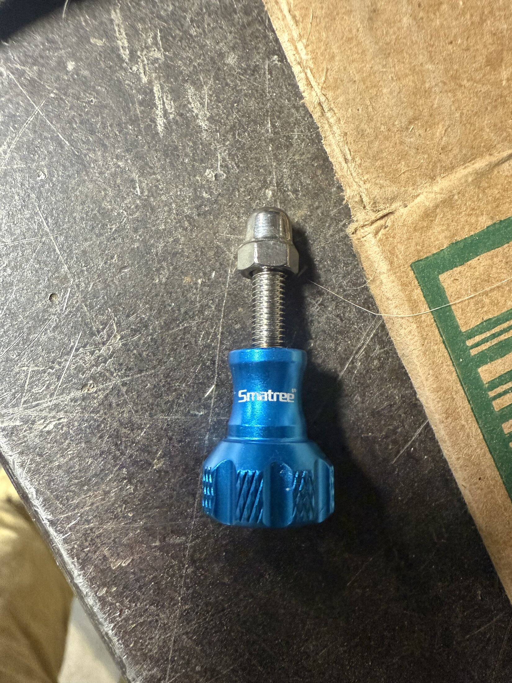

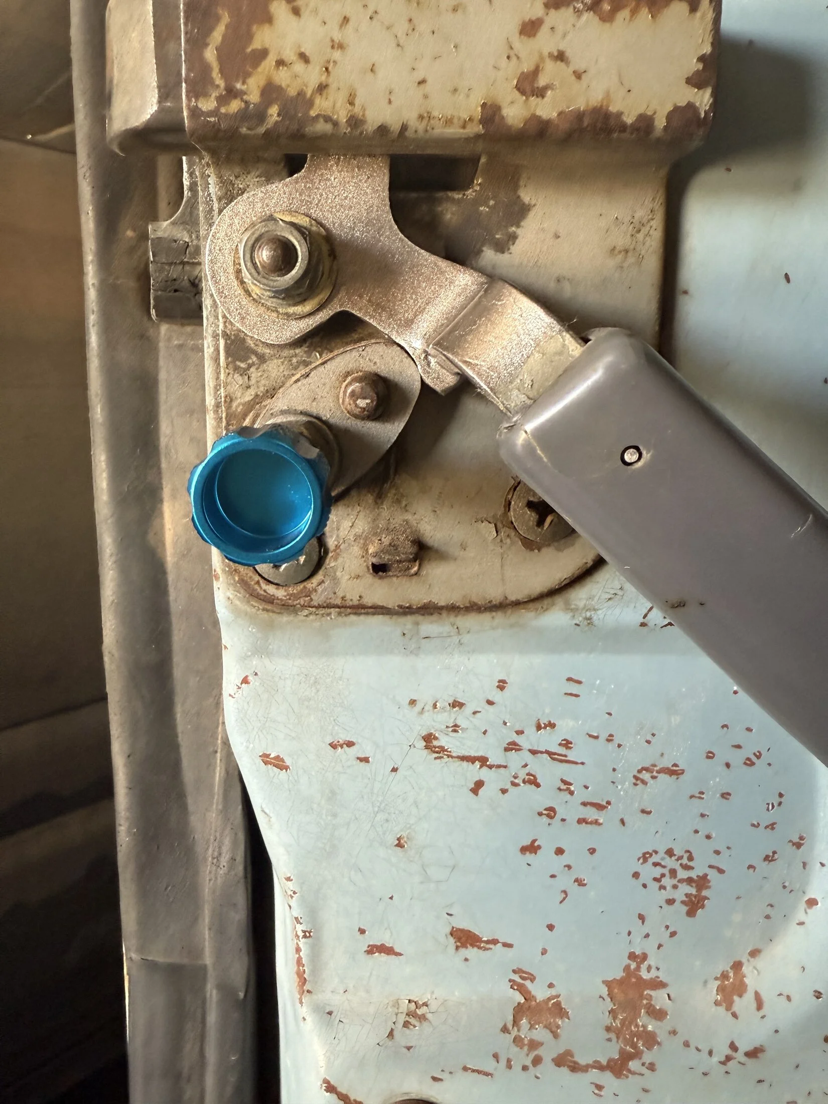

I needed a fix to be able to lock the doors. I had ordered these blue aluminum knob’s (Smatree) off of Amazon a while ago but never used them.
I attempted to turn the stud out but it snapped off, So I drilled it out to fit the lock shank and then drilled a hole for the set screw. I did this for both doors. They will work until I find something better.
Seems like someone should be able to 3d print those? Good solution until then though.

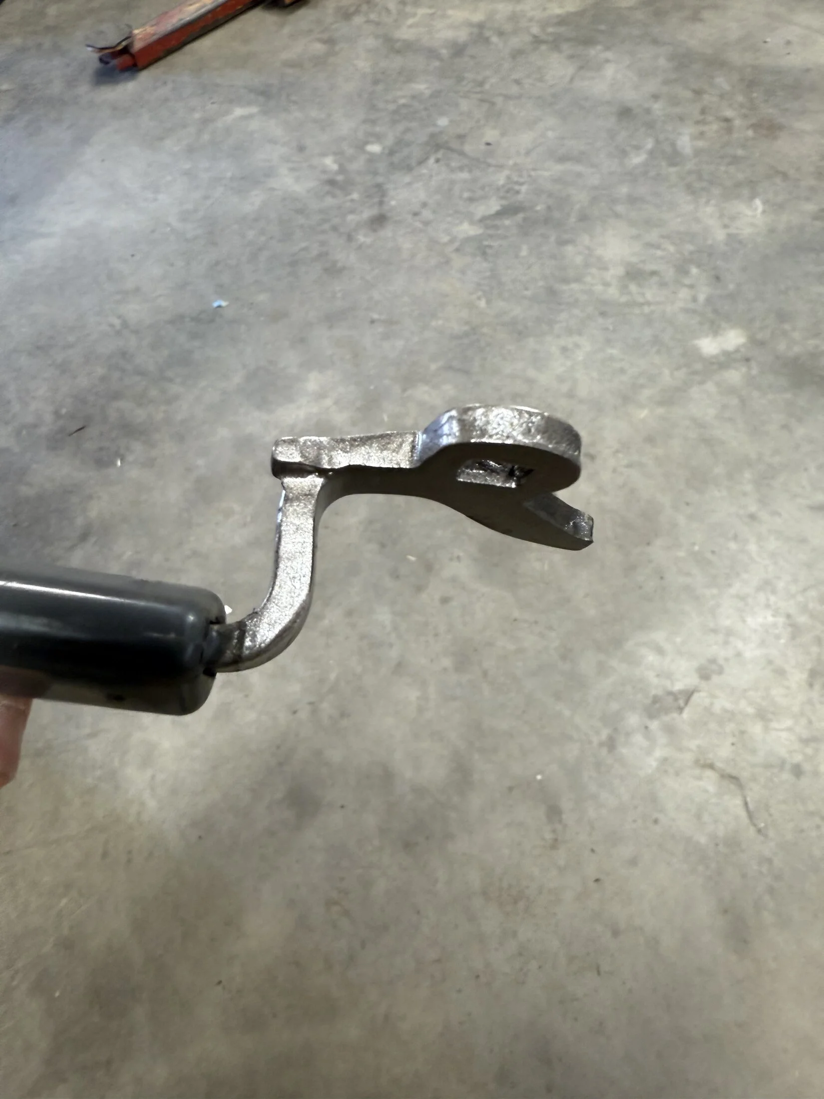

I could not lock the driver door with the key after removing it. Every time I turned the cylinder just enough to remove the key it positioned the stop just right, so the door handle could force it down to open the door.
Before
I welded a little catch to the door handle to prevent the lever from turning the stop down after the door is locked with the key removed.

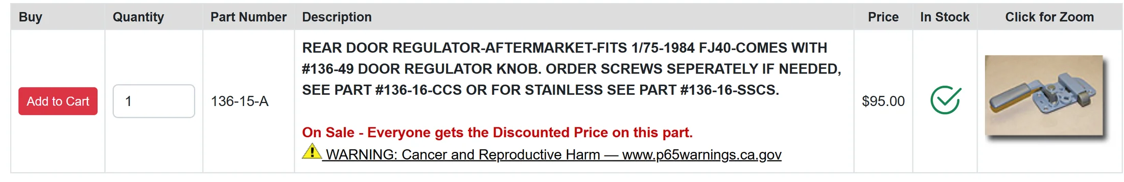

That part could be a problem for the split ambulance doors if it is not available.
