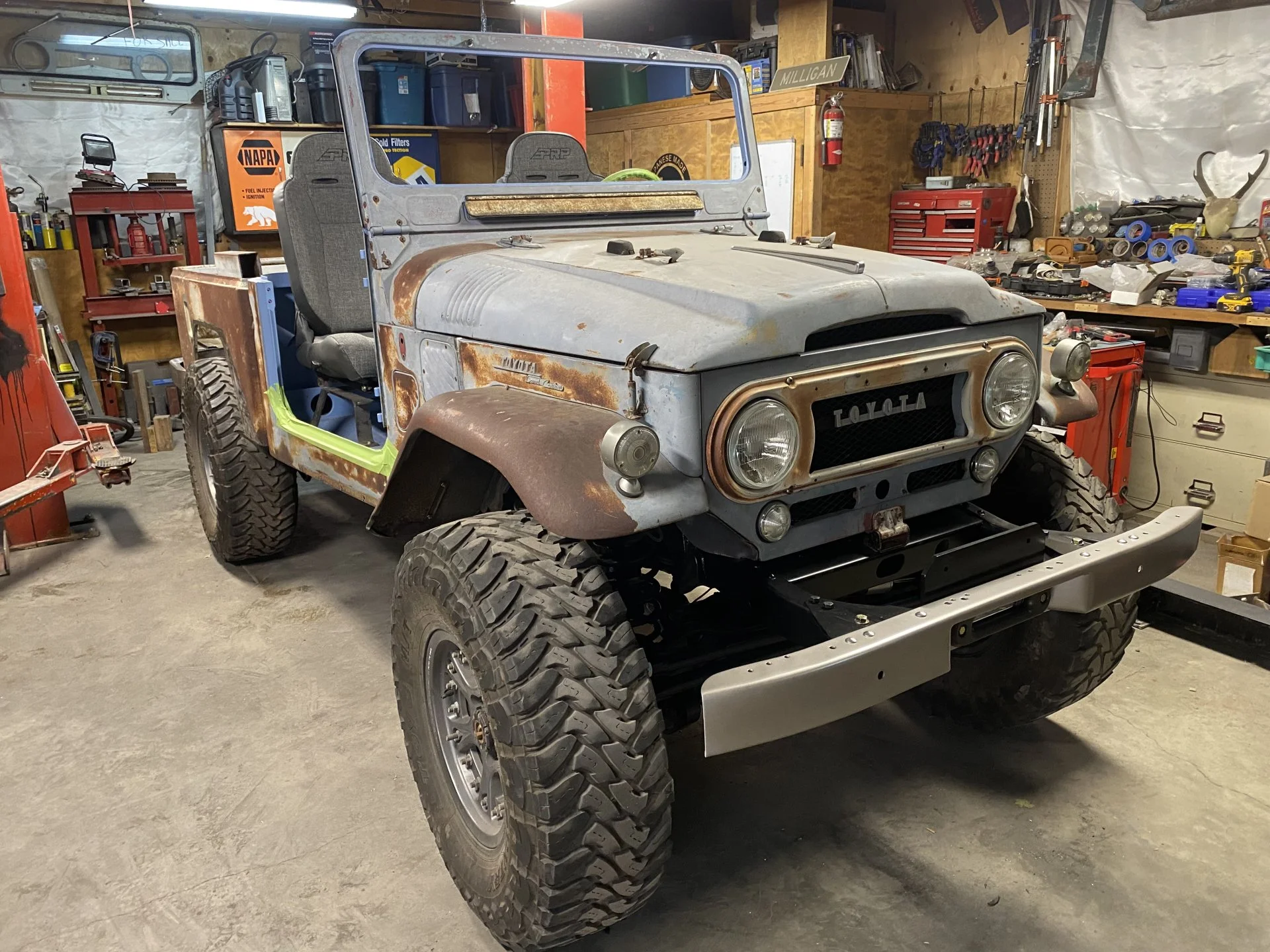

Today was the day. I got the 45 together enough to take it for a short drive. I have been adding and working on pieces of the build that I will share shortly but today didn’t go as I had hopped.
Here is ready to go.
I turned the key and if fired right up ready to go. When I put it in gear it got shy and wouldn’t go. I tried every gear, high and low rang in the transfer case, activated the CDL, and tried various combinations of all. The engine changes RPM slightly as if engaging the transmission under load but it doesn’t do anything.
The little trouble shooting I did was check the harness plugs to confirm everything is plugged in.
Regardless of the shifter wiring my general thought process is that as long as I physically shift the shifter linkage into drive it should at least go into drive. Please correct me if that is not correct.
If my above thinking is correct then the issue must be in the transmission. I bought the transmission off of eBay 5 years ago advertised as having 139k and in good condition. So I have no confirmation that it is good.
Thoughts, what should I look at before I have to pull it out? I appreciate the help in advance.

Did you check the transmission fluid level while it was running and in park? Sounds like it may be low on fluid.
I did not but I had filled it previously after running it. I will check it again while running it definitely could be low still.
Well, adding fluid would have been the easiest fix. Heck that is exactly what it needed, thanks @Bripars40, it wasn't low by much per the dipstick but I topped it off and it wants to go in drive and reverse. Sadly the sun has gone down, so the test drive will have to wait until tomorrow. I suppose I will take some fluid with me for the short drive just incase. I am not sure how long it will take to fill the torque converter if it is not full already. Awesome, can't wait!

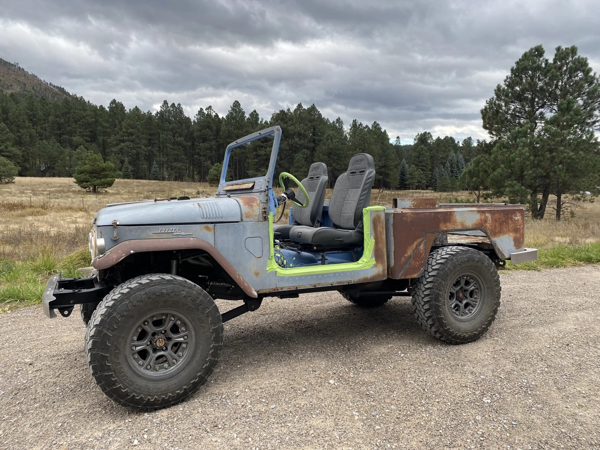

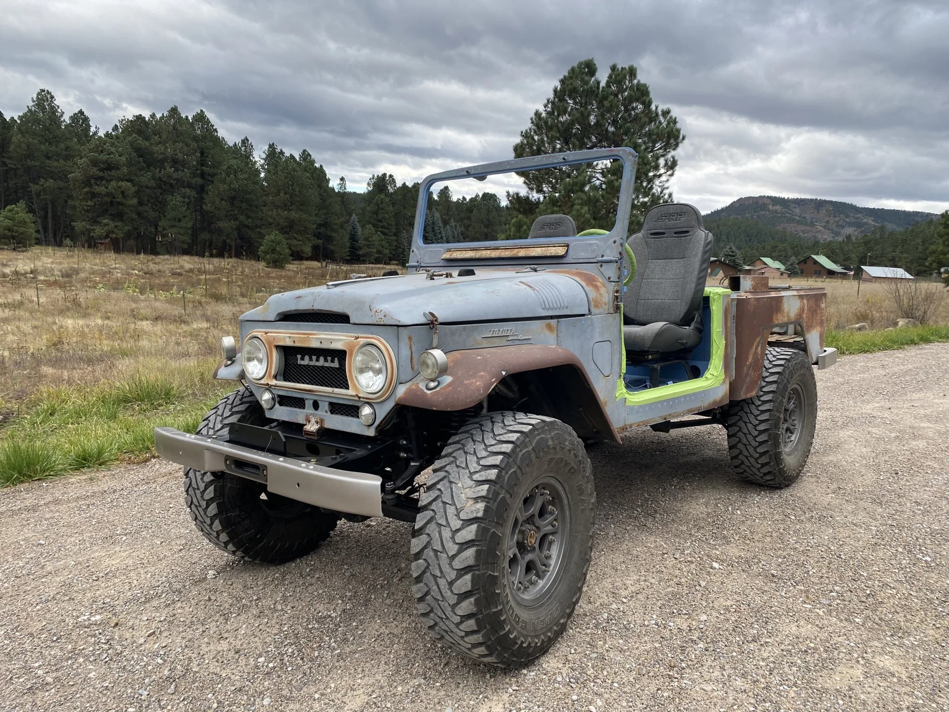

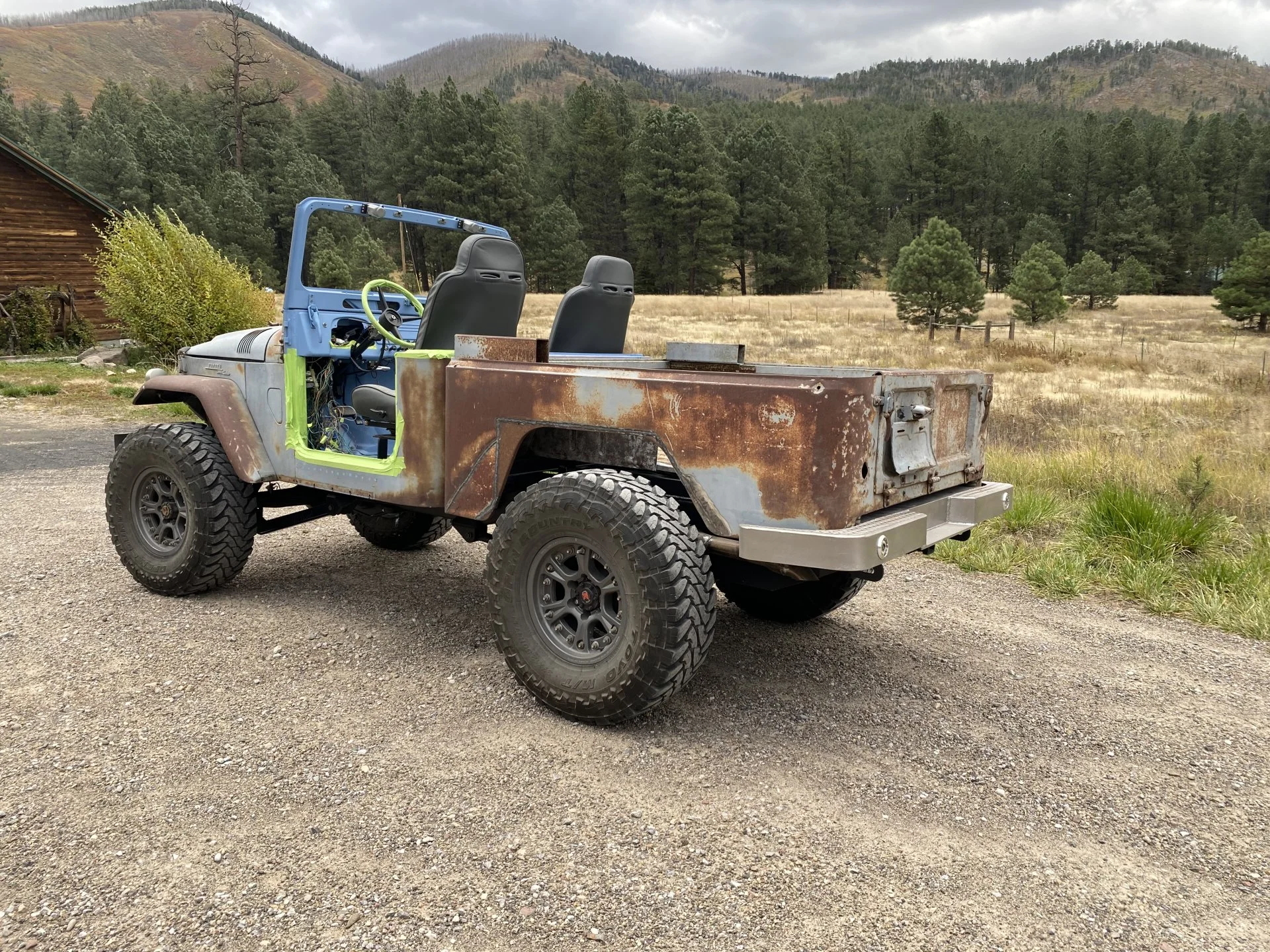

The wind is blowing like crazy and it is 43 degrees outside today but it is an awesome day to go for a drive, so I took it into the wild on it’s first drive. It is pretty awesome! It seems the shifter is working in all gears, so I can move past that.
It moves pretty good. I drove it out to the end of the road and put it on pavement to take it up to speed. It did great, nothing seems to be leaking. It has a slight smell but I think it is the exhaust burning the ceramic coating. The brakes work great but I think I will adjust the pedal height to make it more comfortable.
I took a video, it is pretty crappy, the wind is blowing pretty hard and the bed held on by 4 bolts is rattling. If I decide to post it I will add a link here.
Here it is outside

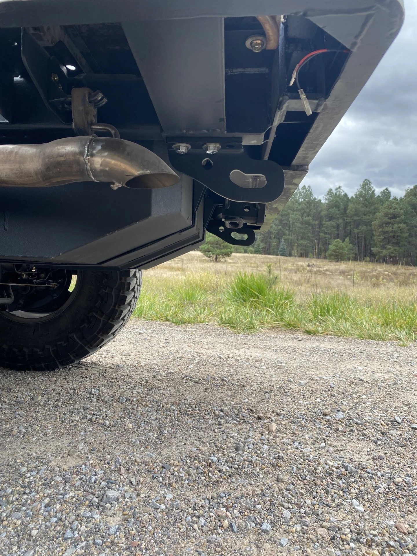

When I built both bumpers I made sure the bottom bolt pattern would line up with 80 series recovery mounting points. I purchased shackle mounts for the front and rear, then painted them because I didn’t like the orange. The mounts in the rear have well placed hole the I eventually intend to use to mount a skid plate for the fuel tank.

Only seeing this now and happy you got it sorted. Had the exact same thing happen to me when I went for my first test drive. The torque convertor really takes quite a bit to refill and it took me a while to get the box full enough to engage.
