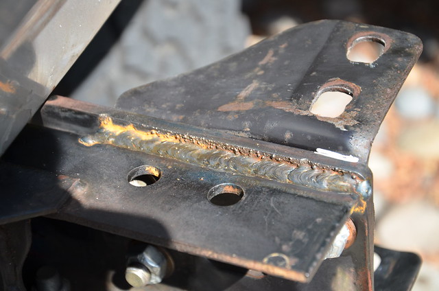

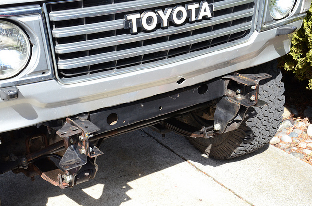

I worked with my friend in the welding class at my vocational school on Thursday and Friday to get the shackle reversal welded up, and today I finished working on the bumper brackets, and mounted the bumper for the first time since the previous owner put the lift on the truck.

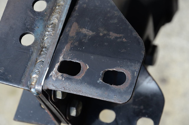

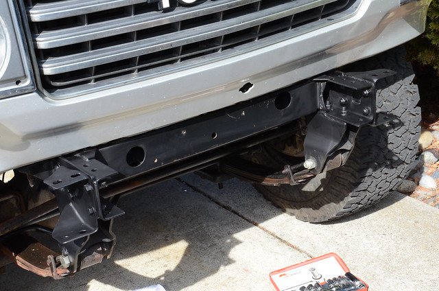

In order to get the bumper bolts to line up with the holes in the brackets I had to make them into an oblong shape. In cases like this, its rare for me to have the right tool for the job, and this was no exception. What I ended up doing was drilling a small hole, then using a drill close to the correct size and fileing the crap out of it with a round file to bring it to the final shape. When that was done I cleaned the area up with some degreaser and a few shots of compressed air. A few coats of flat black paint later and it was ready to put the bumper back on.
A quick polish of the front bumper's chrome, and a scrub with a Mr. Clean Magic Eraser and a splash of Armor All for the plastic end caps, and I was done.

One of the welds. It rained last night so its got a little surface rust on it.

The result of my drilling and fileing.

Welded, drilled and ready to go.

Fresh coat of paint.
