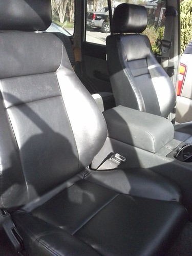

Recently I added ProCar seats. They are considerably more comfortable than the flat and worn out stock seats
After a week or two, I realized that black vinyl gets REALLY REALLY hot when you park in the sun... so I got some cheap seat covers. :)

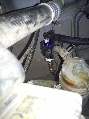

Today I did a little tinkering with the ignition timing (I play around with it waaaaaaaay too often, and when I did it last week I forgot to disconnect the vac. advance lines before setting it. so it was waay too retarded. :doh:) I also replaced the PCV valve, and added an oil separator to catch any oil before it goes into the intake, hopefully helping keep the engine cleaner in the long run.
When I changed the PCV valve, I expected it to only take a few minutes, but the rubber grommet/gasket was cooked solid and broke off at the barb, leaving from the barb down lodged in the tube... so it took a while to dig out with a knife.
Wow those seats look great! Easy install? Cost?
Serious seat envy here
Super easy install, just unbolt the sliders from the old seats and put them on the new ones and install the seats. Cost is around $600 for the pair, although I got them when Summit Racing was having a sale and was able to get them for about $570.
