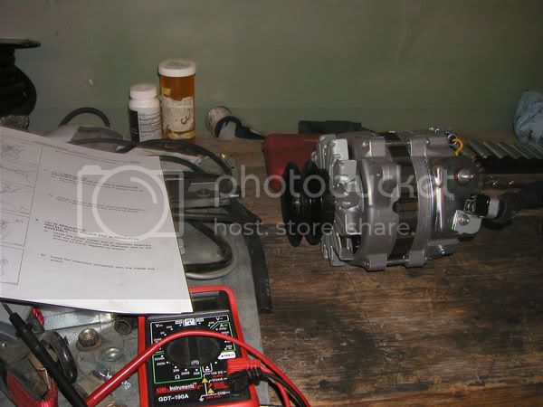

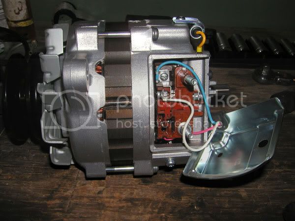

Yeah I ordered the part from him. It was either 6,615 yen ($67) through him or $155 through my local dealer. (The 12HT and 3FE use the same stator.) Don't know what the shipping will be but I think it will be less than $100. I think I'll order the alternator through the dealer. It is a 12v 80amp alternator. There is apparently a small body alternator that works with the AC bracket and a large body alternator that doesn't. (This info is from Stone's thread.) But the EPC and ToyoDIY.com only list one part number for the 12v alternator so not sure if the alternator from the dealer will fit but from the diagram on the EPC & ToyoDIY it looks like it should.

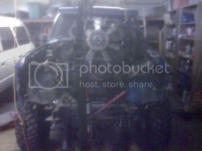

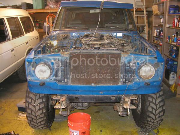

Finally got the 2F/h42/split-case removed. Amazing all the little things that you have to remember to disconnect. Here are a few crappy cell phone pics. Lagwagon is rebuilding a 38mm split-case to put on my 12H-T/h55. I'll hopefully get the h55/split-case back from him today.
