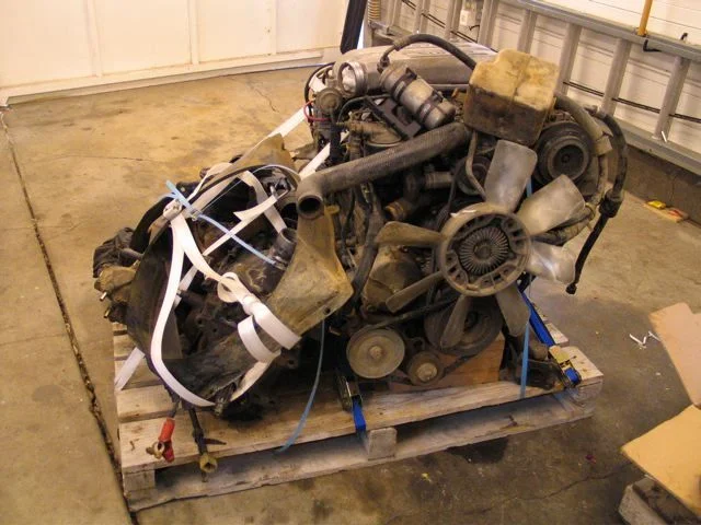

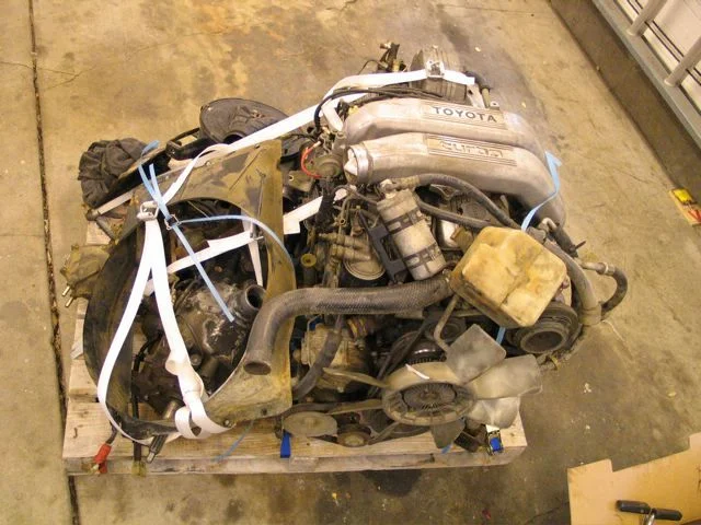

Waiting to be picked up:

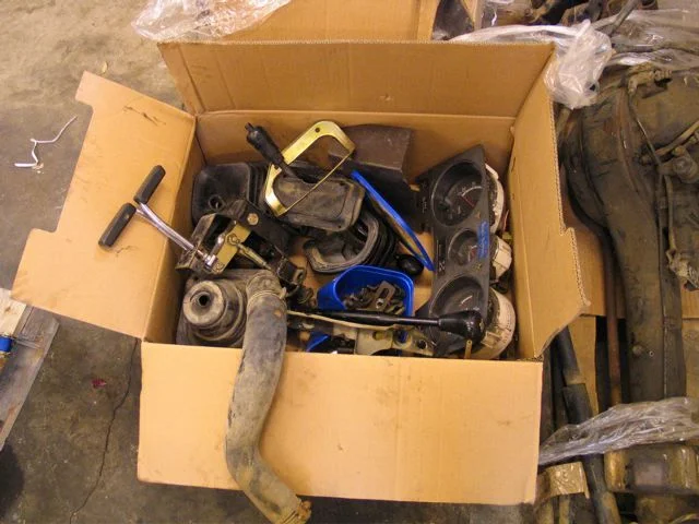

Cool....cable lockers and PTO winch.
You may have to change the shifter it will be offset to the right to much for LHD
No 2F and 2H motor mounts are not the same ..
Nice score in factory lockers levers and PTO .. the engne too are one of the best engines made by Toyota

dogboy2 got the stuff from JDM Wholesale in Vancouver. I also have the instrument cluster but it is 24volt. Can I just replace the 24v bulbs with 12v bulbs and expect the cluster to work?
I've picked up the engine in Portland and it is now down in Davis. I need some help figuring out the relays and how to hook up the electrical stuff. I think I'm going to do the majority of the swap the week of June 22nd. The plan right now is to figure out what else I still need and get everything prepped so it all goes smoothly. I know I need a vacuum canister. The HJ61s used a vacuum canister, right? First thing I need to do is pull the 2F, I guess.
