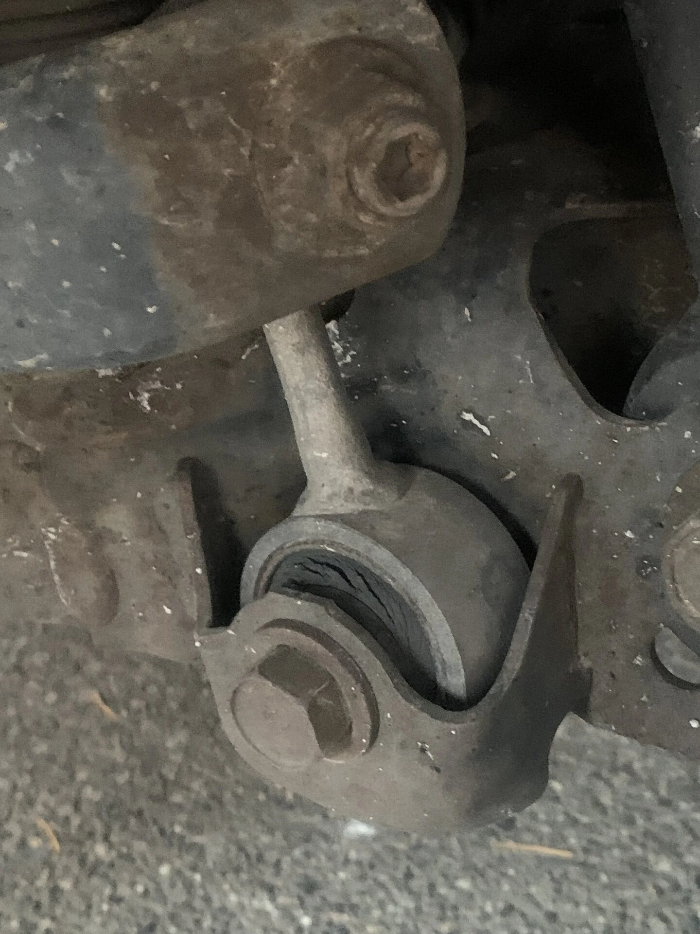

Sway bar link!
I still don’t see any loose items, but the sway bar links look pretty shot. I’ll start with those.
Sway bar endlinks often fail on the ball joint side that's hidden behind the boot. Can't say it's 100% that but it looks like there's enough reason to swap?

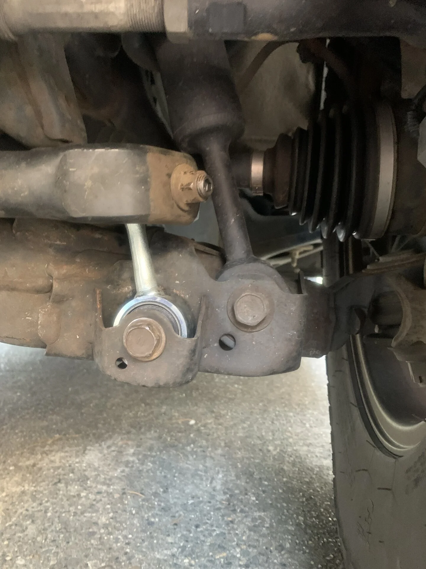

Removal and Install notes forr Link Assembly (part number 48810-60051)
Removal:
19mm socket for the nut and bolt
2 lb hammer
breaker bar
24" pipe extension for breaker bar
cold chisel
Pry bar
floor jack
install:
19mm socket
torque wrench (bolt 100 ftlb, nut 103 ftlb)
Removal notes:
Jacking from the center of the rig / skid plate put the jack in the way of the pipe extension on the bolt, hod to move the jack to the frame rail behind wheel
I had sprayed pb blaster on the threads a couple times over the past few days
The nut and bolt came loose with some persuasion (breaker bar + pipe). the bolt had limited swing and took a bit of fiddling
I had some trouble getting the link out. in the end pushing from below thru the cage with the cold chiisel got enough of an angle to pry the sway a 1/16" and allow the top bolt to disengage. Then it could be lifted up and out.
Install notes
It wasn't too hard to find a position to get the top bolt started, and then some simple prying got the top thru with the bottom in the cage. Lining up the lower bolt required jacking and lower the car, a little, and a few love taps, but didn't take too long.
If you don't count the time I spent looking for an air impact I hid somewhere in my garage 5 years ago, this took around 45 min.

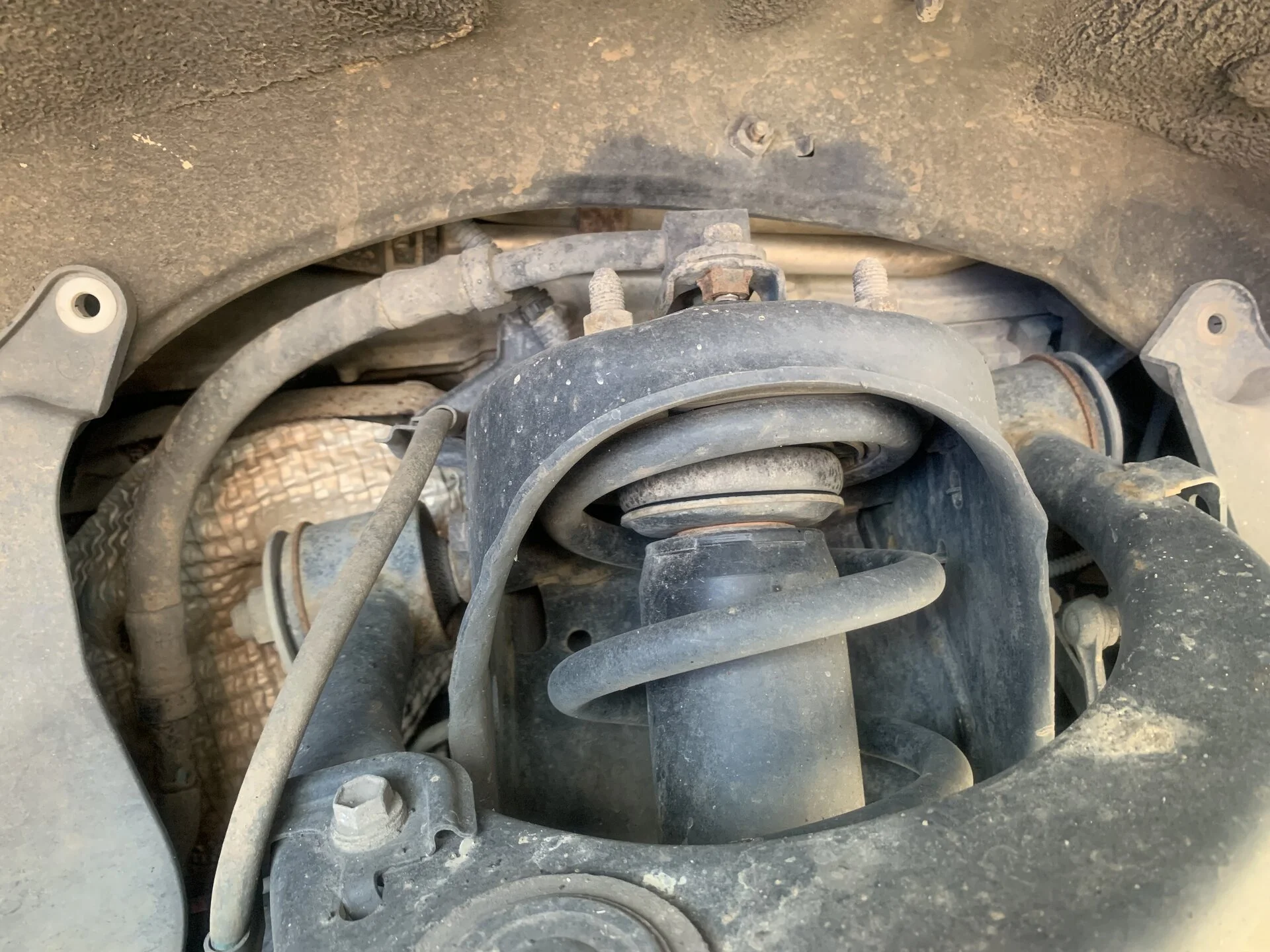

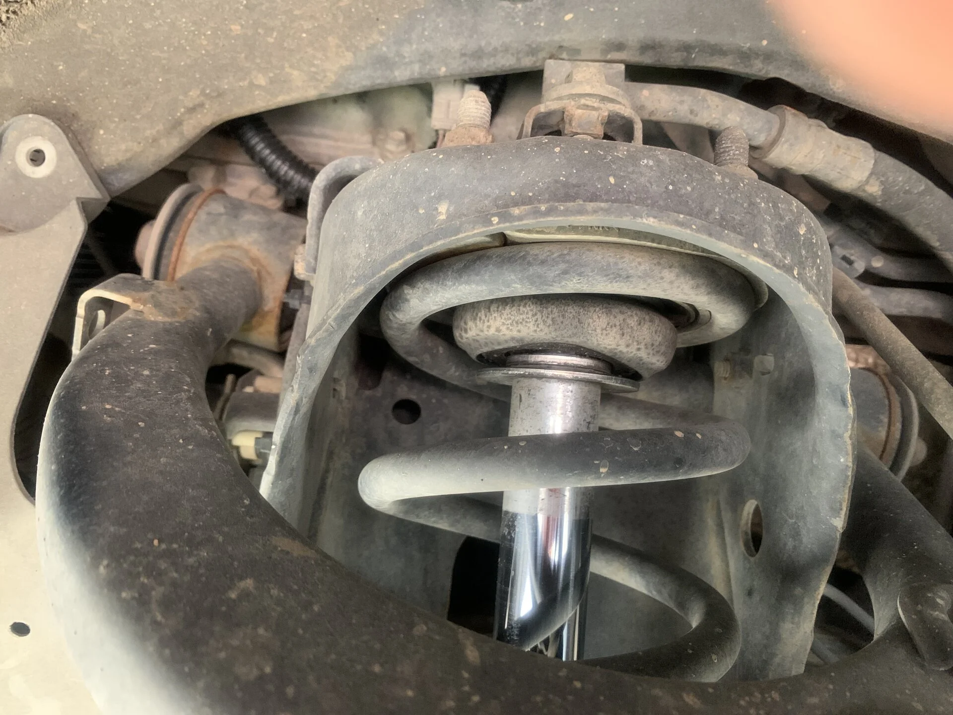

Looking around for clunk sources. Did the old wheel tug up down left and right. No play to be seen in any of the upper and lower soft joints. Some play in the steering tie rod, is that normal?
Found the pictured difference at the top of the shock. Looks like a metal collar is missing, and the rubber top out is roached off its mount. That plastic shroud has been loose for ages, can’t say regarding the metal collar. Would this clunk? It does match up with what I think the sound is like, kind of a loose spring sound.
Maybe I get to do front long travel finally? If I have to take the shock off I’m going to be replacing stuff!
For now I put the spring rubber at the top of the spring in hopes it’ll reduce compression up there.
