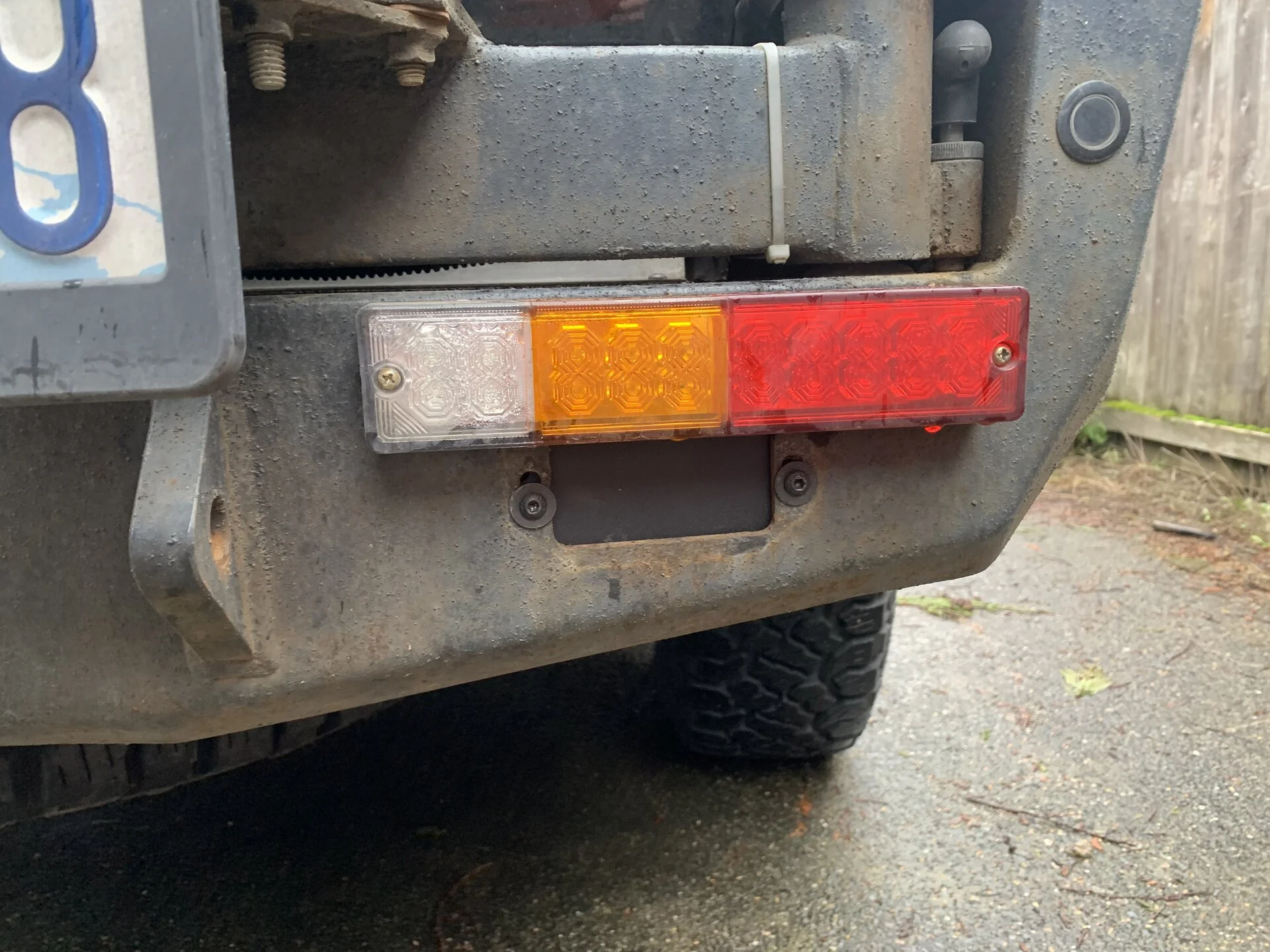

Installed and Hooked up my reverse light that I stubbed wiring out for 1 year.

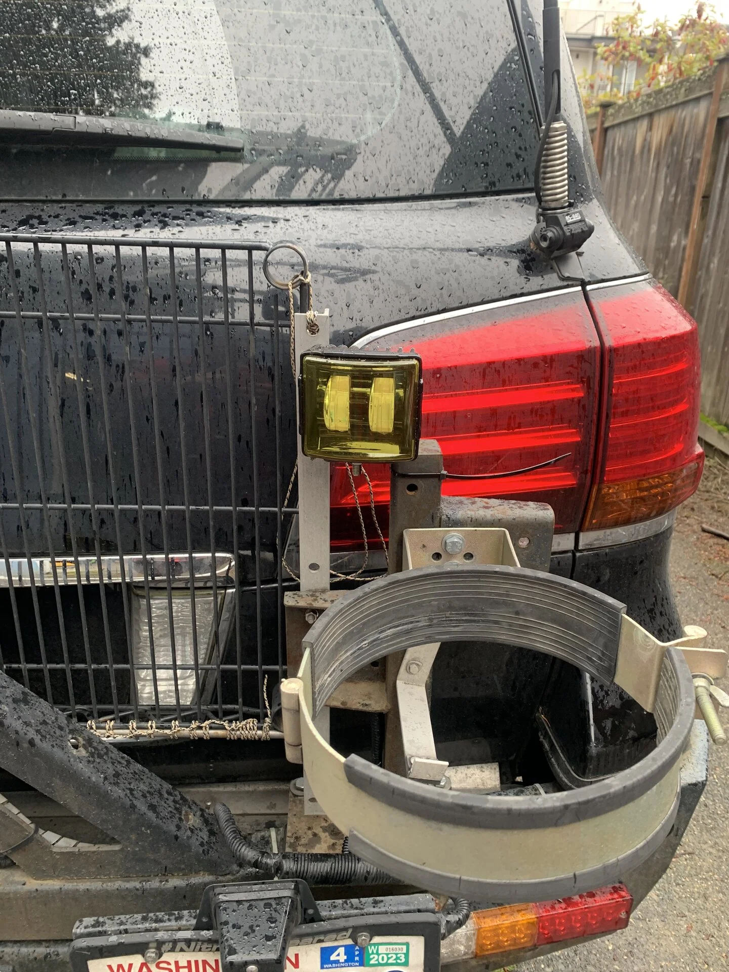

Finally mounted the changing room, shower room, toilet room up on the new rack. Had to redrill and cut off the brackets. Getting an itch to add an awning again, still looking for a bomber truly freestanding awning for $500.

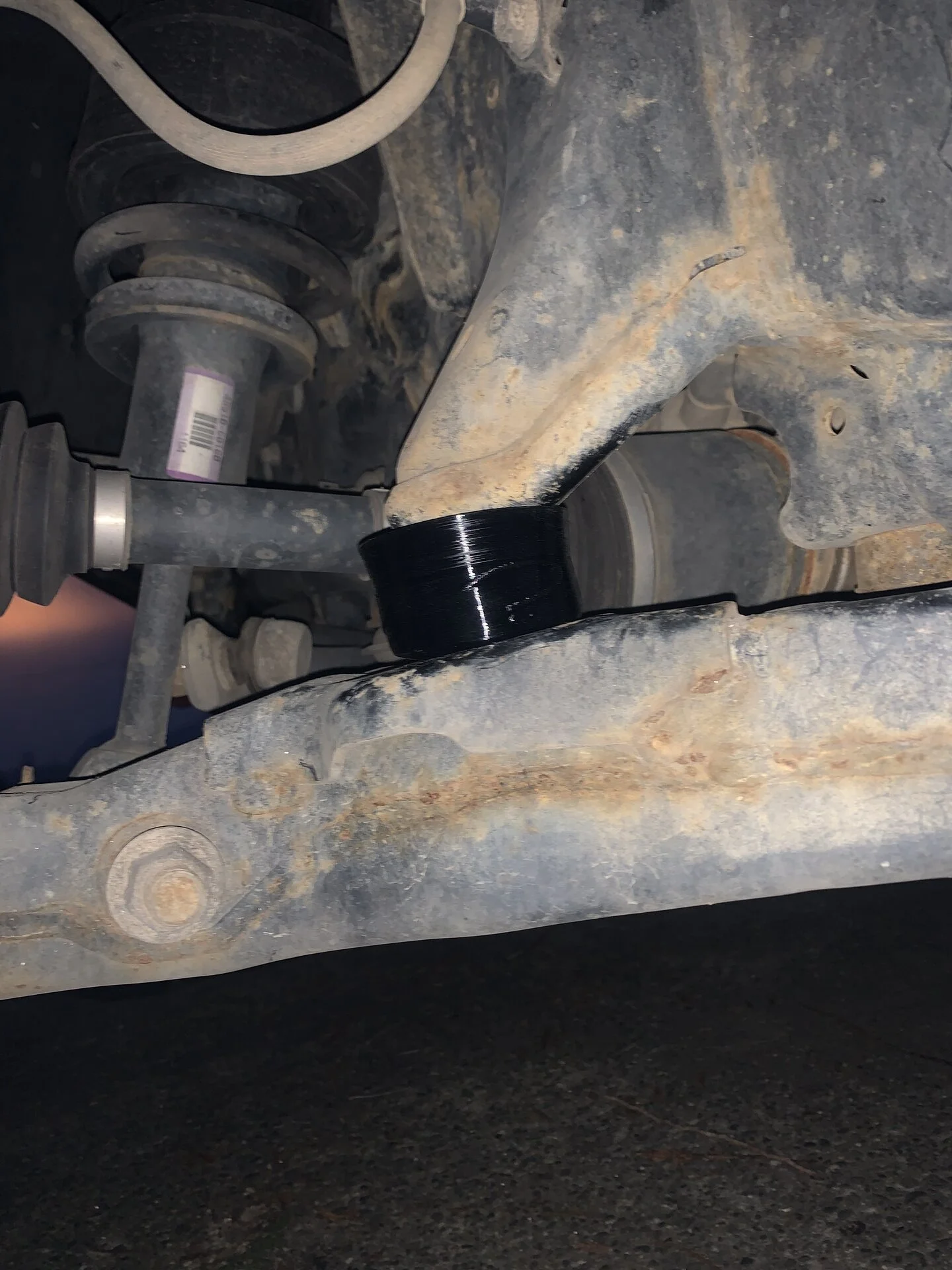

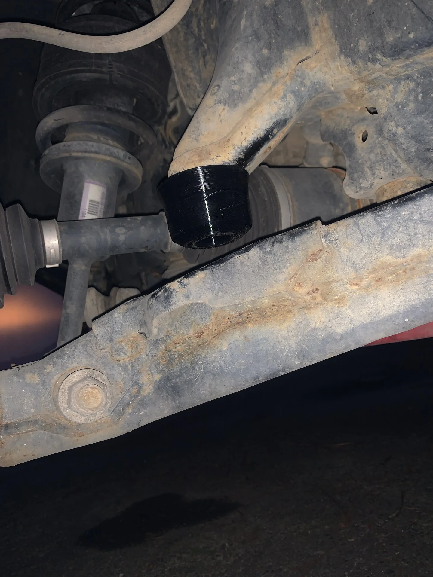

Put on the new, shorter front bumpstops from Perry Parts. Low mode is back on the menu.
These have a little clearance in Normal, and about 1 1/4" in High.
The longer set worked great, but did contact the arm in all positions. I don't have any seat time yet, will update on ride and impacts as I put a few miles on the rig.

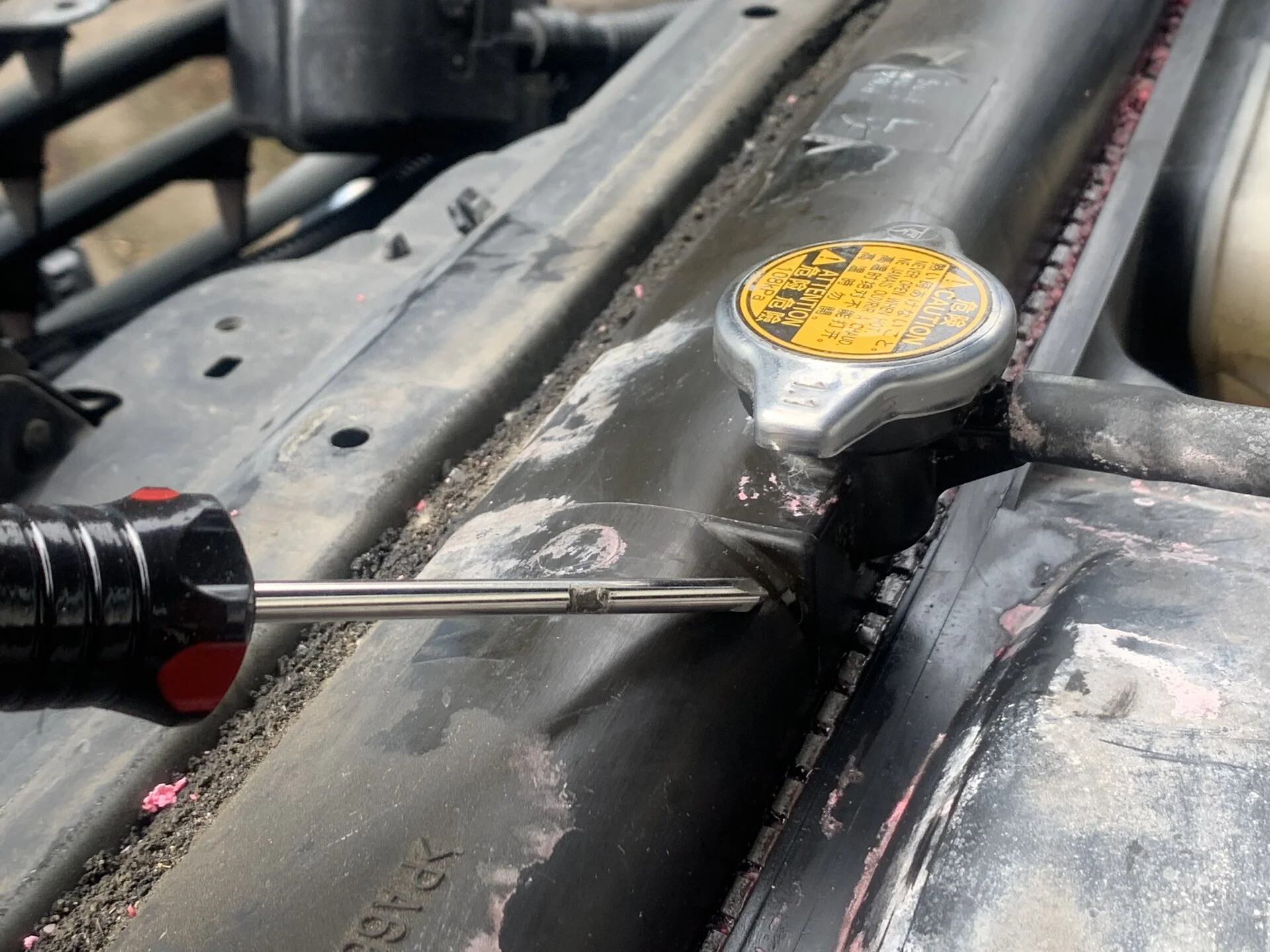

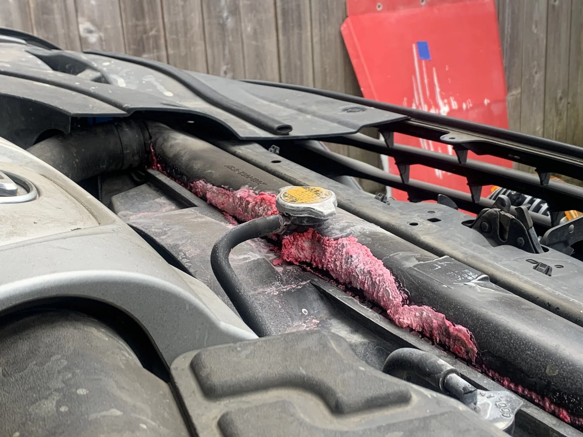

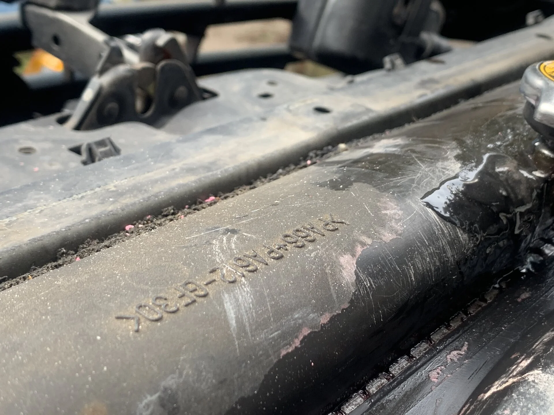

In other news, the was a light coolant stain on my engine skid. And some blow by on the cosmetic covers. And a nice crust near the thermostat when I think that cover off.
I think my radiator is trying to tell me something!
It has a small hole that weeps under pressure where it is square shaped by the thermostat.
I put some plastic jb weld on it for now. I may have screwed up the bond, was cleaning up and rotated the thermostat and sprayed some warm coolant on it. We’ll see.
Added a total of about 2 liters of premix to the resi and radiator.
Will need to lay in the parts for the coolant refresh kit.
As expected the first epoxy try didn’t set up over the weep. An hour later it was till soft. Scraped it off and resanded and reapplied. Engine now cold so no weep. Expect better performance in this attempt.
2nd attempt worked, but there is an additional weep on the fan shroud side, under the thermostat. The thermostat sits I a square box, who could have seen this coming?
Waiting for truck to cool down so I can try to patch in this hard to reach and impossible to see area.
Fixed the back underside of the thermostat bung. Now leaking out the round side of the bung. So that’ll be four different locations. It’s safe to say the rad is toast. Physical failure of the plastic. I look forward to lots of breaking plastic on removal.

FWIW.. JB makes a product called Water Weld.. it works even on hot coolant tanks and radiators... been there done that just not on the 200...
but yeah that thing is toast, I would do the fan as well, just because.. and keep your old one as a spare.
YMMV..
YMMV..
Where the jbweld plastic epoxy wasn't setting up was over an active, wet leak. It cures fine if there isn't continuing water presence. Sounds like water weld can also cure in the presence of water/rad fluid?
Yes - last trip we used it to fix a leak in a coolant reservoir tank which was still hot but not under pressure obviously when we fixed it, we just moved it so we could get to the leak while leaving it connected, and with coolant in it.
Worked the rest of the trip (3 days till he got home)
Not a miracle cure but worked and held pressure (~15psi) - that was a fairly small diameter leak however, something larger than a small hole will probably be more iffy...
It's worth carrying with you.
while on the topic of coolant stuff to get you home... also carry a roll of rescue tape with you works on the hoses, just make sure to at least zip tie the ends of it once you wrap it (hose clamps work better) - they have some info on their website about how to use it.
