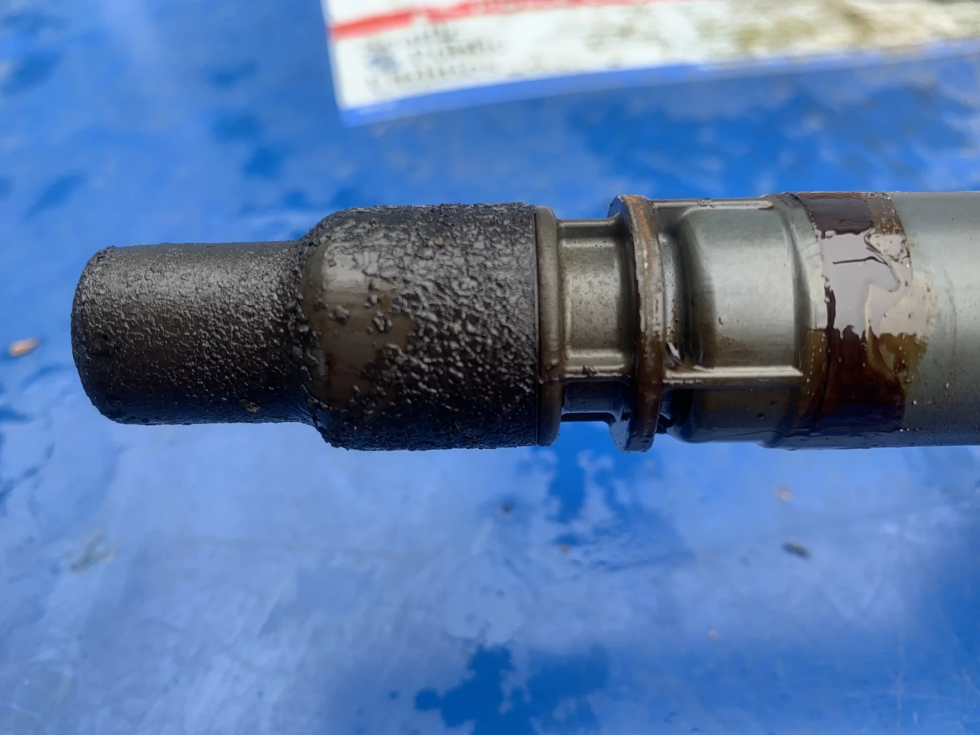

Quite a bit of oil on #6 coil and spark plug. Spark plug was loose, so I’ll blame that.
The other coils on that side are clean, I still haven’t gotten #8 plug out, it started raining.

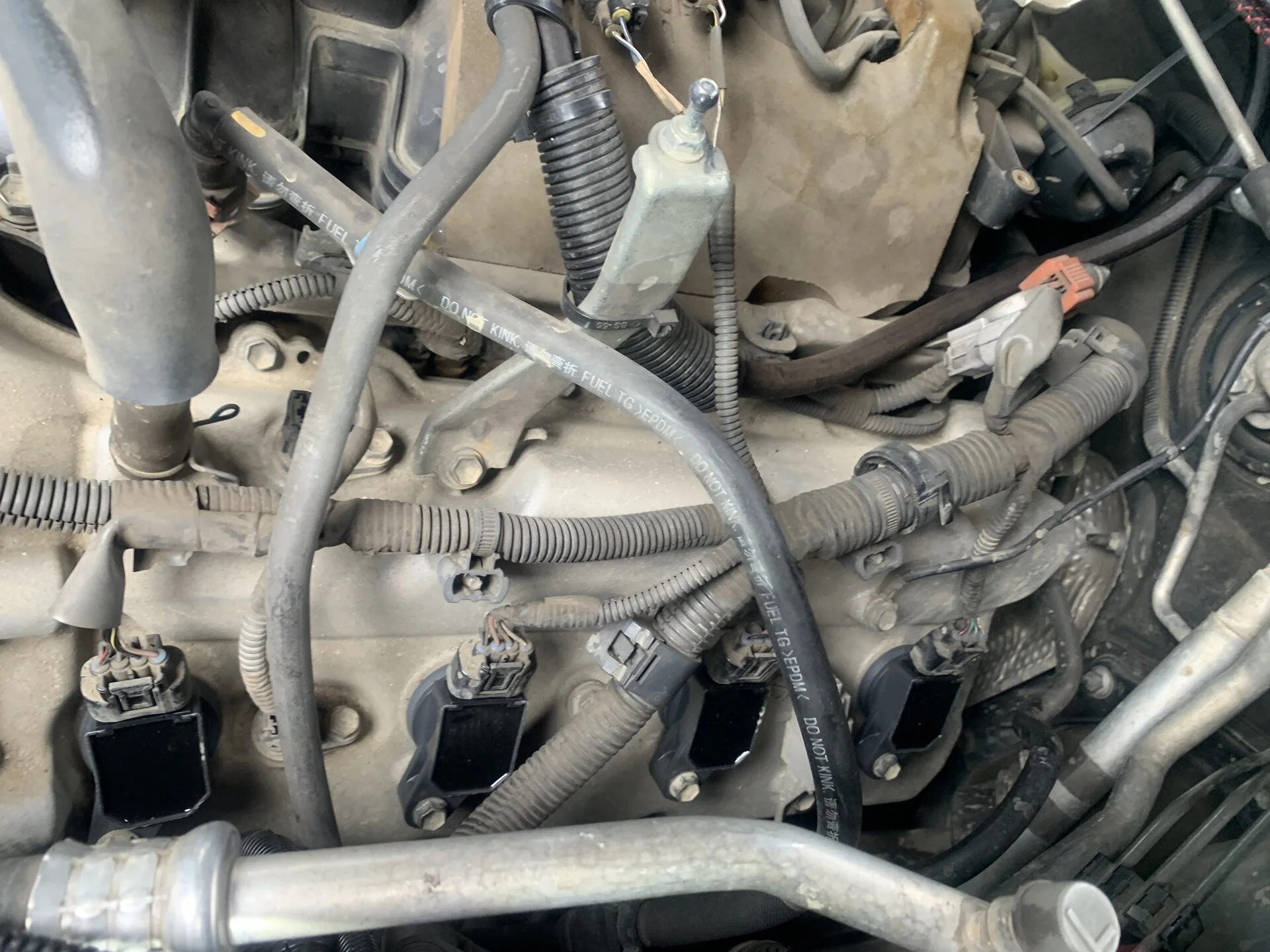

#8 coil was a right pain to remove, I unclipped the main harness from the firewall and snaked it out. Looking forward to putting it back in!

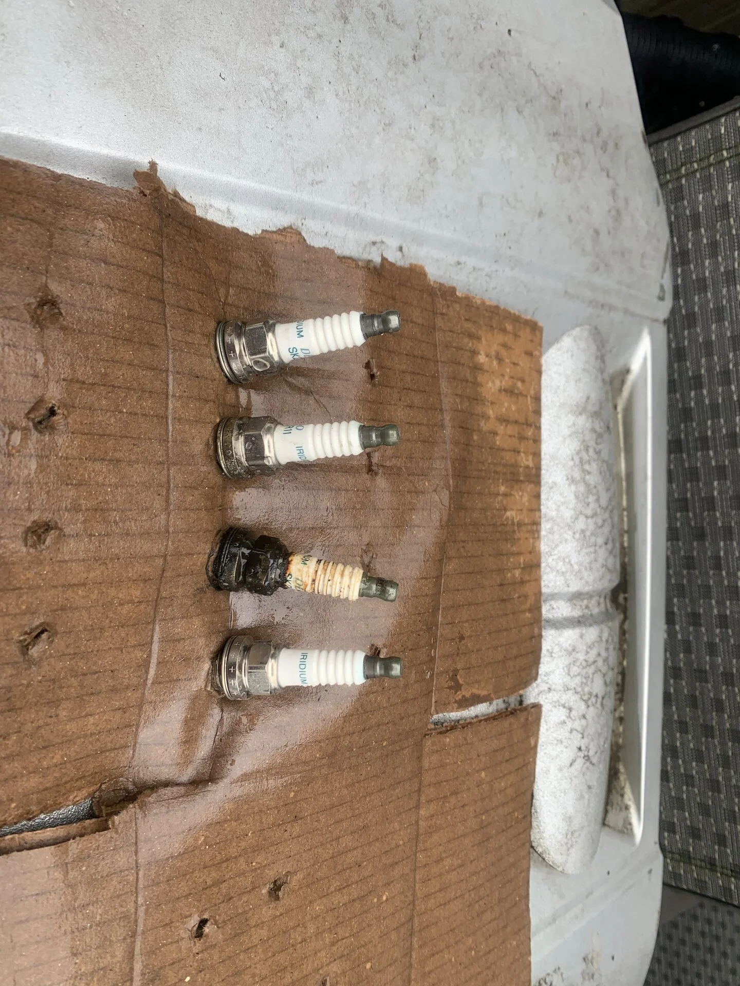

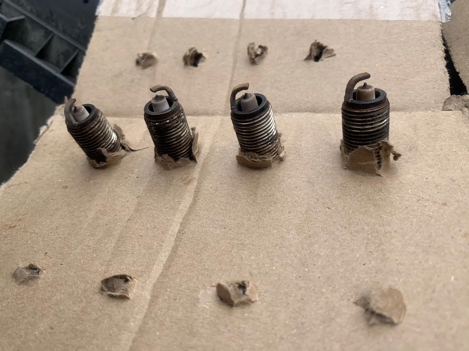

Here are plugs from bank 1. They look ok until compared with a new plug, quite a bit of the electrode is actually missing.

Unclip the main engine harness from the firewall (push screwdriver in at tab, pull off hanger), at back right of engine (#8).

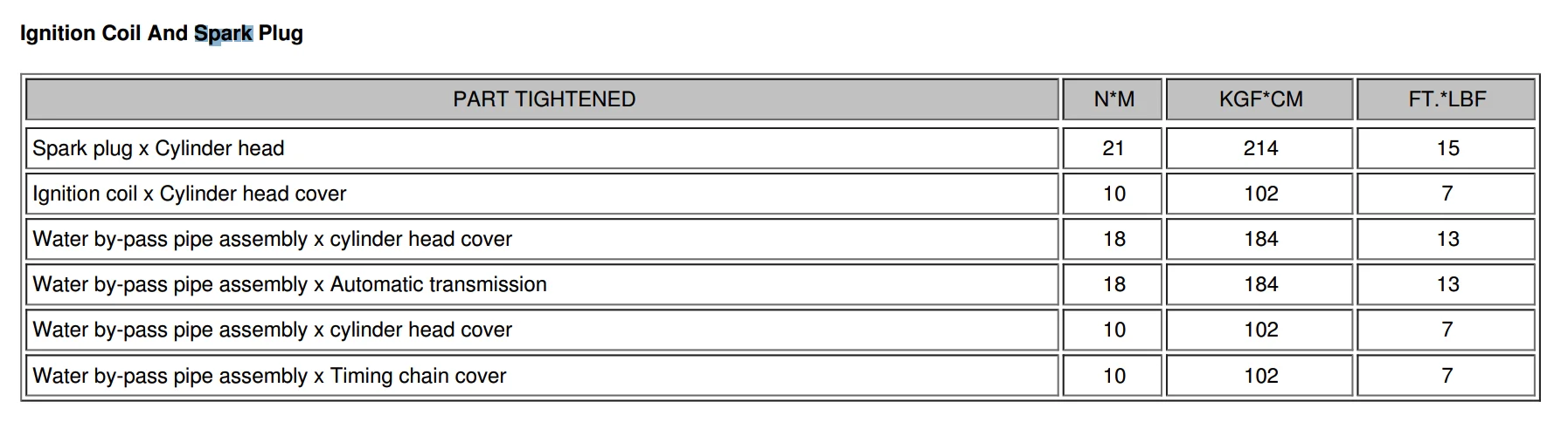

I did the left side first, for practice. I had one very tight/possibly cross threaded plug (#1). I choose to put antiseize on this plug for reinstall. I tightened to 12ftlb instead of 15 due to the antiseize. The other 7 got tightened to 15 ftlb.
I had oil at location #6. That plug was hand tight, so I am hoping it was simply an installation error by previous shadetree. Will watch.

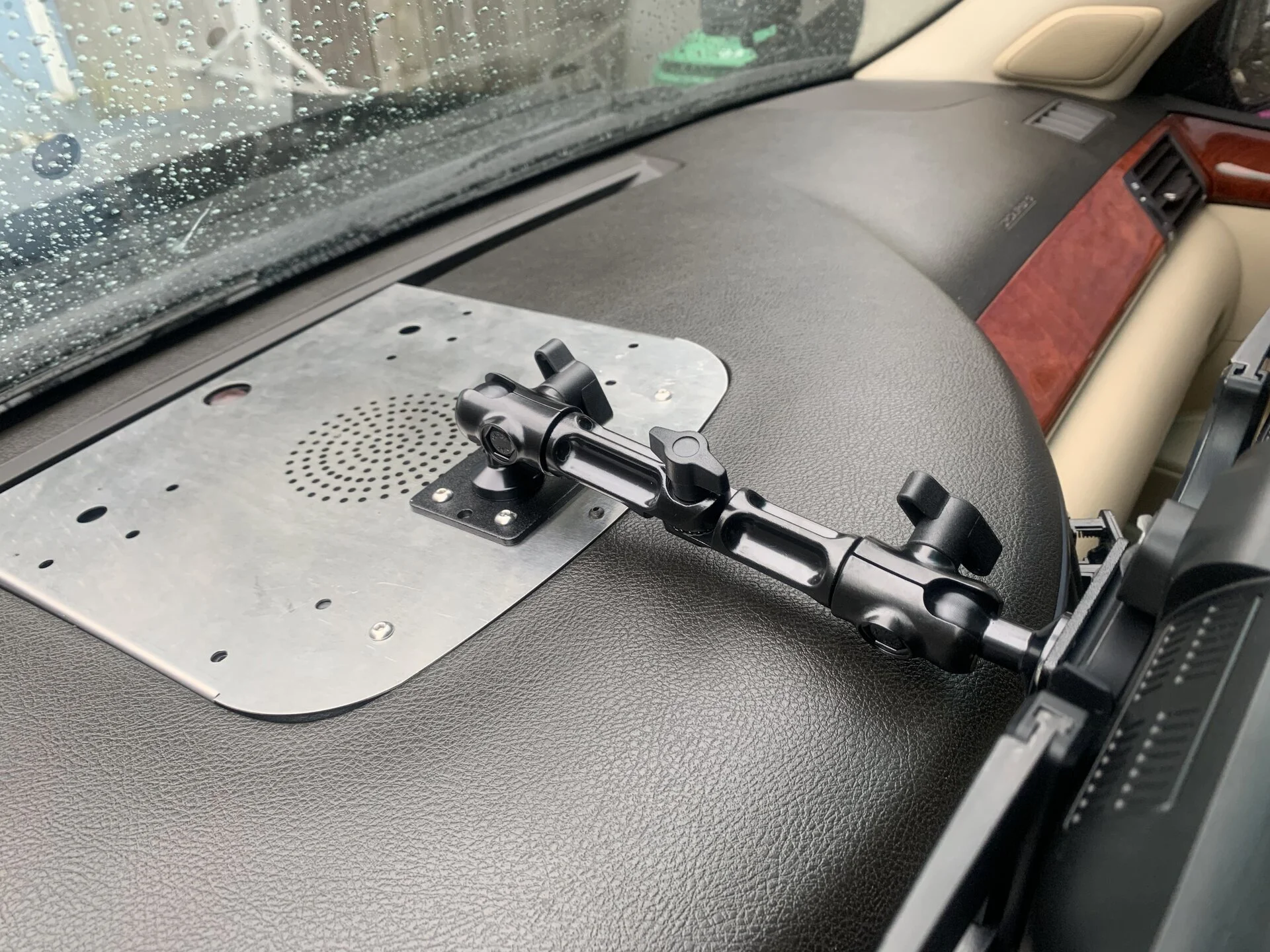

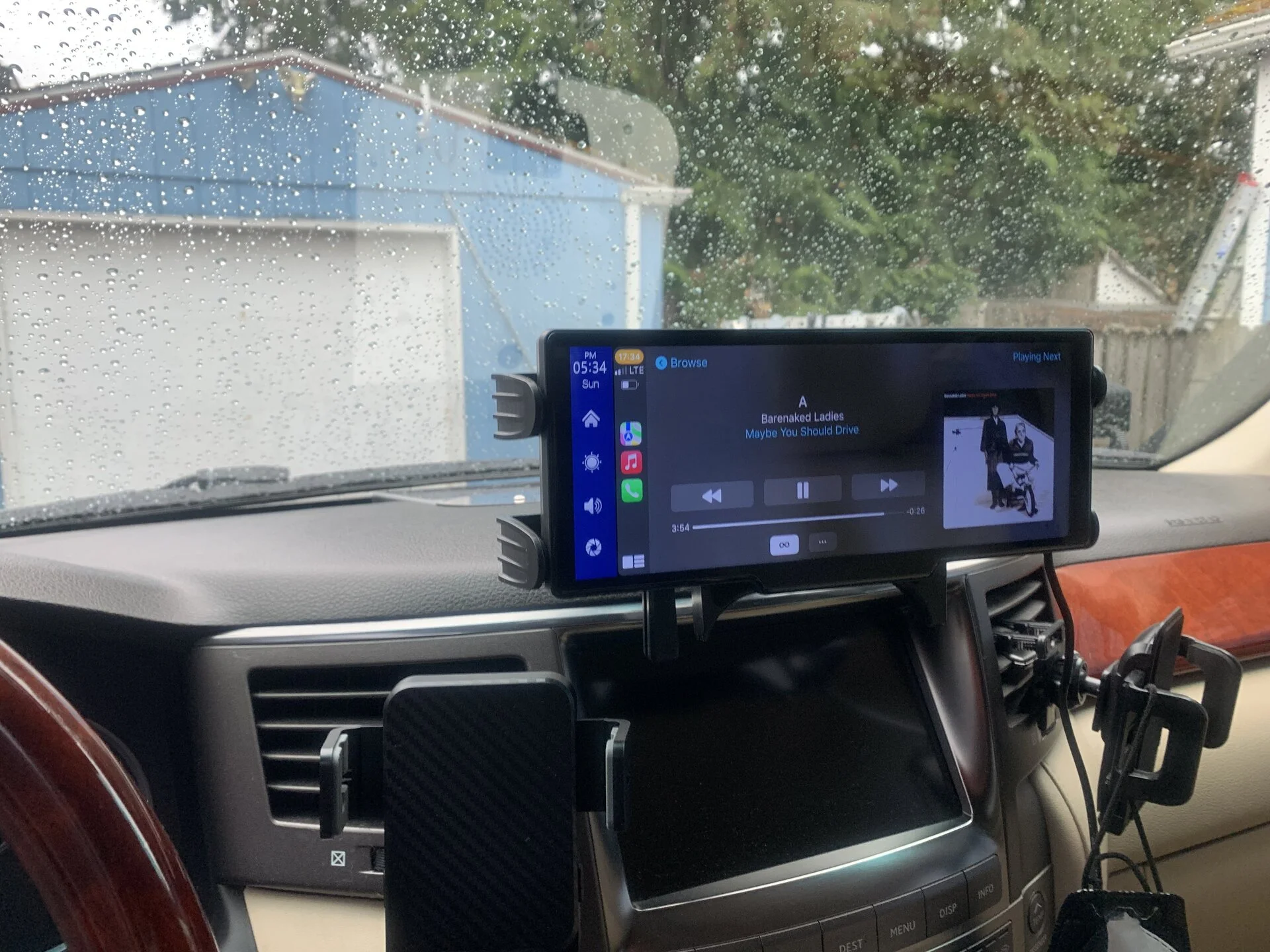

New arm for the CarPlay portable. Had some power stuff in house to mount on the gamiviti cover, but decided as I layed it out to do something different. So another week on the cig socket adapter.
$42 20mm tablet mount with 8” arm. The camera on the portable is in the way, so it holds it a bit shifted. For now not resting on the dash, will see if it want to shake, if so I’ll toss a rubber pad under it.
Yeah, that tablet way out on the 8" arm wobbles pretty good, the joint's tight, it's just physics. I rolled up a microfiber cloth and put it under for now, we'll see what I decide to do long term. I was planning to hang my phone on that arm as well, so it's just going to get more bounce in it. I guess I'll lay in a second amps mount just in case I have to mount them separate, which seems pretty likely at this point.
