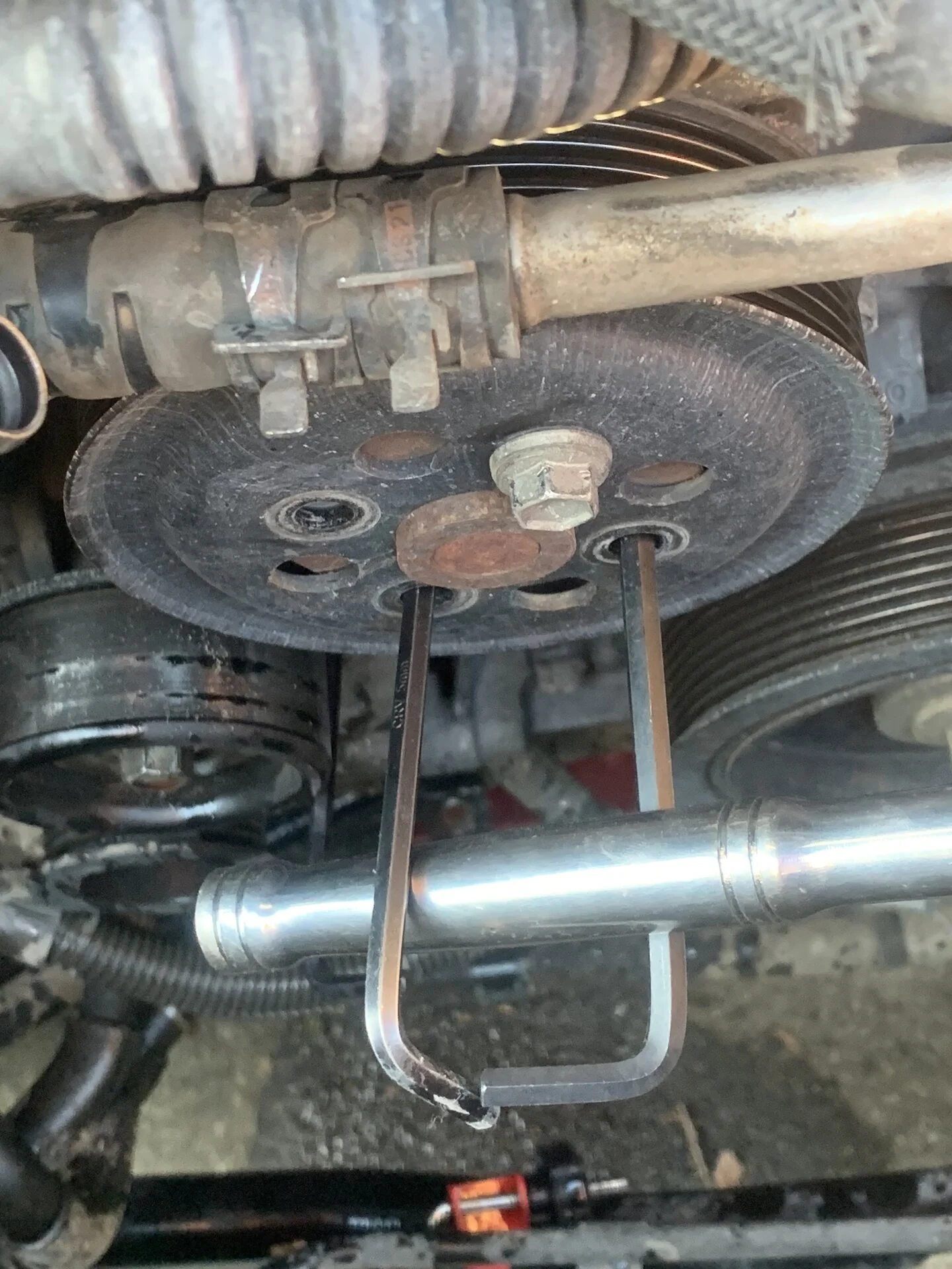

Among several ways to loosen the water pump bolts I chose to wedge some hex keys in empty bolt holes.

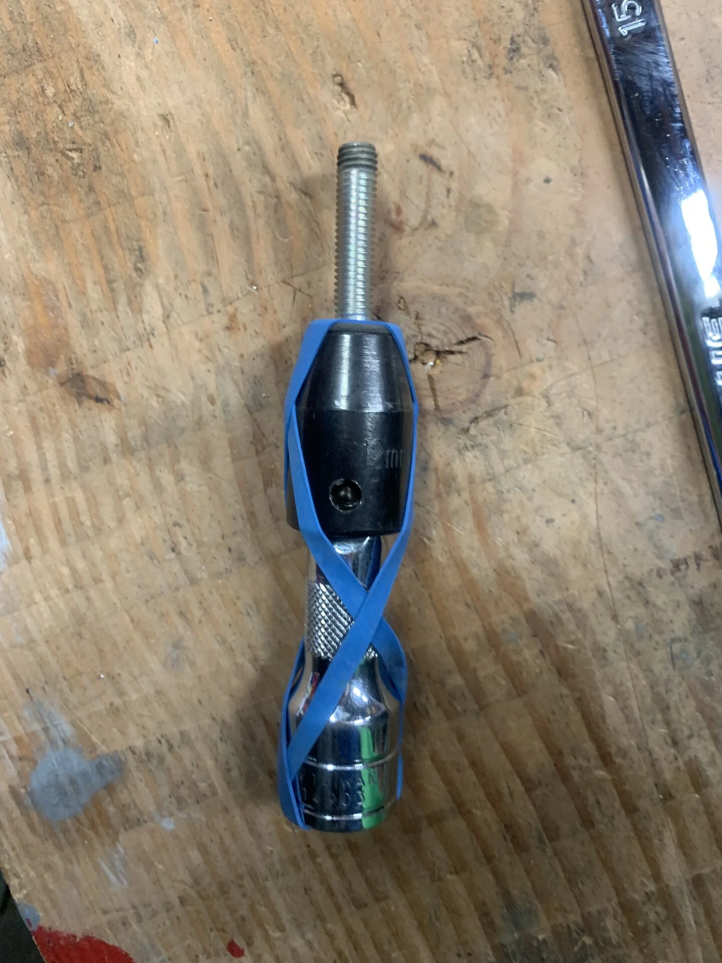

“made” a SST to start the install the lower radiator bolts .

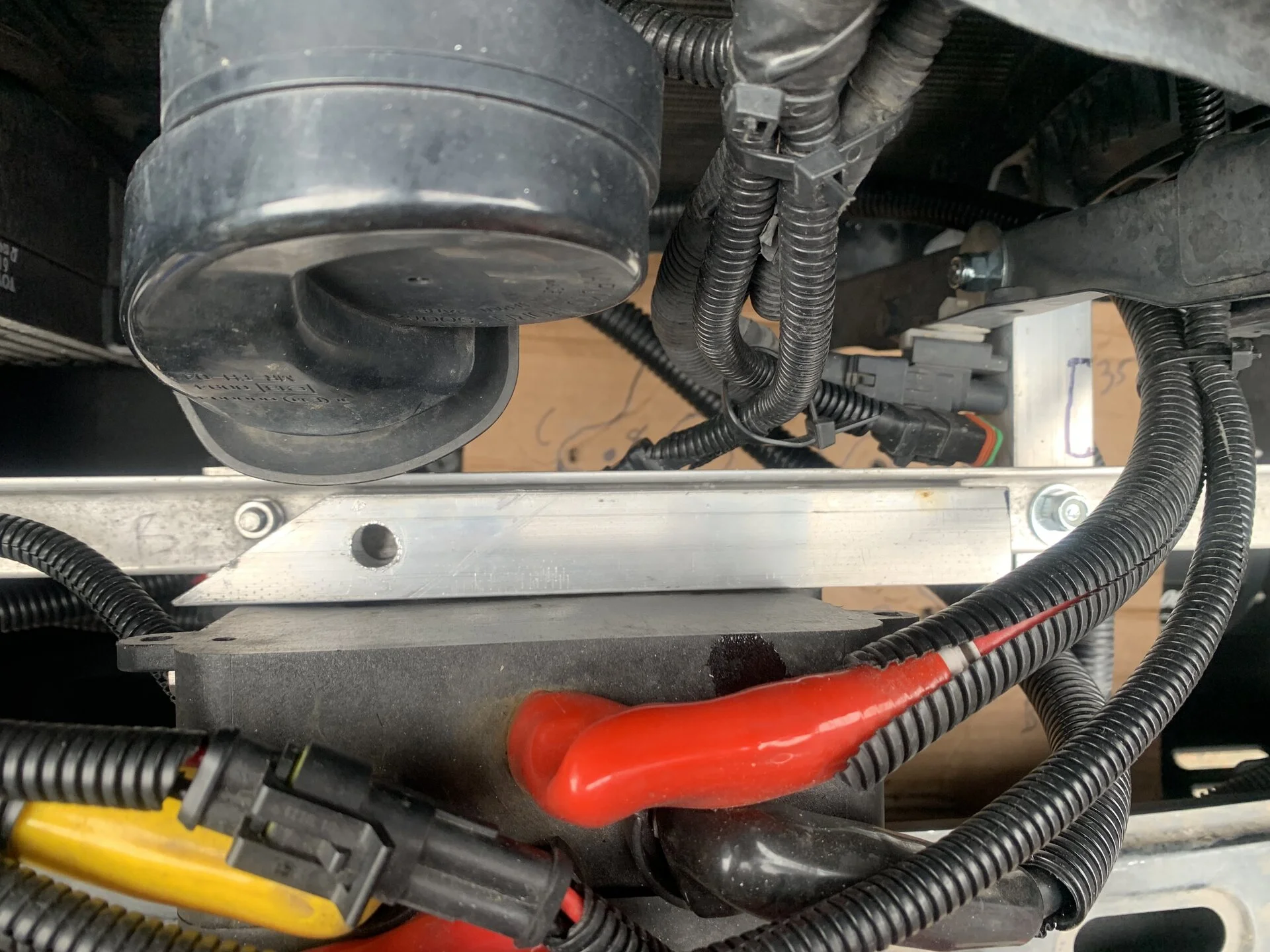

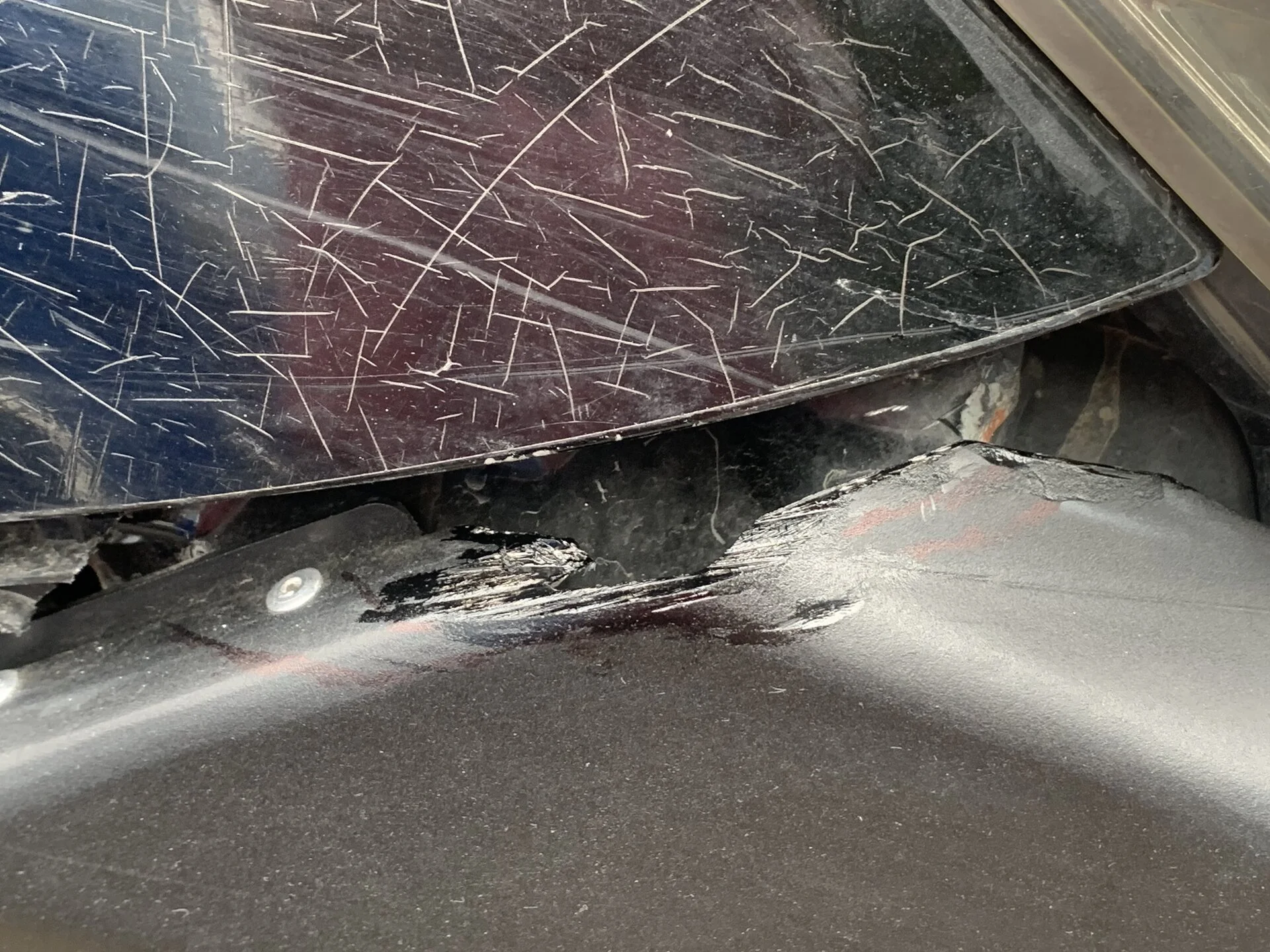

While I had the bumper cover / grille off, did some work on the bumper install.
Reinforce the grill carrier at the center so it doesn’t sag
Cut down to 3/4” spacing on the right side.

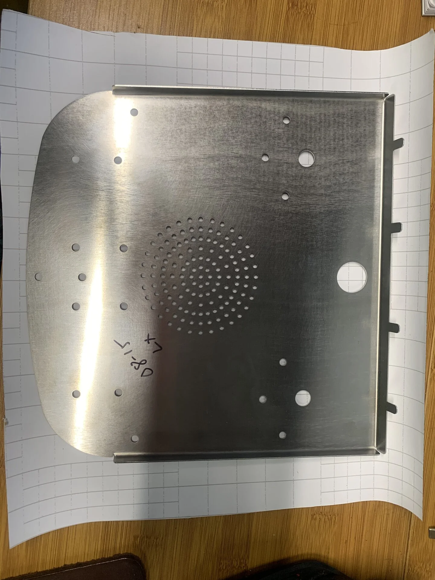

Make a bracket for the winch control box.

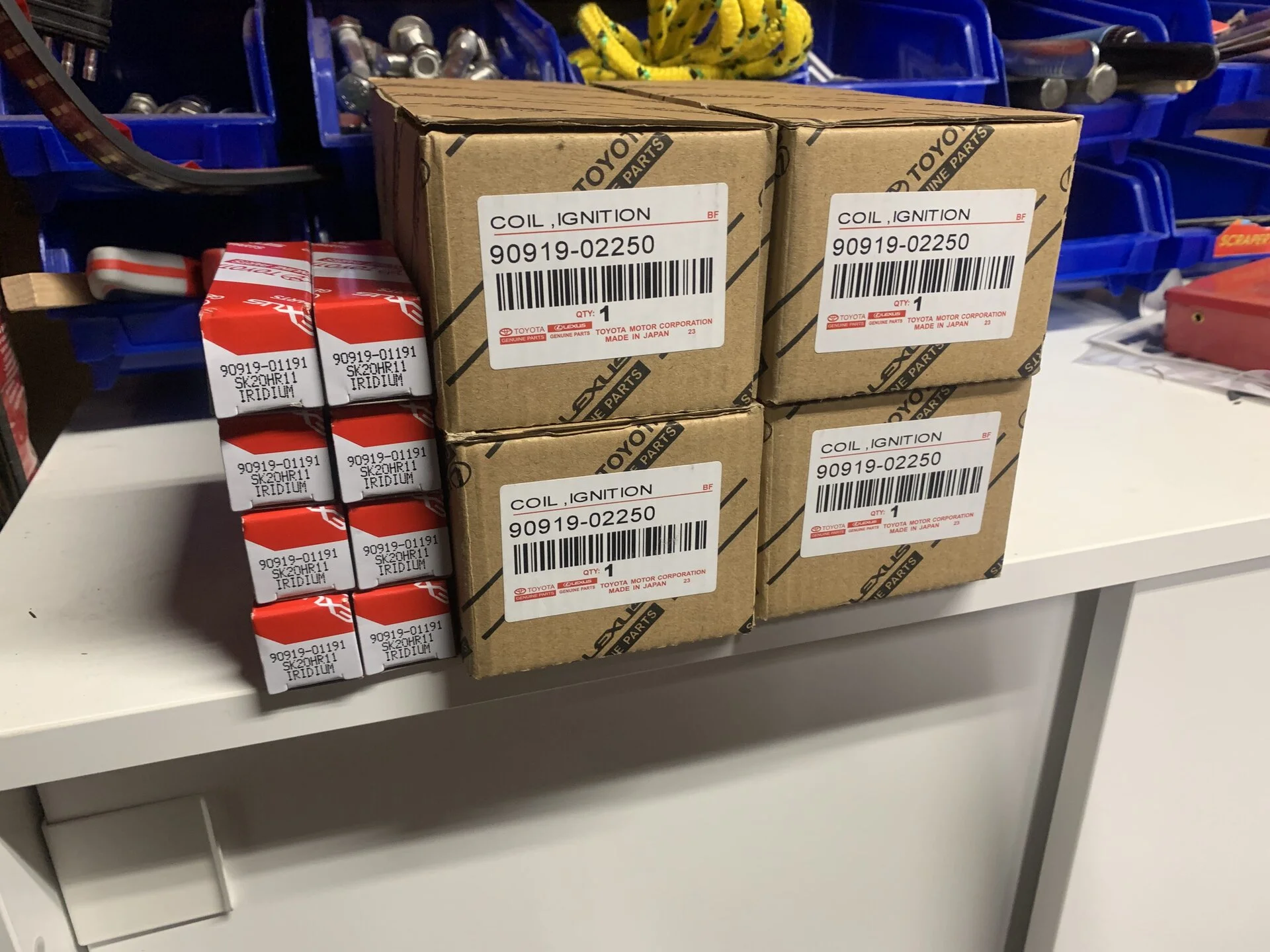

Plugs and half the coils are in.

No rush I'd say, 120K is the service recommendation on the spark plugs ($6/ea)
Coils are probably fine, but I'm already taking them off for the plugs, so why not?, feels like 15 years/240k miles is long enough service life for them ($35/ea)

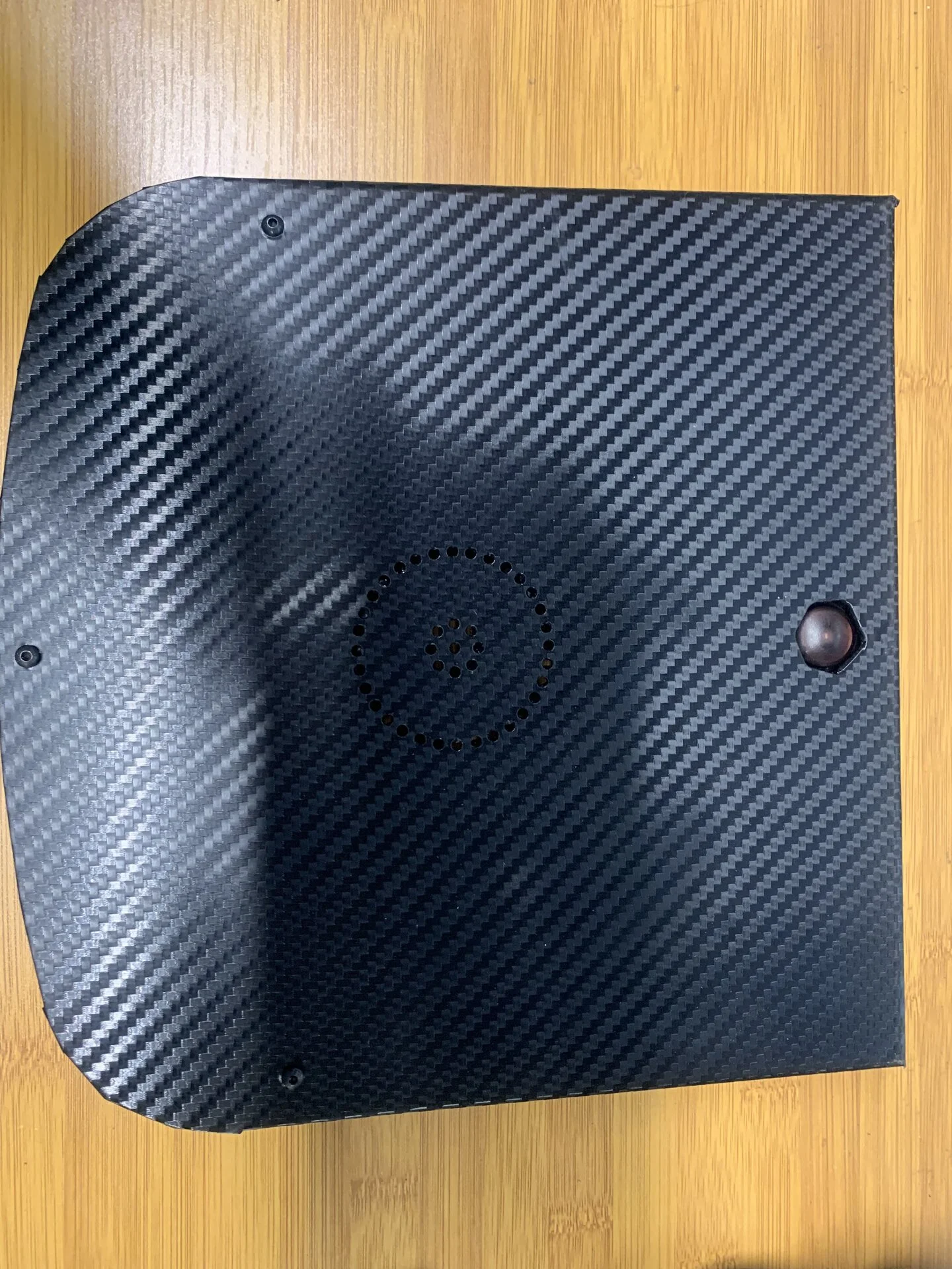

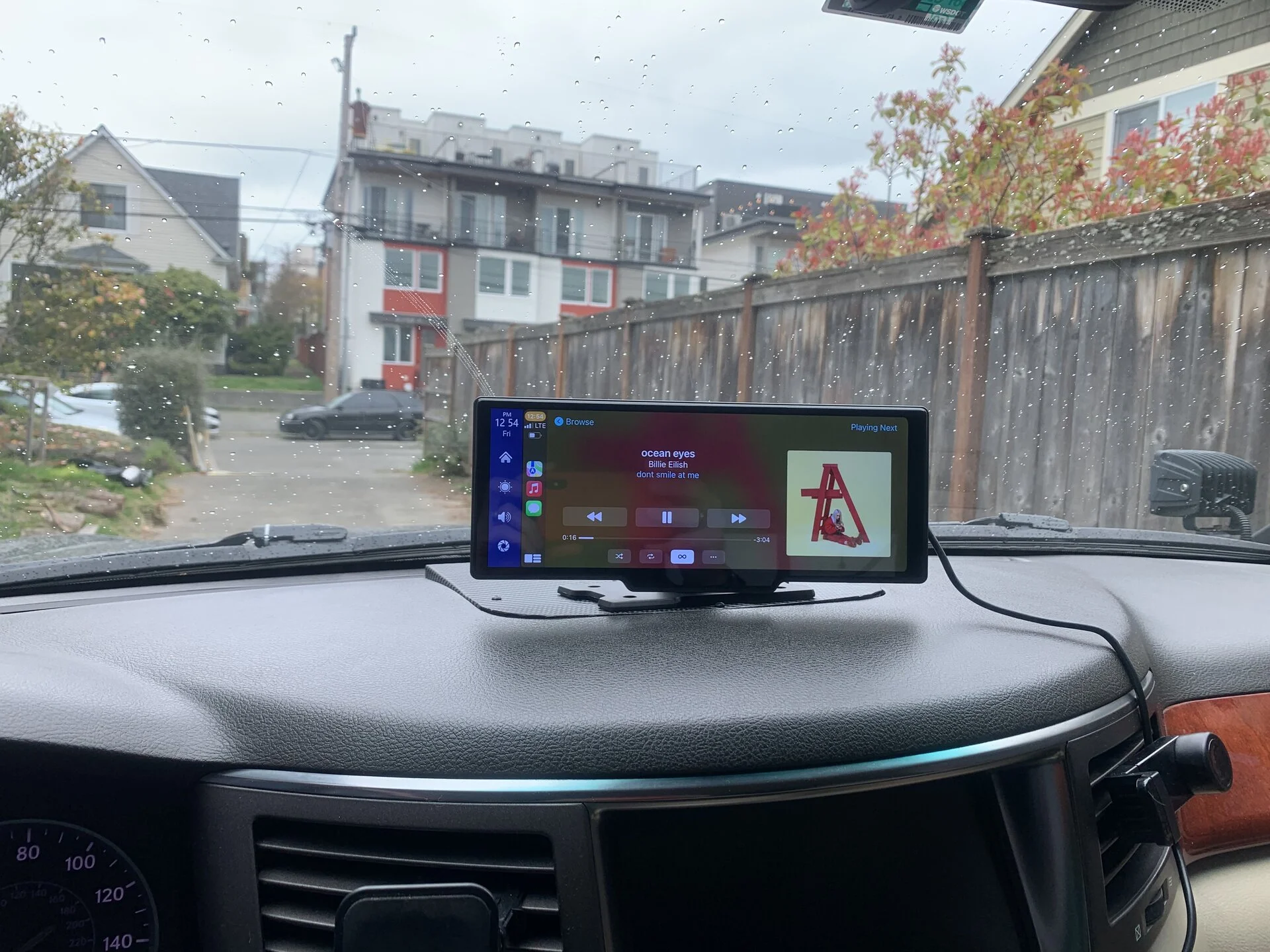

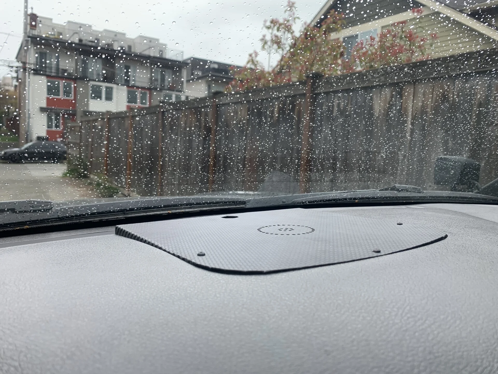

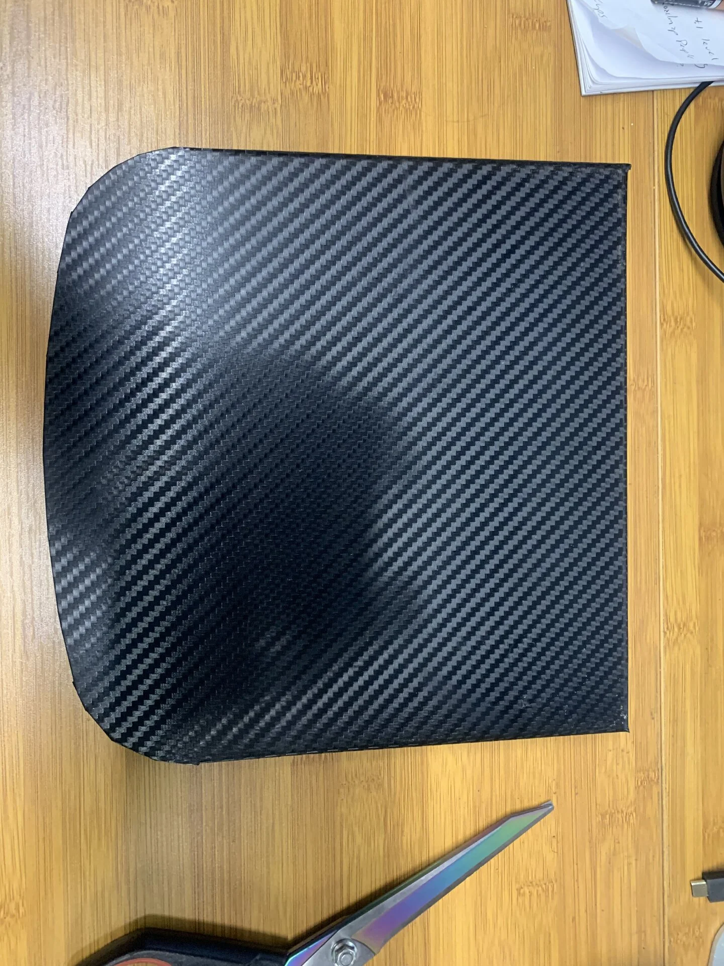

Finally temporary fit. I’ll need to pull it and add power up there and $100 of arms and mounts to get it more forward and lower. This works for now.
This is one of the many look alike carplay portables. It was $135.
I join CarPlay, then on phone in music app select my amazing Bluetooth source (WiiM mini) that feeds the amps.

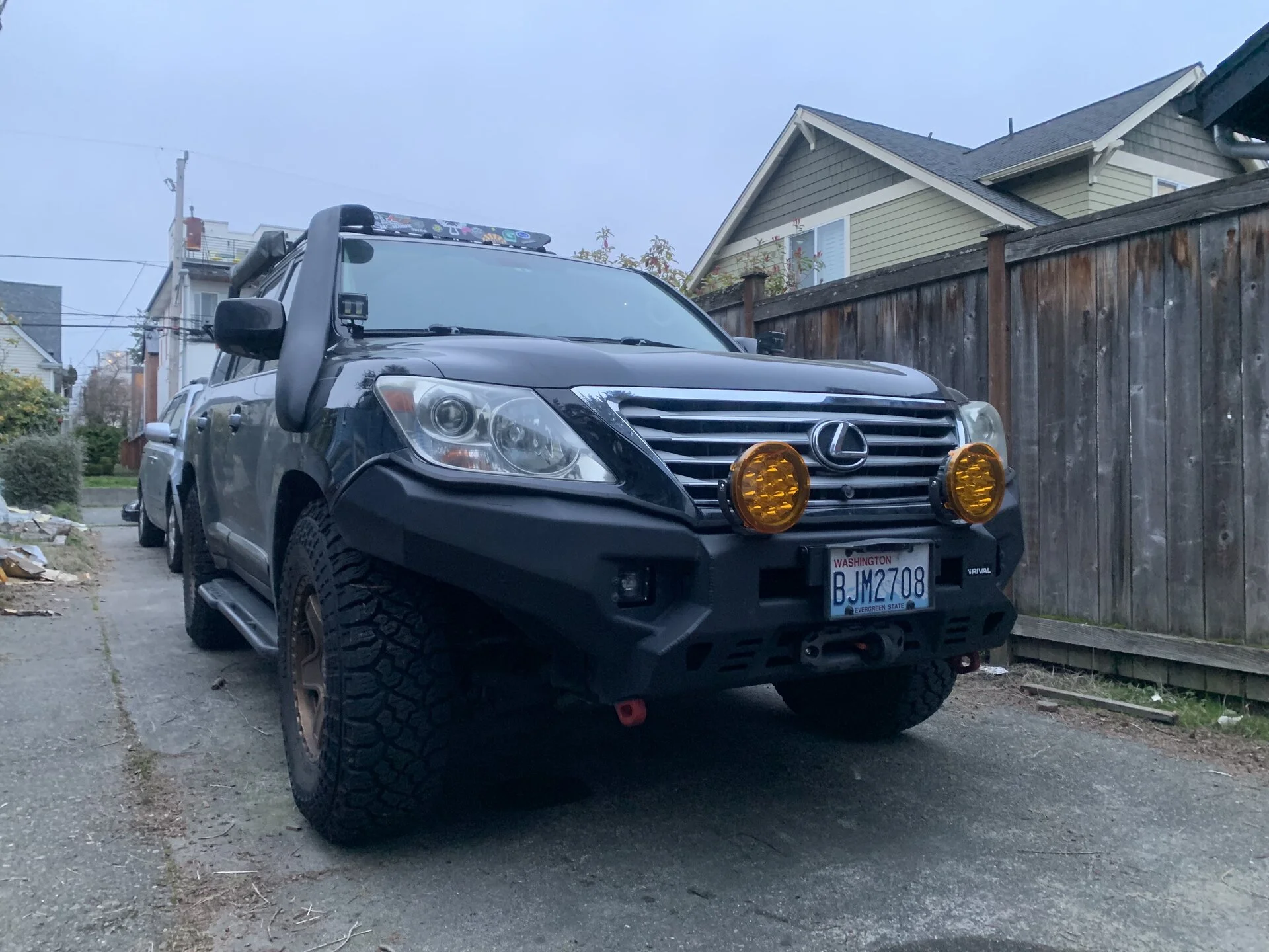

Finally got to stretch the guzzler’s legs after a long winter of kid activities.
O2 sensor / fuel sensor and/or a tank of fuel injection cleaner paid off -> saw 15.5 mpg over 200 miles of up and down from prosser to Seattle. With some high winds and 50 miles of wintry mix. Speed limits were 70 or 65 and I was going 5 over. Something worked good and I’m very optimistic that spark plugs and coils will get me into the 16s. Also running a bit better and smoother, though that is hard to prove. For the last couple years I’ve usually seen 13 or 15 (at best) fwy mpg, and never above 12 over hills where downshifting to 4th and 4000 rpm was going on.

New CarPlay portable worked great. I’m going to look for an option with an external microphone to try.
