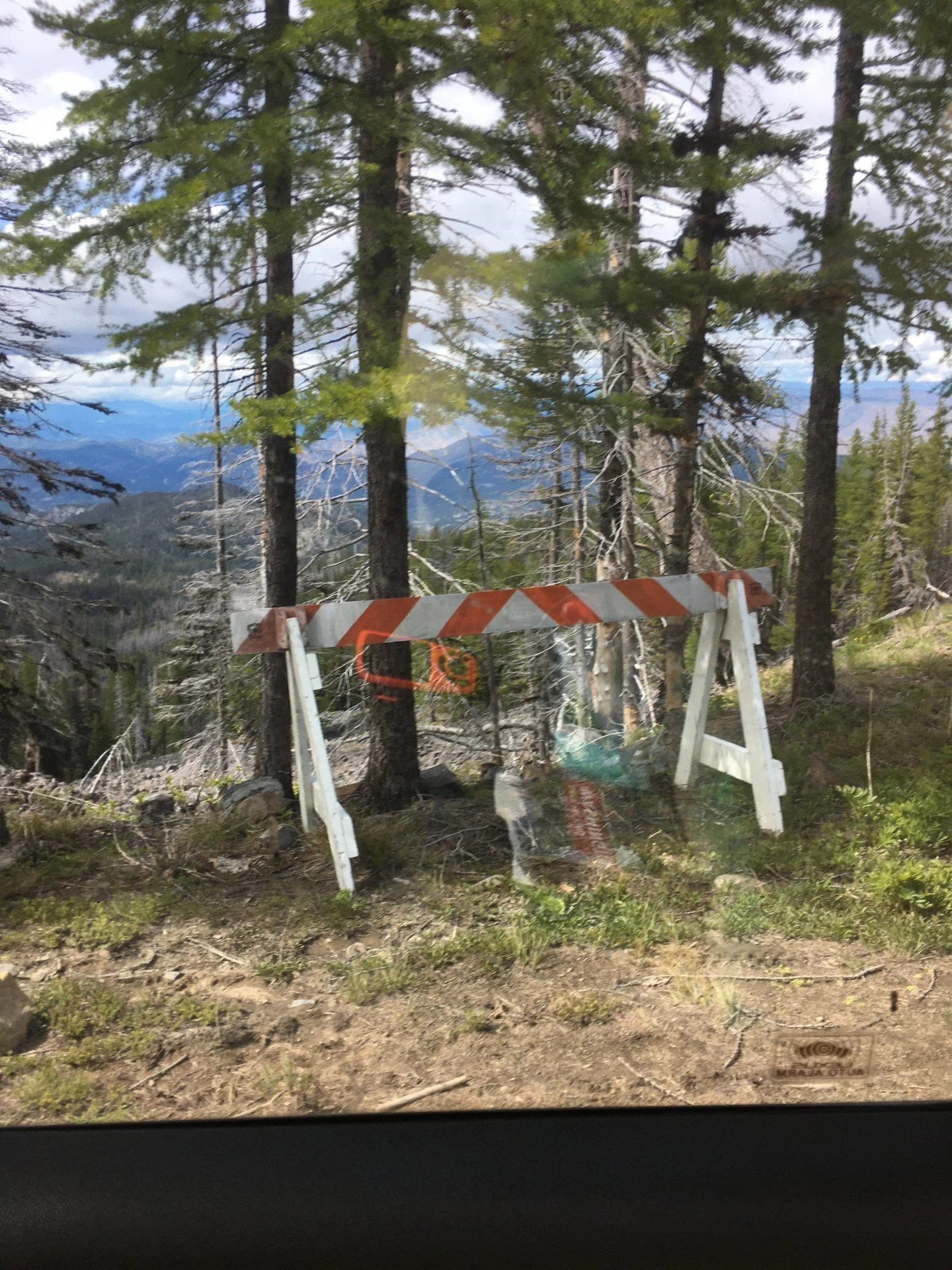

So headed down NF 9712 about five miles N of Haney Meadow, the road which was paralleling the mountain edge had a set of washouts right near the summit, before it headed down to Wenatchee. The total obstacle might have been 1/8" mile and had four separate washouts. Sketchy because the road, which was already cliff edge, was now off camber quite a bit and narrowed significantly. This area sees primarily motorcycle traffic I think . . . anyhow, we drove it and found this on the other side.

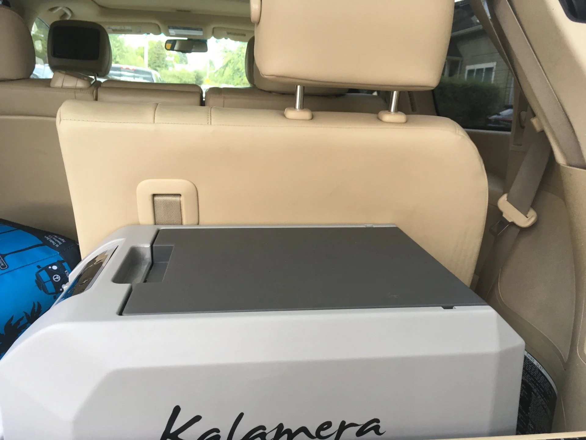

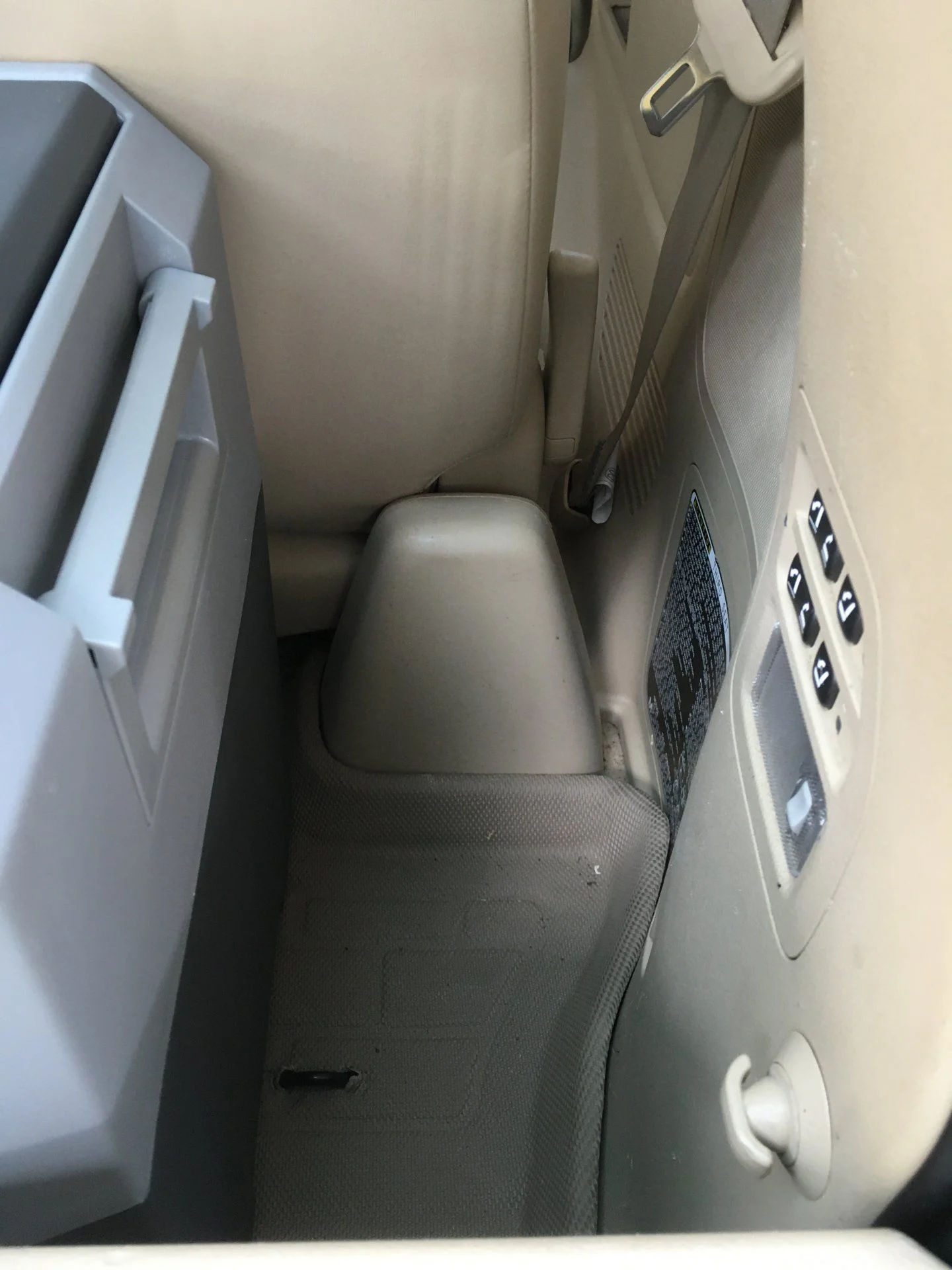

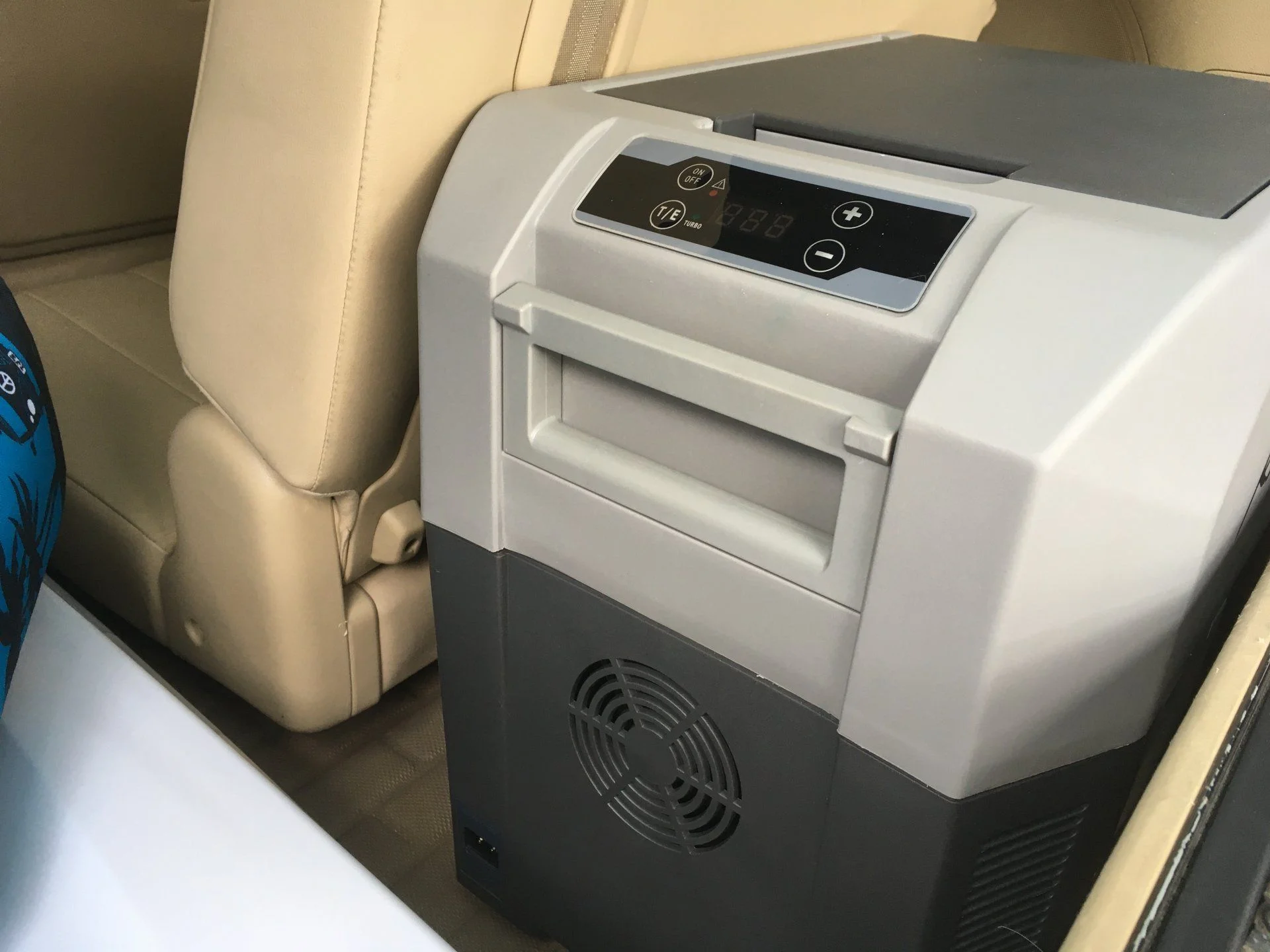

I can confirm that the Kalamera 25L (26 quart) model KRC-CR25DAC fits behind a deployed 3rd row jump seat, with the seat at a 'comfortable' two and three clicks. It also opens enough before the headrest gets involved to get a drink out. Has left right movement, but only about 1/4" forward back. There are no vents on the long sides, so this is perfect. It isn't obvious from the pics, but the lid has a push interlock on it to open.
Aside from being a generic, and only 25L capacity, a pretty good basic solution.
Resets to 0F after a power off. Comes with a 120v 3a to 12v 9.9a ACDC power brick and a dedicated, separate Cig lighter plug.
Already doing double duty as extra frozen storage in the garage.
$250 delivered.
I found this one, but I can't find the exact model you posted:
Kalamera 26 Quarts Portable Refrigerator Freezer Compact Compressor Electric Cooler DC Mini Fridge for Car, Office and Camping Amazon product ASIN B07PKBPK7S
That is the one I bought. $250 prime delivered. Shipped out of southeast.
From the Fridge manual
12v 4.1A or 24V 2.4A
Input voltage 10.5 to 31V
ACDC 12V 5A 50/60hz 100V to 240V (Never mind that included a 12V 10A in the box . . .)
18.9" x 12.99" x 16.73"
Pictures never do it justice, and I don't have any from the really tight ones as I was focused on the road. Used the front and side cam to make sure I was on the road. Side cam in particular was useful to keep the tire well away from the edge.
Trip looked fun! I use the camera like this all the time. I've got enough width that I can see the front tire. I tilt my passenger mirror down so I can see the rear line too. For driver's side I usually just hang out the window :P
Trip looked fun! I use the camera like this all the time. I've got enough width that I can see the front tire. I tilt my passenger mirror down so I can see the rear line too. For driver's side I usually just hang out the window :p
Yeah the side video was key. Four inches of brown, two inches of green/rocks, and then black/blue for the void. I had to run that stretch on an in and out, so much easier up hill with driver on the cliff side, than downhill with passenger on the cliff side.

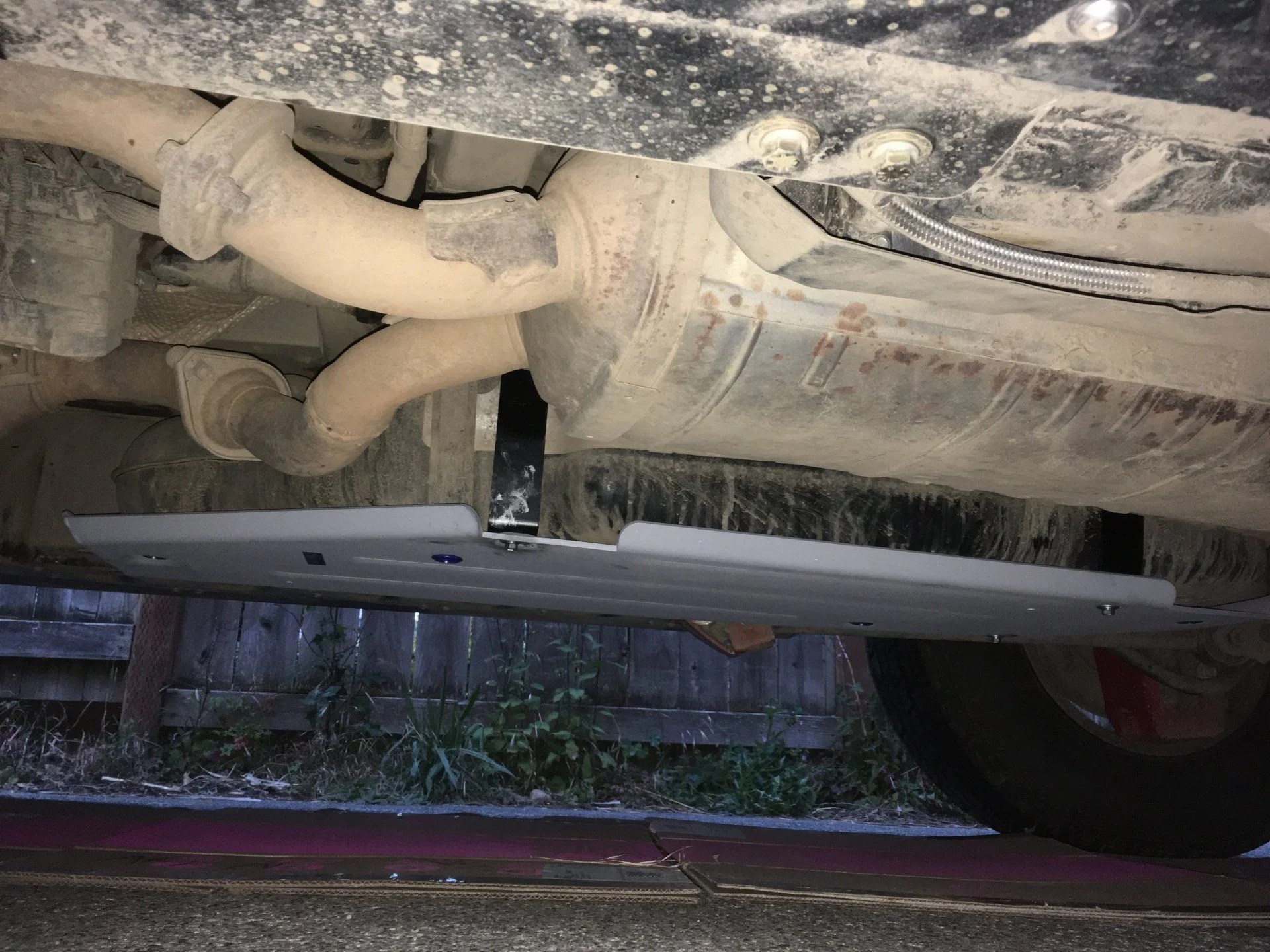

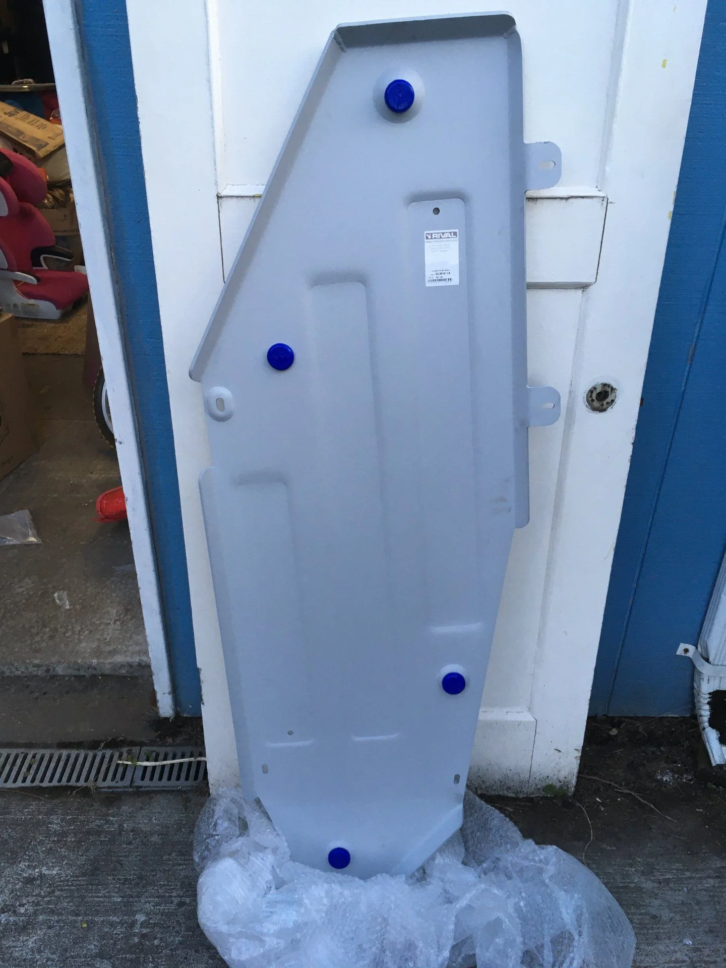

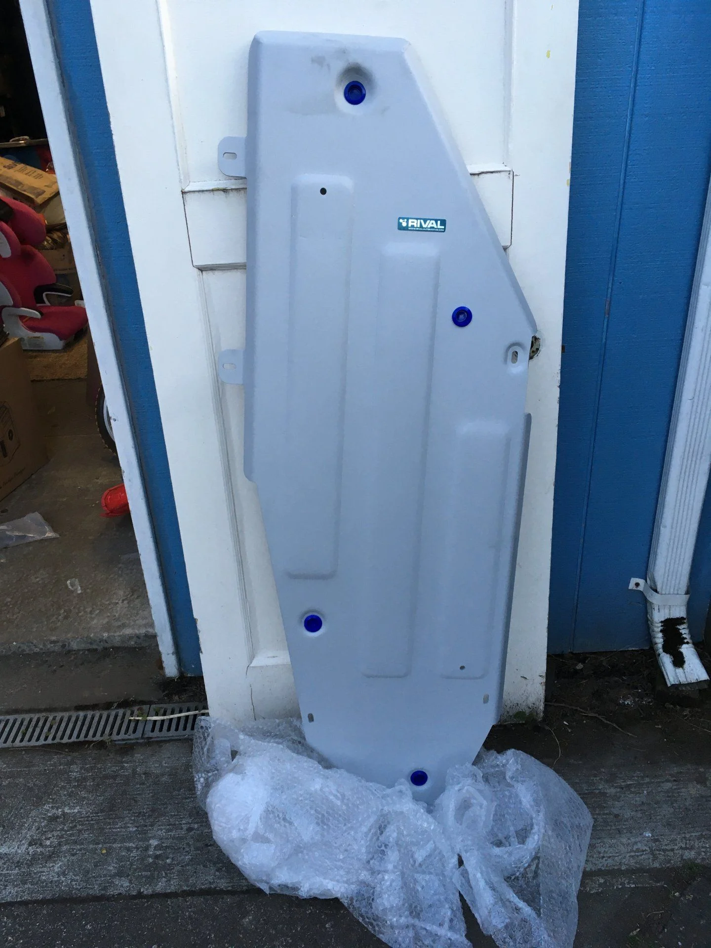

Have the rival fuel skid on. Took around an hour. I had to pull the transfer case skid, as it has a support the crosses the gas tank area. Still need to remount that.

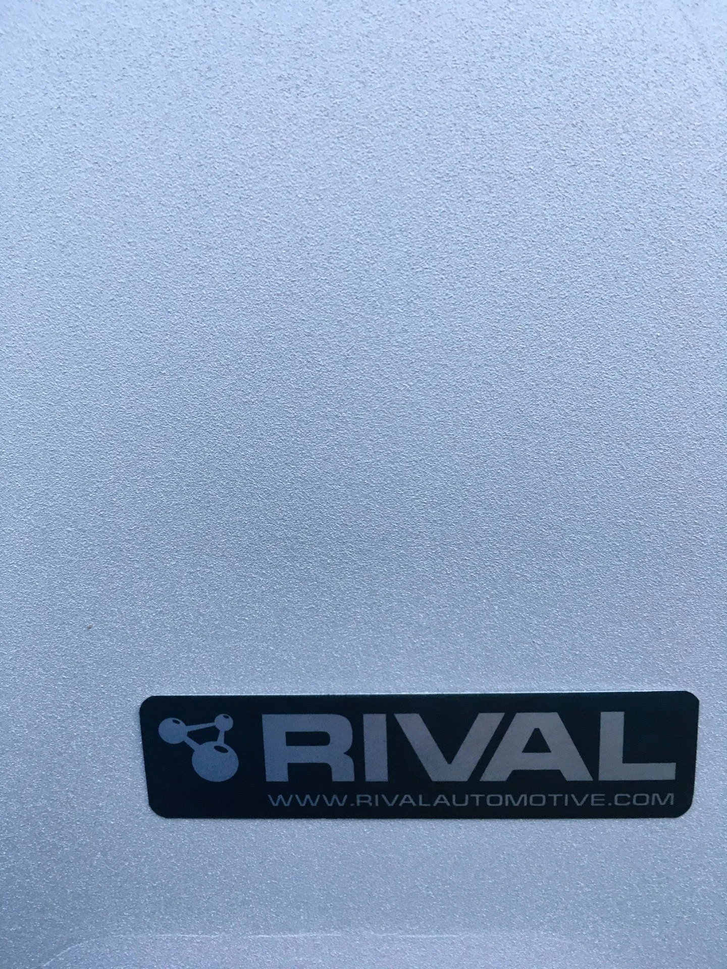

i like the Rival part. It’s got a nice finish on it and the install bits are well thought out. I used stainless bolts, but otherwise their install kit was correct and complete.
Rival skid 20.2 lb. Stock skid 16.8 lb. Net diff 3.4 lb plus the three custom brackets, so under 5 lb total.

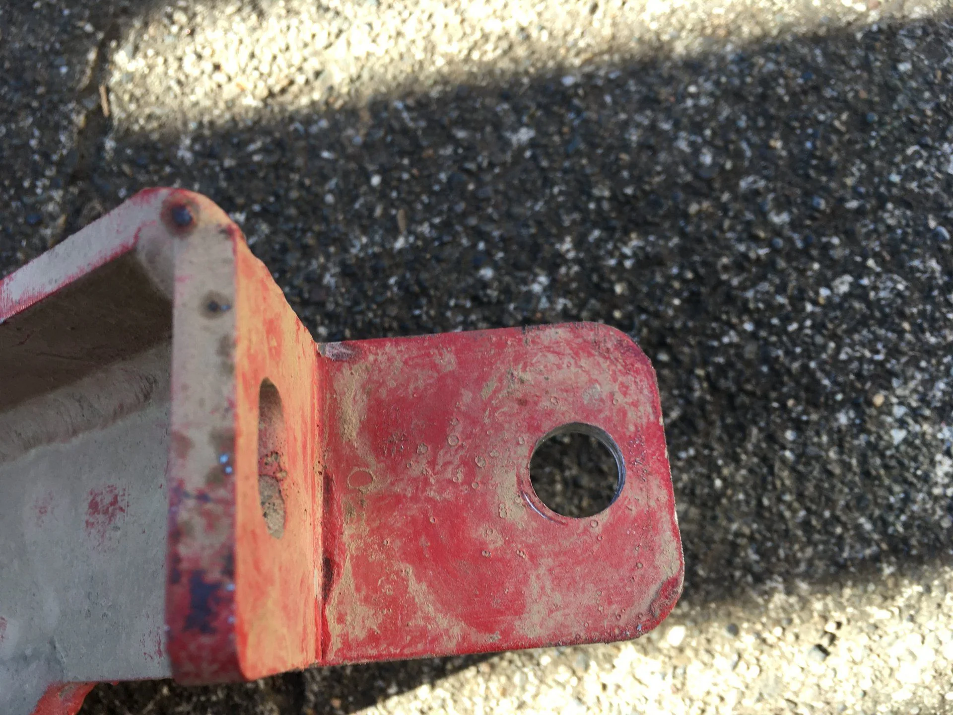

Got the transfer case cross member brace up. Had to trim a small bit from the reinforcement as it was hitting the new gas skid. Also drilled a hole in the other end so I could put the bolt back in my slider mount. I knew it was coming off again for the fuel install so didn't do it last month.
Asfir included a nice adapter for aftermarket fuel skids and after trying it several way I was successful in figuring it out. Should have no problem putting the transfer skid back on tomorrow and then looking forward to RLCA #2.
All done with the skids. Also bought 2 ft of metalized blanket to shield the exhaust on the outside chance the newly exposed upper fuel tank could get heat exposure. Will hope to install that next weekend.

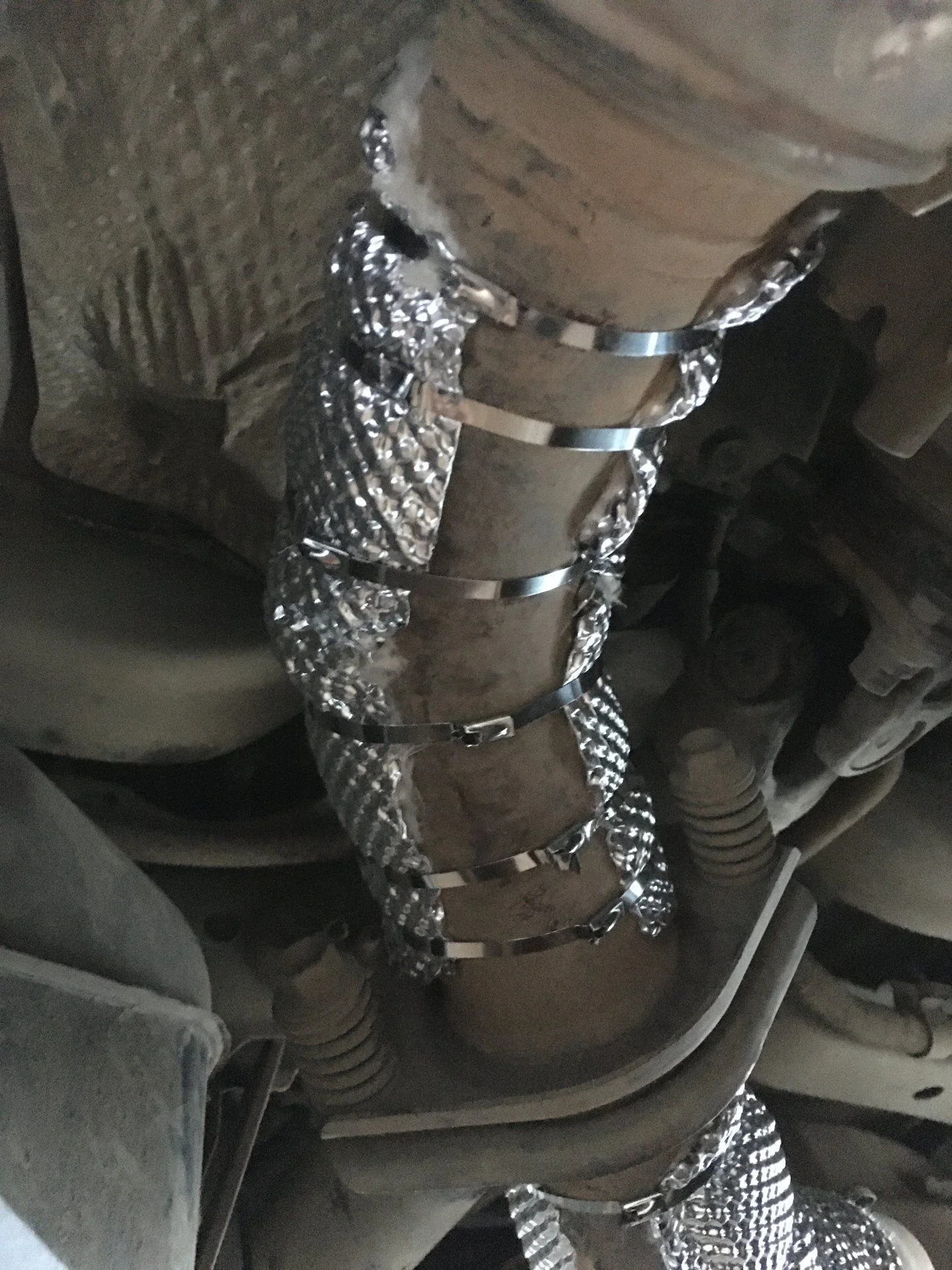

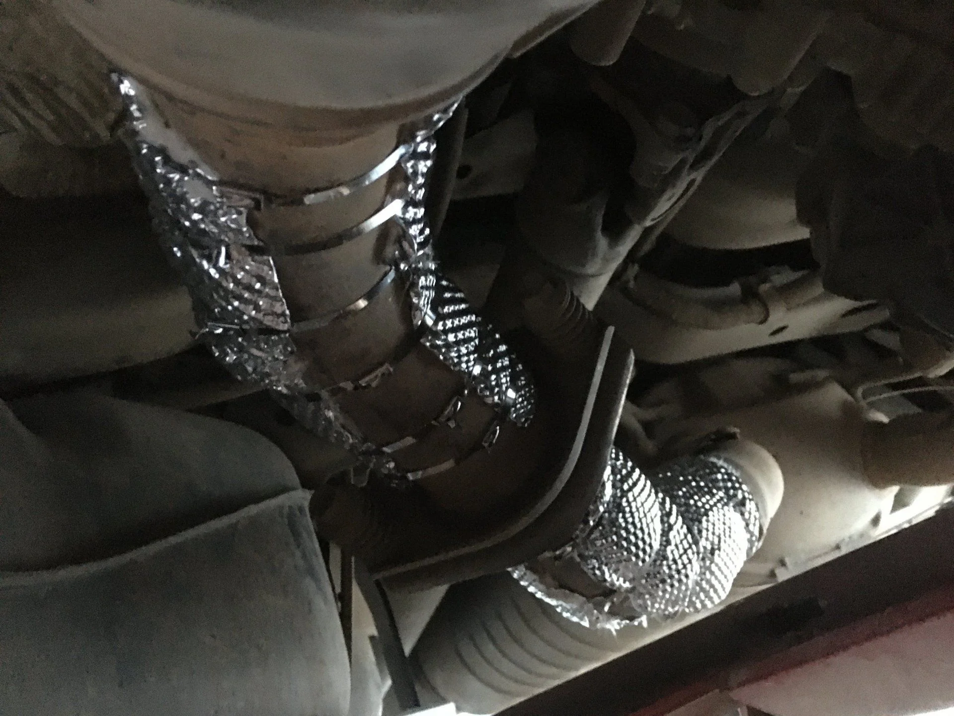

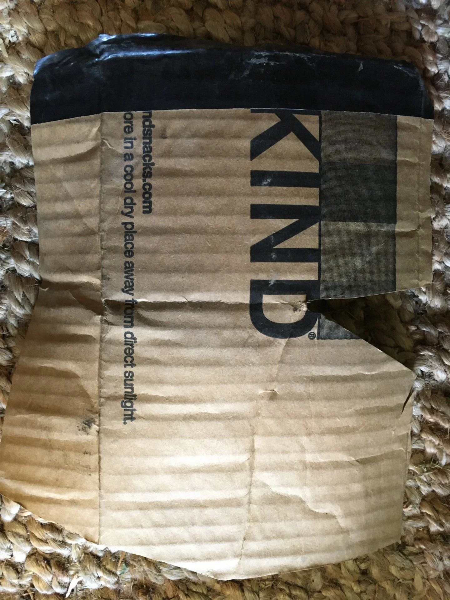

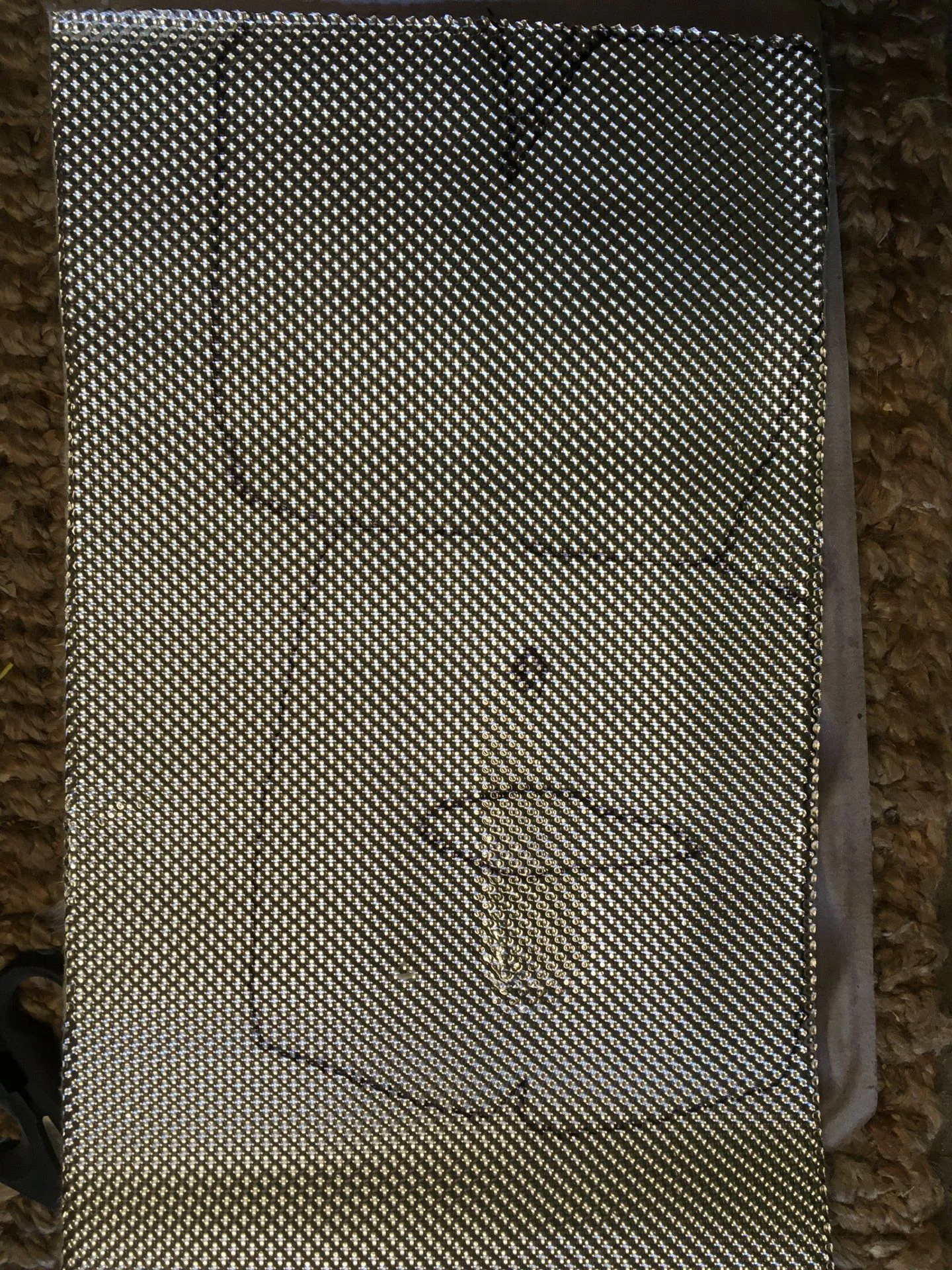

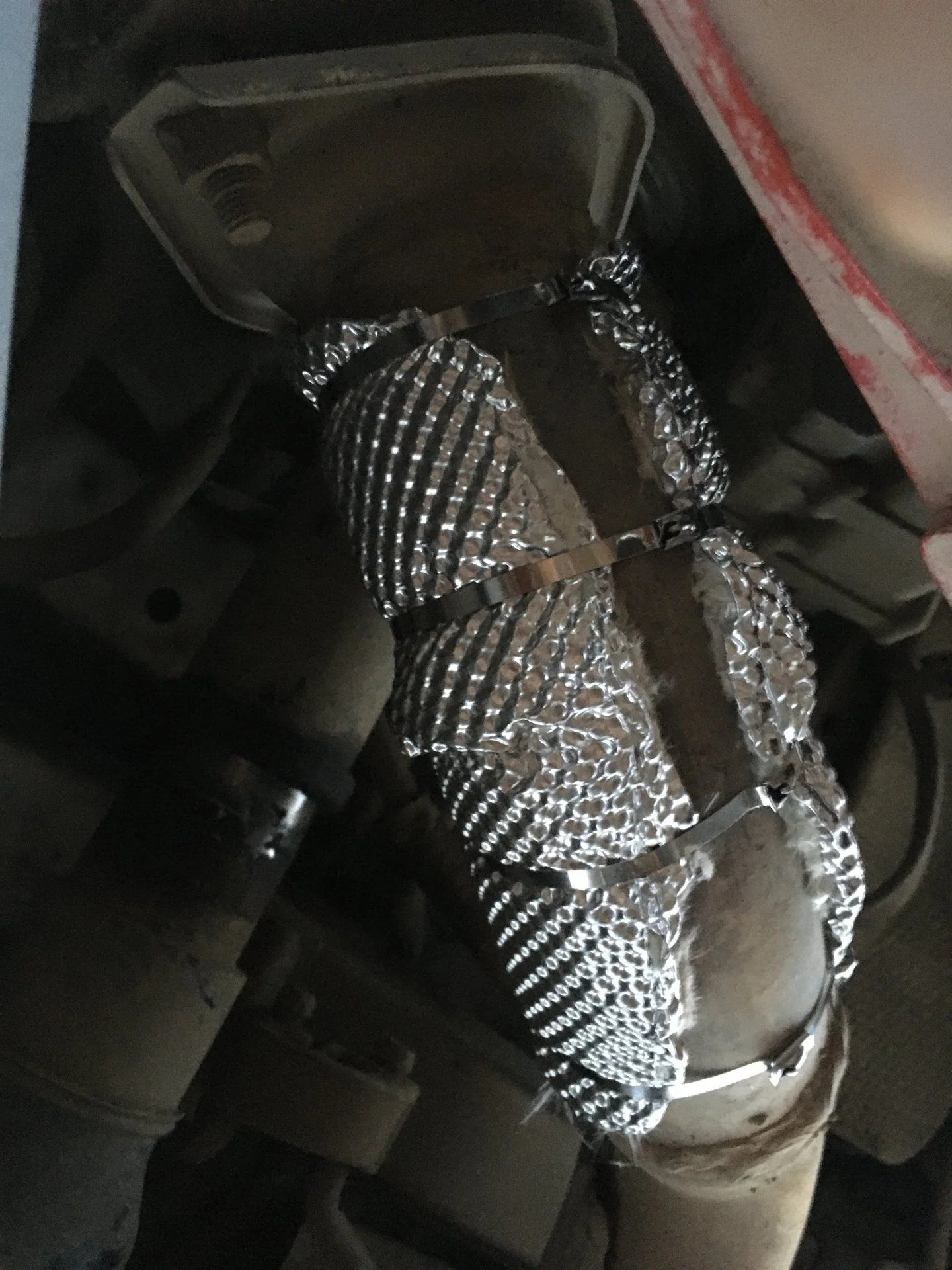

On a 'hot' tip from @Taco2Cruiser , I added some heat shield to the mid-pipe where it passes near the Transfer case and Fuel tank. The blanket came with a nice double sided instruction set, and 2 feet cost about $50. I like this solution a lot as it also provide protection to the transfer case, which heat shield is dependent on the transfer "skid" for bolting up, that skid I removed when I put in the Asfir Transfer Case skid. I also met my new best friend on this job, stainless zip ties, where have these been all my life? So on to the details:
*NOTE FIBERGLASS HANDLING RULES APPLY*
Make a template
Cut it out
Cut out a perimeter of insulation and fold over
ZIp tie it up
Sleep easy
