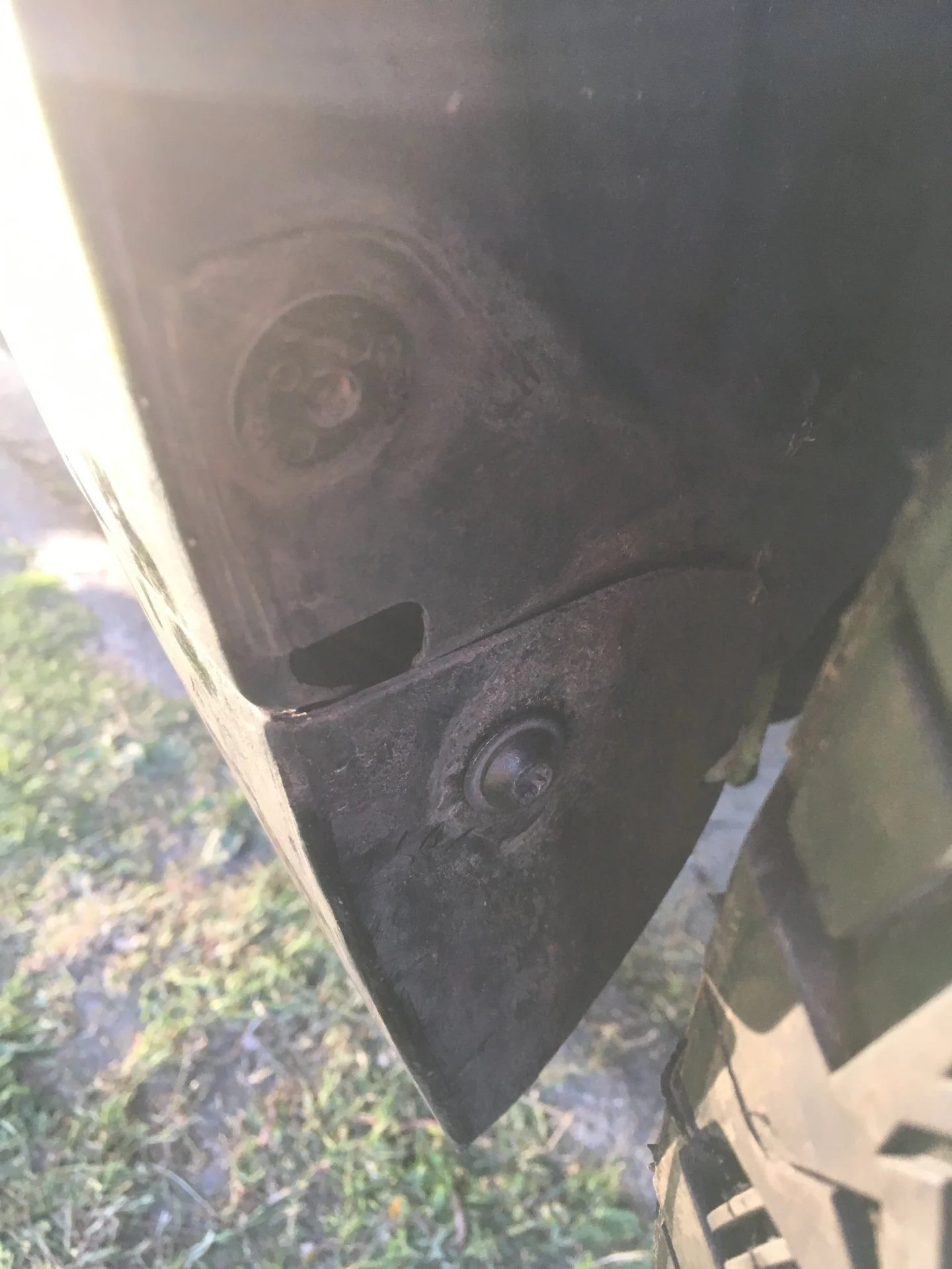

Passenger side a quick fix. Just twisted the bracket off with some locking pliers. Two spot welds snap easily. Cut a contour with scissors and drill a couple holes. 10 min tops.

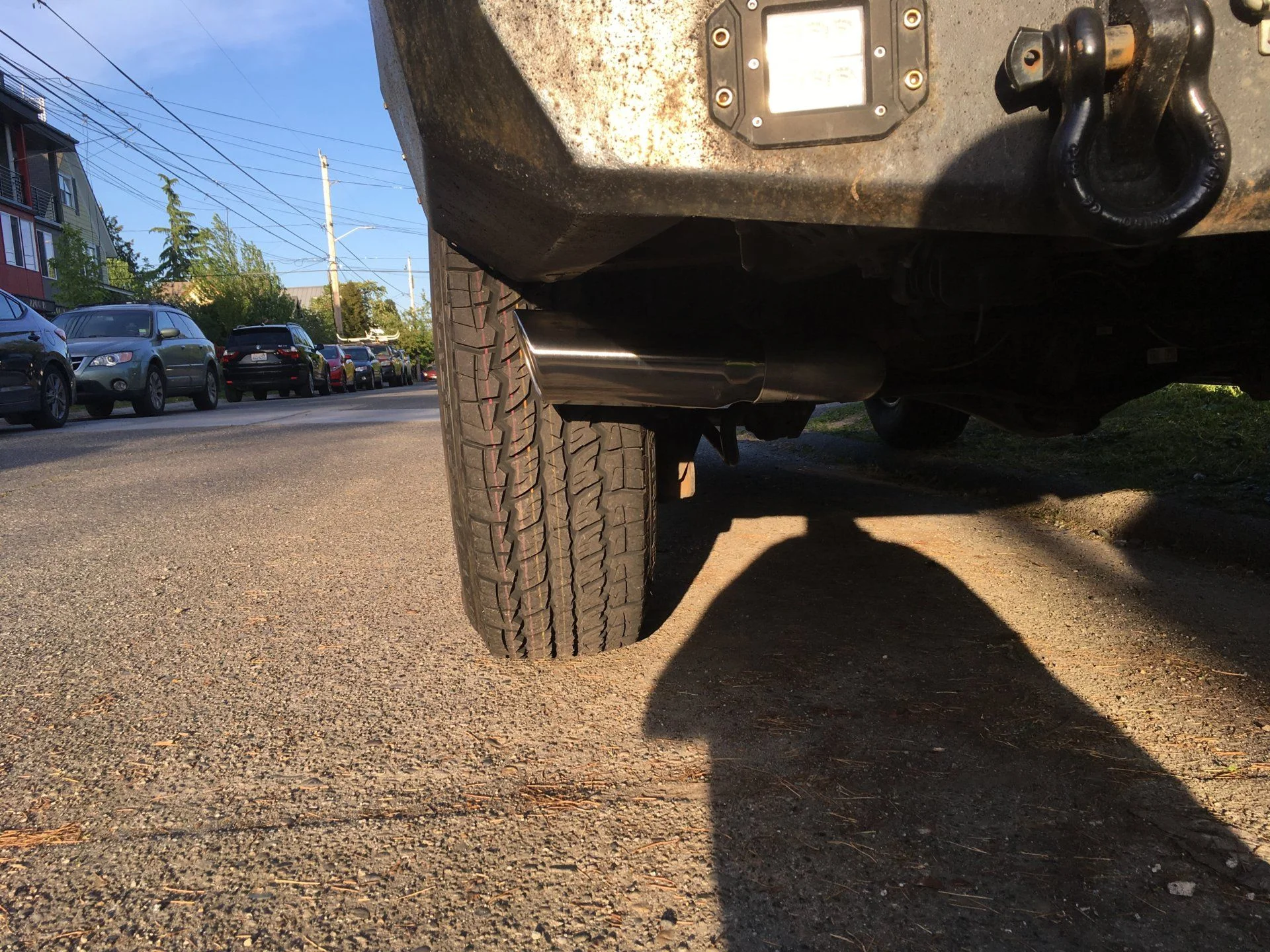

Next up exhaust tip!

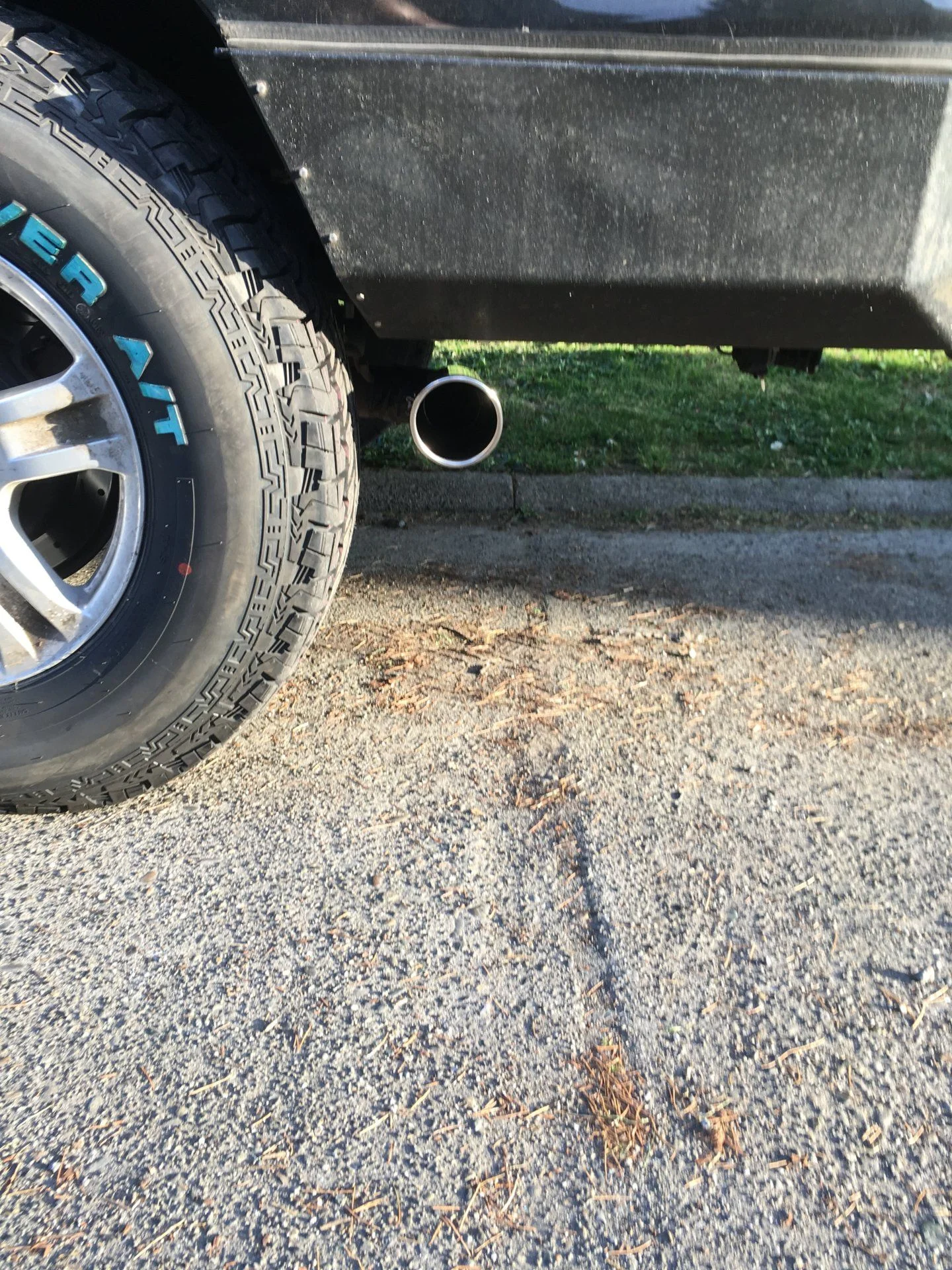

Info for posterity. If you chop your resonator, the size to buy is 3” od. It isn’t exact, but better than 2.75. All you need is a 90 and a tip in 3”. You then decide how close you want to the tire and clamp it on/weld it up.
The car pipe to 90 you have to weld there isn’t enough to room for a butt clamp. Believe me I tried.
Exhaust tip just clamp on or weld on. There are a bazillion styles. I went with a 3” to 4”.
Amazon didn’t have a black option with a good clamp so I have shiny stainless.

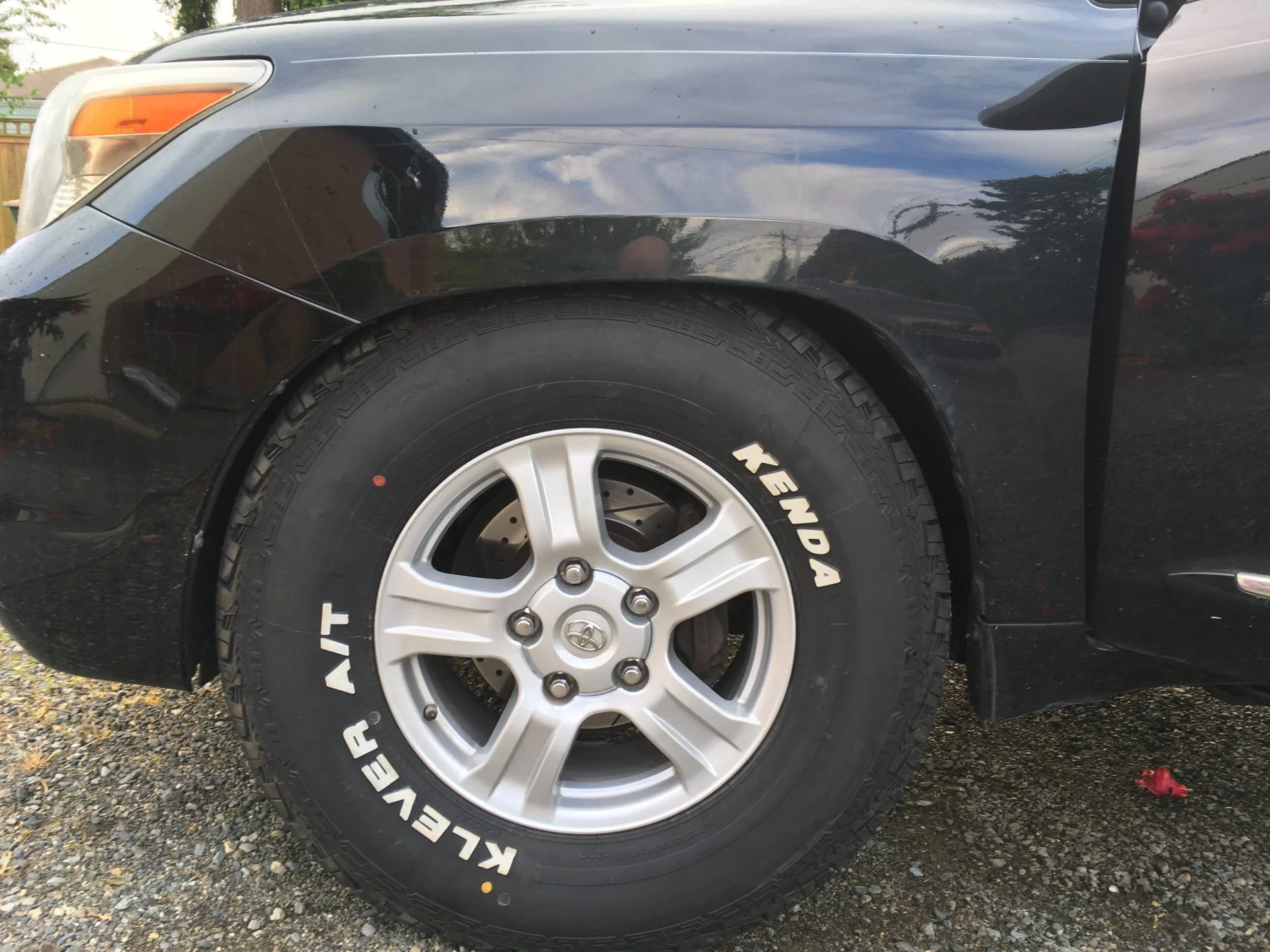

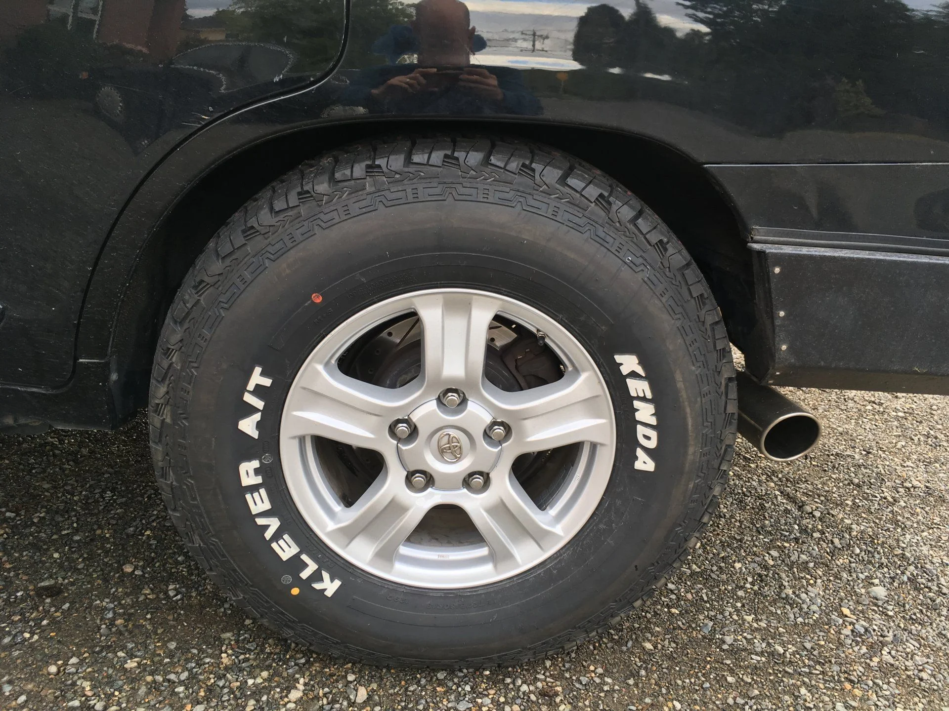

Have a couple hours on the tires now and can post first impressions.
They are pretty quiet. Obviously they are still super new. There is some tire noise at freeway speed, a background white noise. It is low in volume and not an unpleasant sound. I’d call it normal to quiet for an AT five tread style tire.
Compared to the duratracs, it is both quieter and different in characteristic. The duratracs started a low hum around 35 mph. There is none of this now. At 35 mph with the windows down these tires are completely silent.
Rain - good as expected
Dry - good as expected
Handling and ride. They are an 80 aspect tire. The ride is more compliant than the duratracs, and less compliant than the p rated Michelin hp tour. I can use “sport” mode without it being very harsh, which the duratracs were. I can use comfort mode and it isn’t too bouncy.
They don’t corner awesome. Fine, but not speed racer. This is to be expected from an 80 aspect.
It took a couple days to get the pressures to stabilize.
Summary perfectly fine and nothing unusual to report.

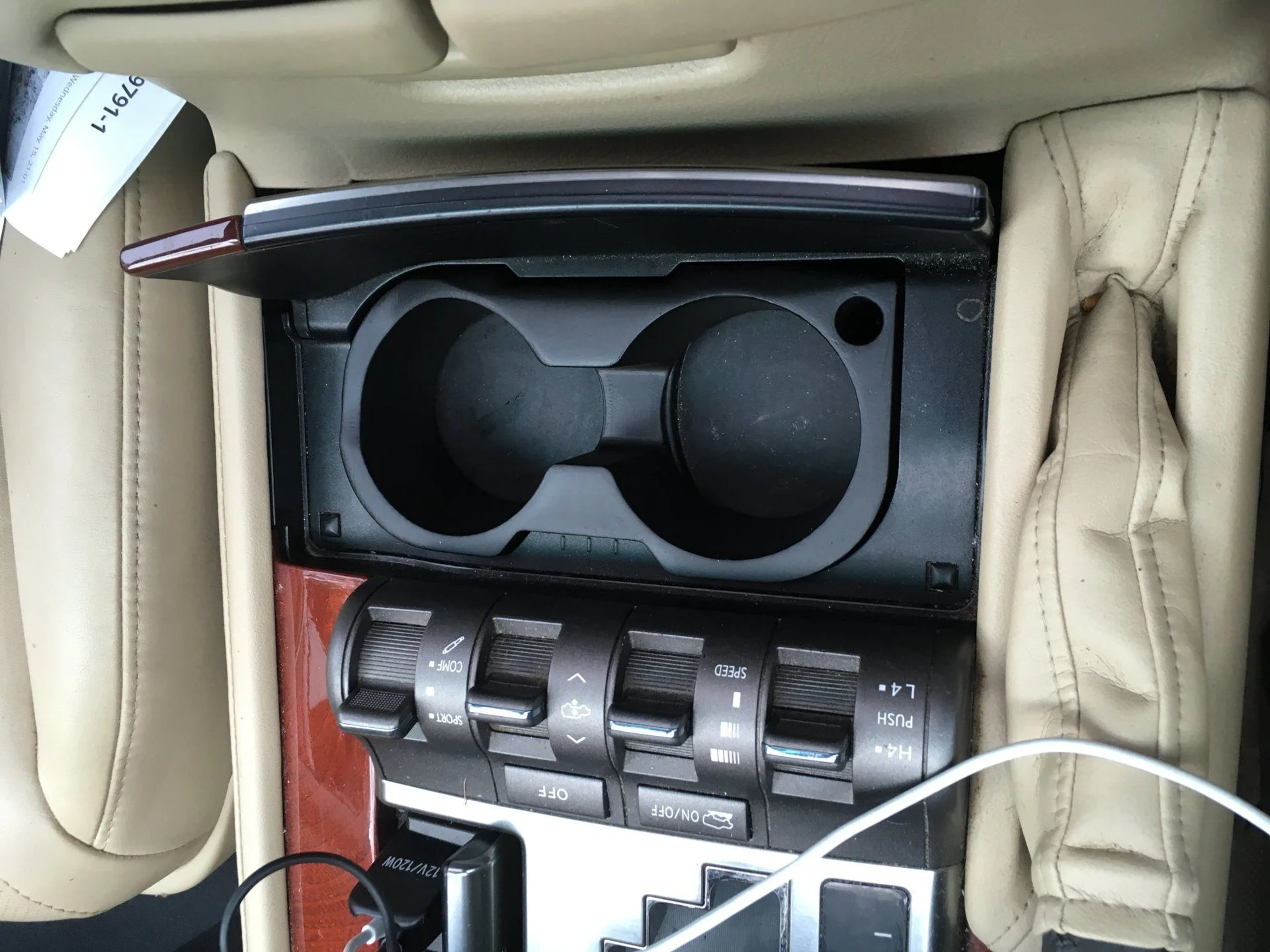

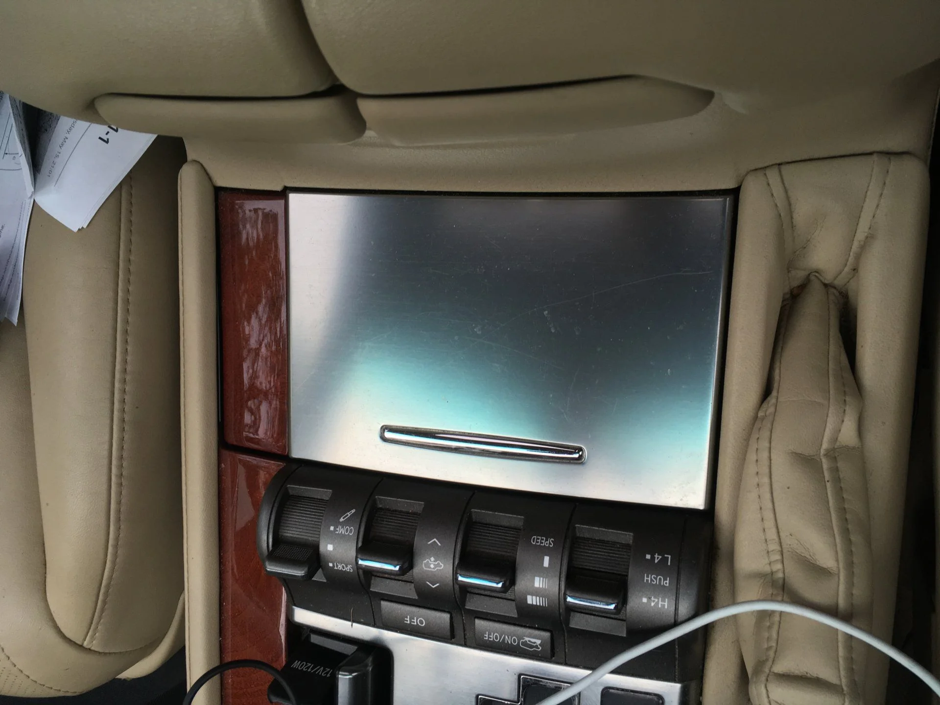

I can go into low mode. I have had driver front a bit lower since I got the rig was putting off addressing until tires were sorted as it requires an alignment. I will need to do a calibration, it lowers to about one finger space to upper fender, and I can’t turn the wheel more than about 1/2 way. Others corners all have plenty of space.
This was expected. Stoked that a simple recal or minor sensor adjustment will address.

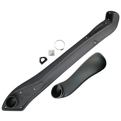

And got into a conversation with a coworker on dorkles and ended up buying one. Went with an off brand - like that it enters the fender sooner.
Ships from Malaysia, made in Thailand, says it fits ALL LC200 engines (4.0L, 4.7L, 5.7L, 4.6L and 4.5L) and:
Notes :
- Not Included Installation Guide or Manual
What could possibly go wrong?

Super easy install on the 35s. Stay skinny and use a 35 to 45 offset and profit.
Notes :
Oh absolutely. LOL. But seriously it’s pull the wheel and liner. Put on the template. Measure and remeasure and then cross your fingers and cut.
This one runs the horizontal bit above the wheel liner in the fender and reuses the existing entry for the air box.
I bought from an amazon seller to make return easier. Just in case . . .
I heard that you like tall and skinny tires:
255/100/r16!
Dorkle here already. Box is five feet tall
The dorkle connections are around 4" ID. The vertical downtube is 55" long. The inside the fender piece is 22" long. The inside the fender piece is 15" center to center on the holes.
It's friggin huge.
