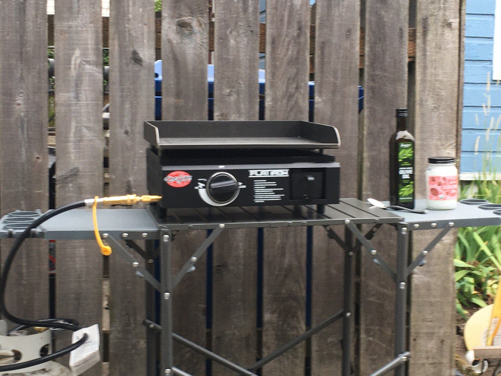

Seasoning the new griddle, and giving the popup table and LP quick connect adapter a try too. All seem a go. Definitely 1 beer work.
Ive been looking for ideas, as I am outgrowing the little cabelas table. How does that table look in the car? I’m trying to get an idea of size when folded. Dimensions would be great!
And looks good!
And looks good!
It’s not small. The size of a folding chair? Plenty of space when open with quite a lot of shelf. Also another version which has two more lower shelves on the Side is available
sourced from amazon traveling under the cuisinart name.
easyup and down, less than 30 sec
Amazon product ASIN B079BCGVST

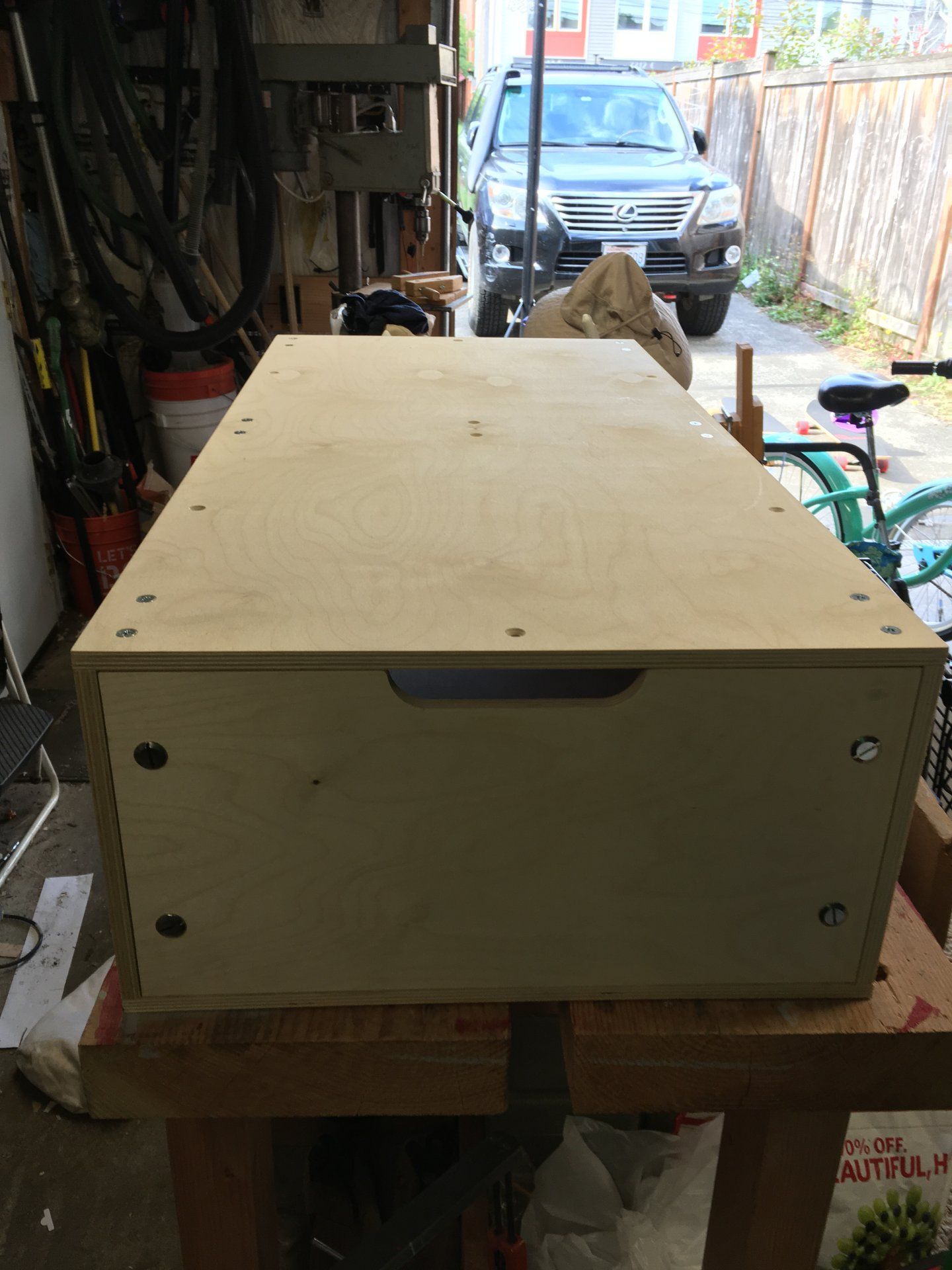

Spent 25 minutes on the reef single install. Worked on the anchor. Using the inside of the two seat latch bolt, the outside edge of 3" aluminum bar is 3 7/8" from the inside edge of the bottom frame (center 5 3/8). I drilled the holes in the center of the bar stock. Need longer 10mm bolts to attach. Decided to run the drawer about 1/2 way over the plastic trim at edge of hatch.
Got the Reef drawer built. Had to sand the dado and drawer bottom to get them to fit. Tolerances very tight. I dabble in wood working so nice to have a project that doesn’t require much thought And fiddling. Glad to have a good assembly area though. Definitely recommend a sanding block and some 220 grit.
ordered some 65mm m10-1.25 bolts for the anchor plate.

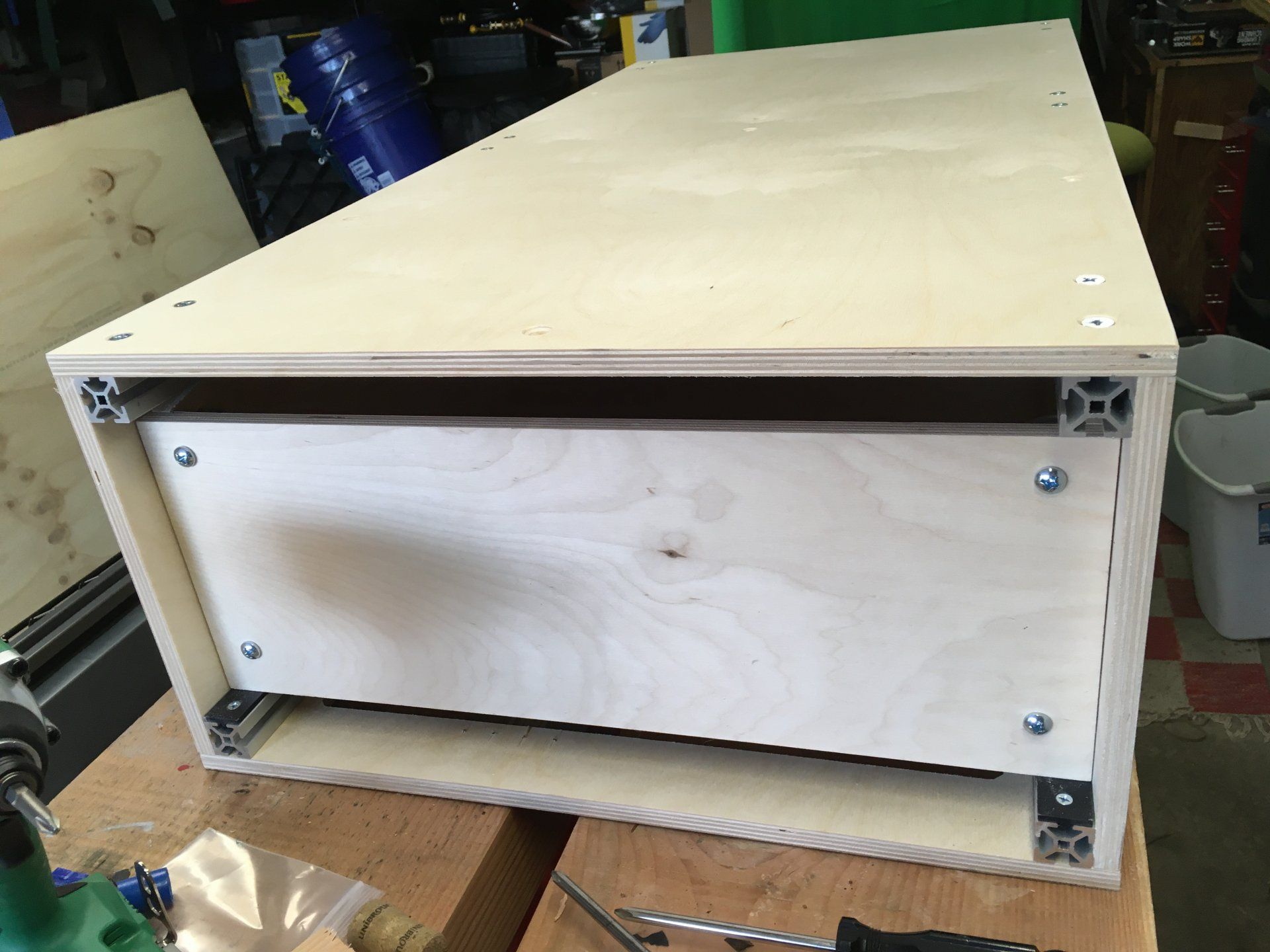

Reef 1 finished. There's no back?
I grew up in a cabinet shop, and I must say, that's a very odd way to make a box. If they're using the T-bar for support, they could have just upped to 3/4" plywood and it would have been just as strong (maybe stronger). Defiantly cheaper.... No slides? Just friction pad on the bottom?
Yeah it's an interesting design. Clearly meant for ease of assembly as the primary focus. No glue to be seen. Seems plenty sturdy. I will djinn up a back along with the wings.
I wanted to save time on bespoke drawers. And aussie metal based options all Sooo heavy. So mission accomplished!
There is no back.
Not for long! I don't want something getting wedged in back there. I have a 1/4-20 tap somewhere. I think path of least resistance is to just tap the center hole on the back extrusions and screw on a piece of ply. Will do that when I fit the wings in. Denied on install today as my m10 bolts got delayed. Just as well, I'm waiting on the tie downs, it'll save one install and uninstall of the 50 coming.
@grinchy, I found the aluminum hole in the center of those extrusions to be soft enough that you can thread a screw directly into the center hole without tapping.
I found that out by trying to build my first box without reading instructions and bolted the measurement tool/spacer to the back of the box. I figured it would add rigidity. :). ooops. maybe reading the instructions is a good idea. I also got to take them apart again to set them up as double (tops and bottoms are 90 degrees to the drawers in the dual config).
I kind of like the back being open: it hasn't created any issues for me, plus it keeps it lighter (I can still remove my double boxes by myself).
Cruiser Dave could probably explain better, but he was working with some pretty specific design parameters around ease of assembly, minimal tools, flat packing, ability to customize, controlling cost to end user, etc. Someone with skills and tools could definitely build the same dimension carcase with woodworking joinery and no extrusions:. In which case, that person probably wouldn't buy this kit, they'd likely just build their own. I've built a lot of stuff, but am not a skilled cabinet maker, so I preferred the ease of assembly of the Reef setup. I think the price is very fair for what you get, I was good with paying Dave for his innovation, design effort, labor and high quality materials. I imagine if you had woodworking tools and skills, you could build it a lot cheaper. Sorry to pollute your thread, grinchy.
Found the tap, and a couple heater tees I'd misplaced, and my license plate lights too. Tapping in aluminum is easy.
