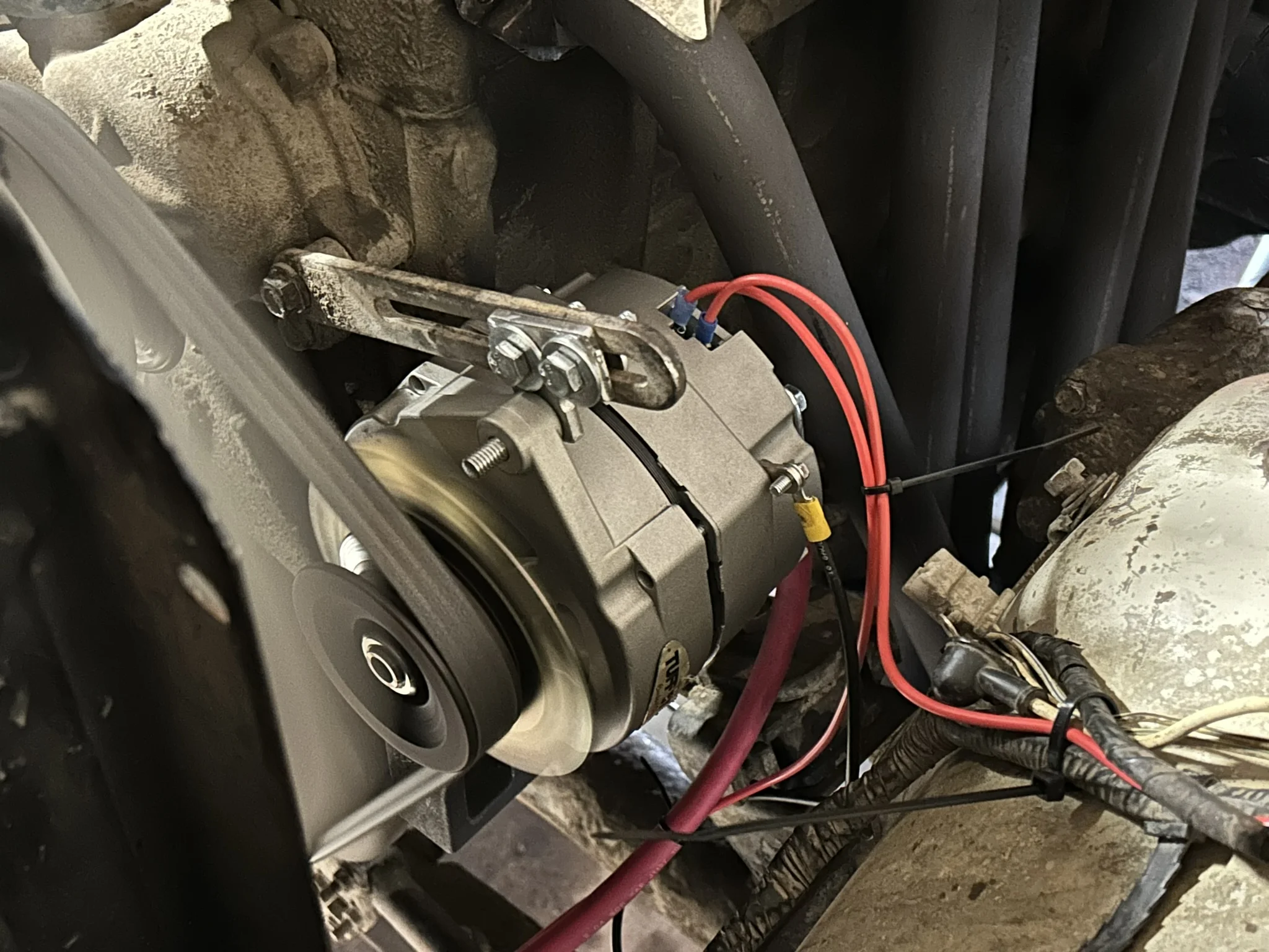

More progress today with the charging system primarily. Did some research and ultimately just went for it as far as picking an alternator upgrade. It is a 10si style 100amp unit, wired up in a factory Chevy 3 wire setup. All of the factory external regulator and alternator wiring has been bypassed and am running a basic blue LED in the dash for my charge light, conveniently where the choke cable was.
In order to bolt it in, I had to do quite a bit of modifying to the factory alternator mount off the block and another bracket to extend the tension bracket down. The whole factory mount got extended with new holes drilled and massaged to get my pulley alignment correct.
New charge cable is 4/0, kinda overkill, but cant hurt. This unit should have no problem keeping up with the fuel pump/Sniper, lights, future stereo, 2 way radio and any modest amount of AUX type stuff.

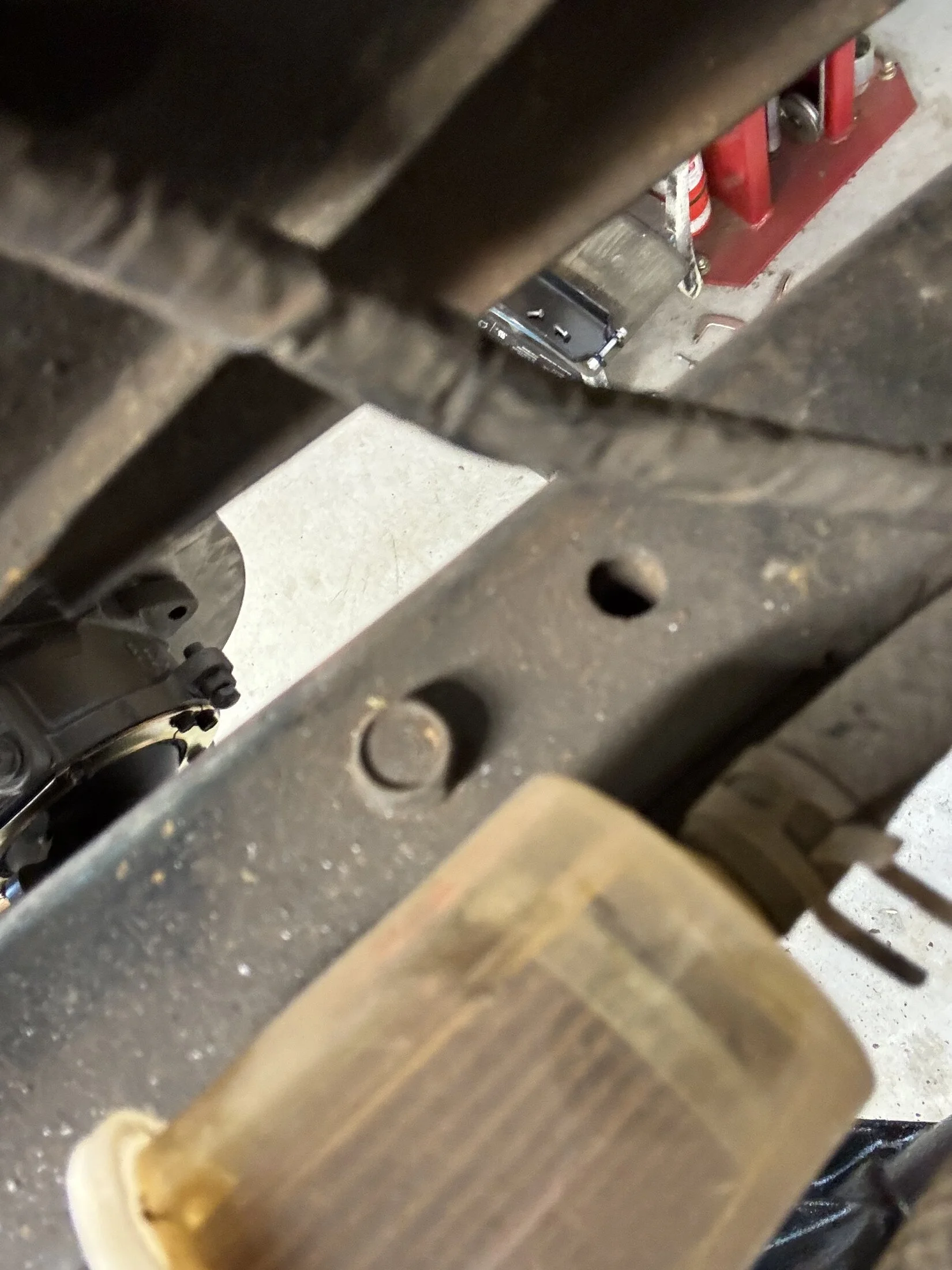

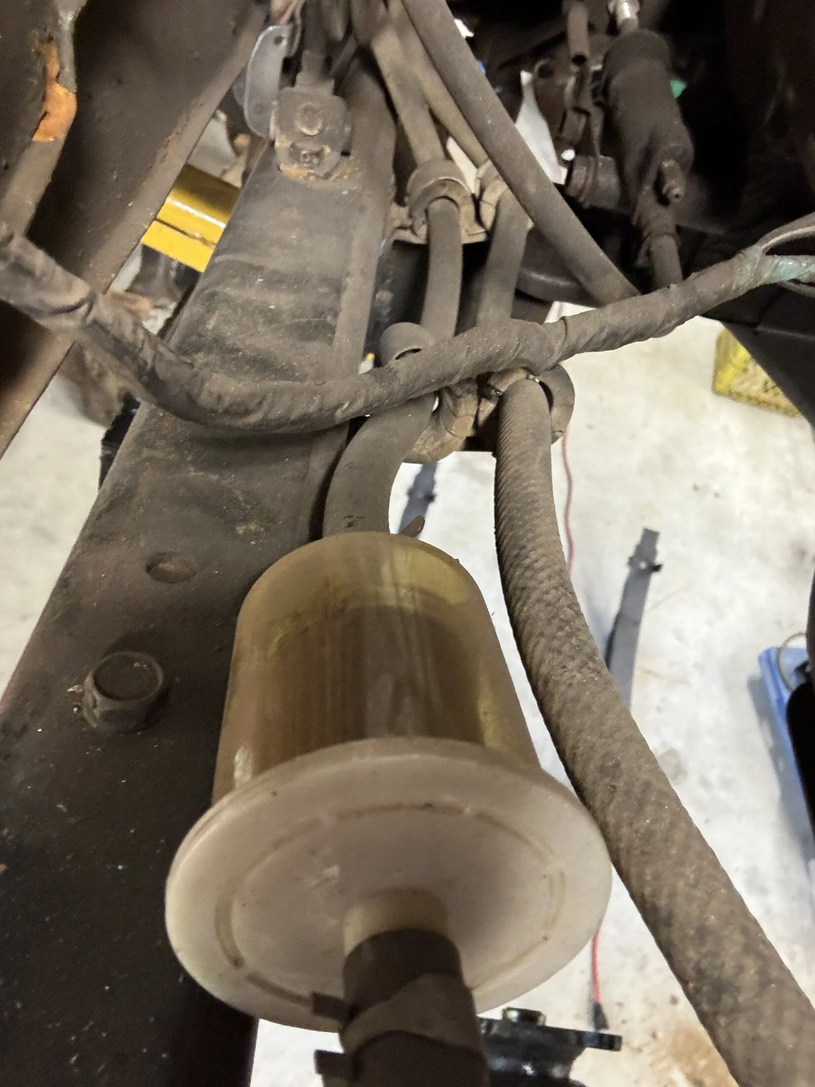

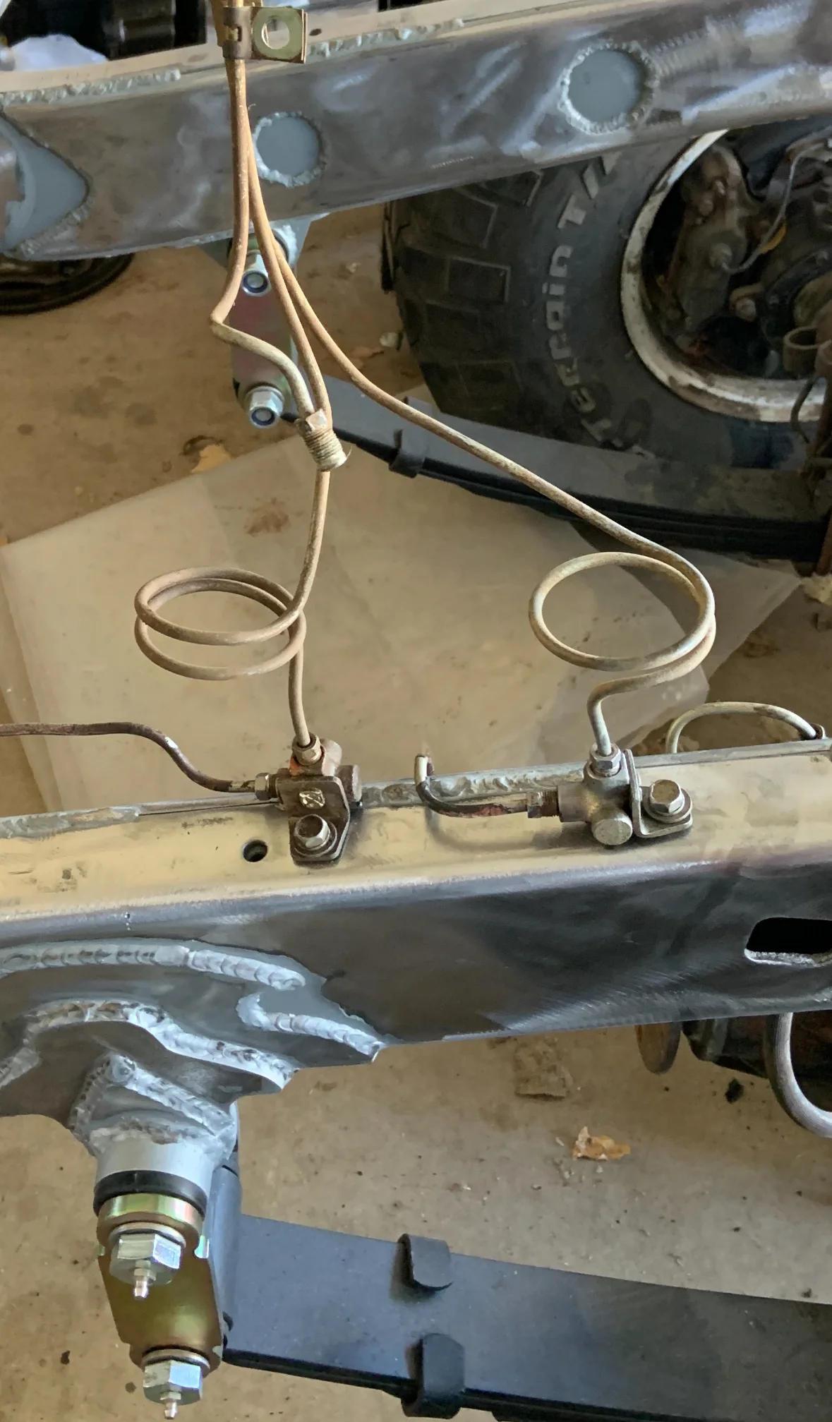

On my 72, I put my transition block down low on the passenger side of the firewall, than used nutzerts on the frame to hold the plate that goes from hard line to flex line. So hardline on the firewall from the MC, than hardline to the frame. If you were asking me, there were no factory provisions for another transition block.
Honestly was a good move to do it there, access was limited snaking in my custom bent lines around everything else going on in there.

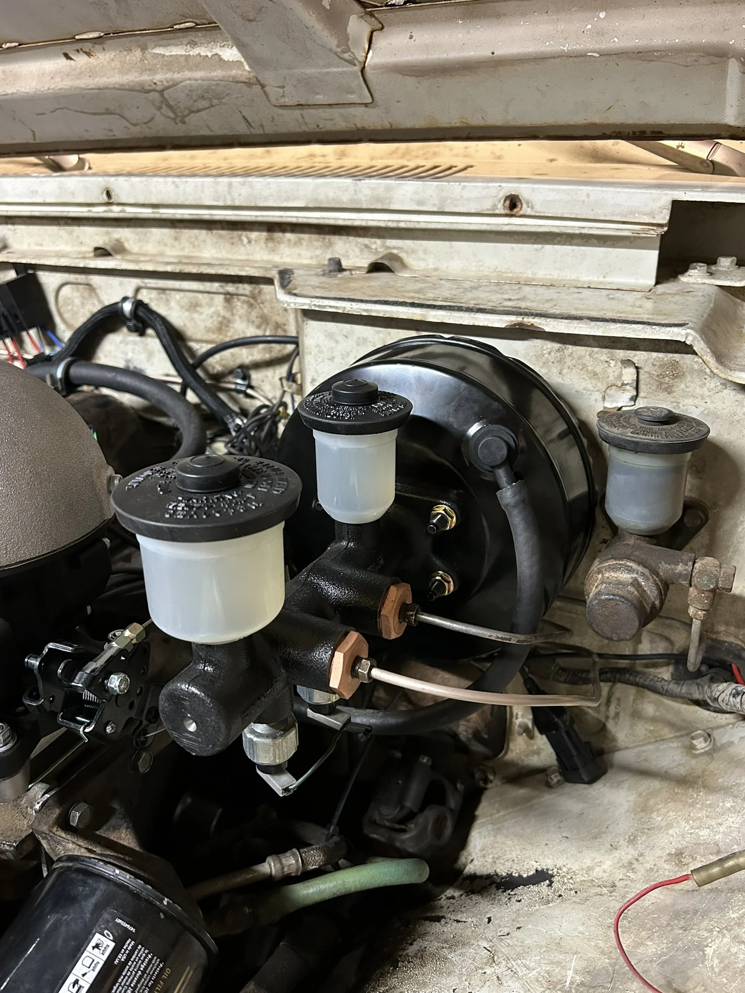

Lots of miscellaneous work done mostly this weekend. New City Racer Booster/ Advics master is installed and adjusted/working. Only had to redo two flares on the new passenger side front brake circuit. Moved the Sniper trigger wire to the factory ignition circuit so no more dropping out/starting issues when the head unit loses power from key on to key start. Also managed to get the stock speedo working. I purchased a new t case gear a while back but that did not initially fix it. Ended up the plastic section of threads behind the instrument cluster was cracked and not allowing the cable to stay screwed in. Wasn't sure how to fix it so I used a hose clamp to (fix) the threads and was able to get the cable to screw in nice and snug. Speedo and Odo both work which is super helpful . As I understand, there are a couple of different gear options, possibly to correct for tire size. I got a 16 tooth and have 33" tires but had not had a chance to compare with GPS.

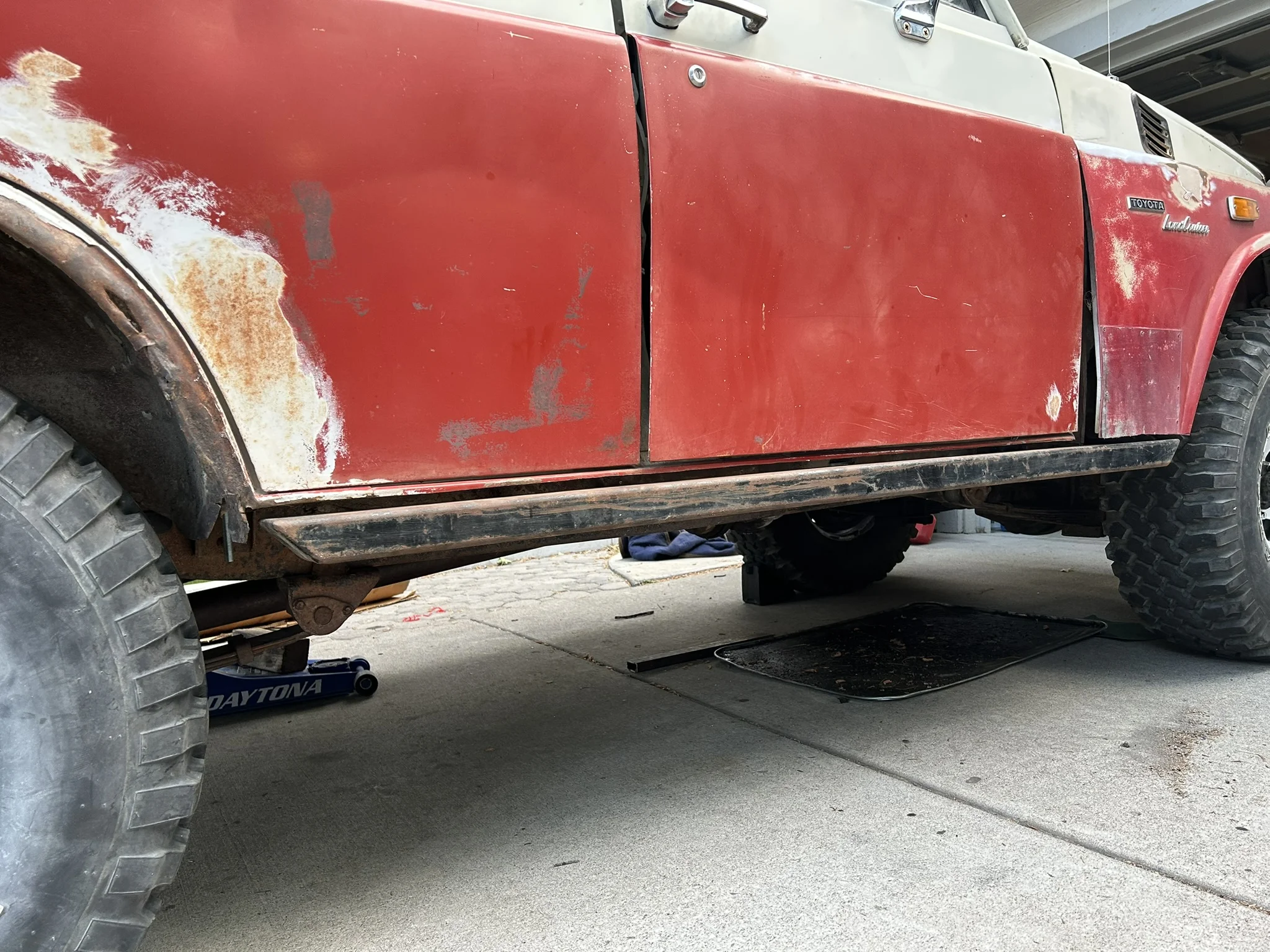

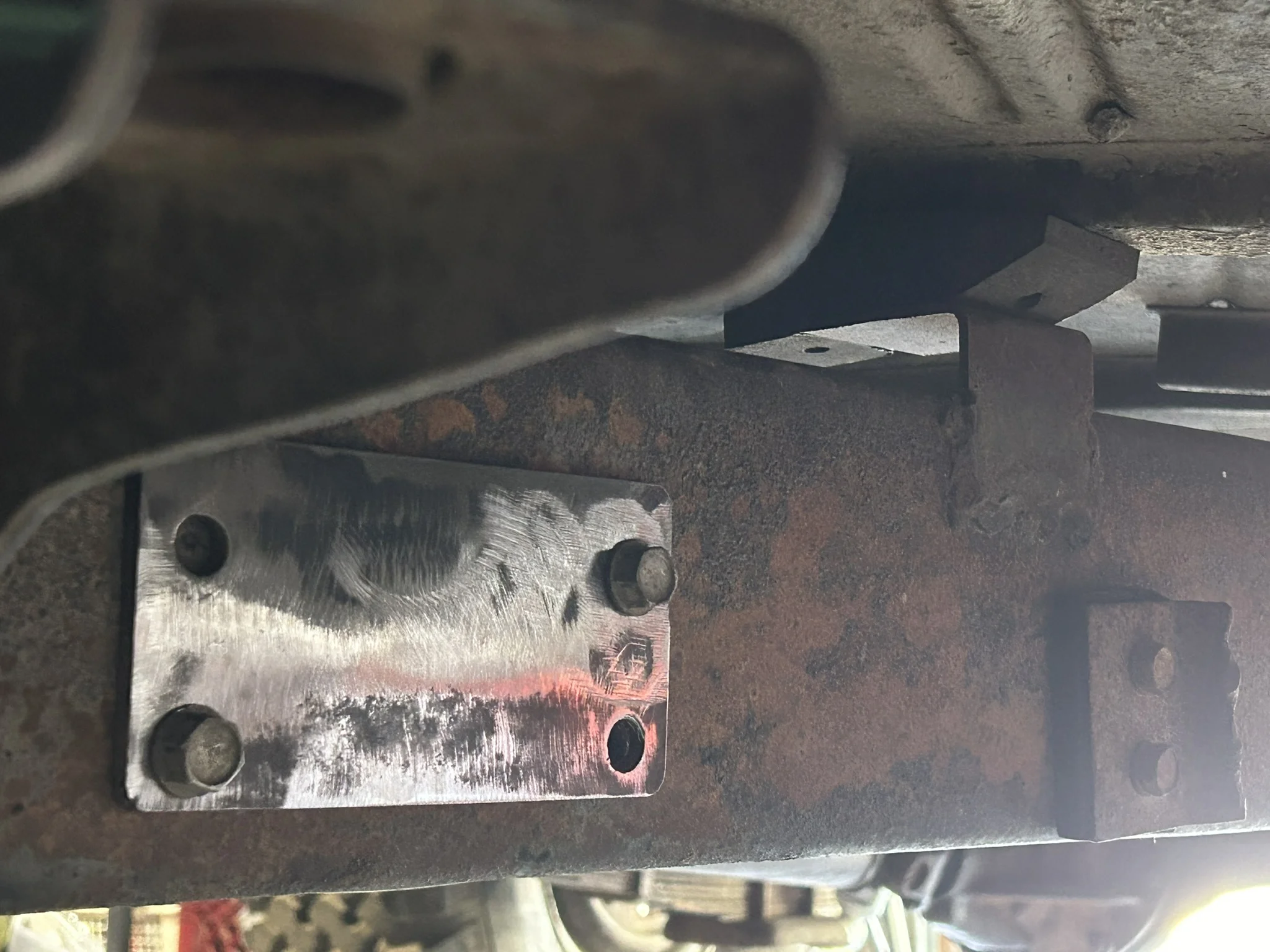

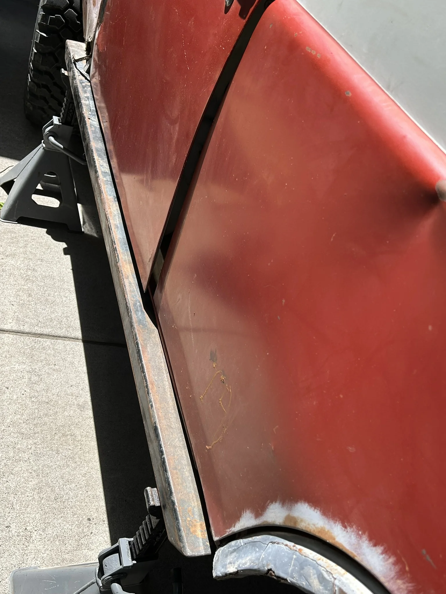

Mock up has started on my rock sliders. As you might expect, the original rockers were both rusted out and trail damaged. I cut them all the way out to just under the door sills. I had an old set of Jerp sliders that actually were the perfect length for the 55 so I will be using them. Of course, will need to make all new kickers from the frame using 1 3/4" DOM. I temporarily attached the 2 landing plates with big self tappers for mock up and initial fab, but will likely end up using grade 8 hardware and sleeves since the frame is boxed. Rock sliders will sit high and tight to the body.

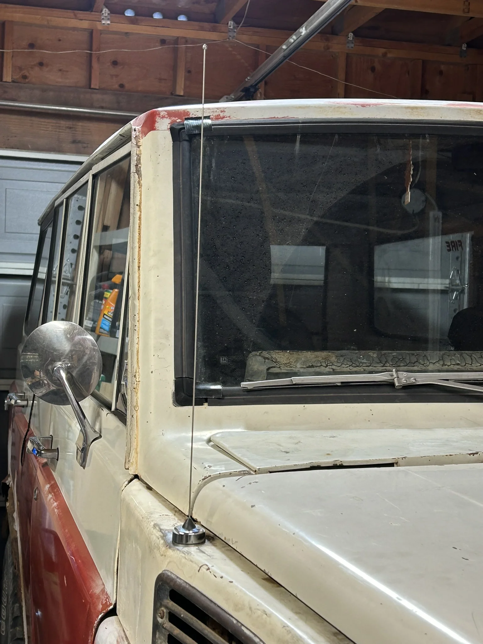

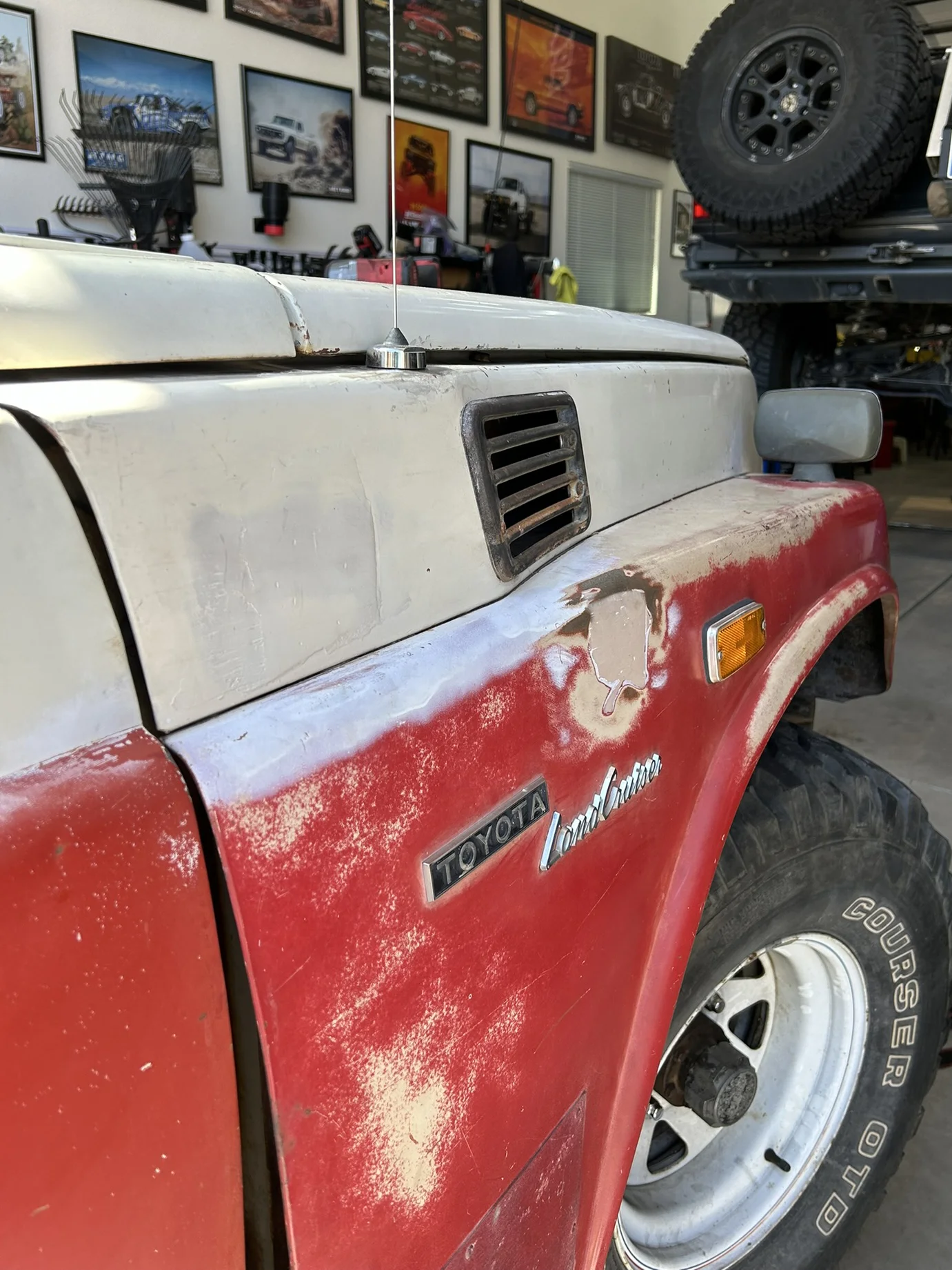

Stock AM radio antenna hole on the passenger side fender has also been modified for a common NMO style antenna.
1974 pass frame rail for reference

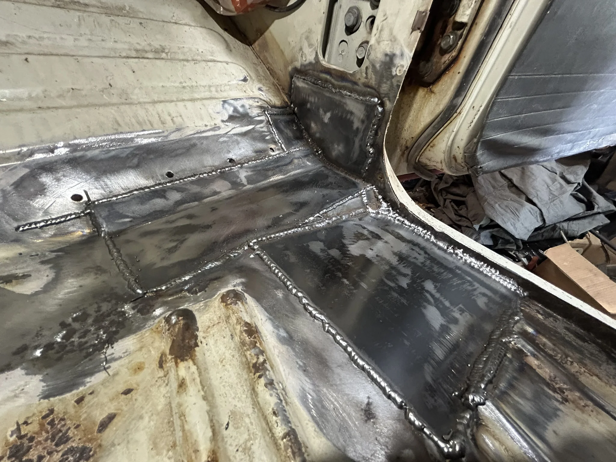

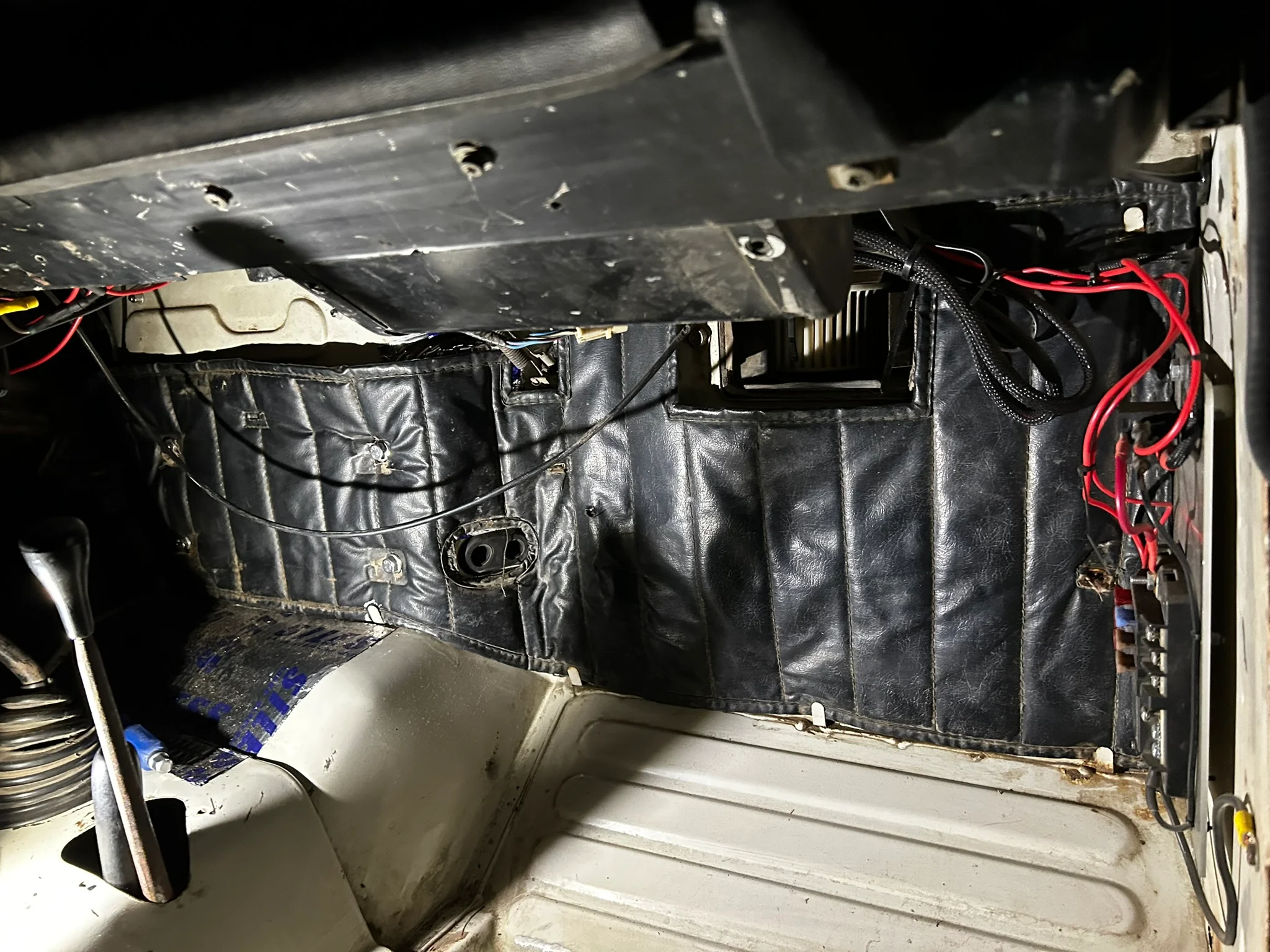

Its far from Bob M quality but the passenger side floorboard no longer has a quick escape hatch. Took a good chunk of the day but its more metal than was there previously.

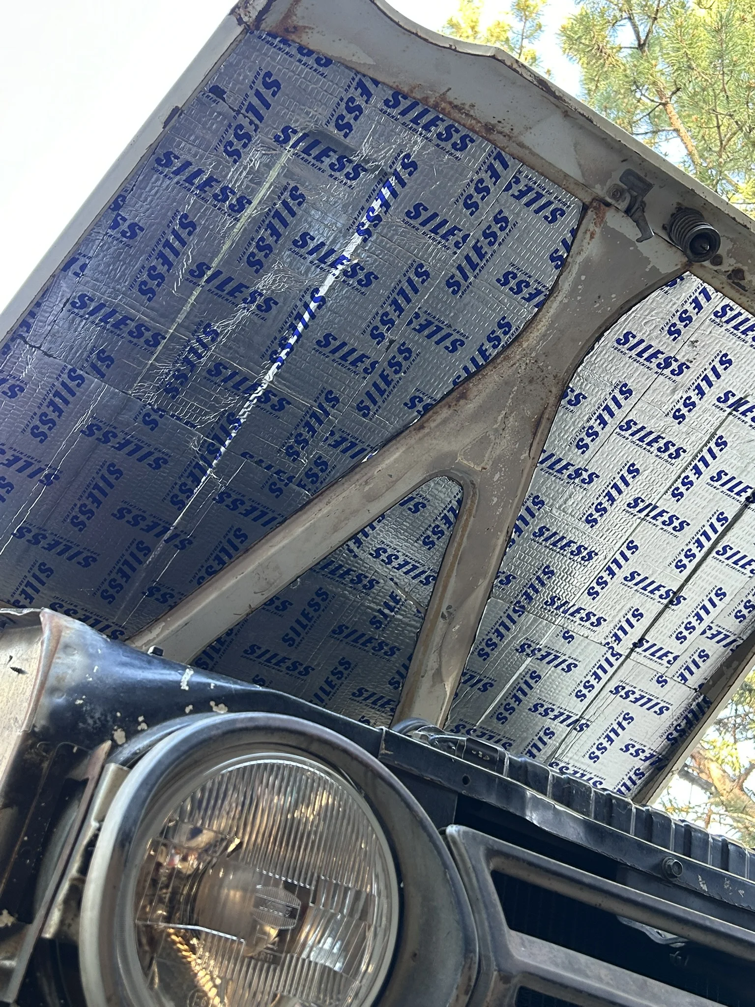

Also added the first of many sheets of the sound deadening stuff. I'm not expecting Lexus quality NVH, but it would be nice to tone it down just a bit. Once I remove the old factory insulation off the roof, I plan to put it there as well and in the doors.

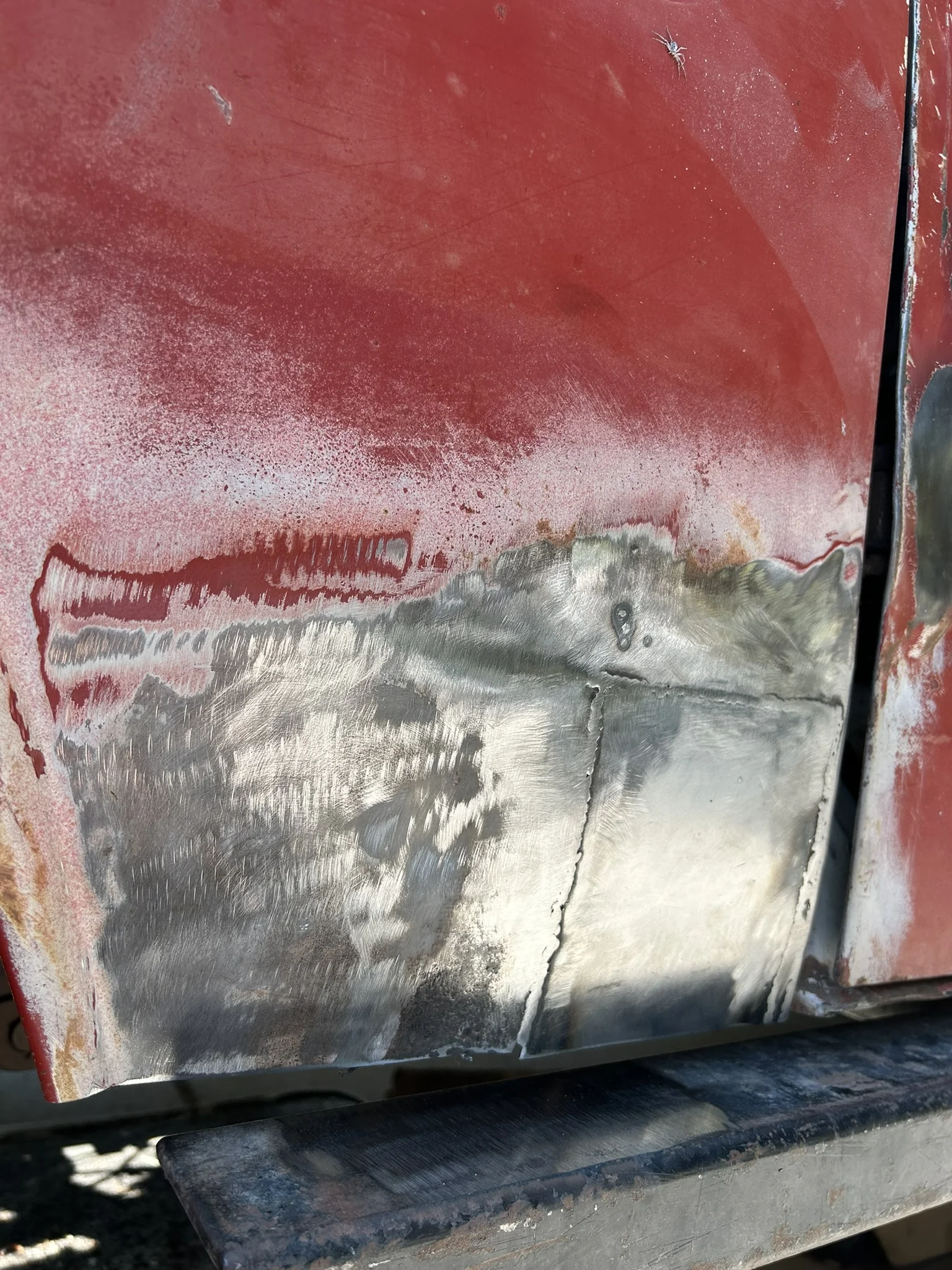

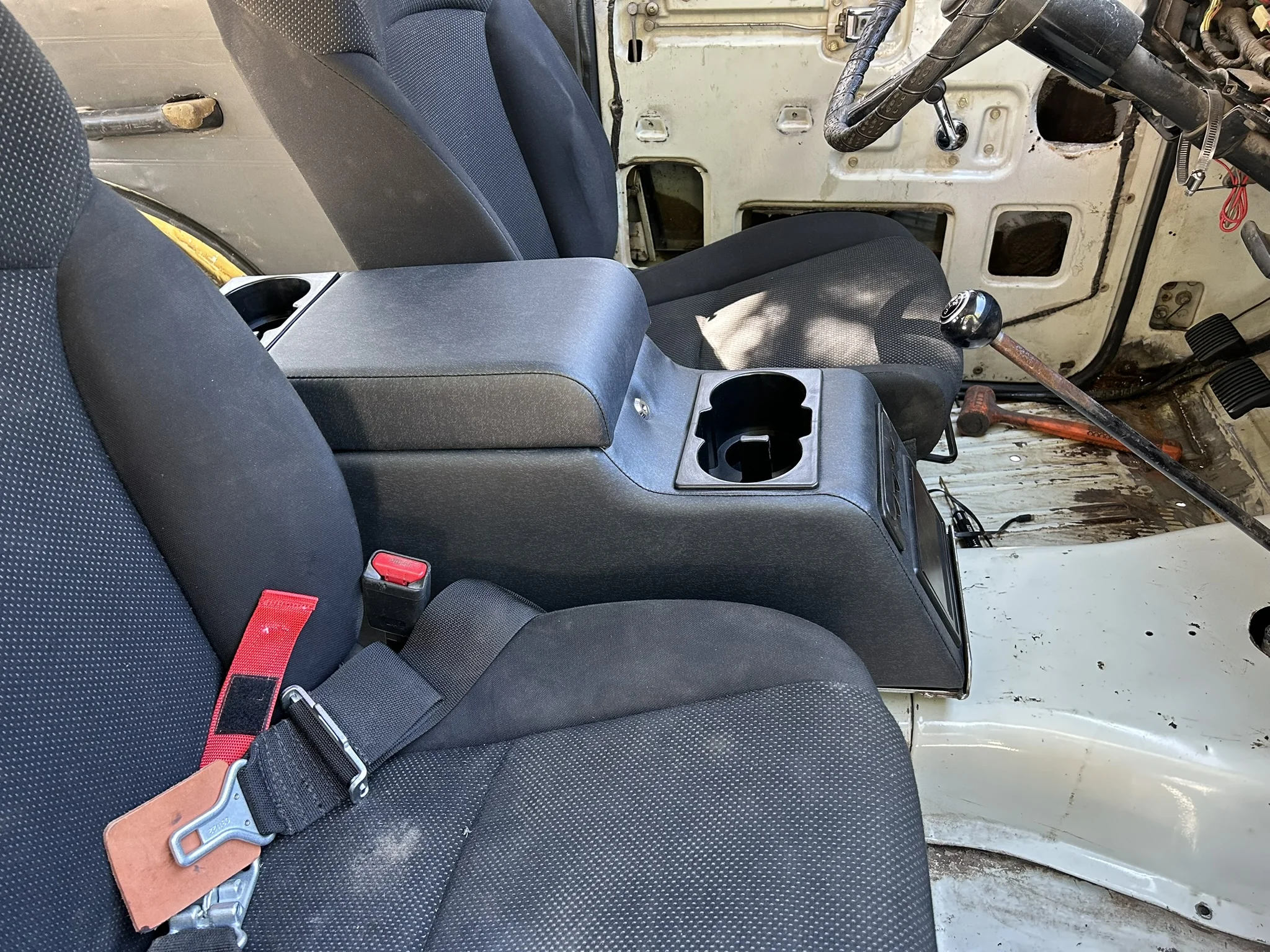

Bit of a catch up. Lots of little items I am trying to sort of button up. Both sliders welded up and mounted, though I still need to drill and sleeve for 1/2" mounting bolts though the frame. Reverse lights wired, cheapo universal center console bolted in. Tie rod was bent so I ordered a new one from Cruiser Outfitters along with new ball joints for the tie rod and drag link. Driver side fender rust and crappy bondo/fiberglass temp repair has been cut out and replaced with new metal. Yaeseu 2m radio is installed and working.
Not much to report though I have taken care of a couple of small things in the last few weeks. Sound deadening added to the firewall, then the stock back vinyl cover put back on. Arguably the difference is negligible but it is there at least.
Brakes have also been adjusted much closer to correct as well as having a bit of air in the master. Both have been corrected and the brake drag does not seem to be a problem now with the brakes feeling pretty consistent. This was a bit of a thrash right before (during) our local week long car show I was participating in. To no ones surprise, fairly confident it was the only 55 of several thousand participants.

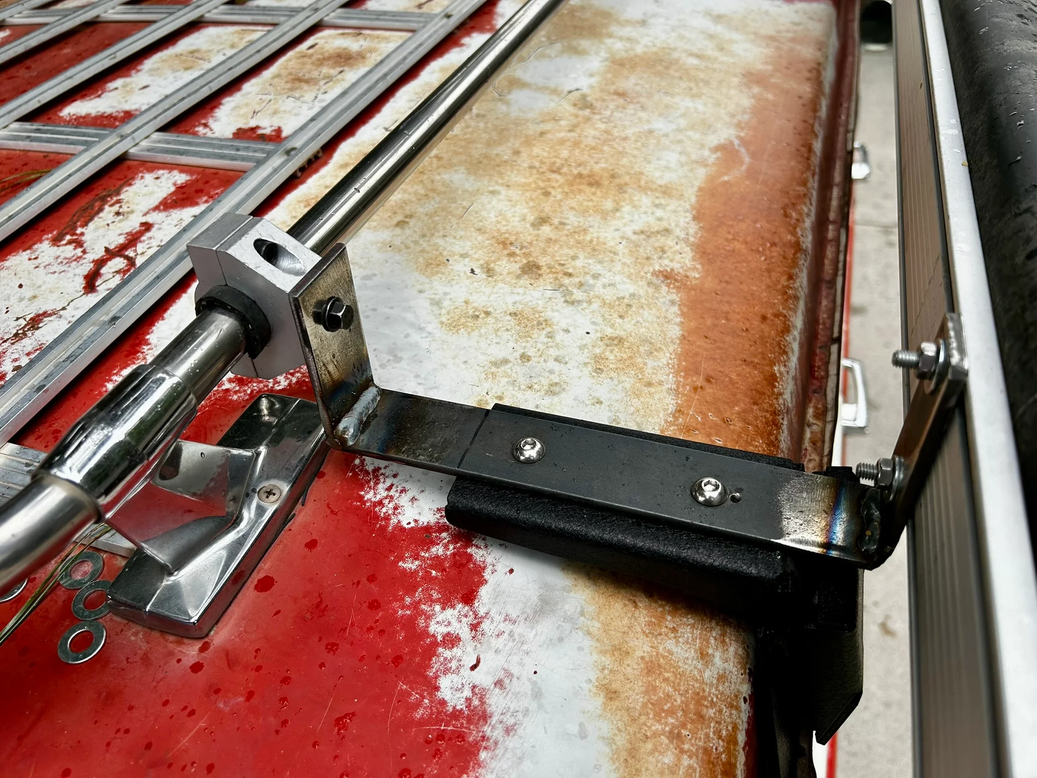

I also am working on getting it a little more setup for hopefully a few small camp trips this season. My last camp rig had an awning so of course I had to put one on the 55. I didn't really want to drop the coin for a large full replacement expedition rack at this time, but also my buddy wanted me to keep that sweet dealer installed luggage rack. Add in some cheap gutter mount metal brackets and some aluminum tube mounts and we have sort of a hybrid setup. There is room for future modification for mounting different things in the future but for now this will do. I will also make a pair for the driver side to match.

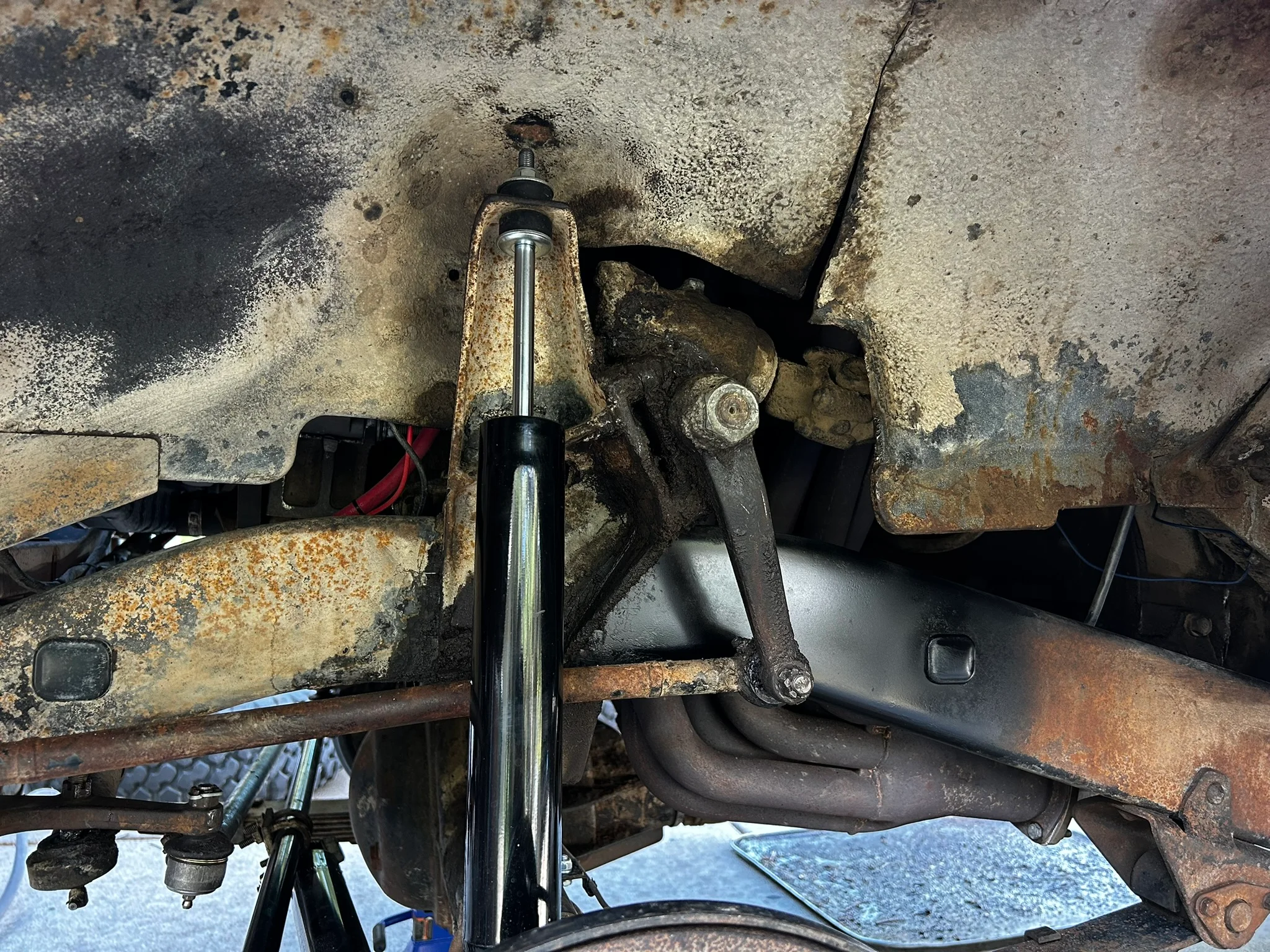

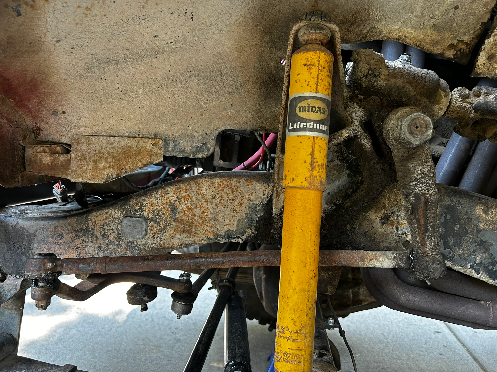

Spent most of yesterday drilling holes in the frame for the rock sliders and today was tinkering on the front end. Repacked the front driver side wheel bearing, adjusted the center idler box and just did some general clean up/de-greasing. The prior owner last drove it during the winter out in the rural part of the state before it got taken apart, so there is dried mud everywhere. I also sanded down a section of frame where brake fluid had eaten away most of the coating and than gave it a few coats of paint, just to get something on there so it was not just raw. Also treated the pig to some new front shocks. These are just some basic ones from Summit. After some measuring, early Chevy Camero/Chevelle rear shocks fit the 55 great. These are from Classic Performance Products. I have a small shackle lift but don't see why they wouldn't fit a stock height 55.
Included a pic of the before shot with the vintage Midas Lifeguard shock.

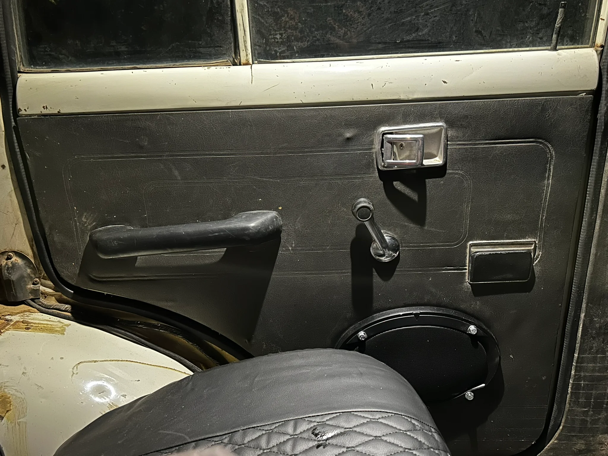

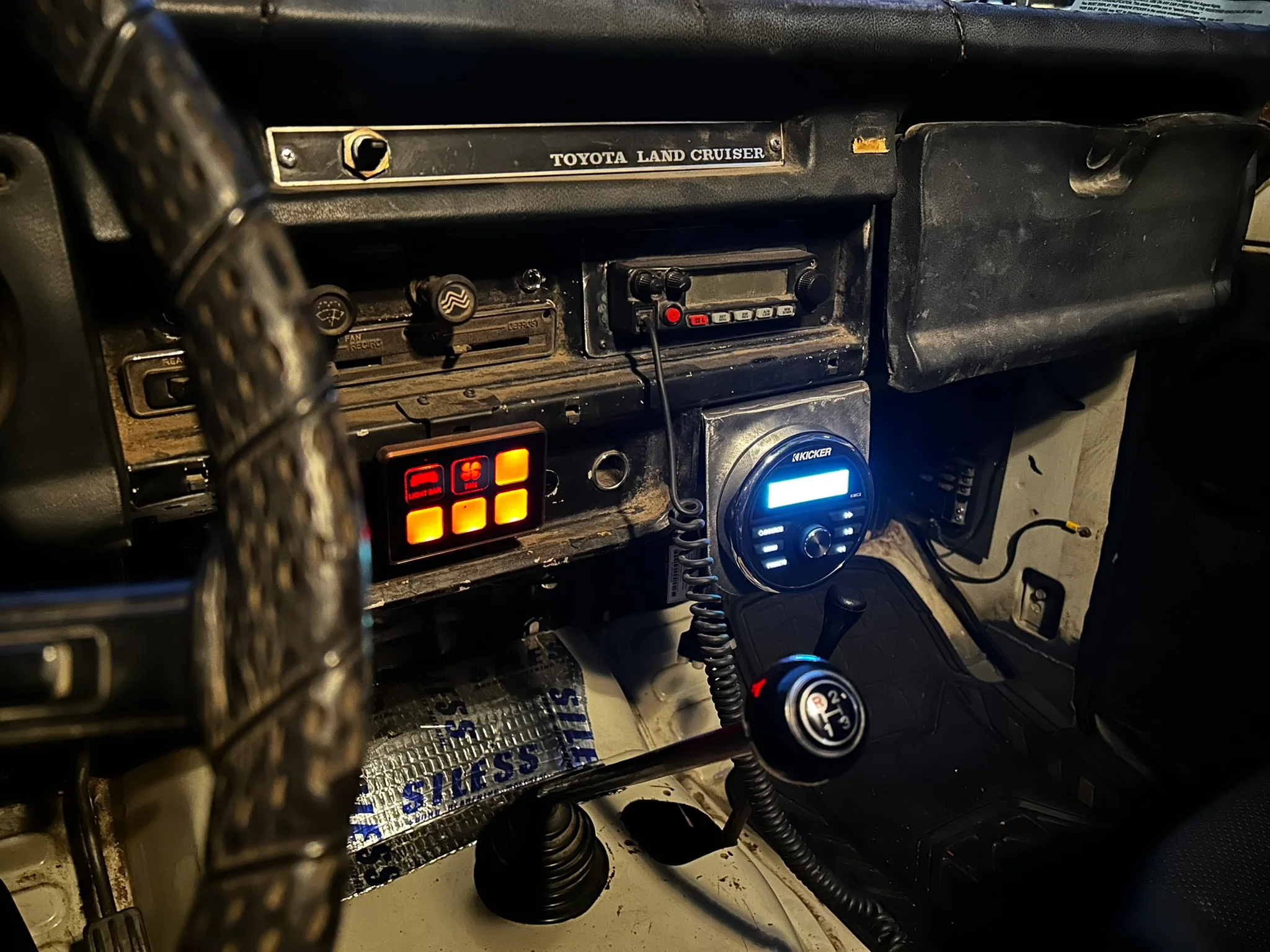

I have also been working on adding some tunes to the pig. Utilized a marine head unit, custom dash mount and all custom speaker wiring in the doors. Just ordered an inexpensive marine amp for the 4 speakers to help drown out that 1F just a bit more. Since every door was apart, it got a cleaned up and most of a sheet of sound deadaning mat in each. Its like adding speakers to a metal tool box, but any little bit helps. Fronts are some 6.5s and rears are 6x9s. The rears took the most work in getting them mounted with some creative bracketry but it looks pretty good. I used the original door cards since I felt less bad about cutting them up, but all in all they are in pretty decent shape.
