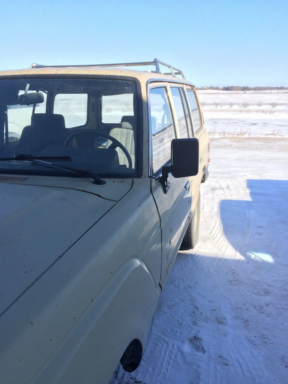

Actually, they're from a 62 series and although the gasket seems like it's for a different model it will tighten down and sit flat. No custom seat needed. This is what mine look like installed:
I found this thread in February and since I work at Toyota I figured I'd test it out. Hope this helps others!

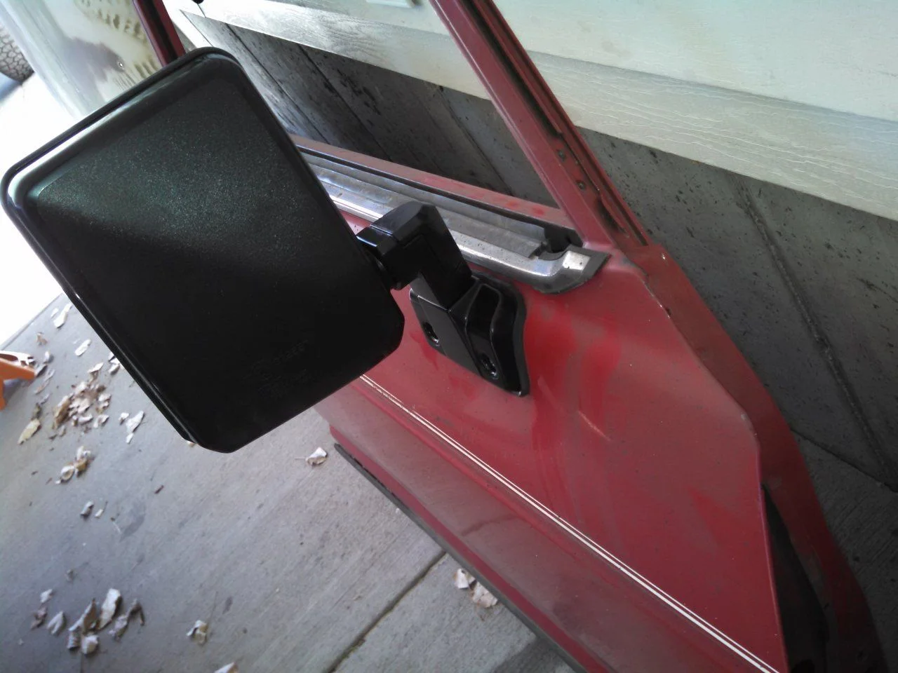

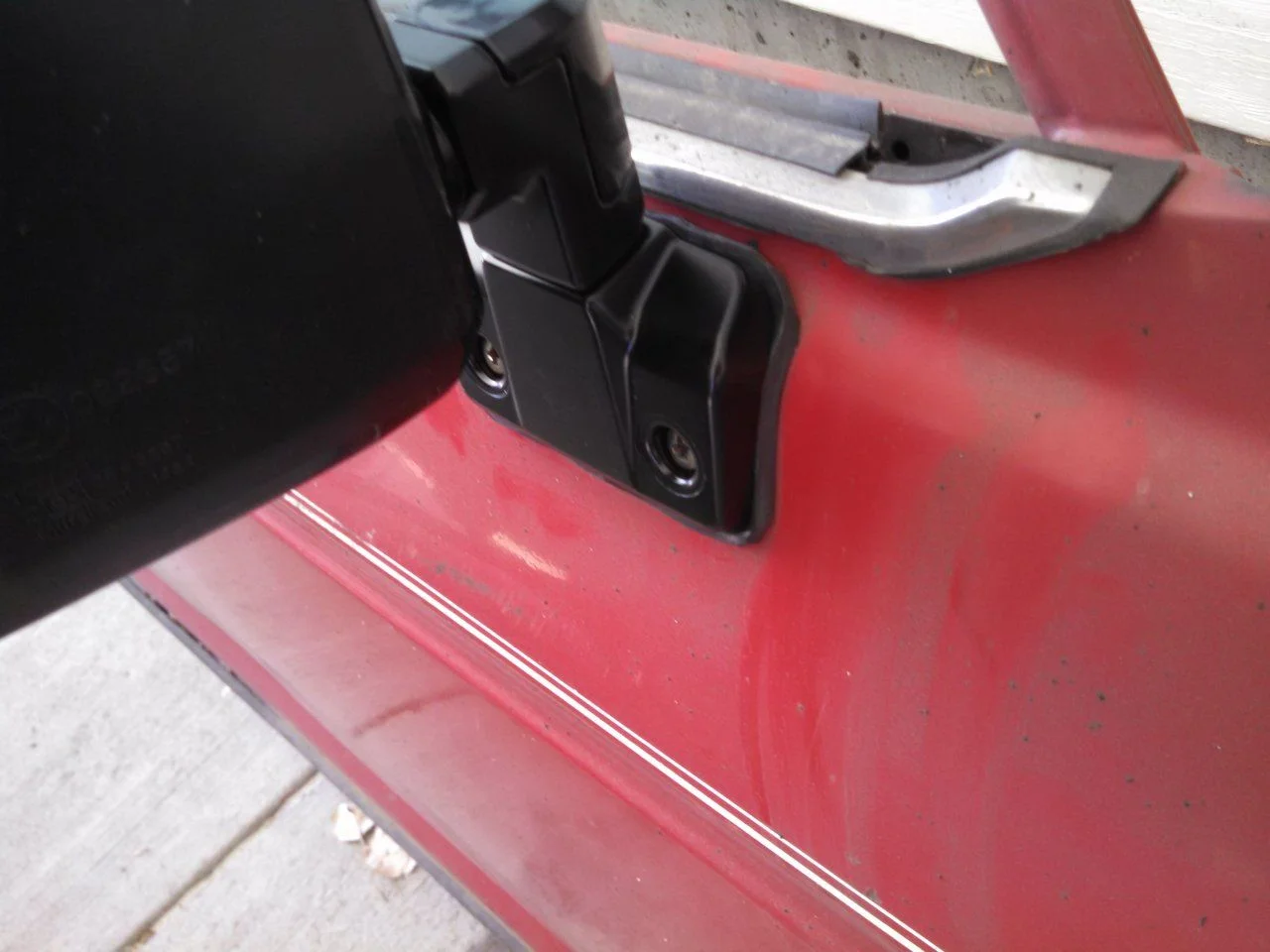

Yeah, that looks exactly like the pic Godwin posted but we are unable to see if there is a gap due to the lack of light.
The holes line up. But as @beno stated earlier they are from a 70 series. But they do fit reasonably well, and with a slight modification, like @reevesci suggested you could make them fit even better! I really want to order a set for Moose.

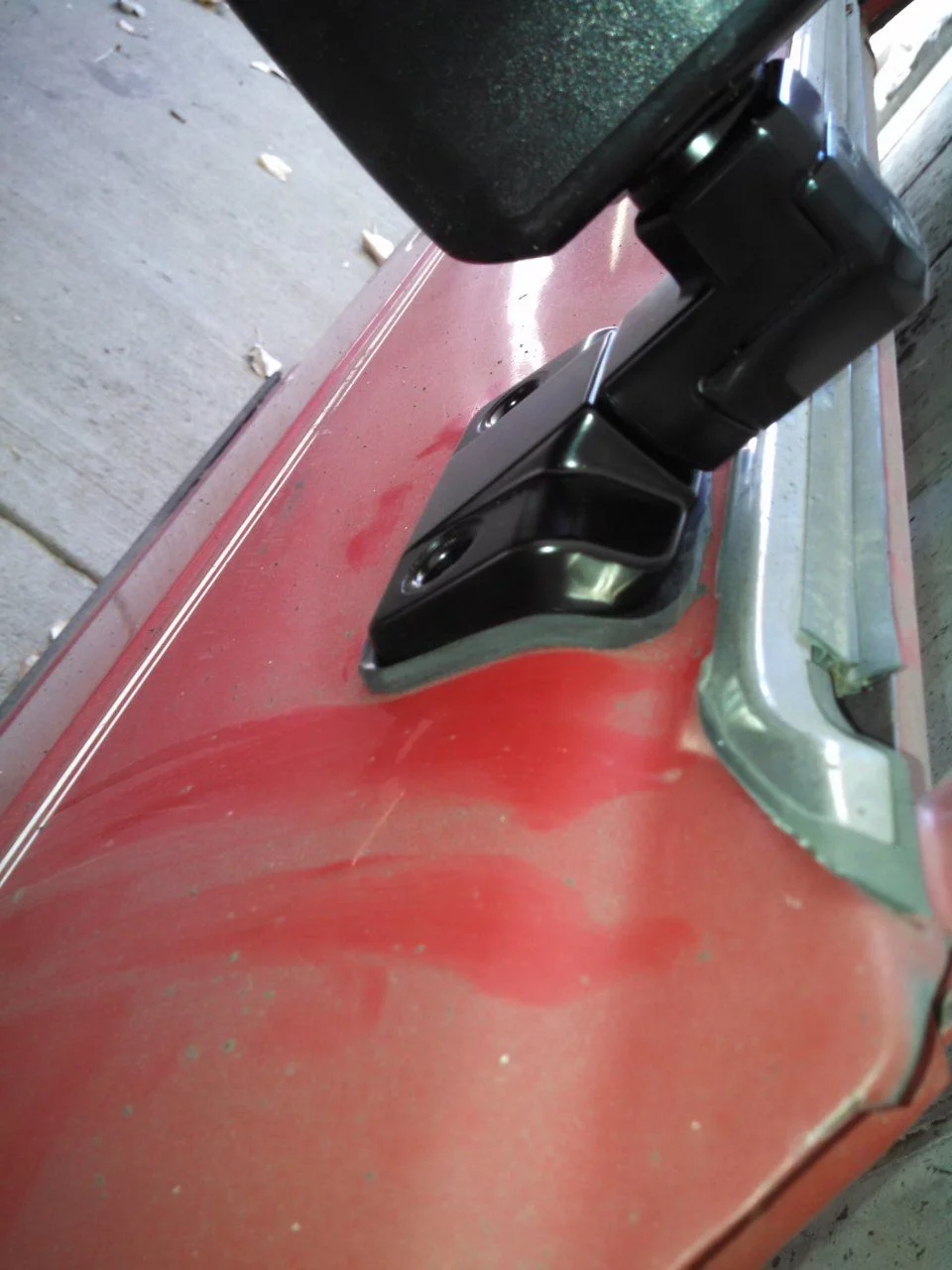

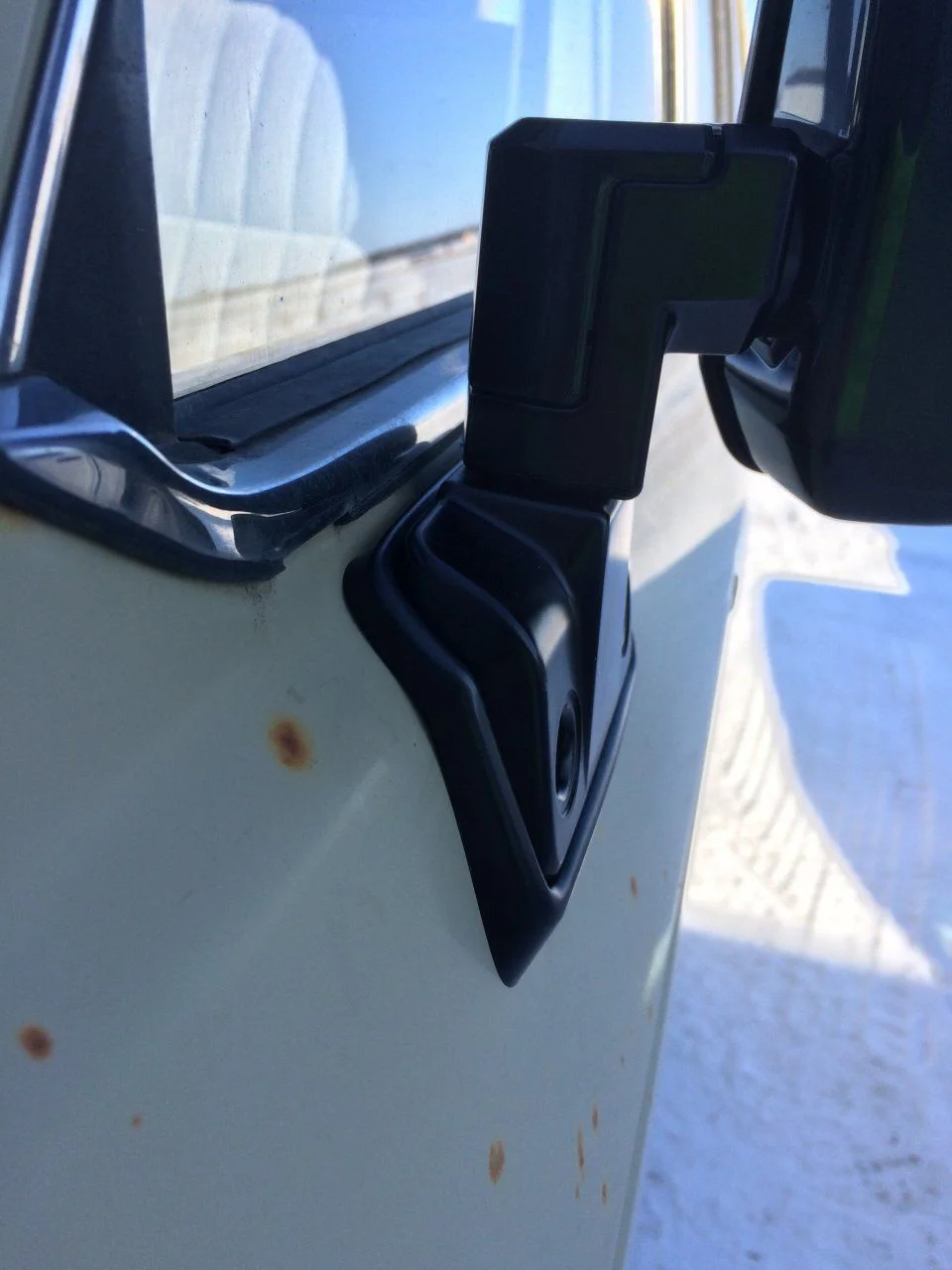

I didn't use a plain screw driver I used a impact driver and it pulled it right tight. Ok actually I'm posting another picture and there is a slight gap but I swear it's made for my door... Seriously.

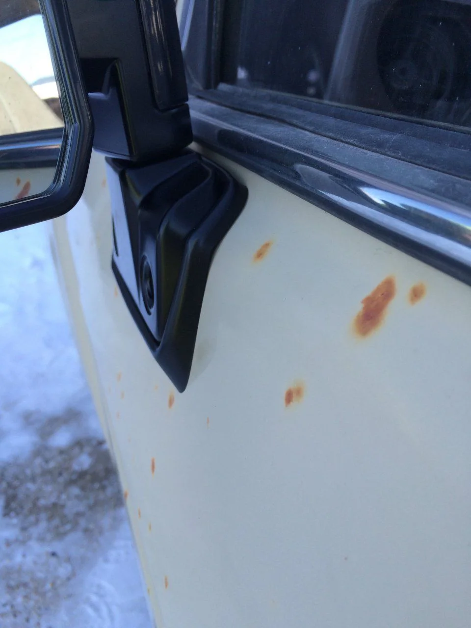

Finally had some time waiting on the freight carrier to pick up a couple bumpers. Here is the quick new gasket for the mirrors. This material is a military grade ASTM -50F to 300F. I'm ordering another piece in a softer durometer. I had to crank down pretty good to get the compression/seal I was happy with.
A local oilfield gasket shop will make me a cut die and stamp these out (making the price reasonable and cut my time by 200% ). Just need to get the specs down and we will be off to the press.
These are hand cut and will be much nicer with the die cut.
