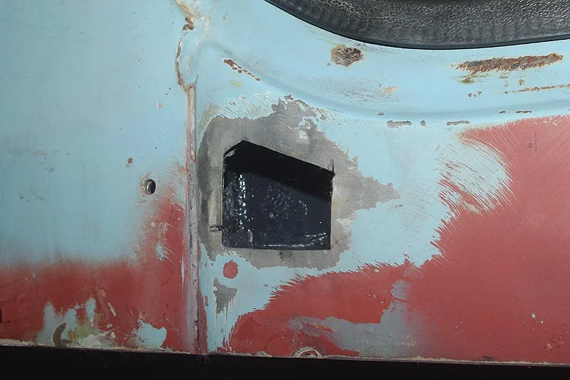

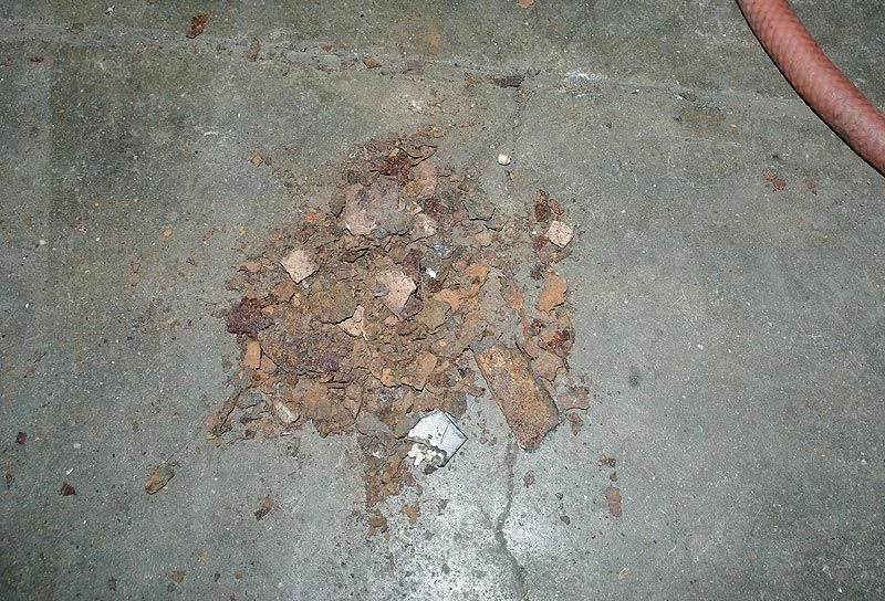

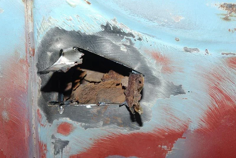

Opened the front one, found a treasure trove, a lot for a small hole? Cleaned it out, treated with phosphoric acid and slobbered paint in there.

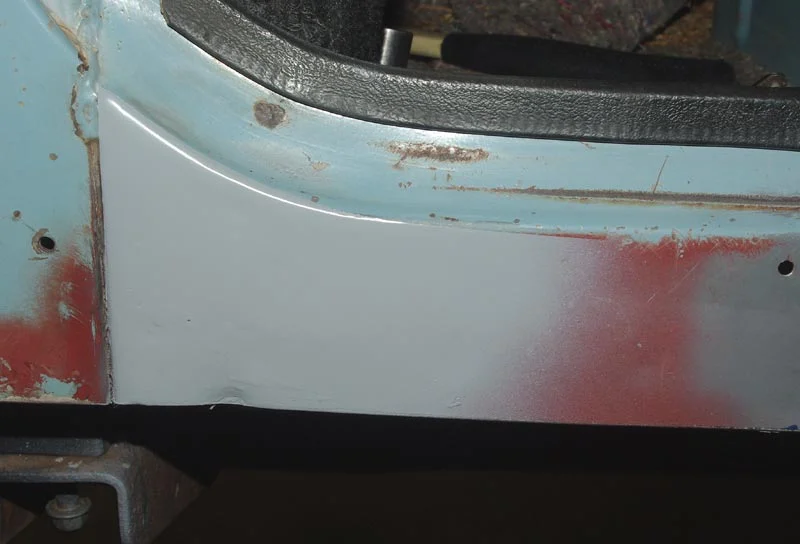

Cut a little patch, tack, cool, grind, repeat. Had to be more careful with this one, that body line is the proposed end of the new paint!

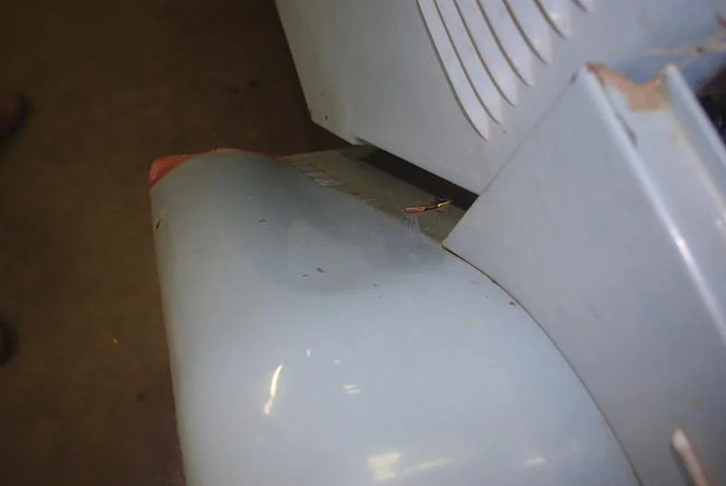

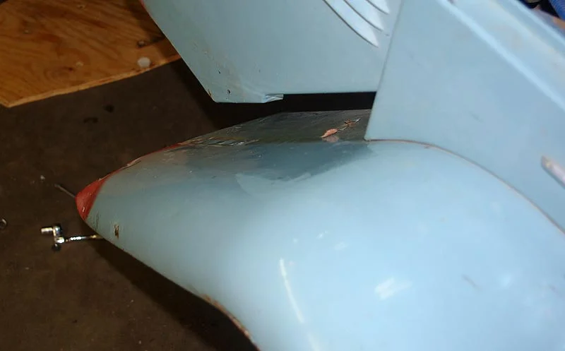

The next diversion was the passenger side fender, it had made rock contact, installing more texture than allowable. Needed to be straightened as much as possible, with as little damage to the "patina" as possible.
Jigged up this precision, composite die, to apply pressure in the correct spots. Then applied repeated percussive force to the inside of the fender.
That got it pretty close. Added a calibrated shim. Continued applying percussive force. Is a Chilean shim proper protocol for a FJ40? :hillbilly:
That got it very close, well within spec, it still has a bit of texture, so matches the rest of the rig! It's difficult to achieve this level of perfection without proper tooling, maybe?:hillbilly:

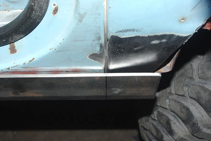

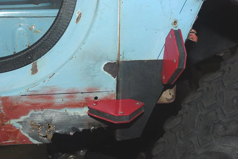

Back to the new rockers, they are straight, unlike the body. Most notably, the quarter is at a differing angle from the rocker, not going to cut it! So, cut the rear part off and welded it back at an angle to match the quarter.
Using new Bushwacker flares, so, mounted the old ones higher and further back, where we hope they will clear the tires. This gave the trim line for the rockers.

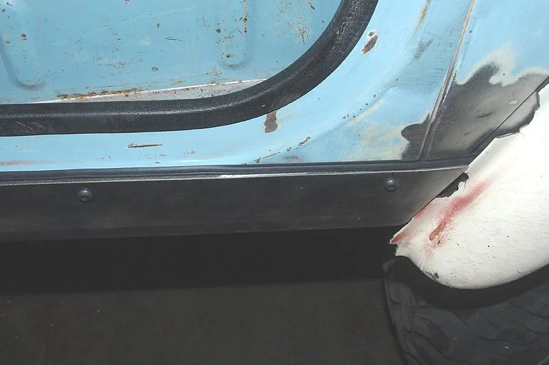

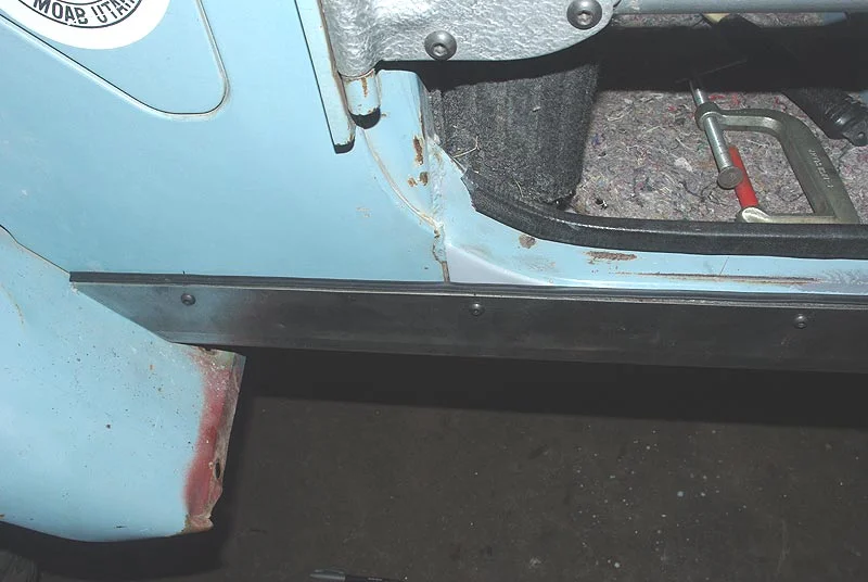

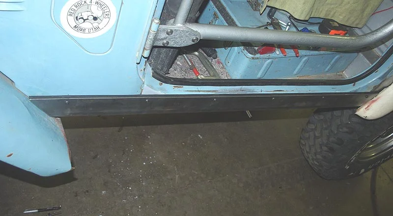

Stopped at our favorite auto body store, picked up some trim strips, this one fits/looks the best? It's listed application is chevy trucks, someone should appreciate that? Drilled and installed button head bolts to secure upper edge of the rocker.
