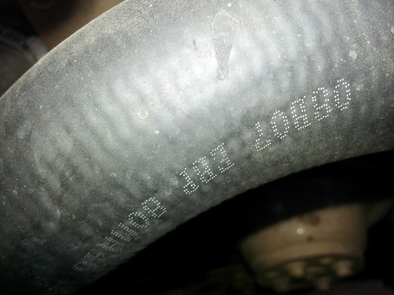

I couldn't make out any part numbers on the lower hose. But here is what it looks like and the part numbers to the upper hose. Also, you can call John Brassier at Proffitts and he can tell (and probably sell) you the hose that they use. I have bought parts from them at good prices.
