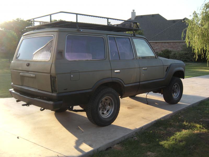

So, now is the time to actually start my build thread. Oddie came to me after being left in a field to die. I nursed her back in the field, during the historical February North Texas snow.. (crazy I know) Drove her home with a busted up windshield and a missing passenger door glass. Blessed be the cardboard! She, yes.. Oddie is a girl, had only 96k on the odometer.
Her story... begins here...
She wrote in her diary that she wants a new 4bt heart, nv4500, SOA, 35" meats, lots of expedition toys and gadgets :)
Dear Diary,
After arriving home and getting the glass replaced. She was elated and started to strip and insisted I pull out .. the motor. The nice <100k motor was delivered to my buddy Daniel in Austin in a late night caffeine-fueled care-flight trip to help with the OX's surgery!
Having the exterior of a clean, basically rust free FJ60 was a tough one.. But, I love it and I hope it helps some with noise from the 4BT. The slight surface rust was removed and self-etched to protect the metal. She had very little rust but she wanted to look rough and tough.. So, had her lined in Speedliner, inside and out.. then she just utterly demanded I get her a rack job!.. For the roof you gutter folk!! Geez!
I'm going to try and show the build and keep myself accountable here :) I've procured about 90% of the stuff needed and am working to get it done now. Got the SOA going in currently with Proffit's fine work. I also went with some Longs while I'm in there.
PS - Thanks to Trent (CruisinFJ60) for the help on pulling the 2F.. never had a cruiser before so I had novice questions.. OK.. a lot of novice questions.
And thanks to John and Jeremiah at Proffits for answering all my questions about the swap and taking care of me on the SOA gear.
A few pictures to help paint an idea :)
Oh and she got her name, oddie, from the color I had hand matched... Olive drab.. (O.D) :bounce:
