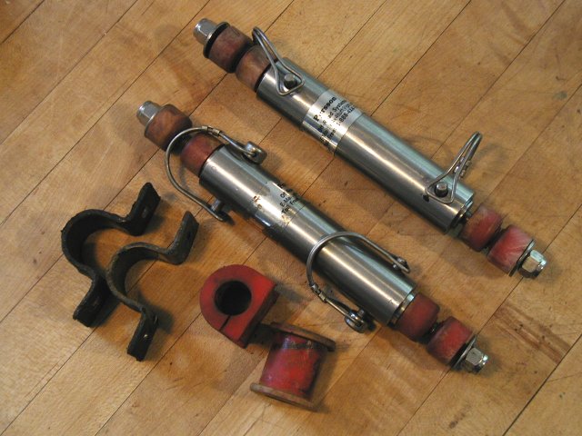

Anti-sway bar went to the scrap pile (on my '84). Used to be a guy named Drew Persson that sold these really cool solid stainless endlink disconnects, but honestly they were kinda a nuisance and I could hardly tell the difference when they were connected. So I got rid of them and the entire bar. Never missed it.

Used to be a guy named Drew Persson that sold these really cool solid stainless endlink disconnects.

I still have mine. They were art.
