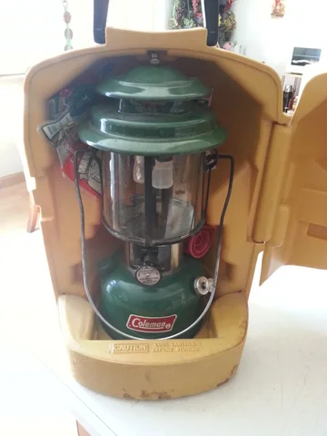

Found a 220k on Cl with a case and extra mantles also an extra generator not bad for $30 i think.20150307_101755.webp20150307_101558.webp

I would like to fire up the 220k that i bought a few weeks ago,according to the owner it's been 2 years since it was last used should i just put fresh fuel and fire it up or should i clean up the tank prior to?
I would just fire it up.

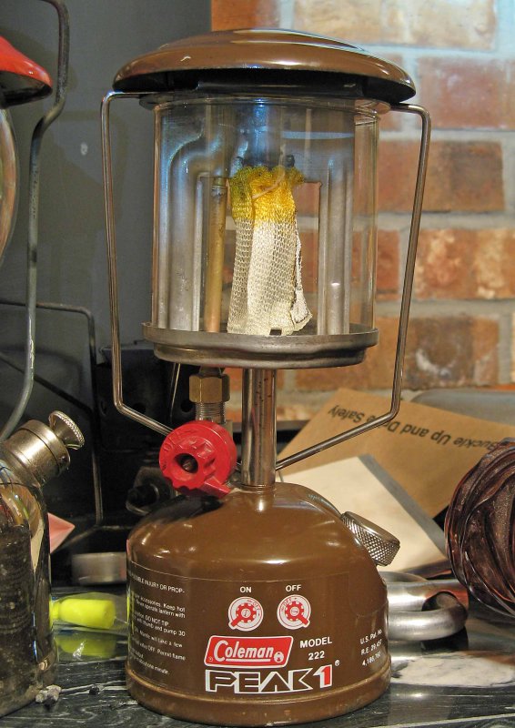

I dug out my dad's old Coleman stuff from the 70s and my stuff from when I was in Boy Scouts and I am having a few troubles getting things going.
First, my Peak 1 single burner back packing lantern started right up after probably 25 years and ran great. It looks like this.
2nd, my Dad's older 220 dual mantle lantern won't start and run consistently. It pumps up and holds pressure in the tank fine. I have replaced the generator but it still appears to either not be pulling enough fuel or air is getting pulled in somewhere. When it sputters it will light but eventually go out. When it does not sputter it will not light at all. I think its getting too much air in the fuel stream somewhere. Any suggestions?
3rd, my Peak 1 stove won't build pressure in the tank. It just pumps and spits fuel all over my thumb. The pump cup is the non-leather type and appears to be tight enough that it should build pressure, but won't. Any suggestions?
that is a relic! I still use my old peak! single burner stove to heat soup at work...
