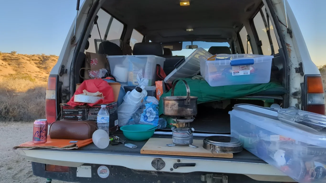

^ the peak stoves are great. Free is a great price! They are basically unobtanium since coleman killed them off. Spares are still easy to find. All you need is to get a spare generator assembly and a pump assembly and you'll be set for a few decades :rofl:
I've been using peak and straight coleman versions for many many years as my go to camp stove (25+ years). Flawless operation and I've only ever replaced the pump on one of them after 20+ years due to the bucket finally becoming to bothersome to continue giving it a little oil to rejuvenate.
I have one in oz for when I am back there and one in the US.
Used the US one just a week and a bit ago on a camping trip. Picture prepping for dinner.
A friend gifted me 5 one gallon cans of the coleman 'white gas', given the stupid cost these days, I was very appreciative and am set for a bunch of years :) Being highly refined without 'additives' it appears to store forever.

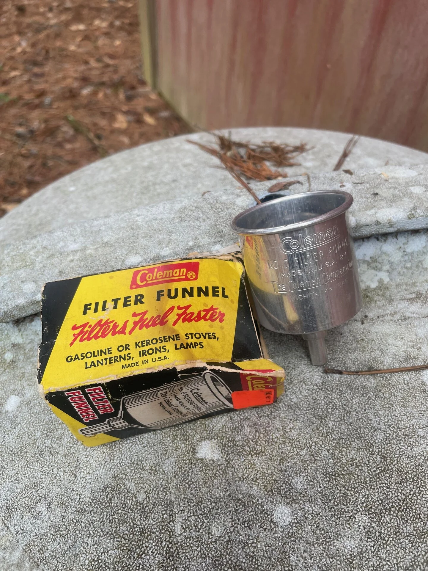

Coleman funnel with the original box that has seen very little use. I would have received this from one of my uncles and all I can say is that it's decades old. I'm going to put it on a shelf for now since I have other means for refueling stoves.
The orange tag says "Key 7" but the price has faded. I'm sure the cost was very low at the time.
