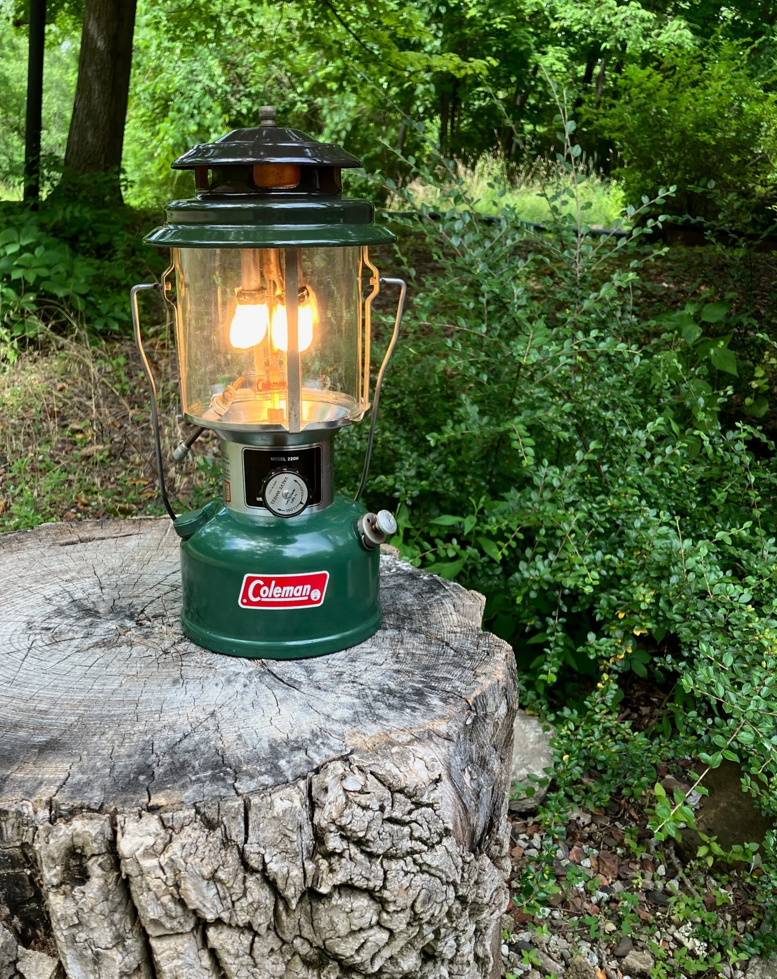

Yesterday's restoration project, a 200K
lrYS2ZK
Very nice looking specimen of a 220H! The 220 series ended with the "K" model (*functionally identical) in June of 1986, so yours is one of the last few model years of production. I'm a fan of the last of the 220's, as they have the original, old style aluminum pump cover instead of the modern plastic fitting, and yet have the updated stamped steel mixing chamber at the top, instead of the classic cast metal assembly. This makes the last of the run an interesting mix of old and new, classic and modern.
I've got a 220F in pieces sitting around the workshop right now. All the brass bits are cleaned and ready to reassemble and so is the font but the frame is stewing in Evaporust. I put it in yesterday before dinner and plan on taking it out sometime tomorrow afternoon. I'm hoping for a quick reassembly and good performance. If these two 220s burn similarly to each other, I'm going to use them for some head-to-head mantle tests to sort out what sort of mantles burn whitest these days since production of, well, everything, ain't what it used to be.

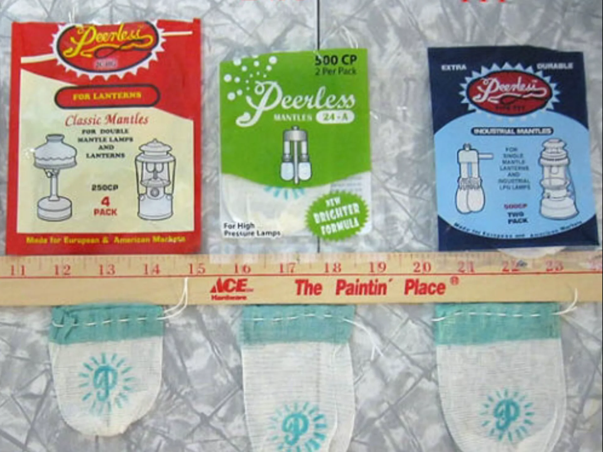

Depending on which lantern I’m using I’ve had good results with Peerless mantles.
The thing is, Peerless isn't Peerless anymore. I found some at the hardware store and was really disappointed at how dim and yellow-red they were compared to their reputation. In fact, they were worse than current production cheap Coleman mantles from Walmart. I sent them to a safety lab at the local university and it turns out they weren't radioactive which means they switched to Yttrium instead of the older Thorium formula. After some back and forth on another forum, there's at least two separate product lines appearing under the Peerless name and in identical packaging. There's no way to tell which version you have unless you know who imported them into the US. American Mantle is importing Peerless mantles that are doped in Yttrium and not radioactive. These are duller and redder than the Coleman current production. Some guy named Sam (not joking) is importing different Peerless mantles in the exact same packaging but he's special ordering mantles that are doped in Thorium and therefore radioactive. Unless you have a way to detect radiation, there's no way to know which you have. Supposedly, the Thorium-doped mantles should be whiter and brighter than any Yttrium-doped mantles. However, I've seen some user reports that say this isn't the case anymore. So, I have the following lined up:
1) Current production Coleman mantles in the green-and-white plastic packaging
2) Current production Coleman mantles in the red-gray-black paper packaging
3) Vintage Coleman Silk Lite mantles
4) Peerless mantles from the hardware store, apparently imported via American Mantle, and known to be non-radioactive (Yttrium)
5) Peerless mantles sourced from a vendor that buys from this Sam guy what are maybe Thorium doped.
The first thing I'm going to do is to take them over to the university and have them all measured for radioactivity. I know options 1, 2, and 4 will be cold. I know #3 will be hot. The question is whether #5 will be hot and, if so, is it as hot as #3. I suspect I will find that the new Peerless mantles imported via Sam are nowhere near as radioactive as the old Silk Lite mantles and that's why there's people complaining about being disappointed in Thorium mantles when compared to their reputation.
After having the lab measure their activity, I have the tools to measure the color of the light they produce and the intensity of the light they produce. Given that the internet will argue over anything and will fight to the death to insist that any measurements you make that don't match their preconceived notions must be a mistake, I'd also like to take pictures of different mantles on the lanterns at the same time so that it's harder for people to argue about it. That's probably a vain hope. They'll argue even if I set the lanterns in front of them, I'm sure.
You are absolutely correct…I get my Peerless from Amazon as well as other locations on line. You can still find Peerless mantles made with Thorium.
