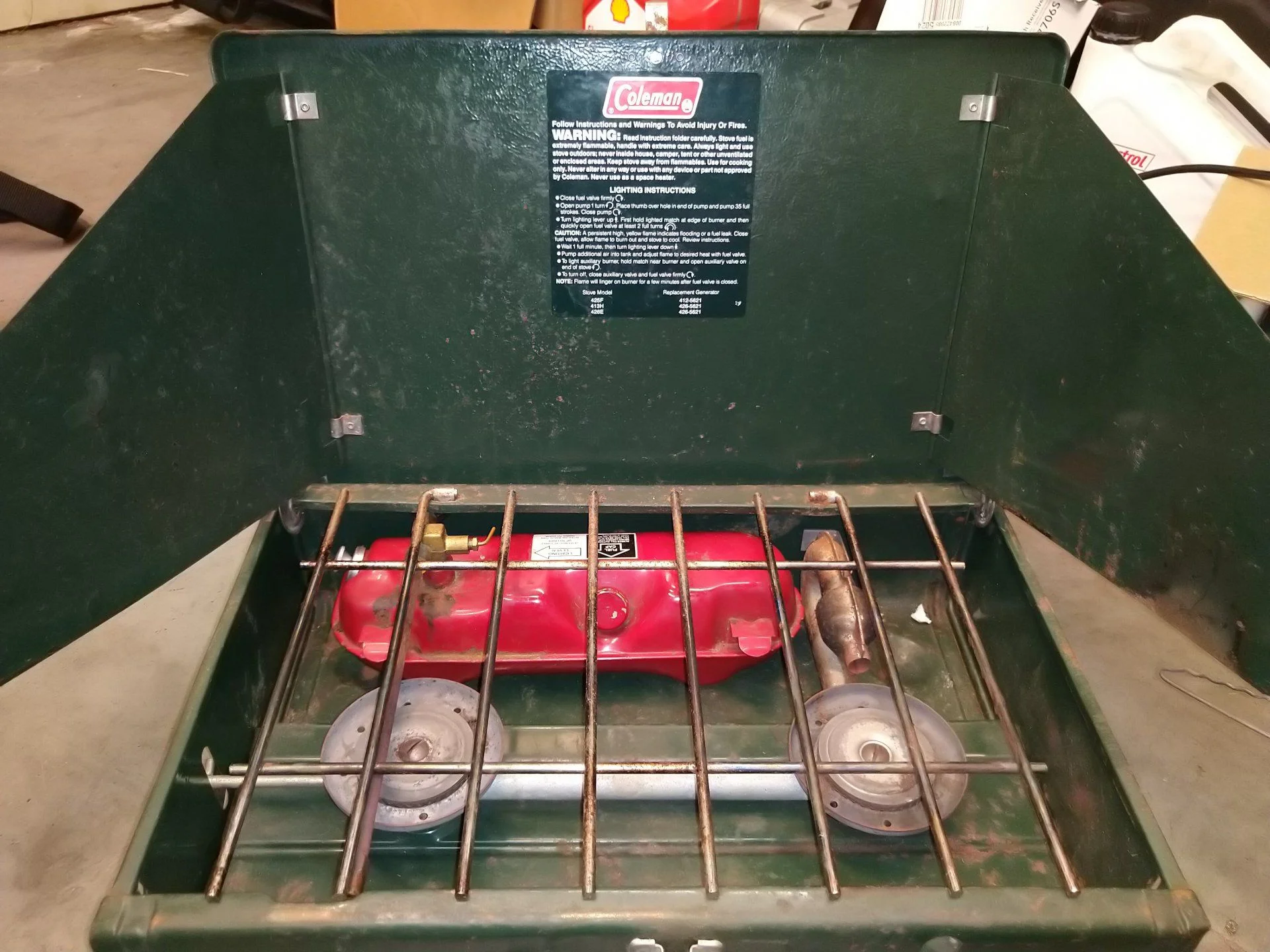

It's sadly true few things are still made to last. I have moved from the white gas and propane coleman stivea to a propane Partner stove, that however, is a new product still made tough, durable, simply designed, serviceable and expected to last.
BUT, I will keep this nearly 60 year old Coleman!! It still has fuel in it even!! 😆
Oh! It's oil not white gas!
Behaves differently!
But it lit!! 👍😁
I bet this thing hasn't been fired up in 20 years. Just a little babysitting and it fired up, both burners!! I'm sure it's clogged and such but that oil's got to be a couple decades-old to be sure.
Good job @DRANGED in getting it fired up. The burner on the right is the ‘Main’ burner and will burn hotter than the burner on the left. The one on the left is to keep food/water warm.
Hole on the pump where you put oil...you can remove the plunger and massage the cup. If it’s leather, spread it out a bit, soak it in motor oil for a few minutes and it will have a better seal and pump better.

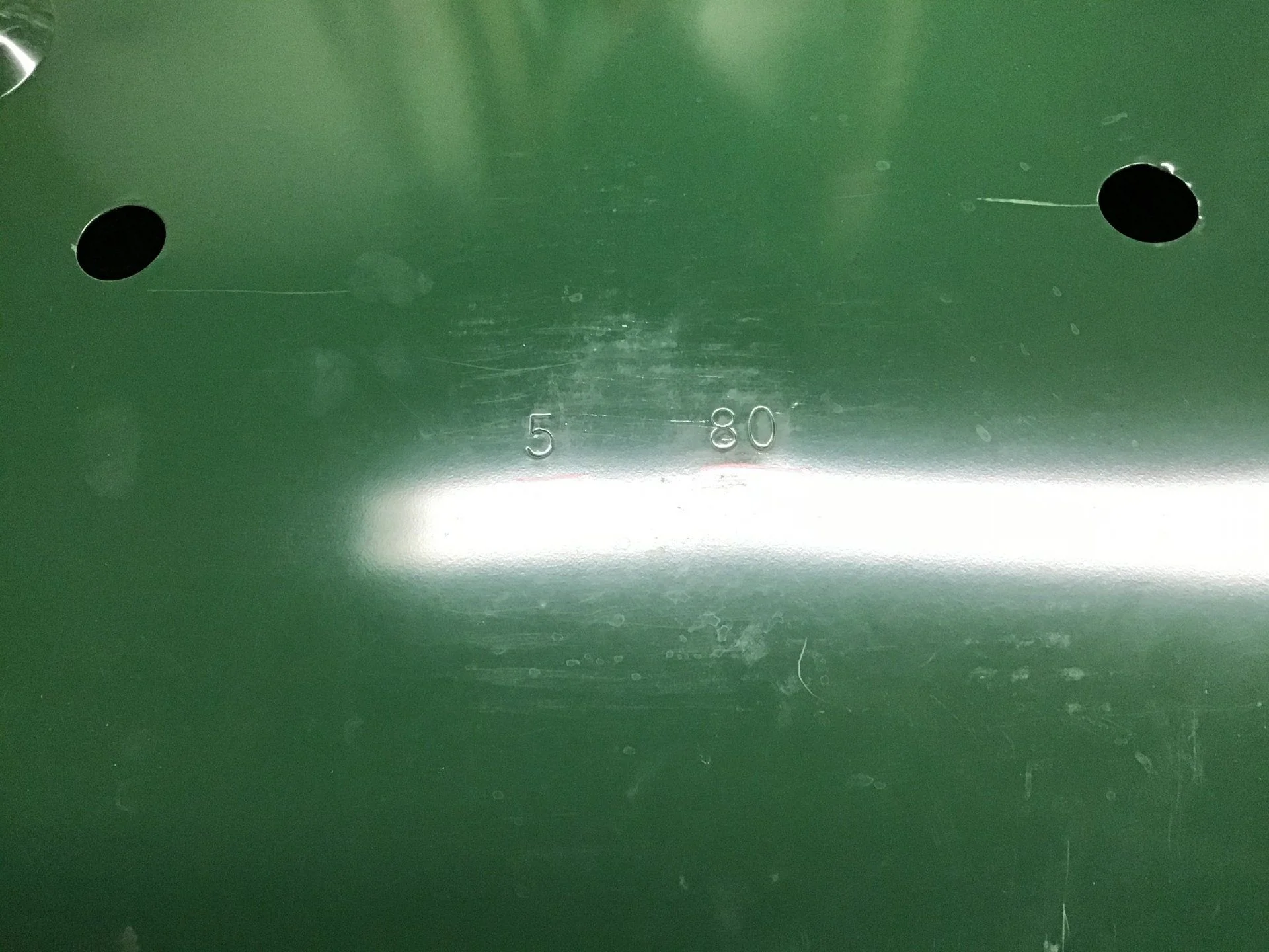

@Prairie Swamp I have included 3 pics of the bottom of 3 stoves. You can see the dates. Two stoves are 425’s, one is a 413. Several other of my stoves do not have dates. Don’t know why.
The dates for stoves in the 60s and early to mid 70s can often be found on the underside of the tank “ears” that slide into the stove.
I think they started stamping the bottoms of the stoves in the late 70’s and 80’s.

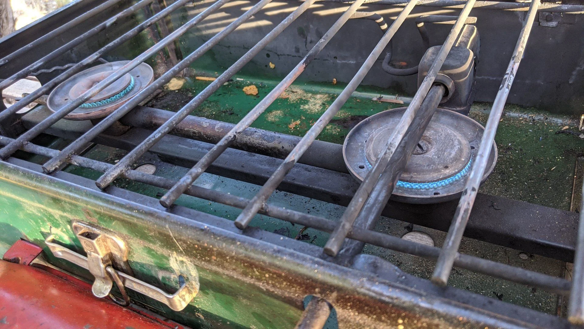

413G gettin’ breakfast done this weekend 😁
Bonus points for the Cabelas griddle and the Coleman folding camp kitchen.

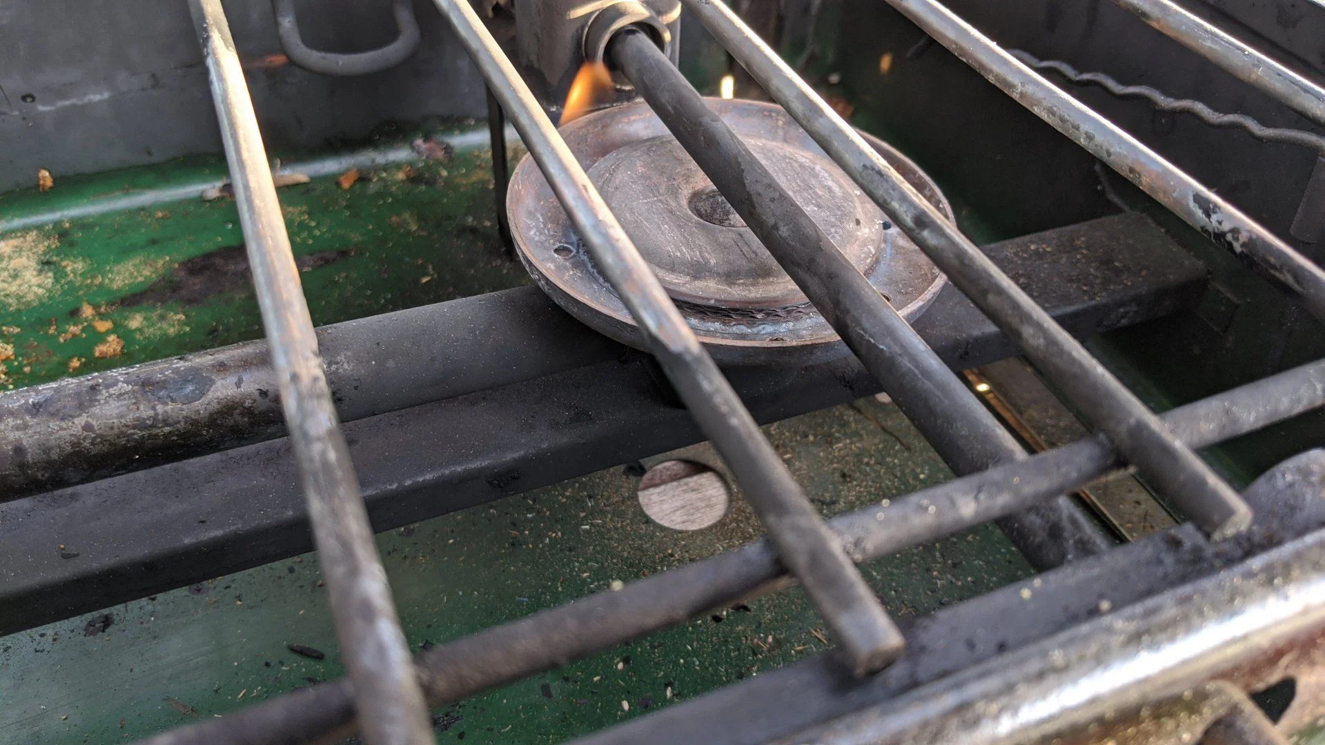

Got another one from this weekend. Sears 426.74980 3-burner gettin it done and a couple awesome sunsets

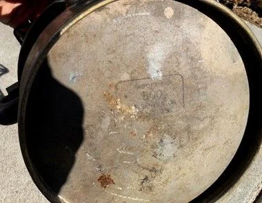

A40 is first quarter of 1940. Mine is B47. Mine fired on the fuel that was in it and is a great runner. I made a discada cooker to fit it.
No $s***. I had no idea. There is fuel in it, and the pump works. The seal on the reservoir cap is faulty....but I can hear a faint hiss when it is pumped and valve open....it would not light though
If you have gasket punches you can make one from rubber sheet. If not you can buy at Oldcolemanparts.com. The owner is awesome. Otherwise eBay or similar. Be sure you specify the small cap. Small fill caps are rare and common between 500 stove and 242 lantern. Then you need the rare copper #0 funnel to fill it.
