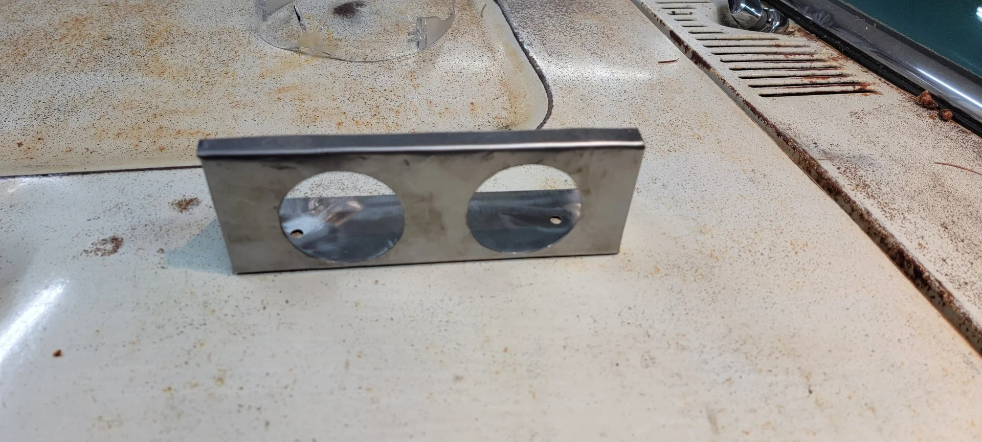

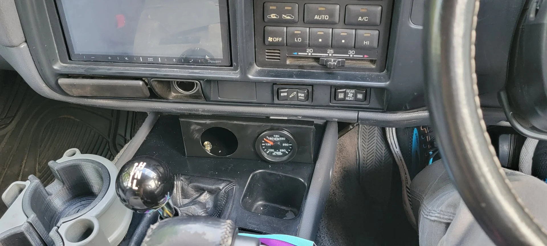

Made rev 0 of a gauge pod.
I think I'm going to do a revision and tilt it back slightly.
The extra hole is for my eventual addition of a pyrometer.
So I've driven enough miles to get a grasp on "normal" trans temps with my setup.
I see 130-140 cruising in the freeway with the converter locker.
Driving around town with the converter unlocked i see 150-160.
I pulled a few pretty aggressive hills with the converter unlocked and touched 175. But as soon as the converter locks at the top it plummets back down.
It's been mid 70s

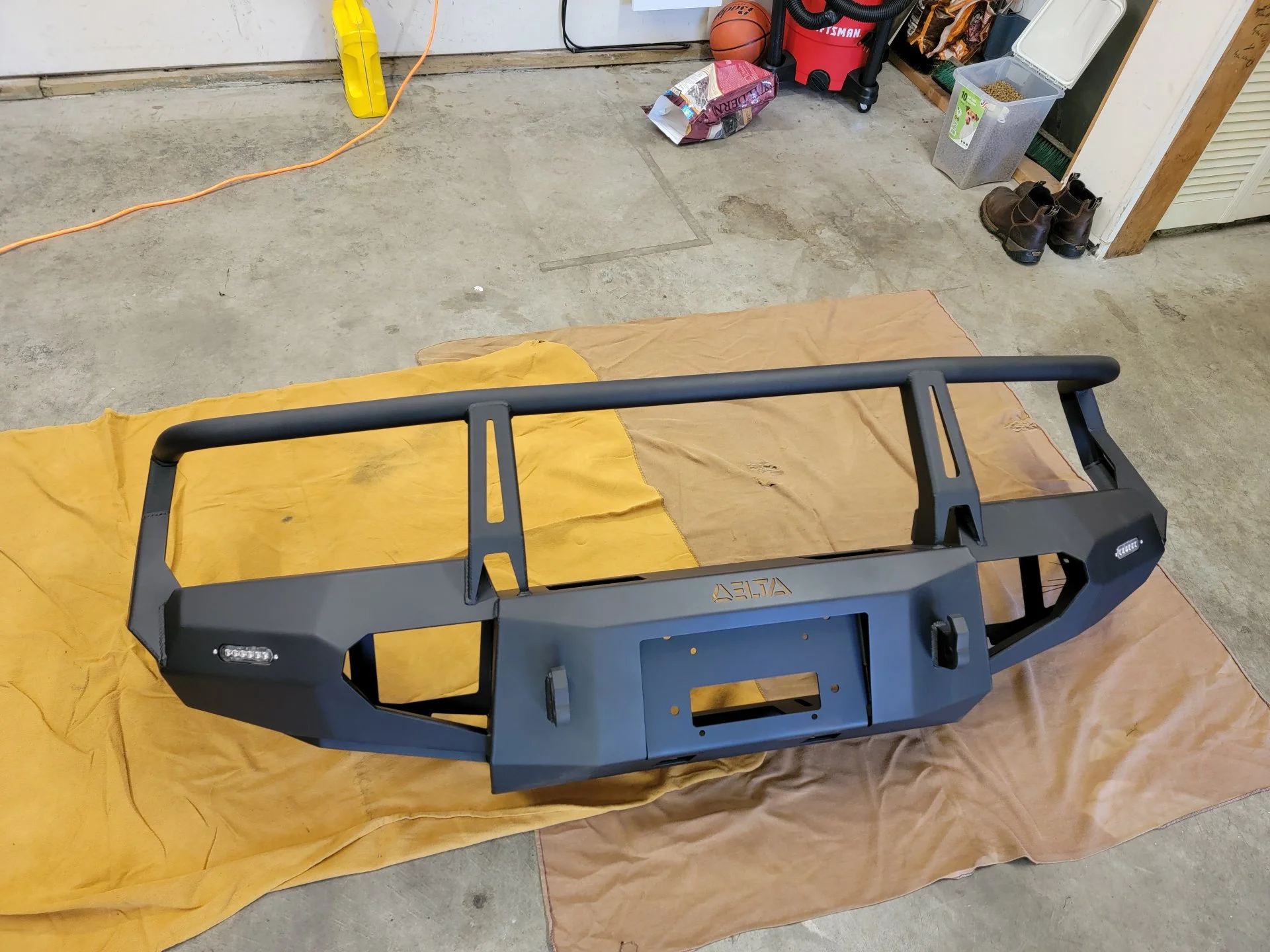

It's finally here
Bumper

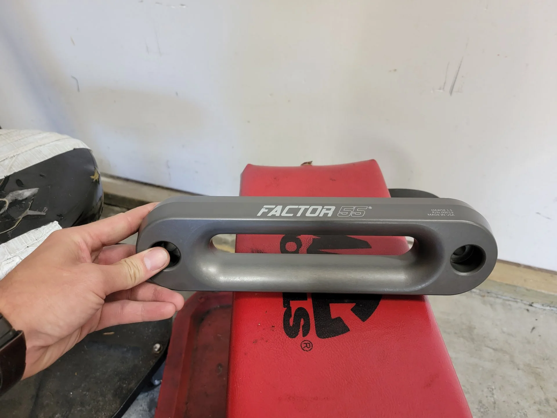

Factor55 fairlead

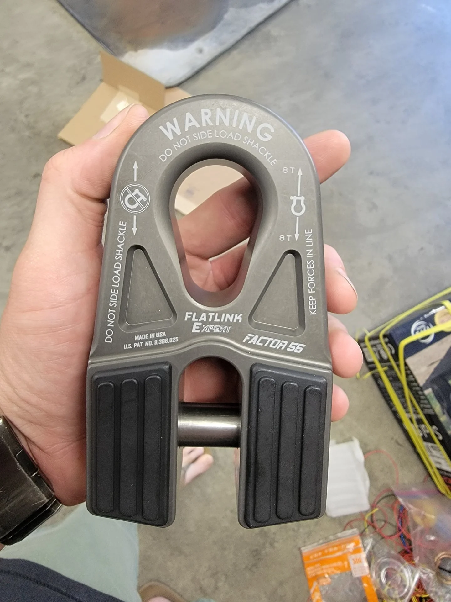

Factor55 elink
That’s a lot of plate steel 😉
Ya but it's, in my opinion, the only bumper made for these that looks good.
Purely opinion of course.
