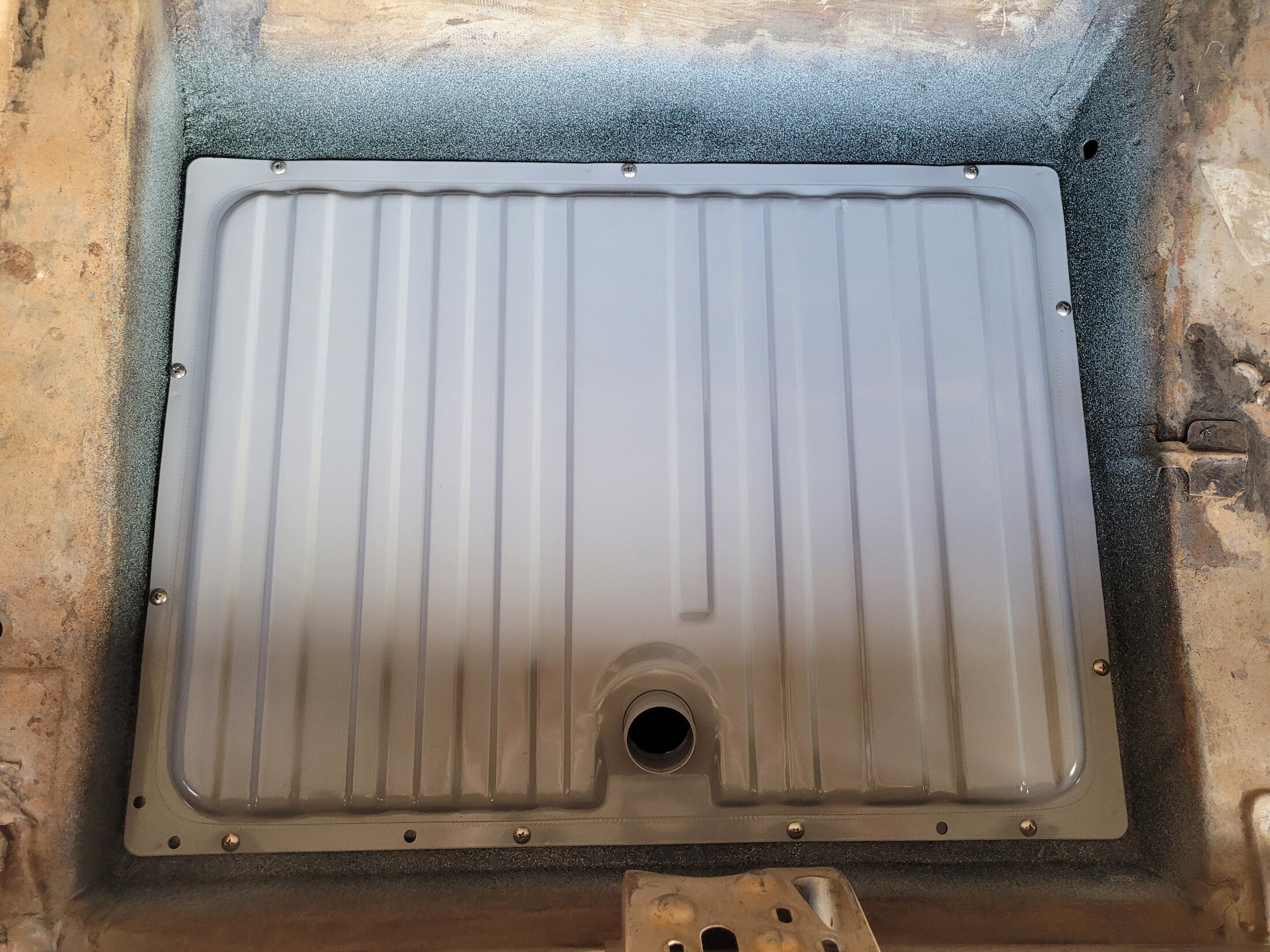

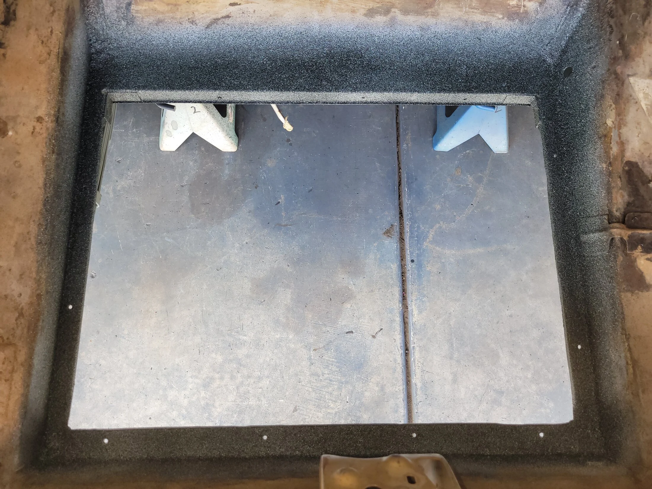

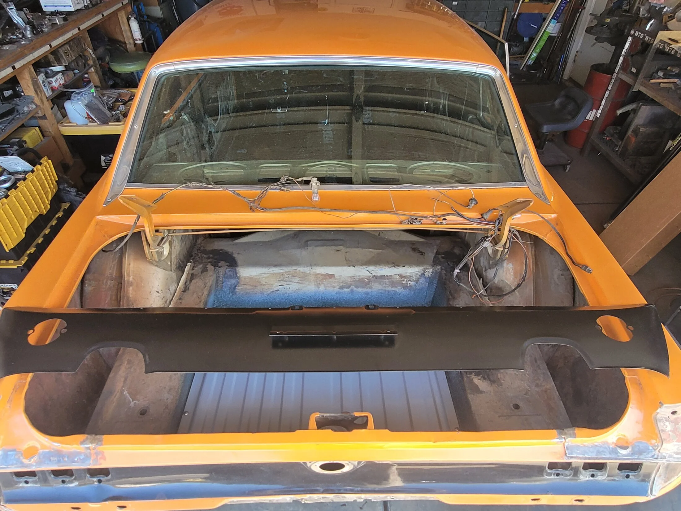

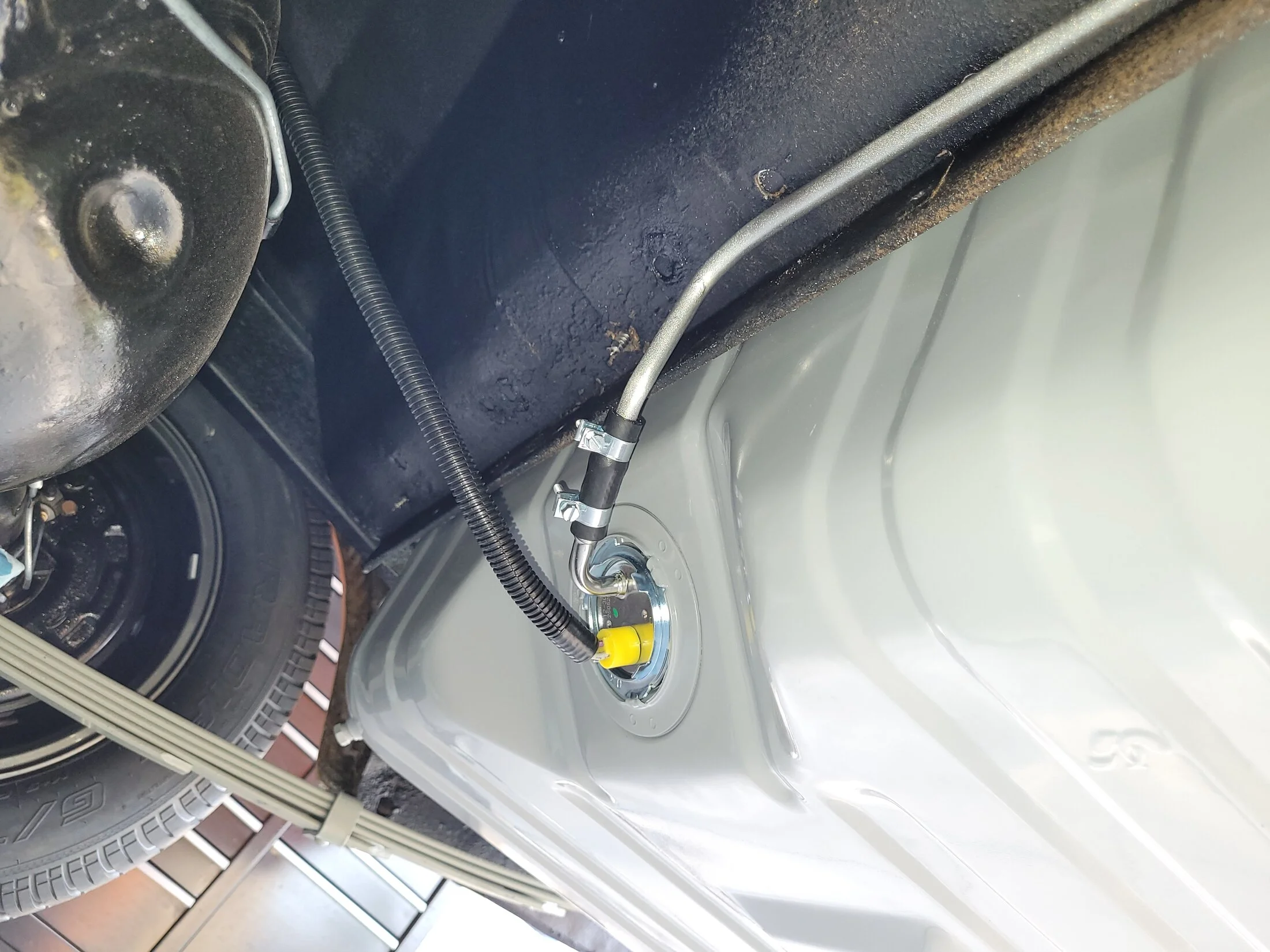

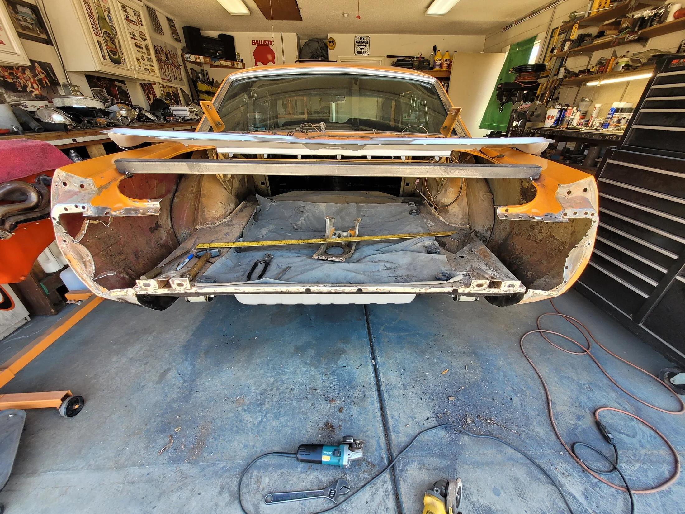

Yesterday after spraying the interior of the trunk where the gas tank sits, my paint had a weird reaction. It was still tacky long after it was supposed to be dry. Well, it's dry this morning. I gave it a second coat and am calling it good.
Tank to be installed next.

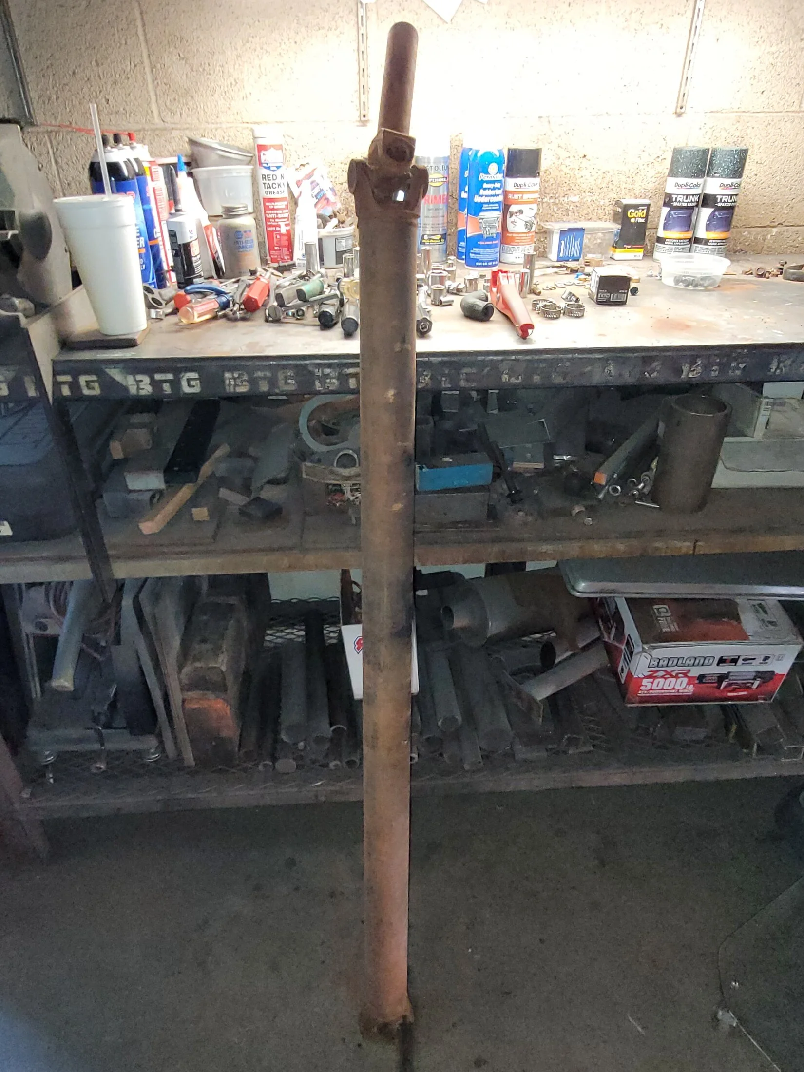

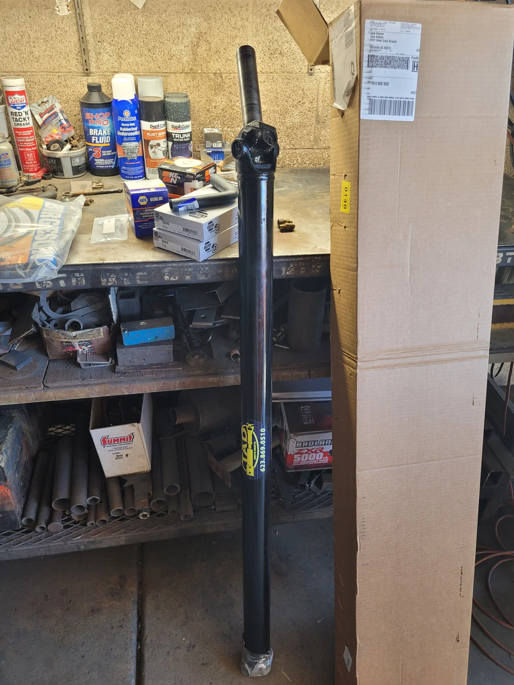

Back on the 68 after a trip to Illinois. I picked up a driveshaft this morning. It needs new ujoints and a balance before it get installed.
Gonna try and tackle some miscellaneous items today. Hopefully have more progress pix later.

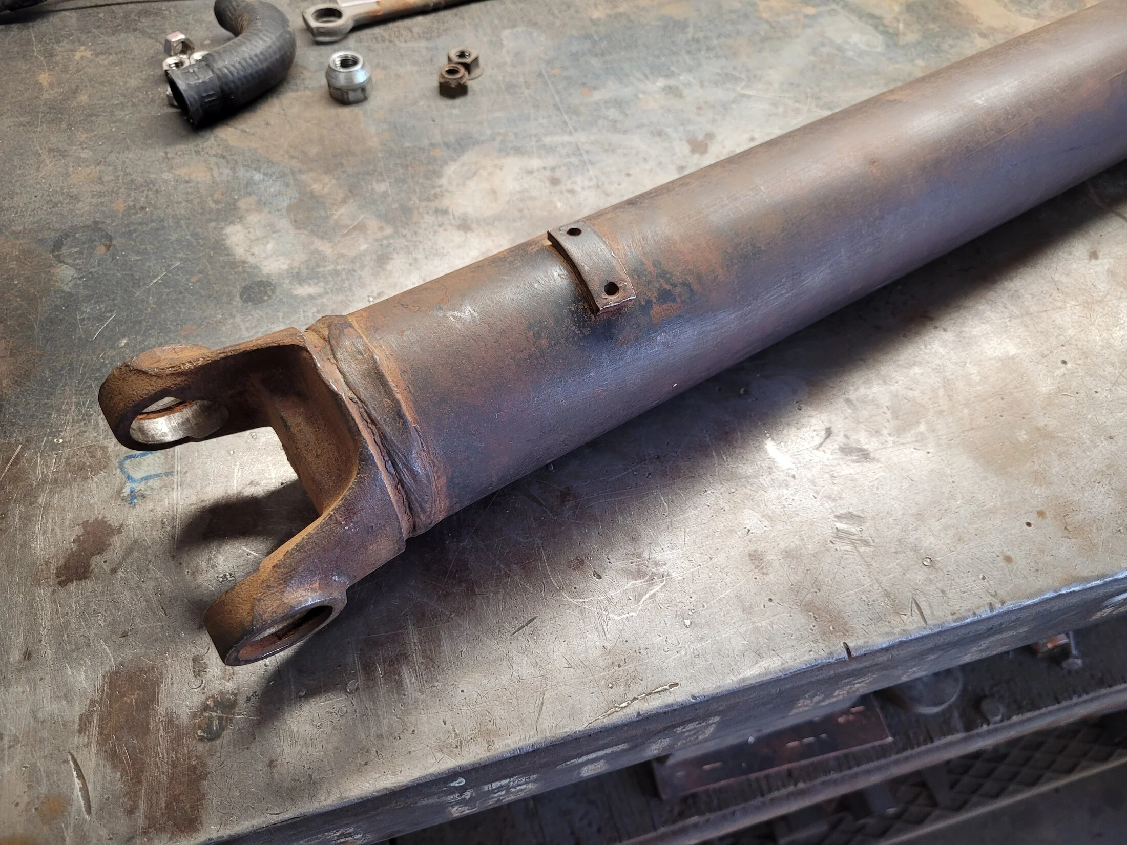

Got the driveshaft all taken apart and somewhat clean. Gonna drop it off for new joints and a balance.

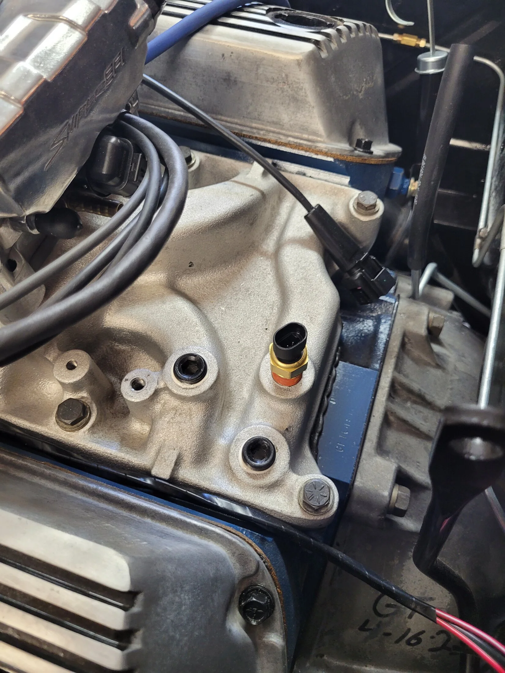

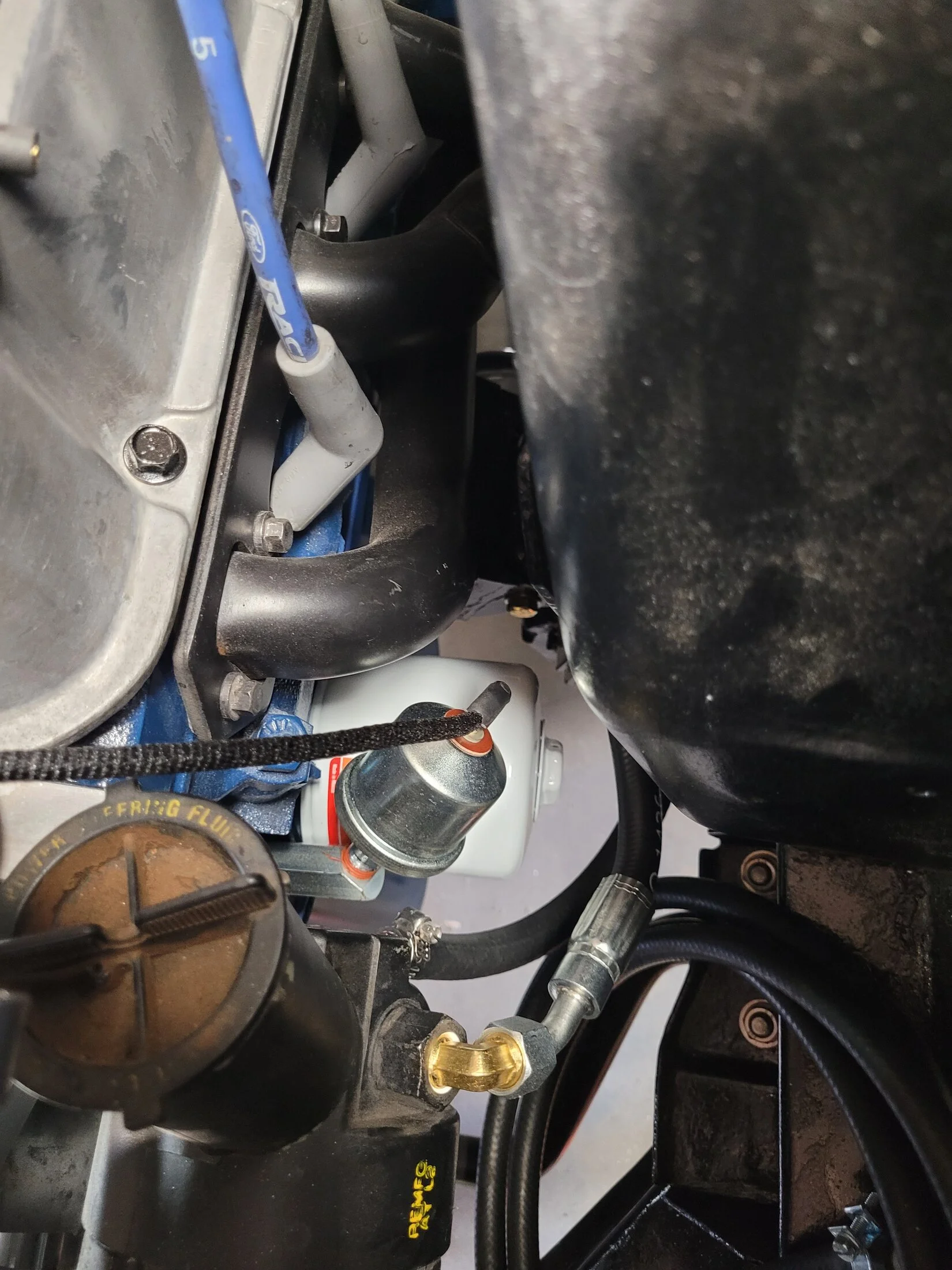

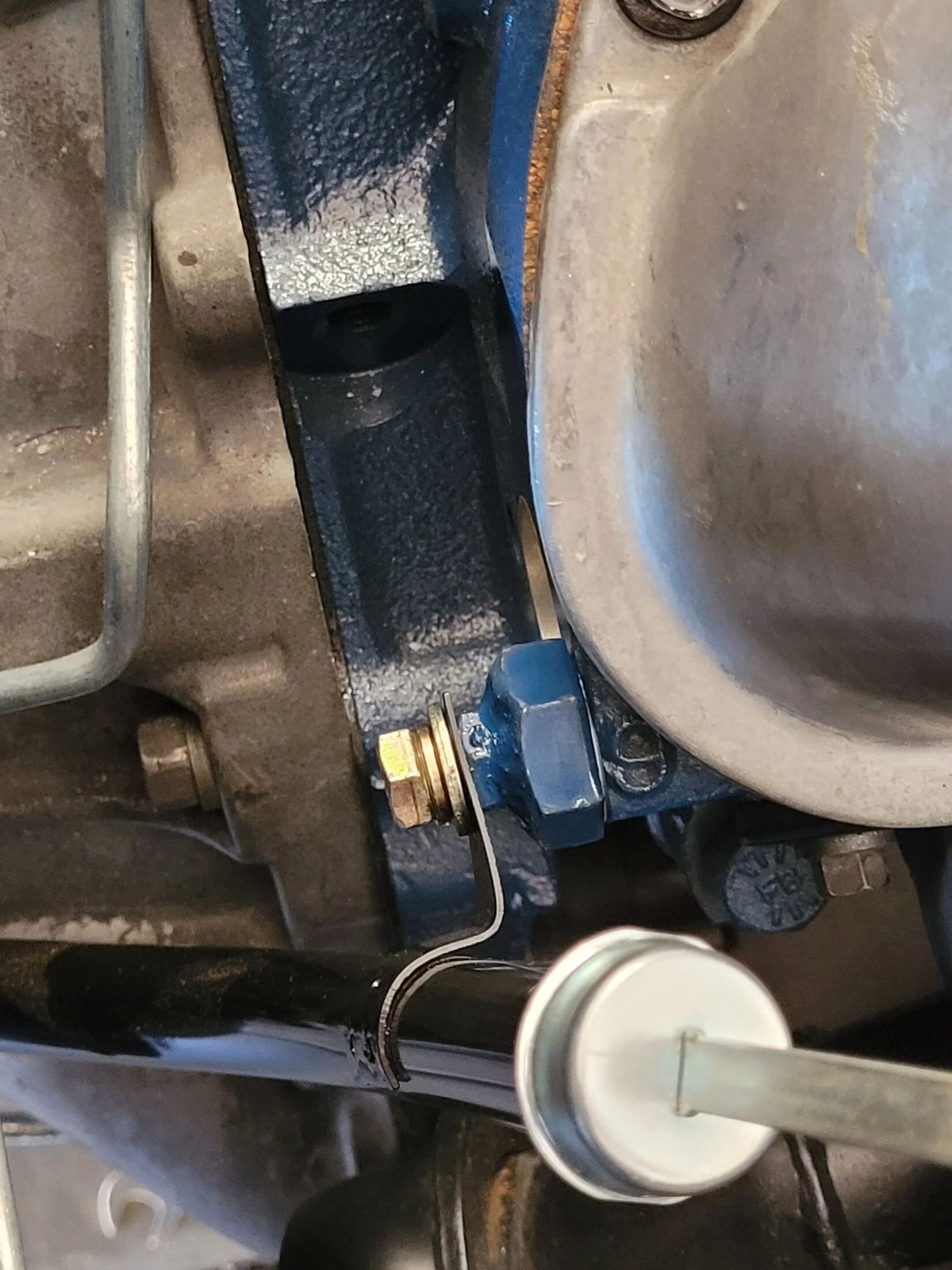

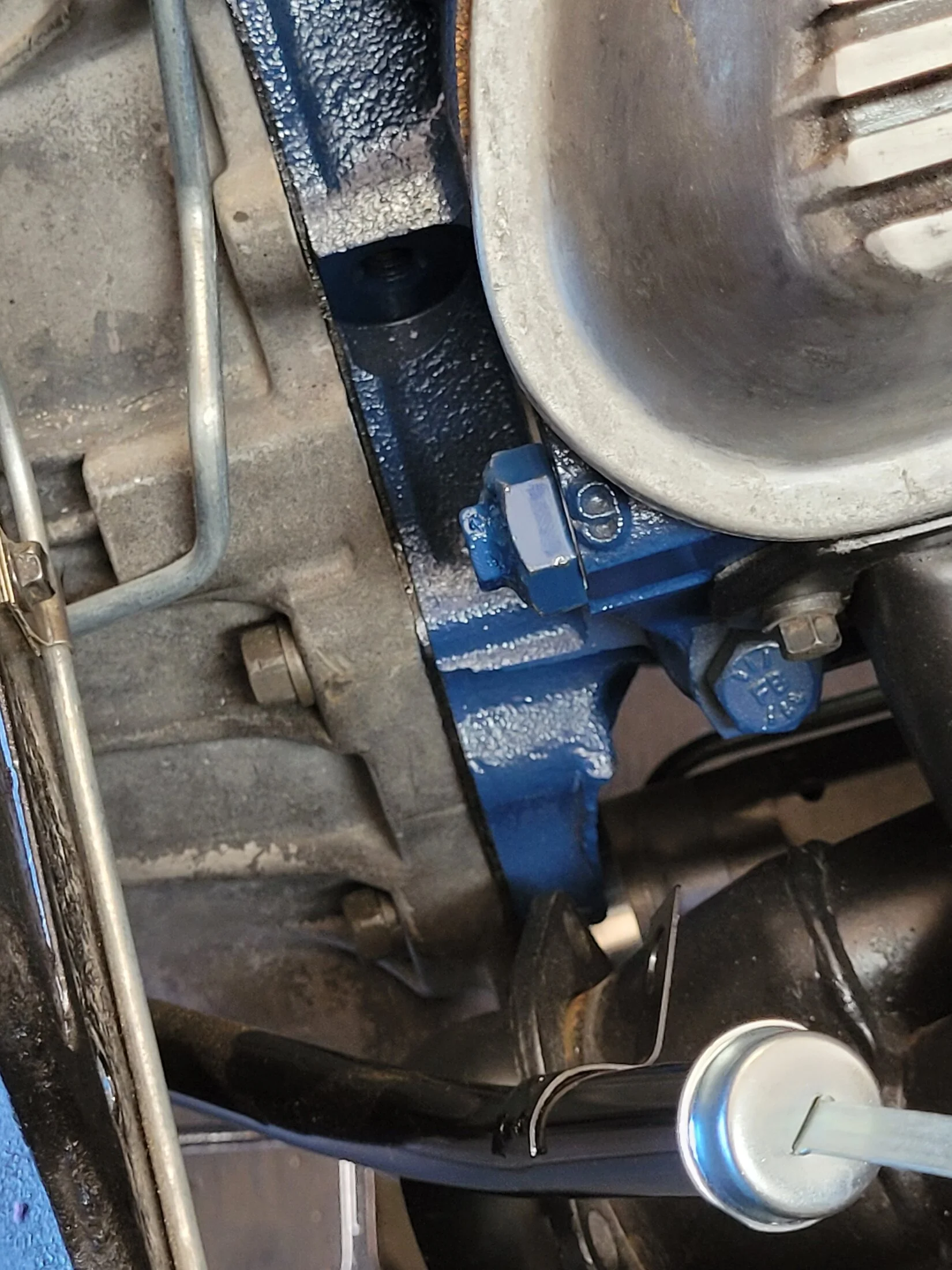

Got the oil sender with its extension installed.

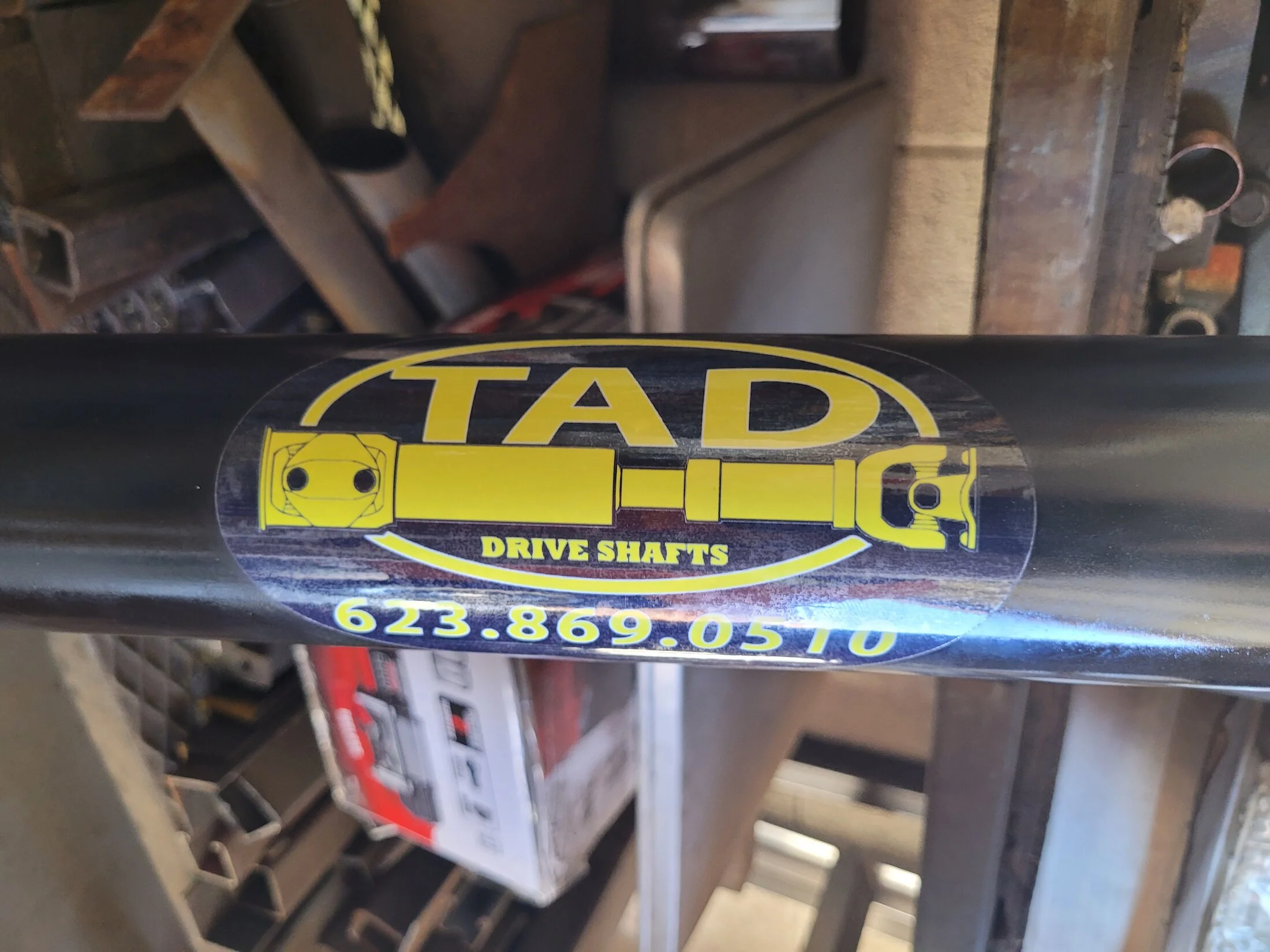

Huge thanks to the guys at TAD driveshaft service for the super quick turnaround. Got it back today and it looks great.

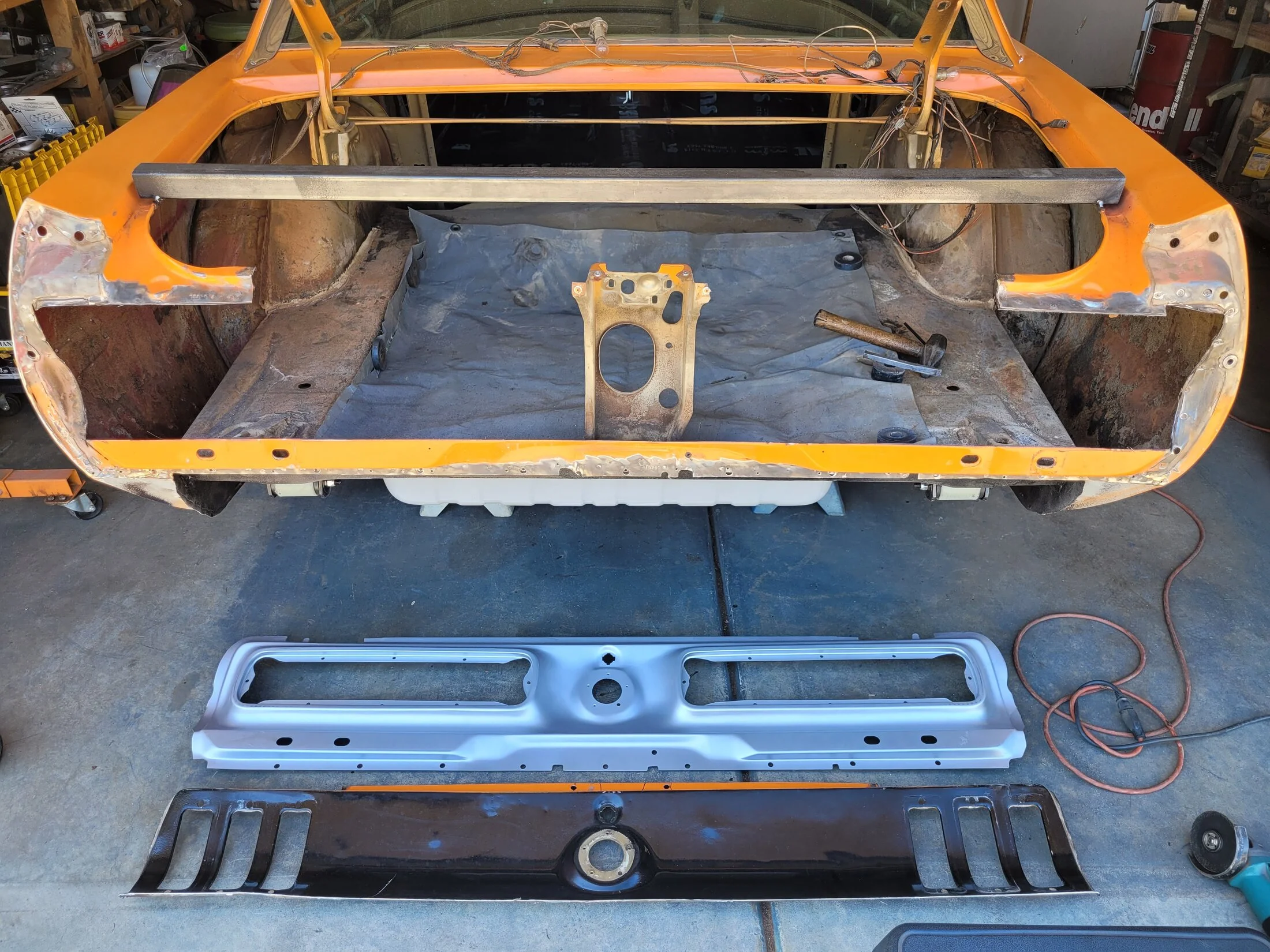

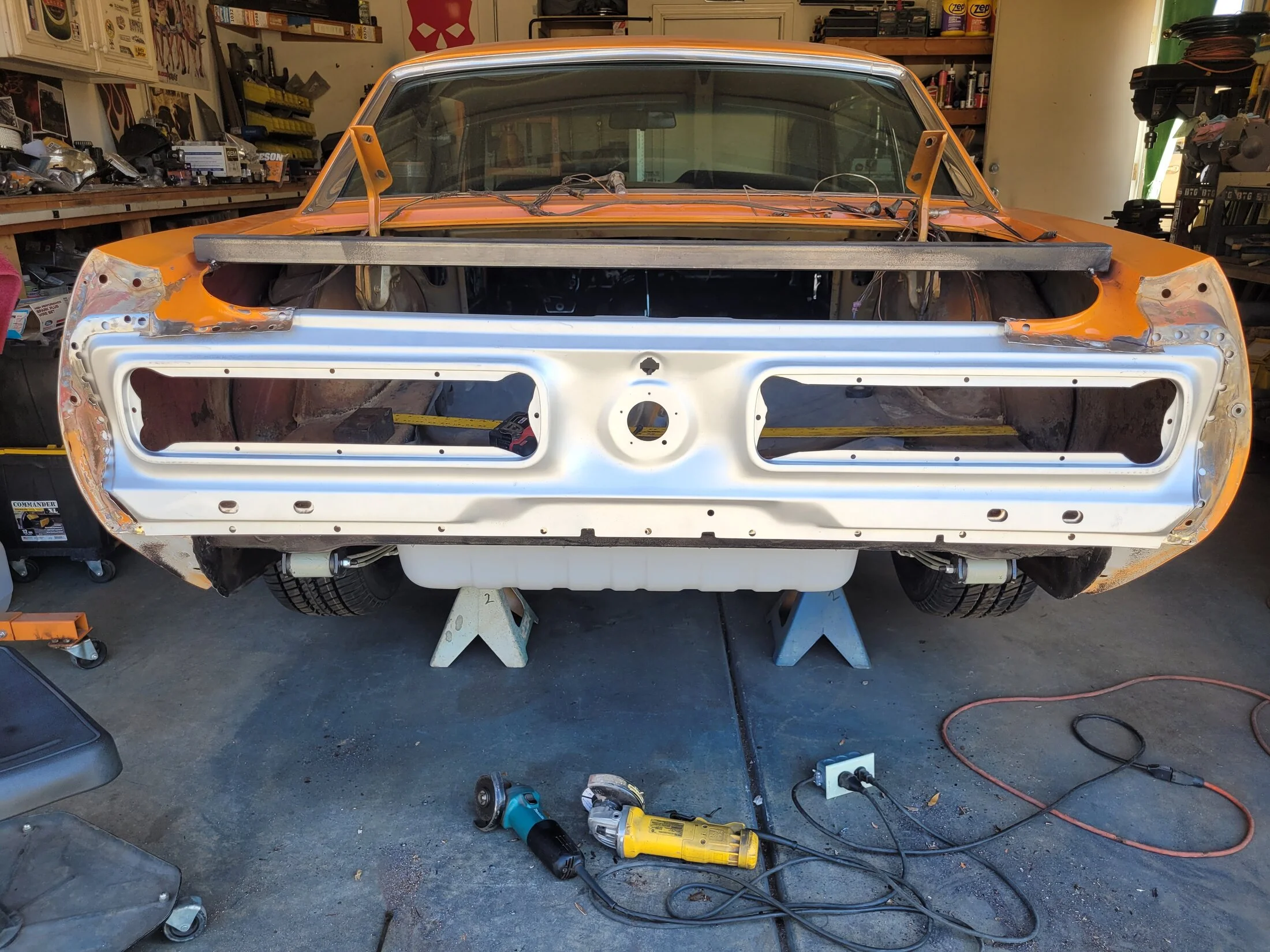

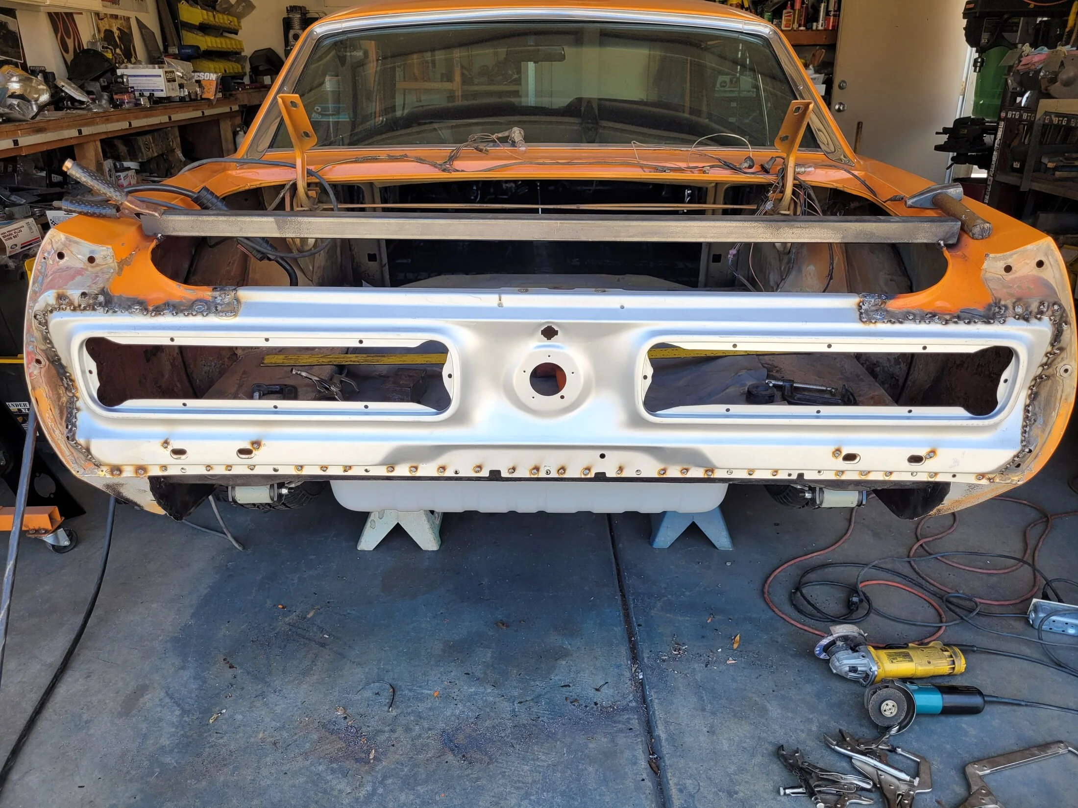

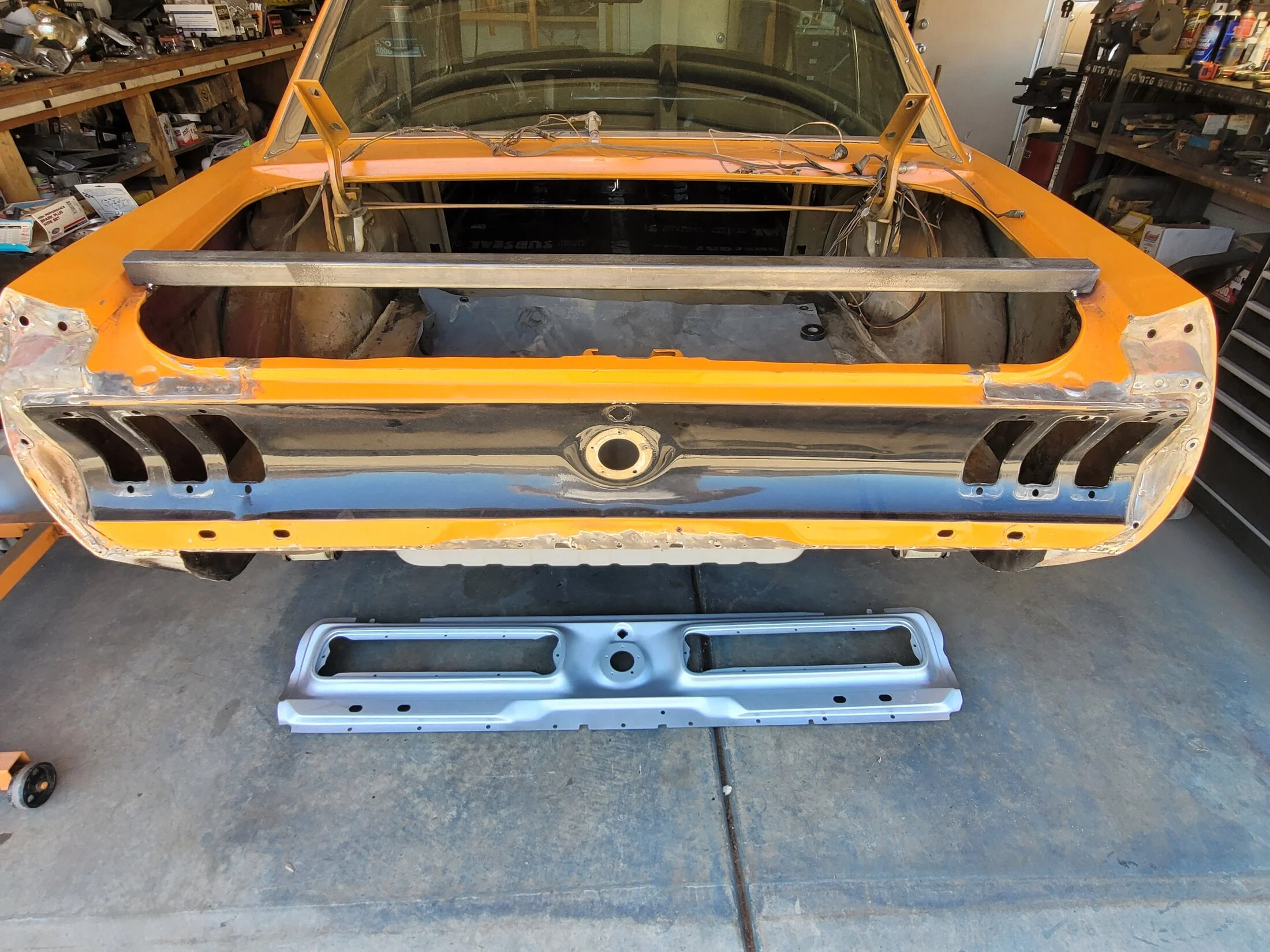

Also had some other parts show up.....including the new rear valance with cut outs for the dual exhaust.

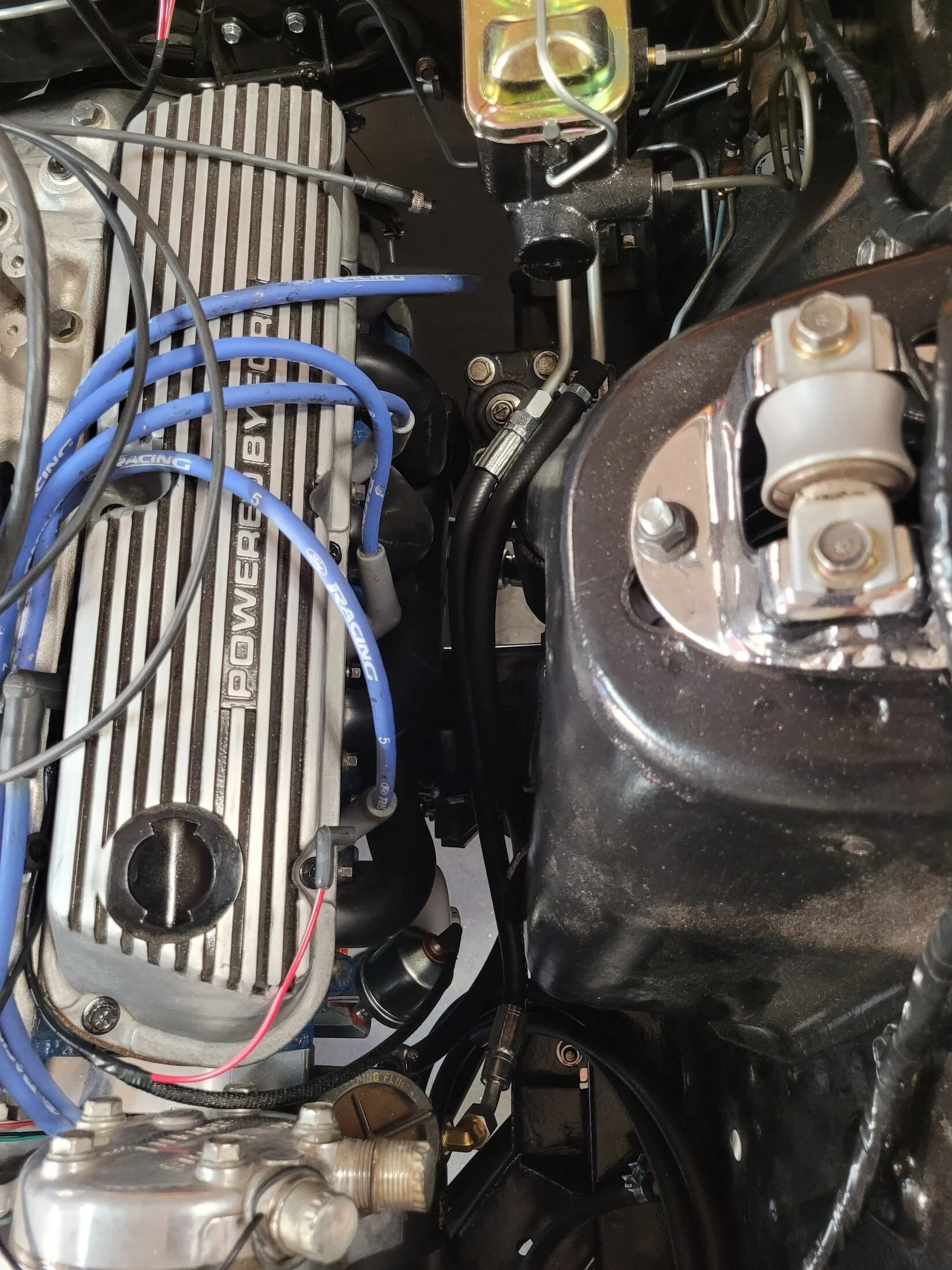

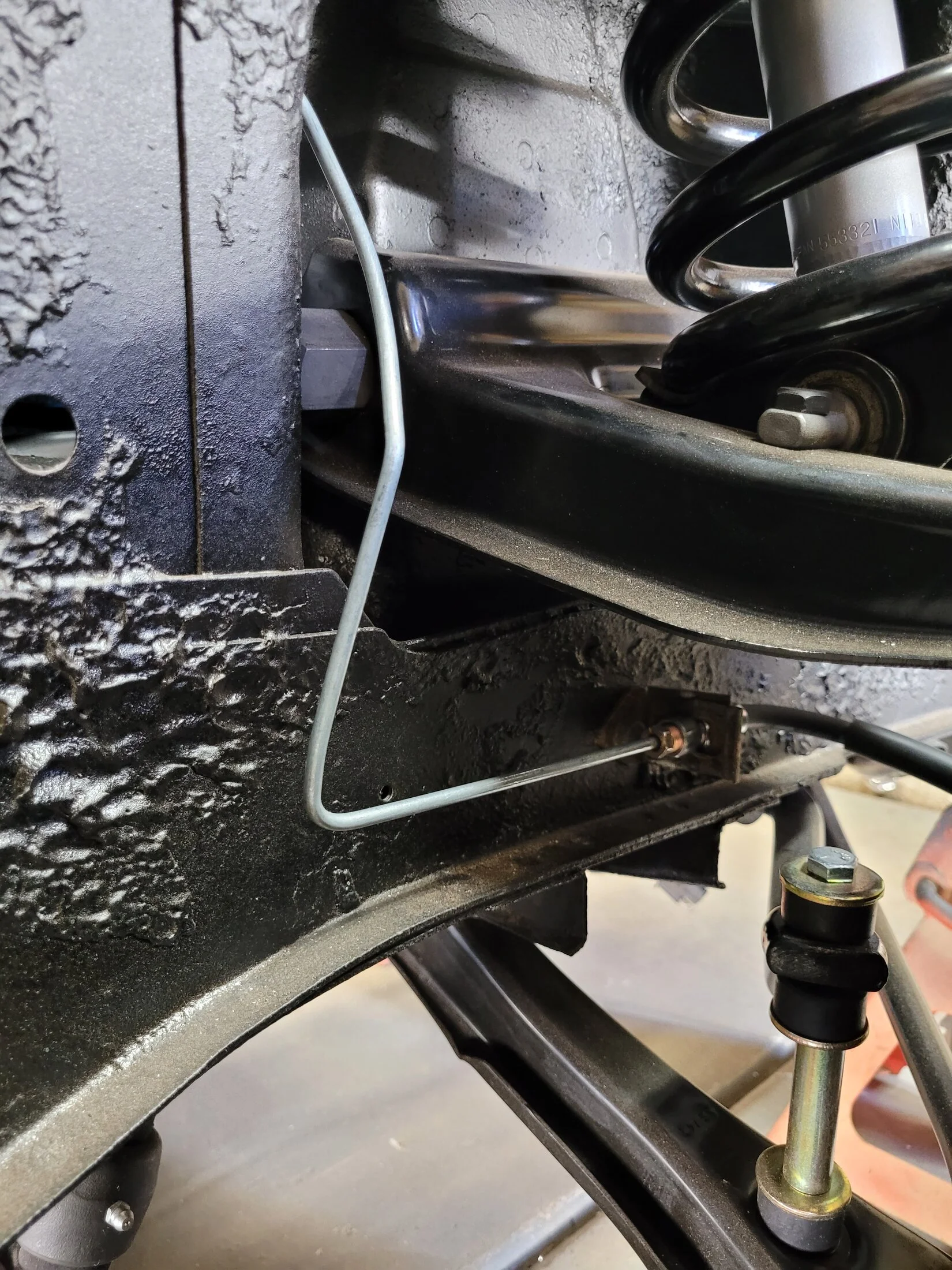

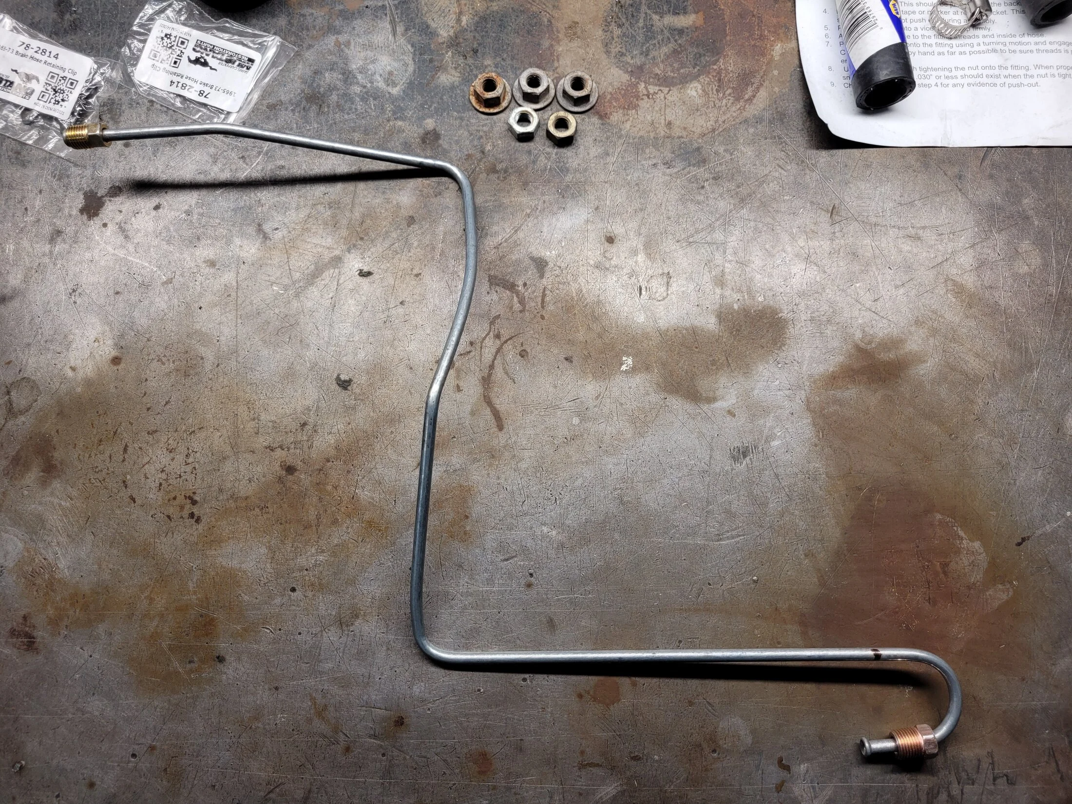

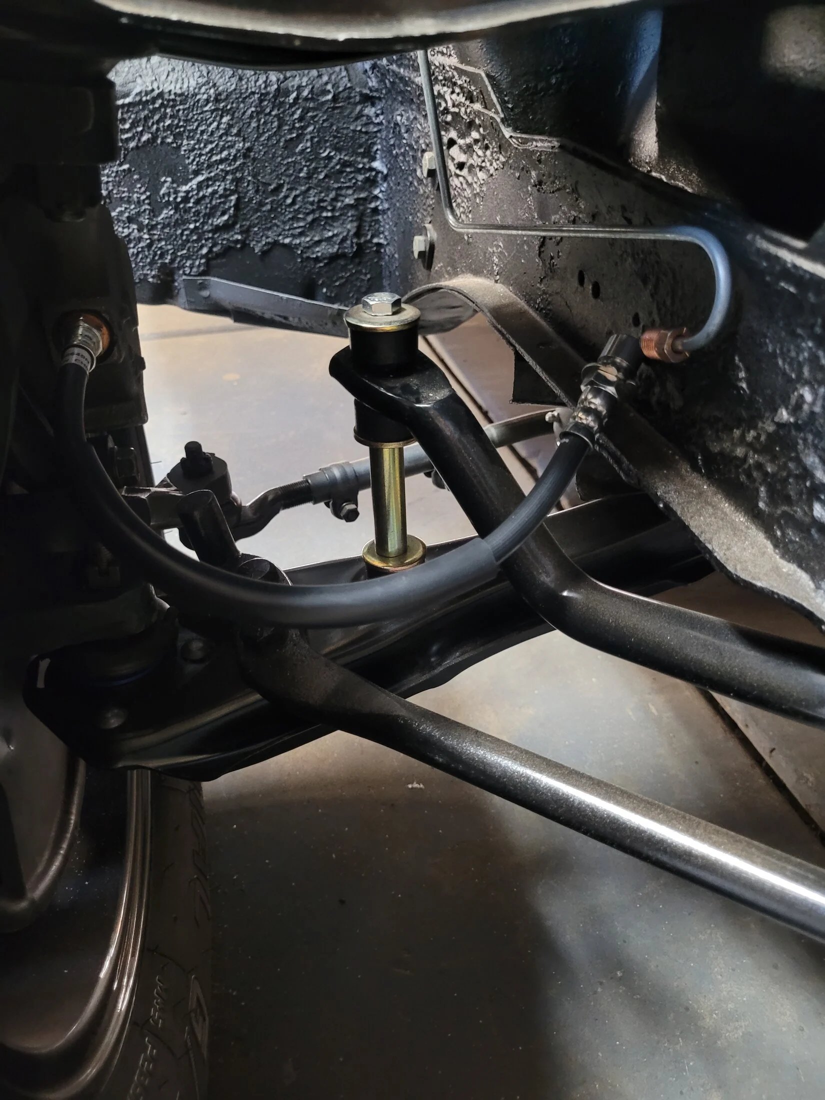

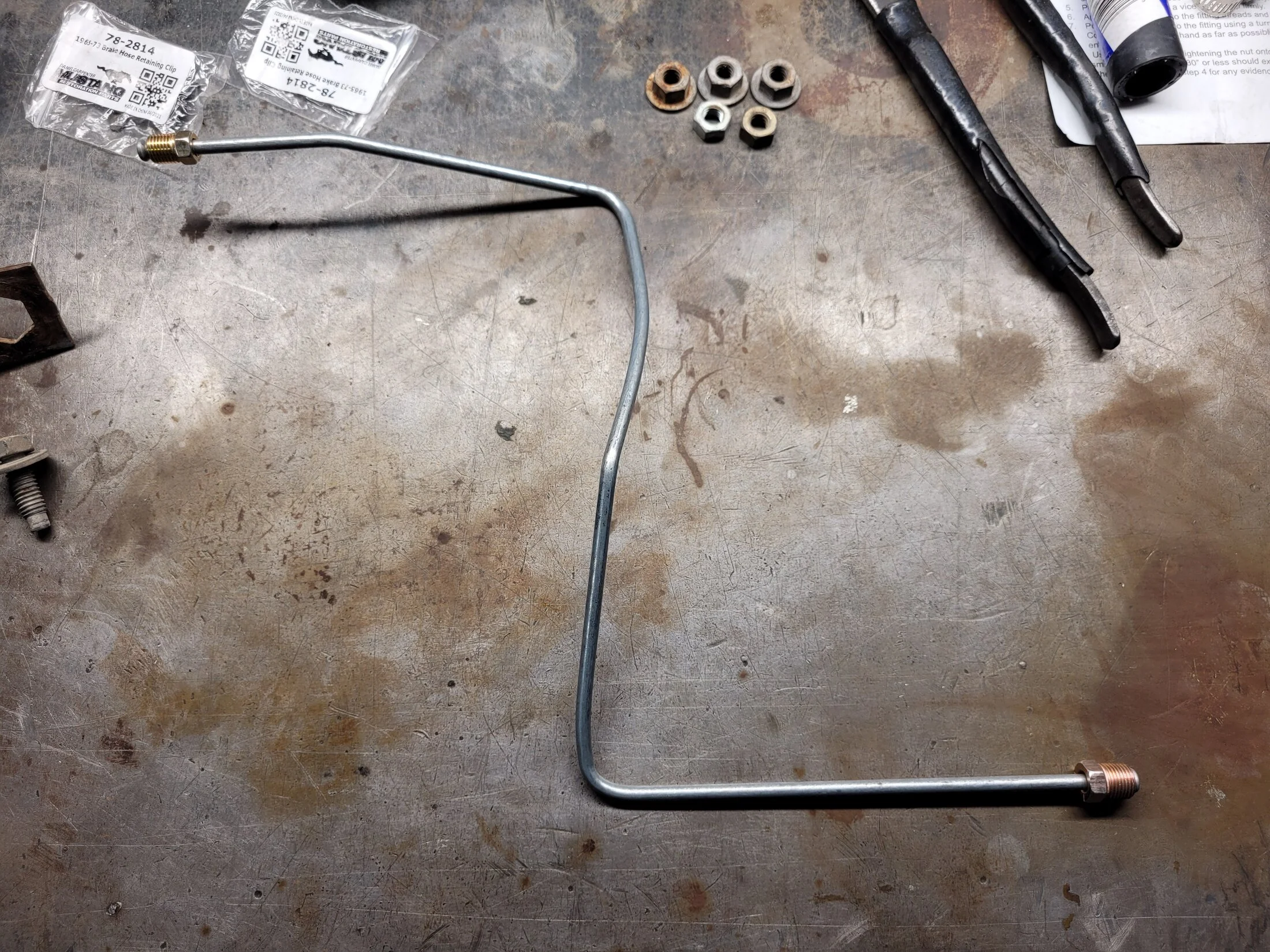

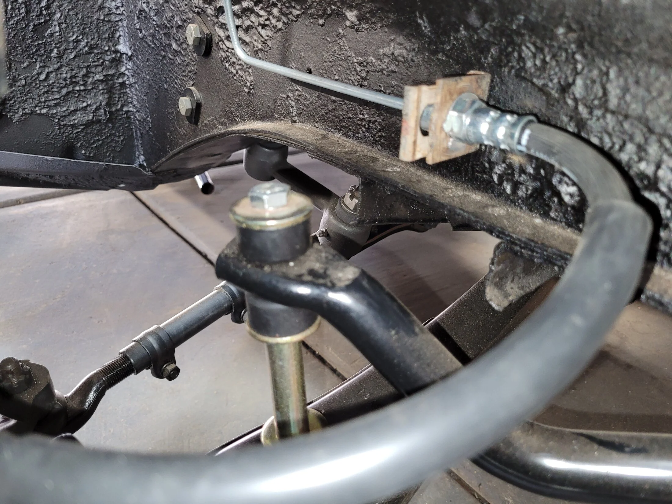

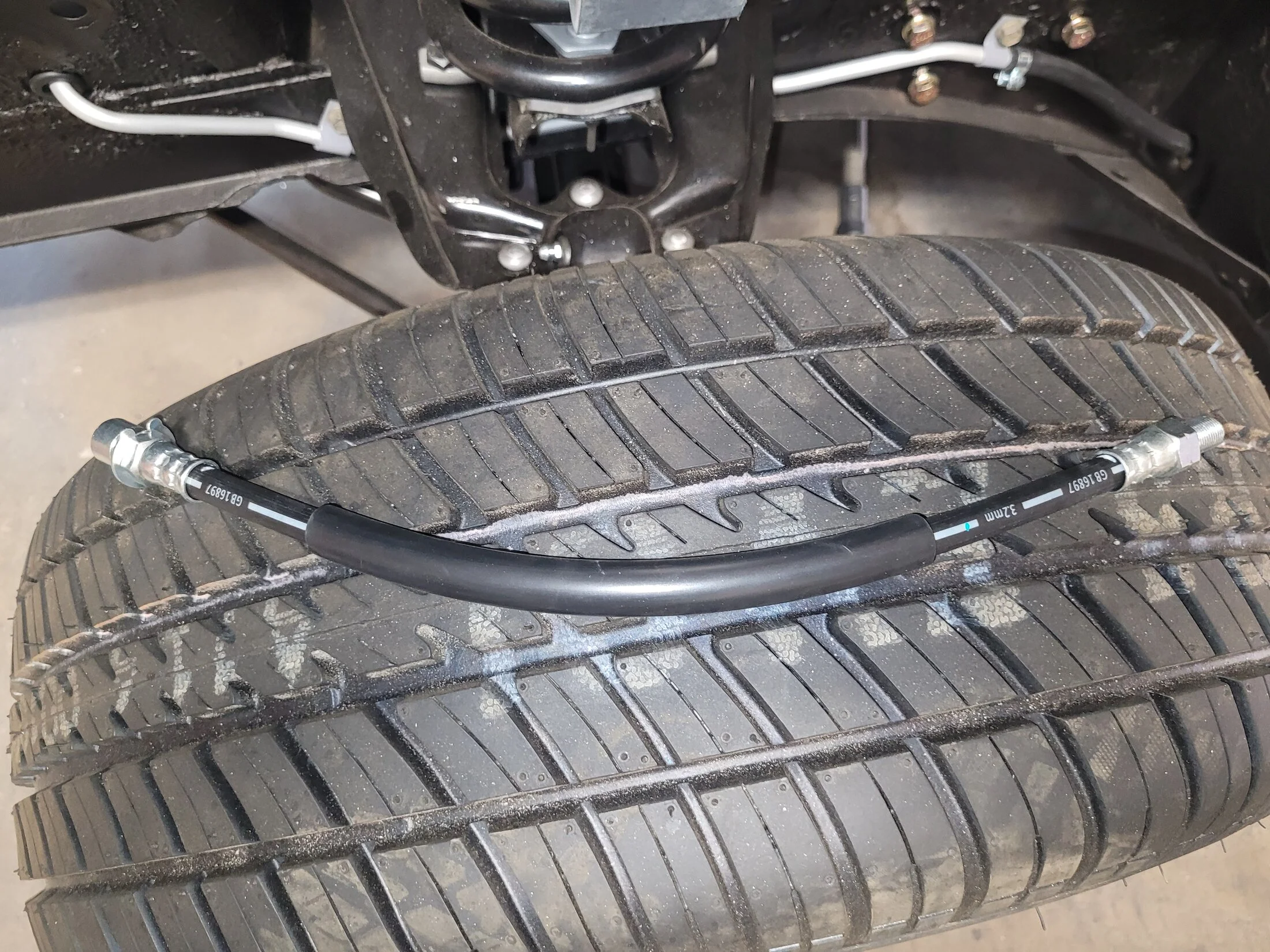

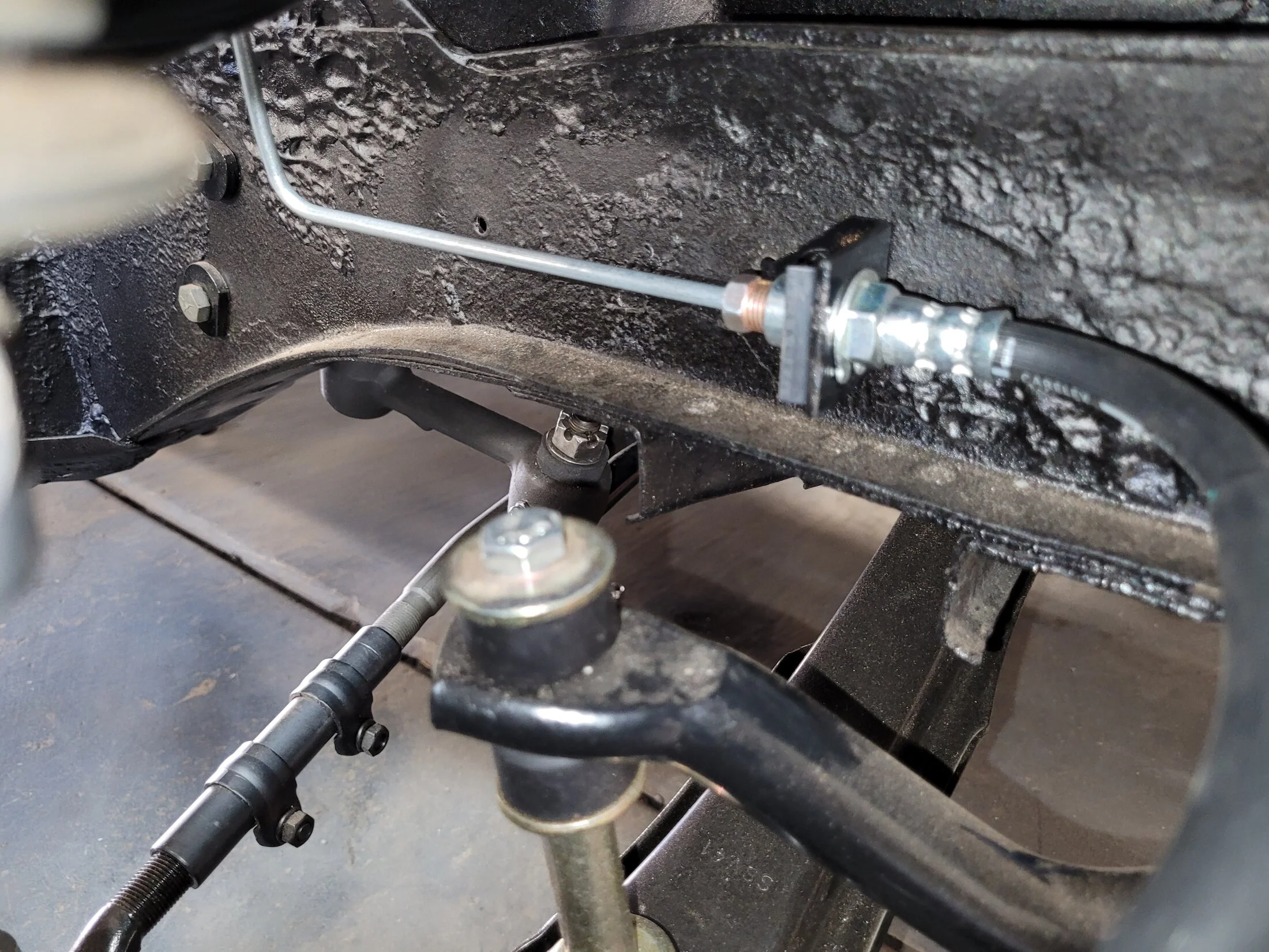

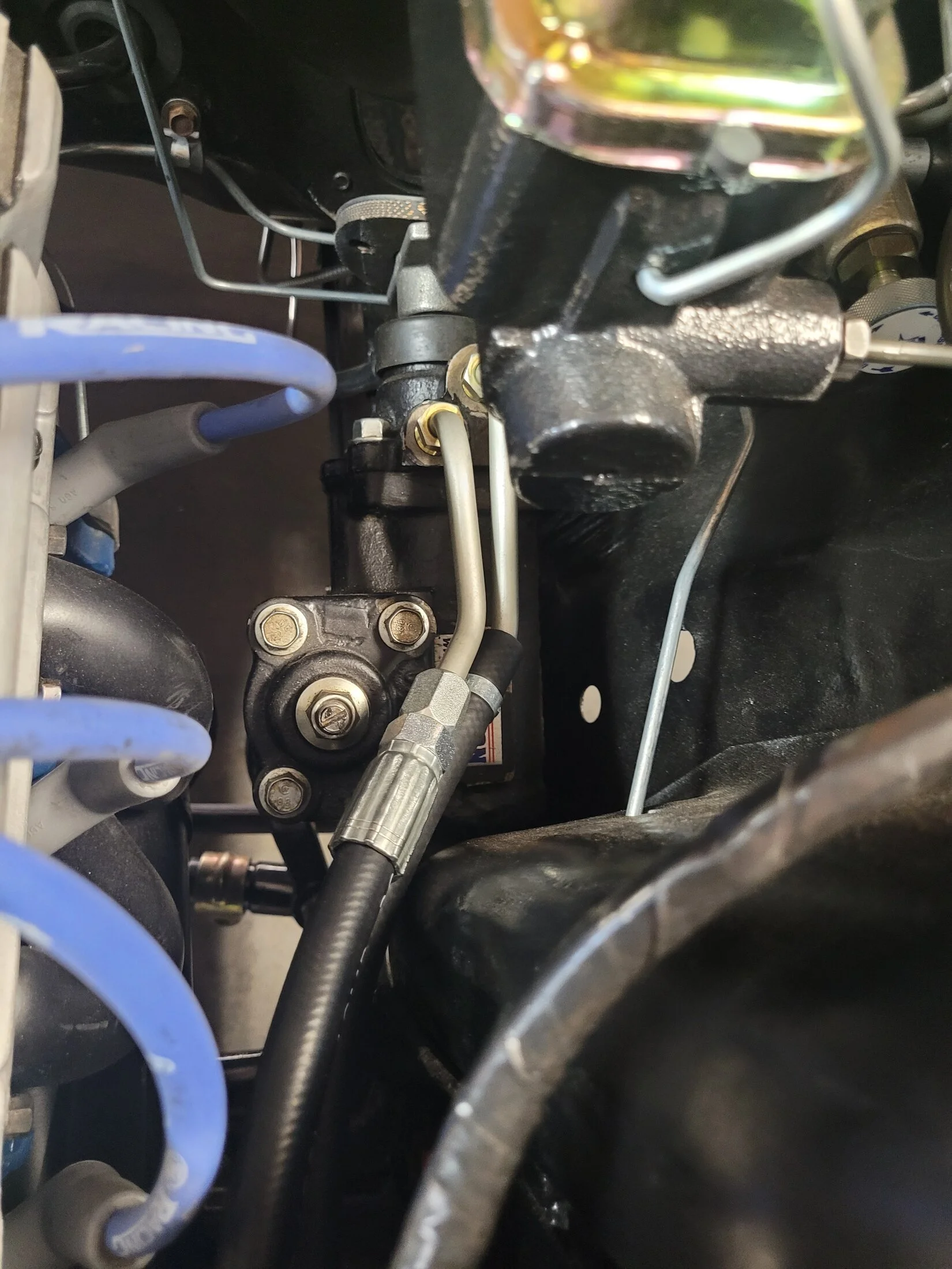

Finally found the correct off the shelf brake hoses for the front. I will need to redo the end of the hardline, but thats not an issue. Got the power steering hoses, but now need a 90 for the pump end. It's always something......lol

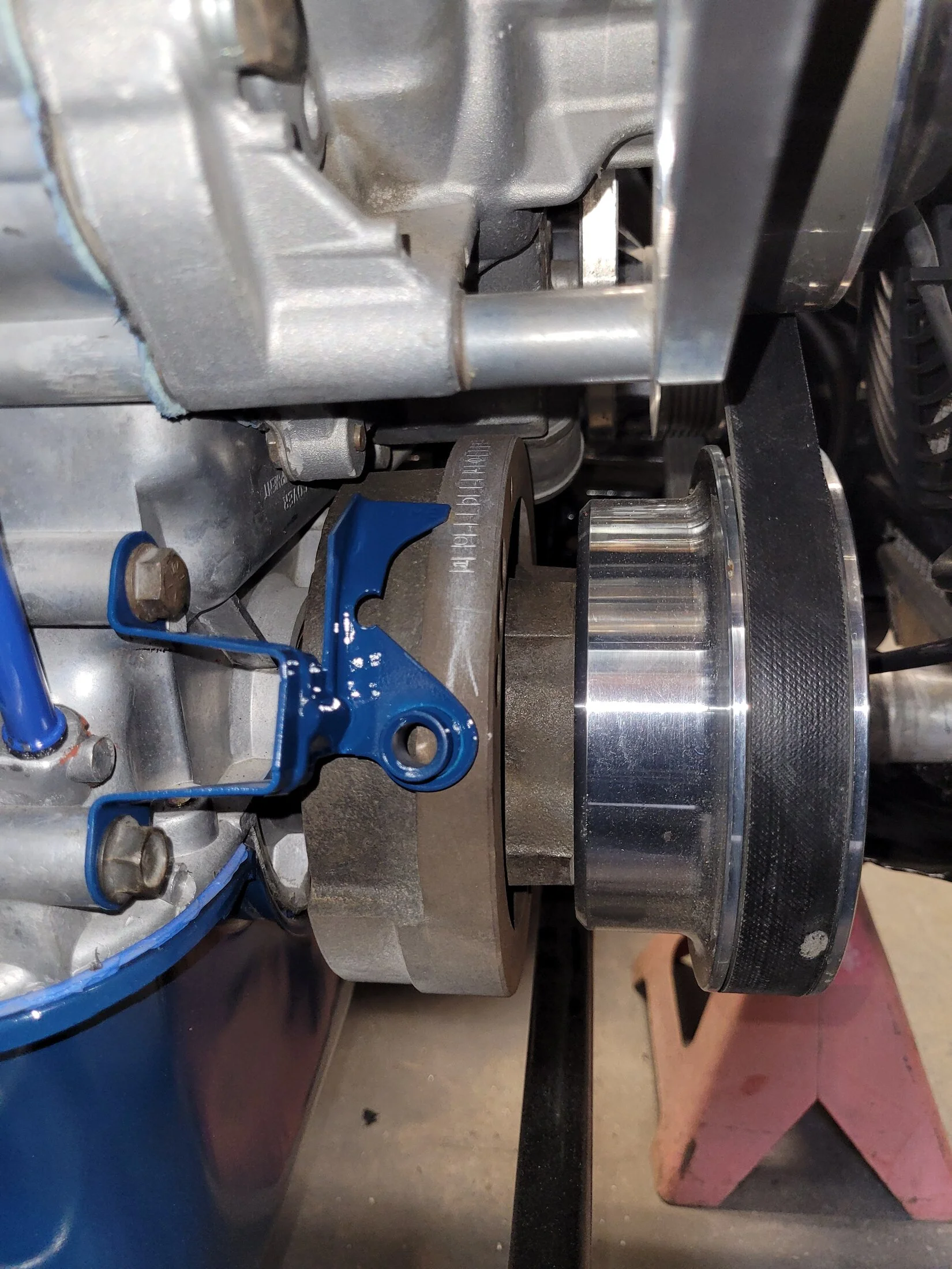

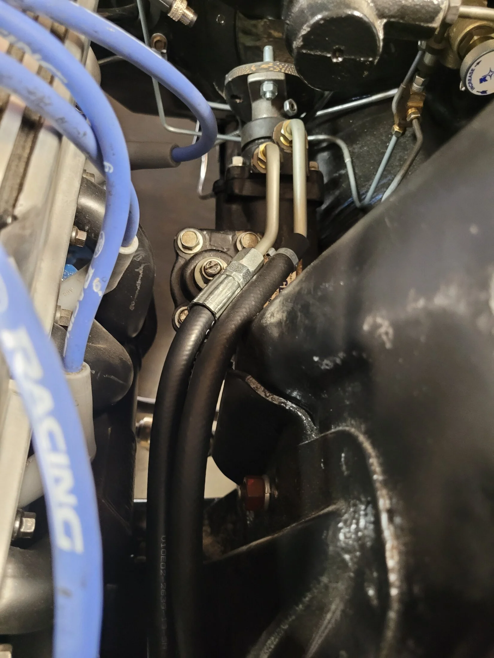

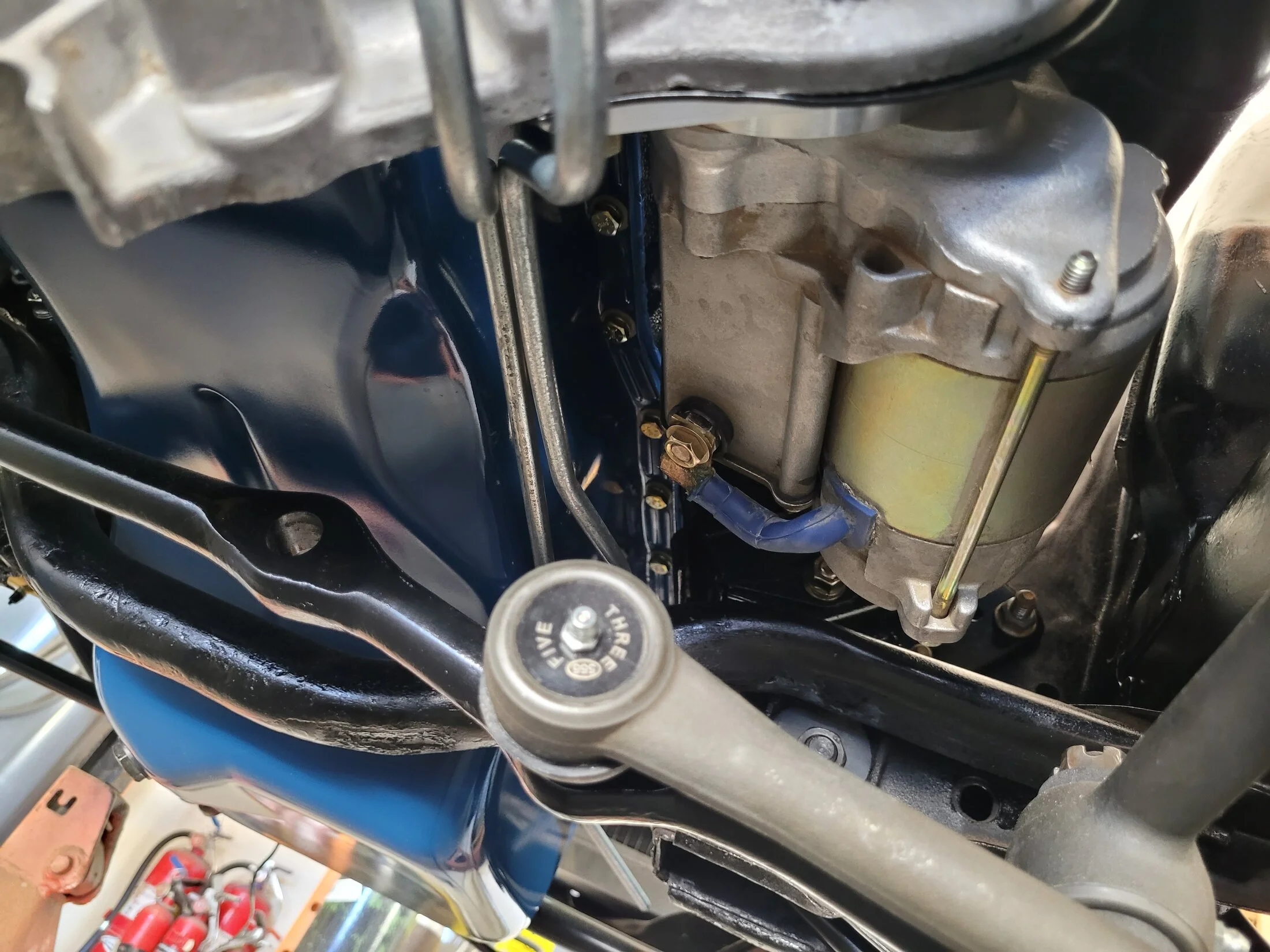

Today is problem solving day.......and so far so good. I reclocked the starter for steering linkage and cooler line clearance. Then I made a little dodad that mounts the top of the transmission filler tube to the head.

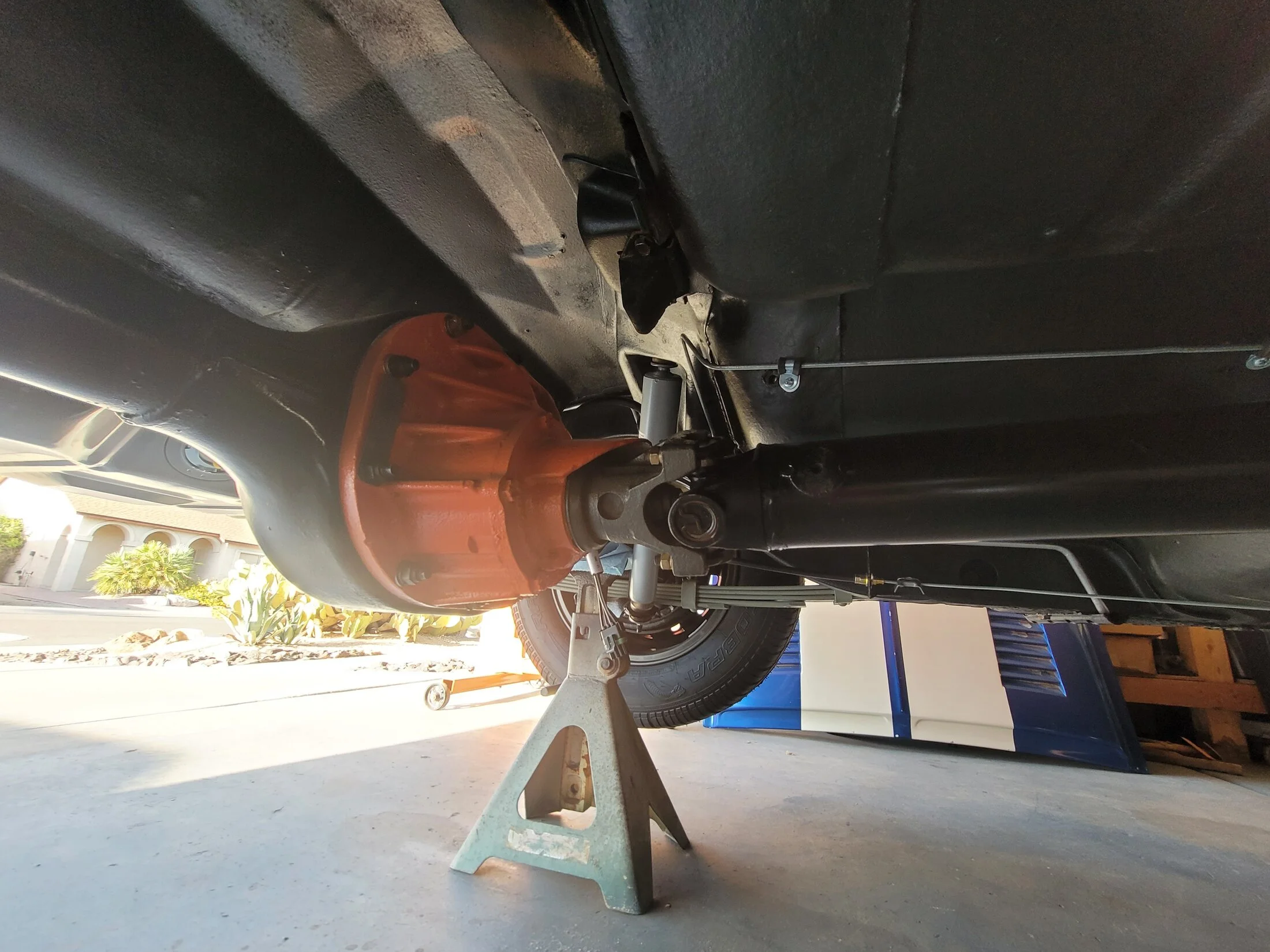

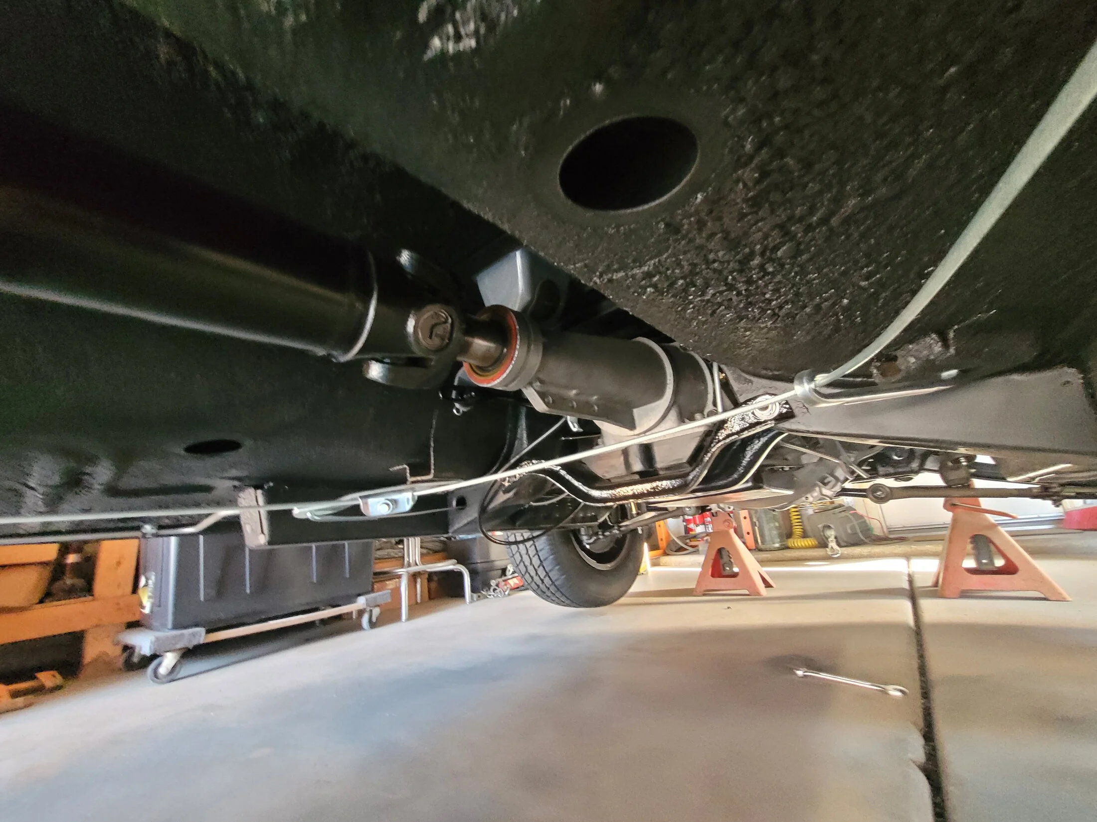

After much struggling and head scratching.......I got the driveshaft installed. The end of the slip yoke had mushroomed slightly making it not fit through the tail housing bushing. Alittle work with the grinder and it fits perfectly.

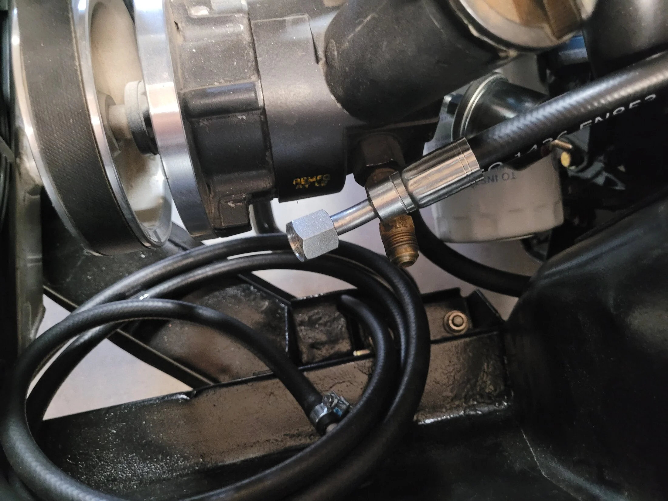

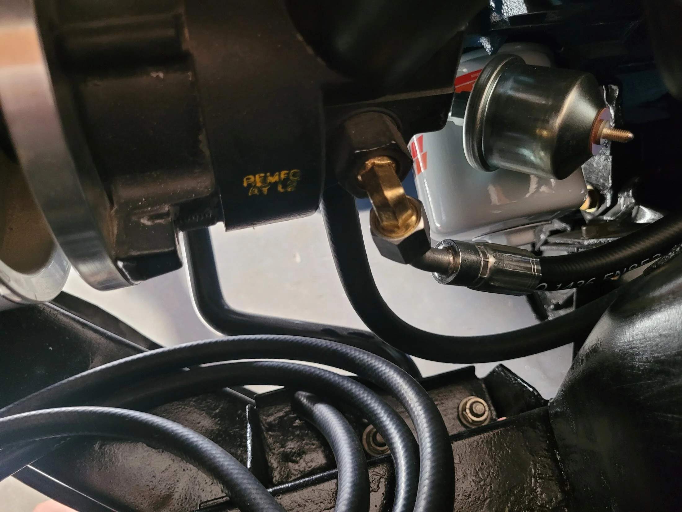

I think I solved another issue. My new power steering line didn't want to connect to the pump. After fiddling with different fittings, I think I have it fixed. Guess I'll find out after I add some juice and see if it leaks.
