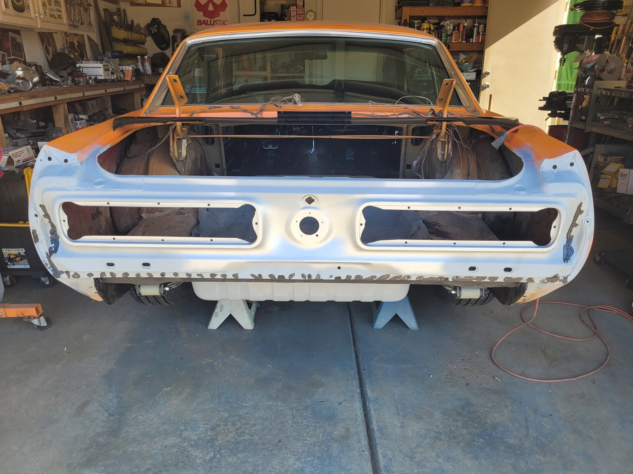

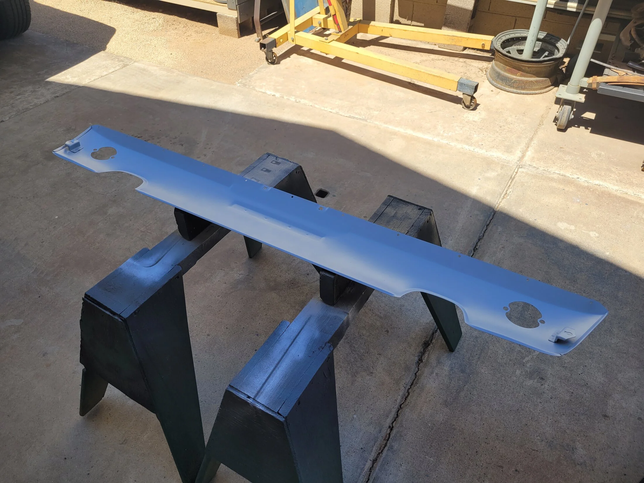

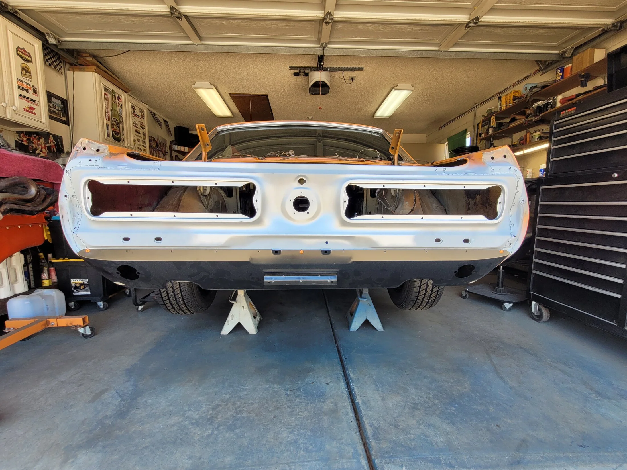

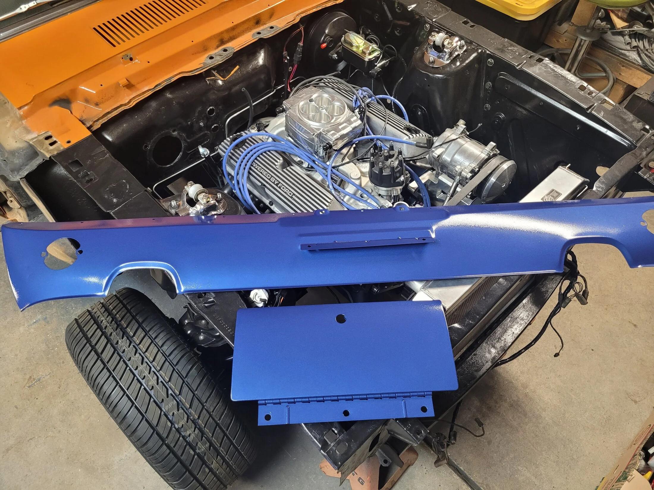

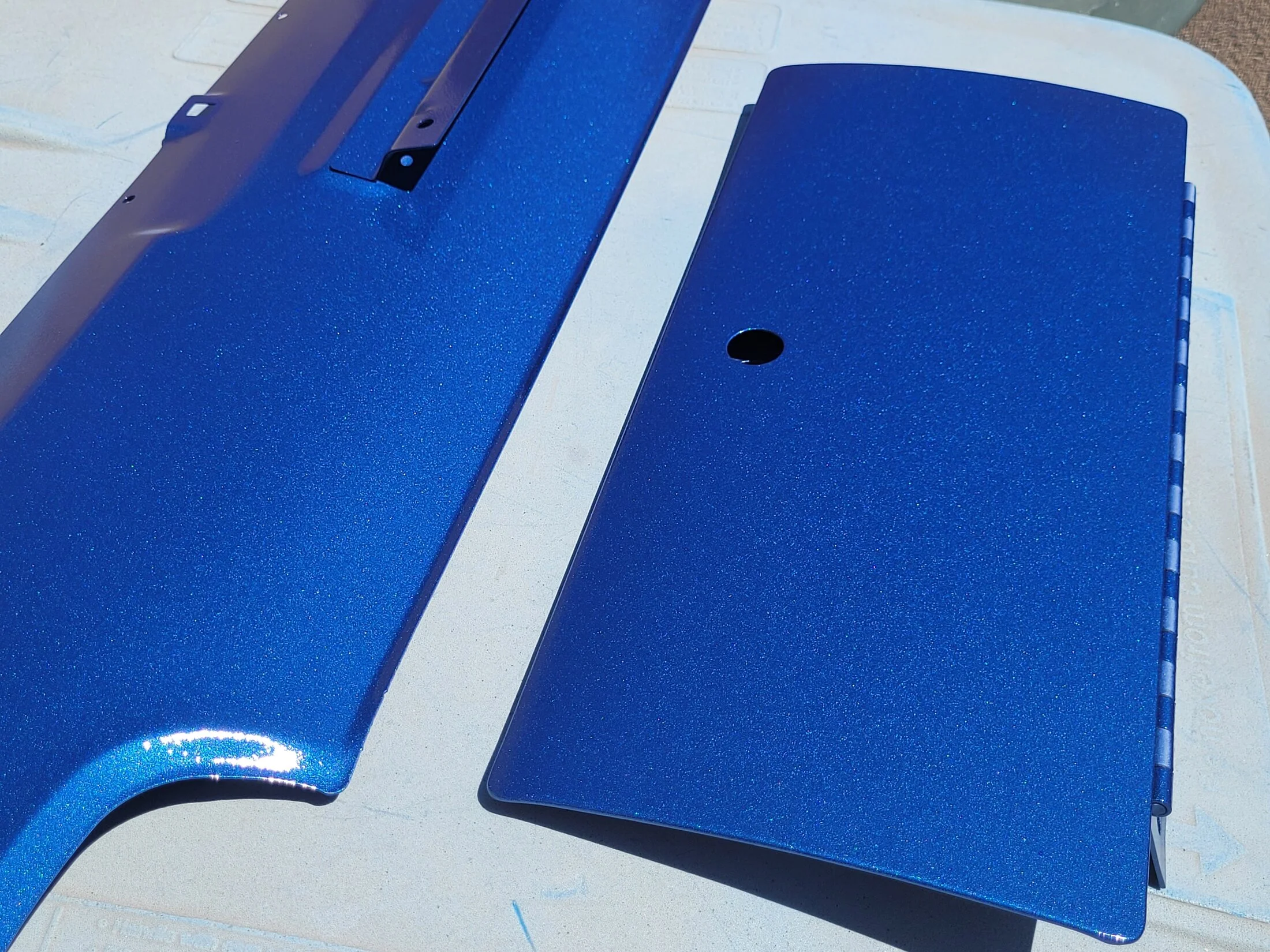

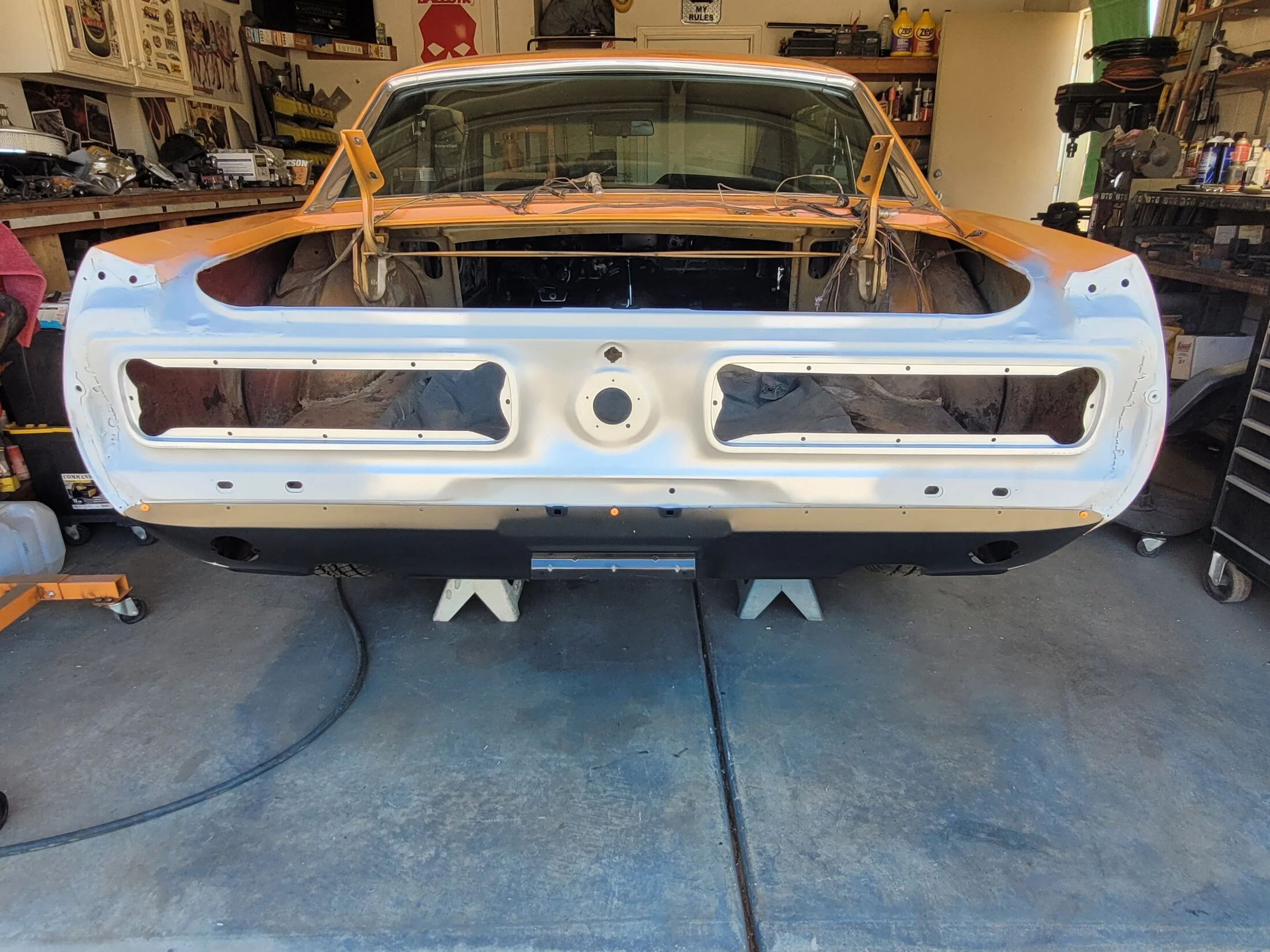

Loosely mounted the valance panel for the visual effect. Dual exhaust is gonna look sweet poking out through those cut outs.

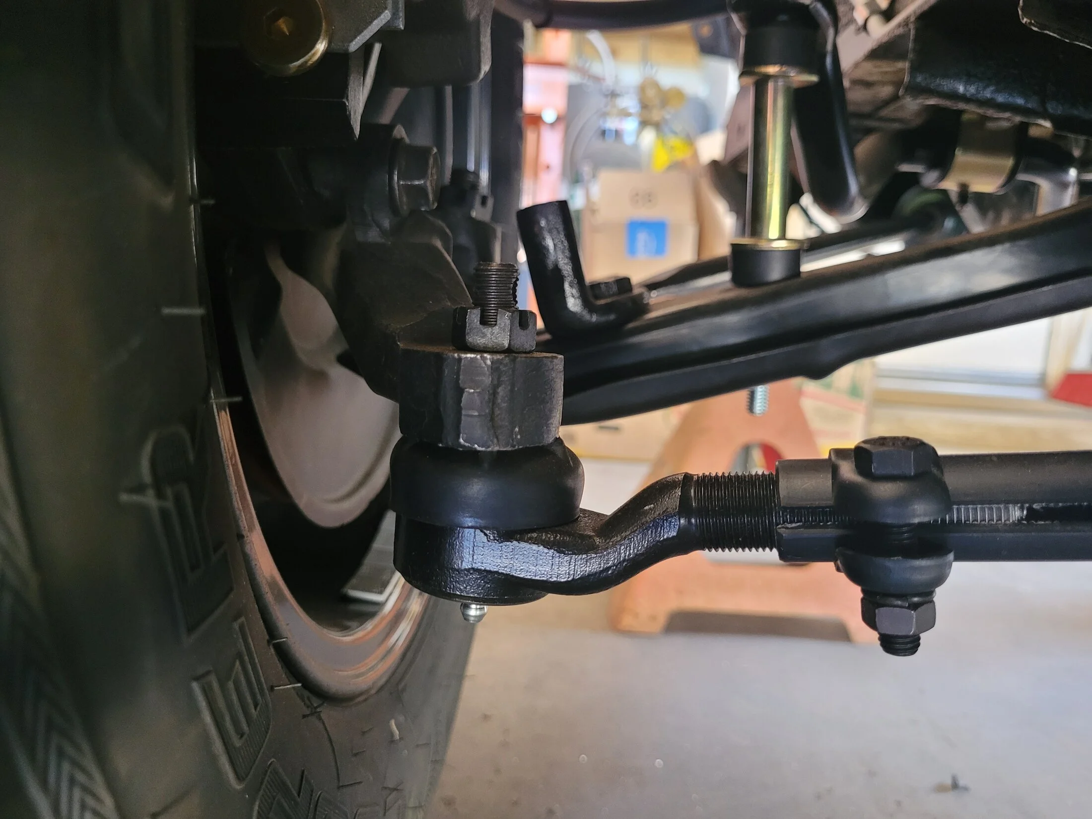

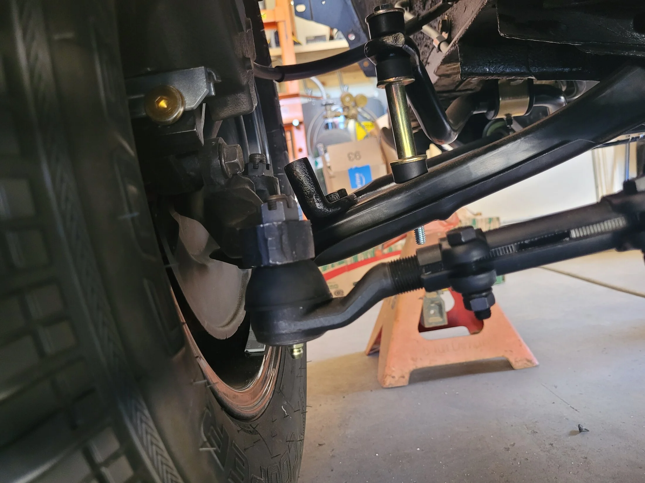

Since it has the Granada spindle and disc brakes, it requires a different tie rod end.
I originally installed Mustang ones and the fitment was poor. Makes sense now. The correct tie rod end has a slightly beefier stud and fits perfectly.

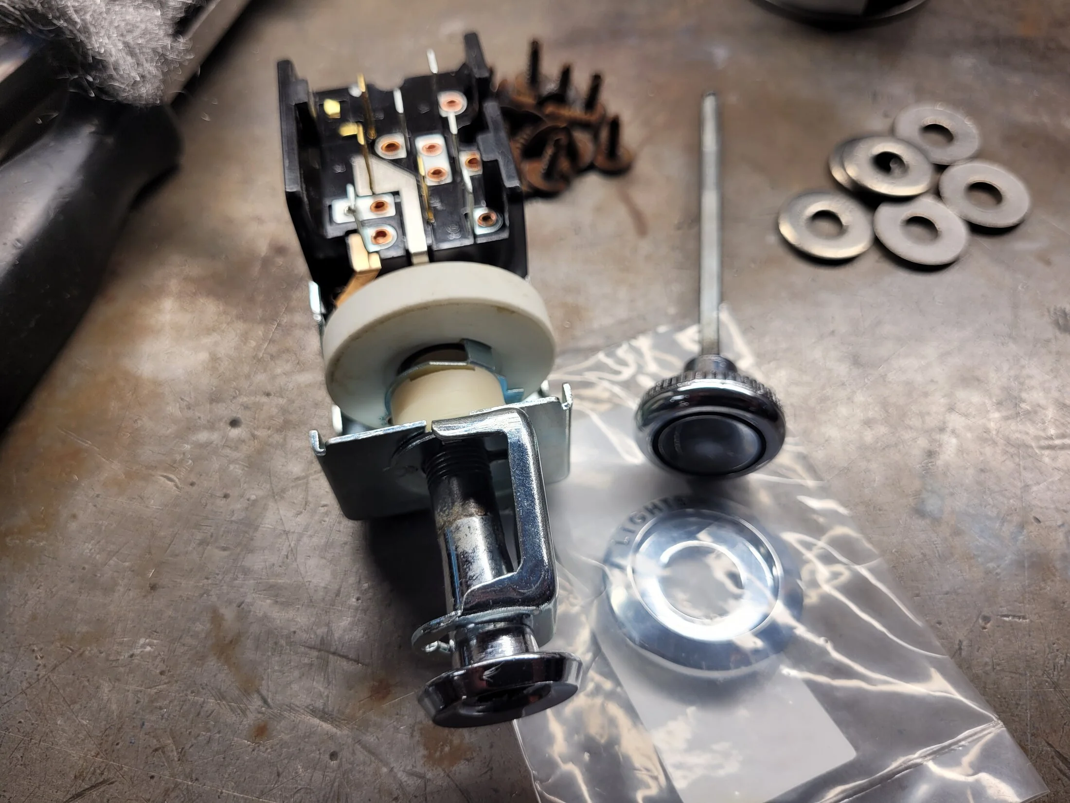

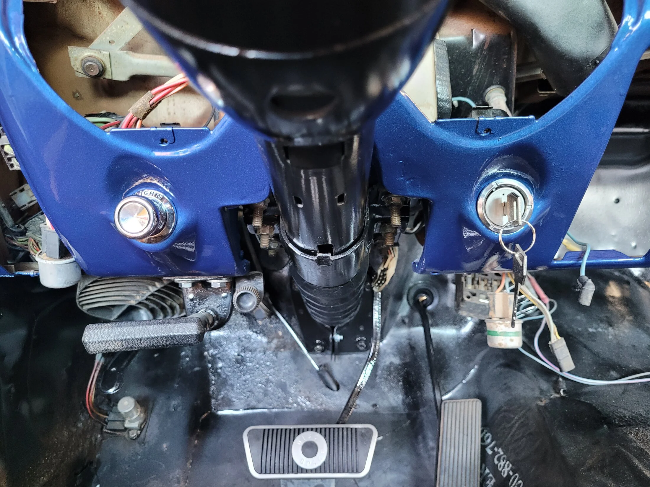

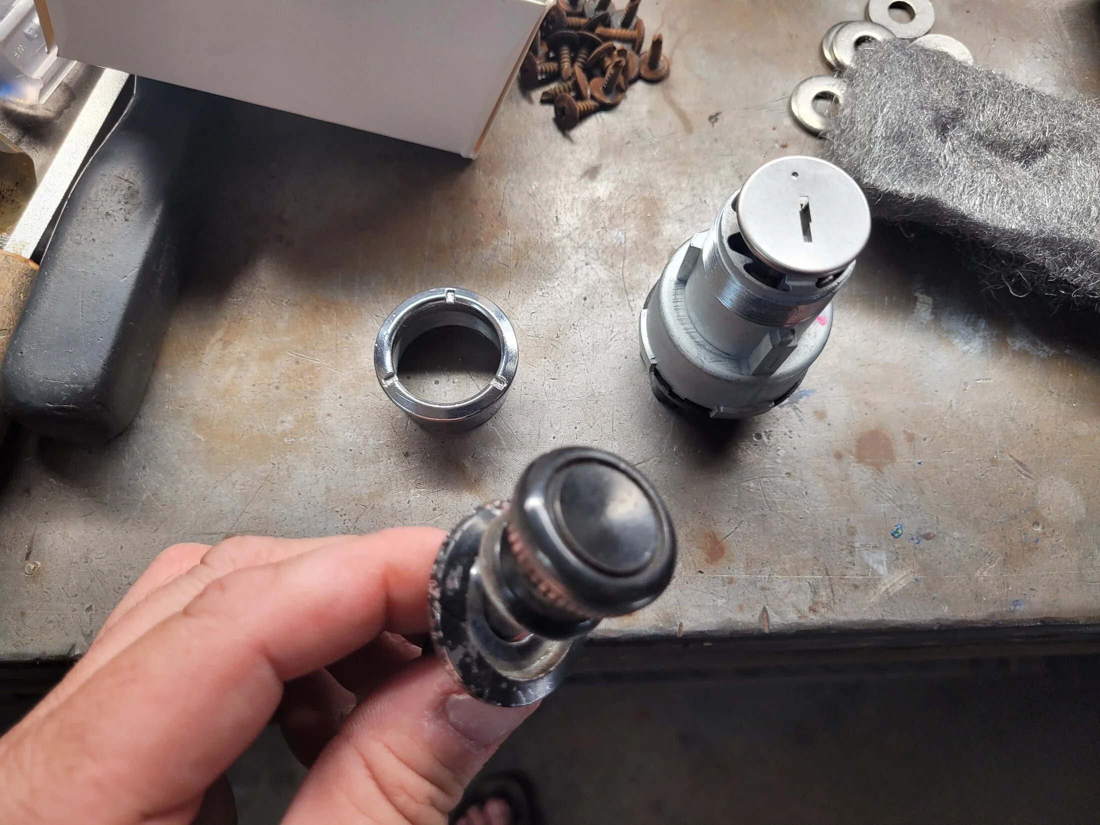

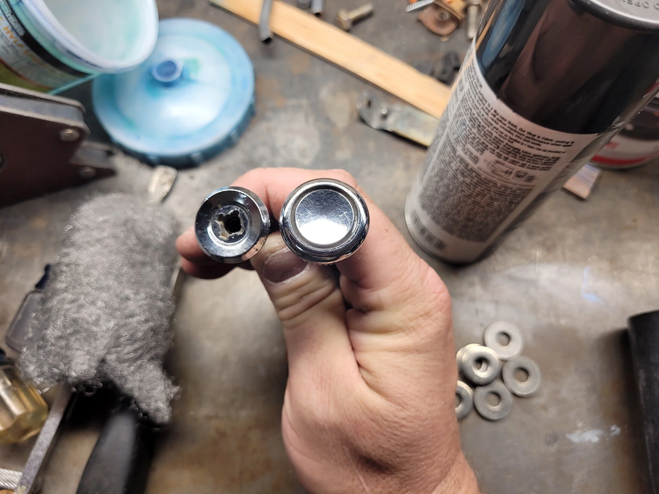

Like all my builds.....I jump around and work on many things at once. So, I worked on cleaning up the chrome bits that go with the new ignition, headlight, and turn signal switch. They were painted black.....now shiny chrome.

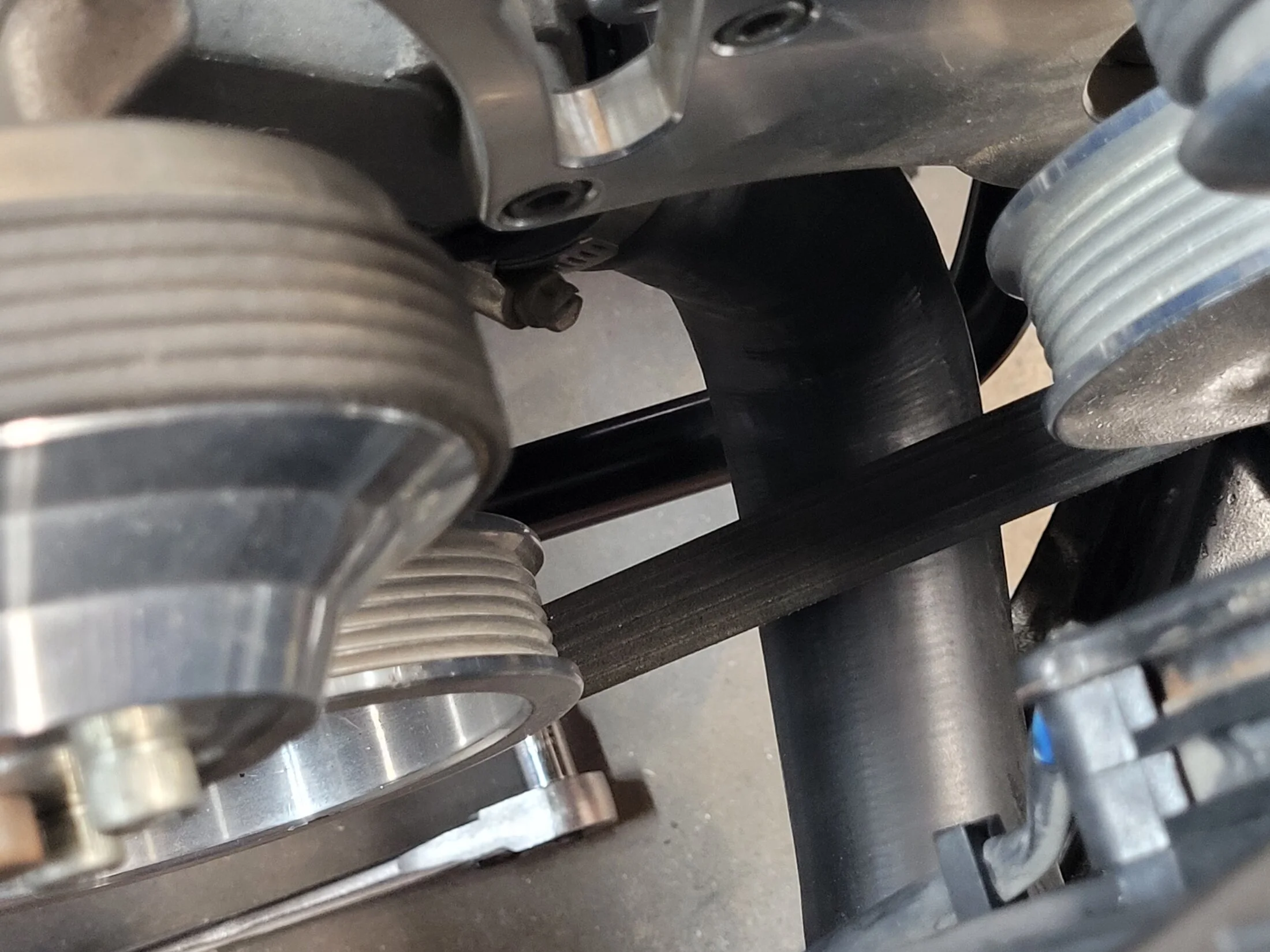

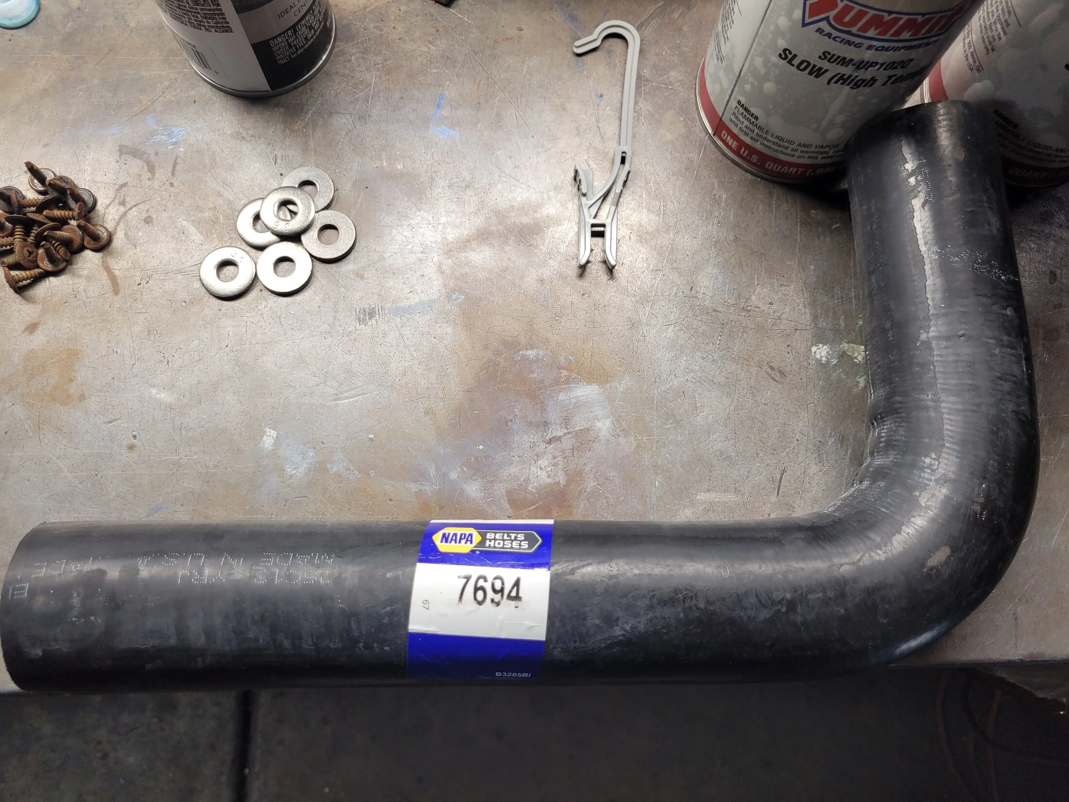

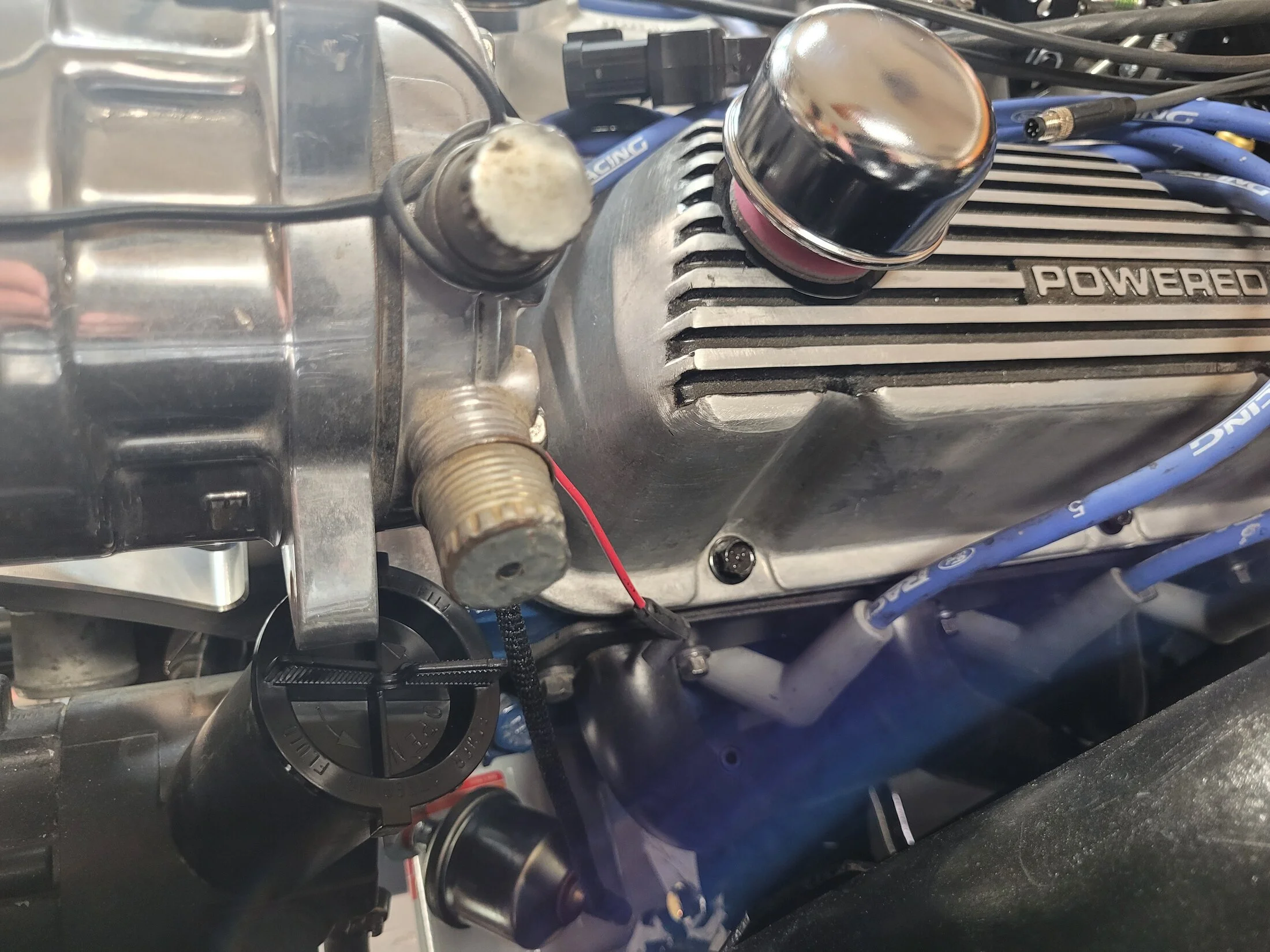

Also picked up a suitable lower radiator hose.
