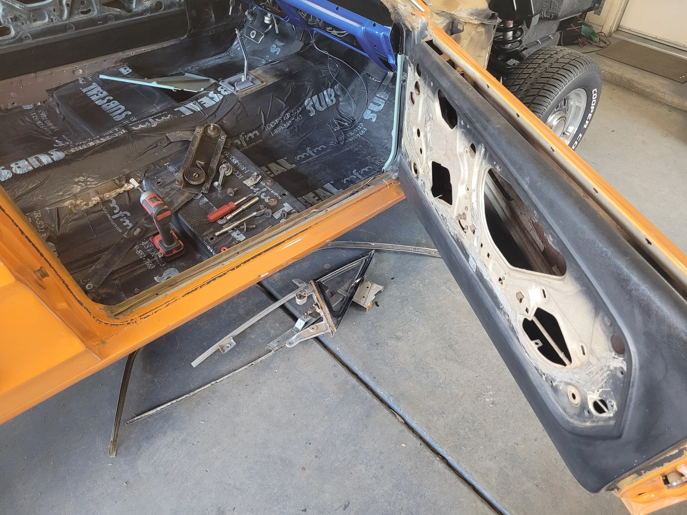

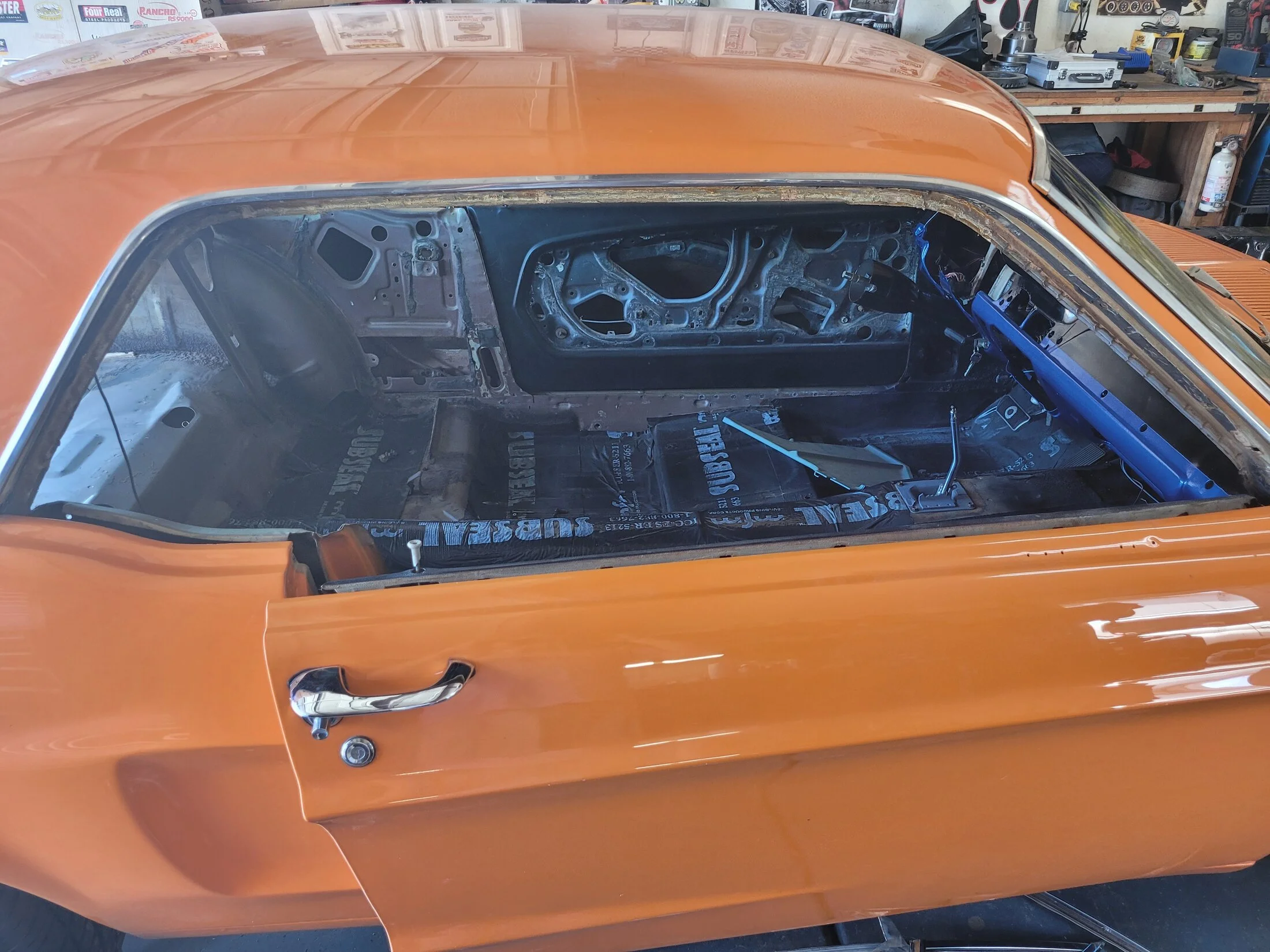

Got the passenger side windows and mechanisms removed. What a pain in the ass.

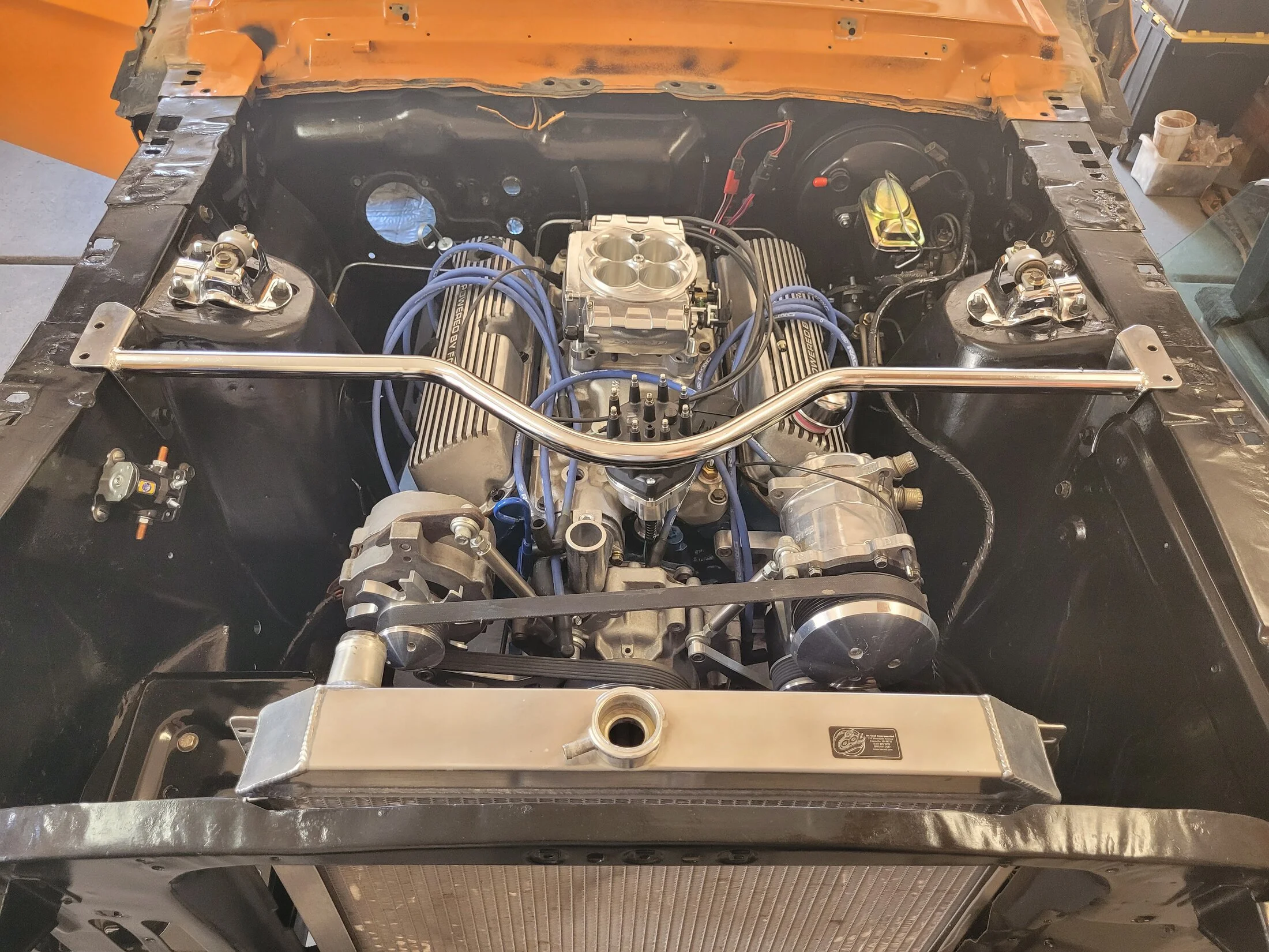

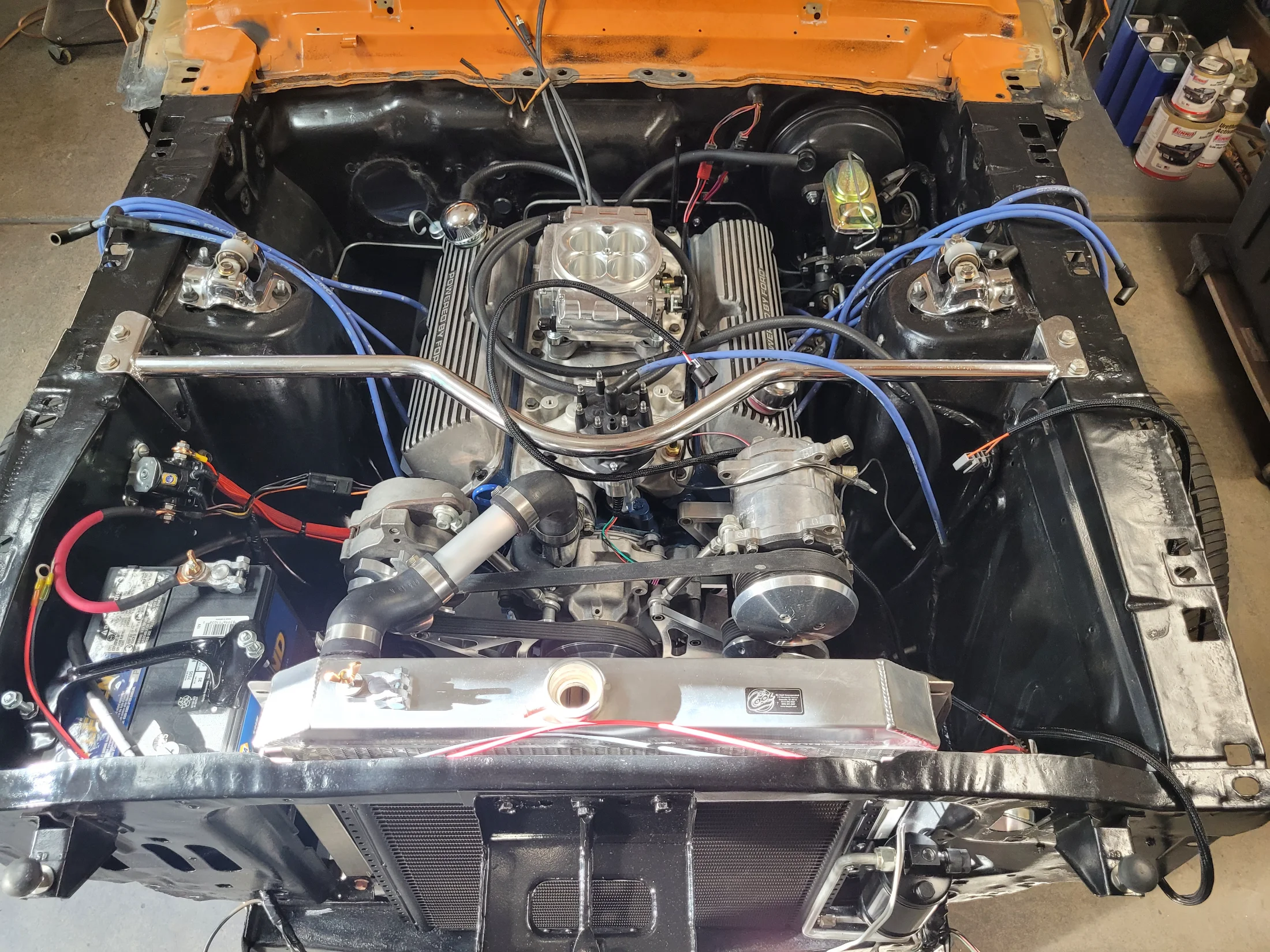

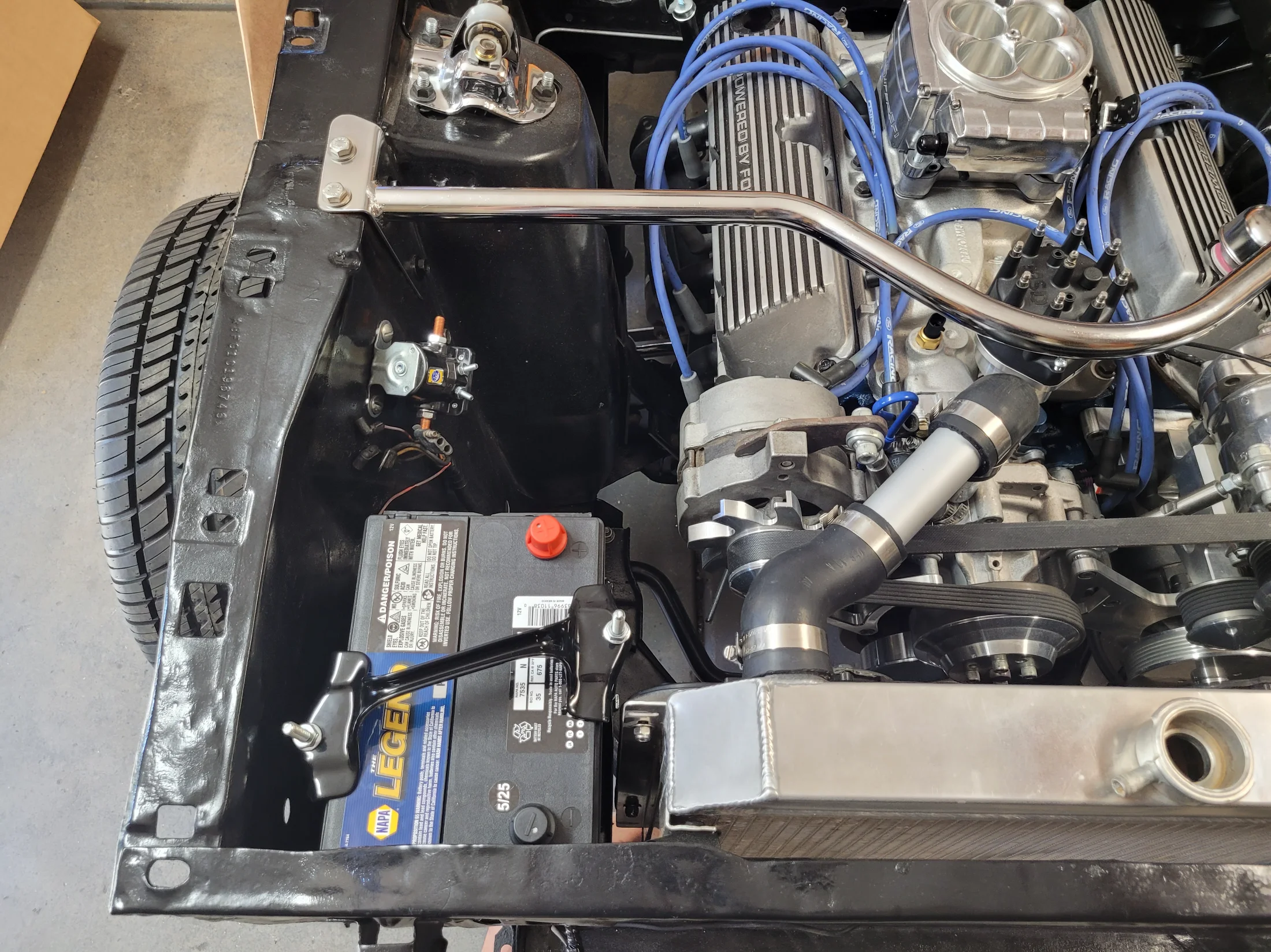

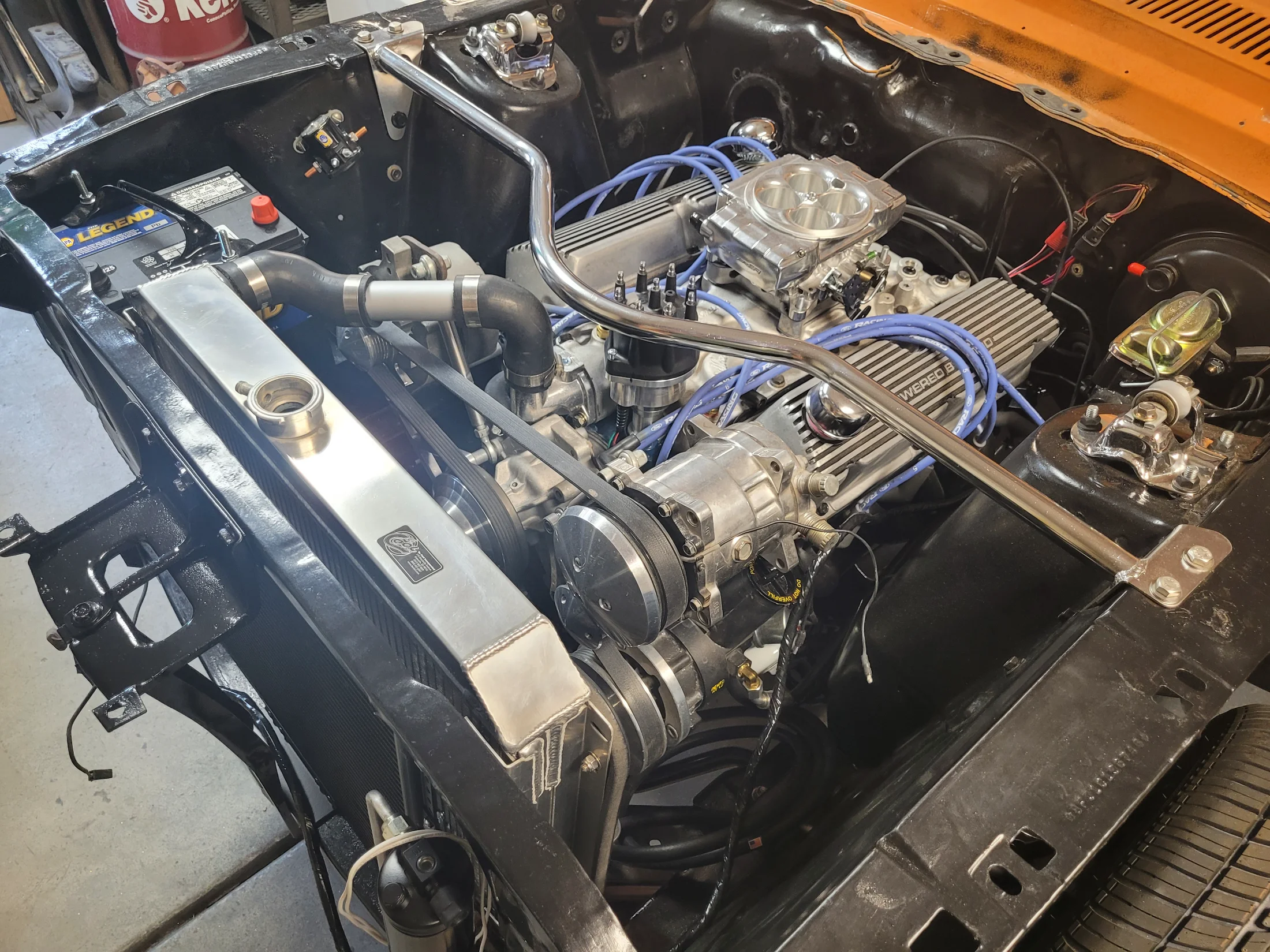

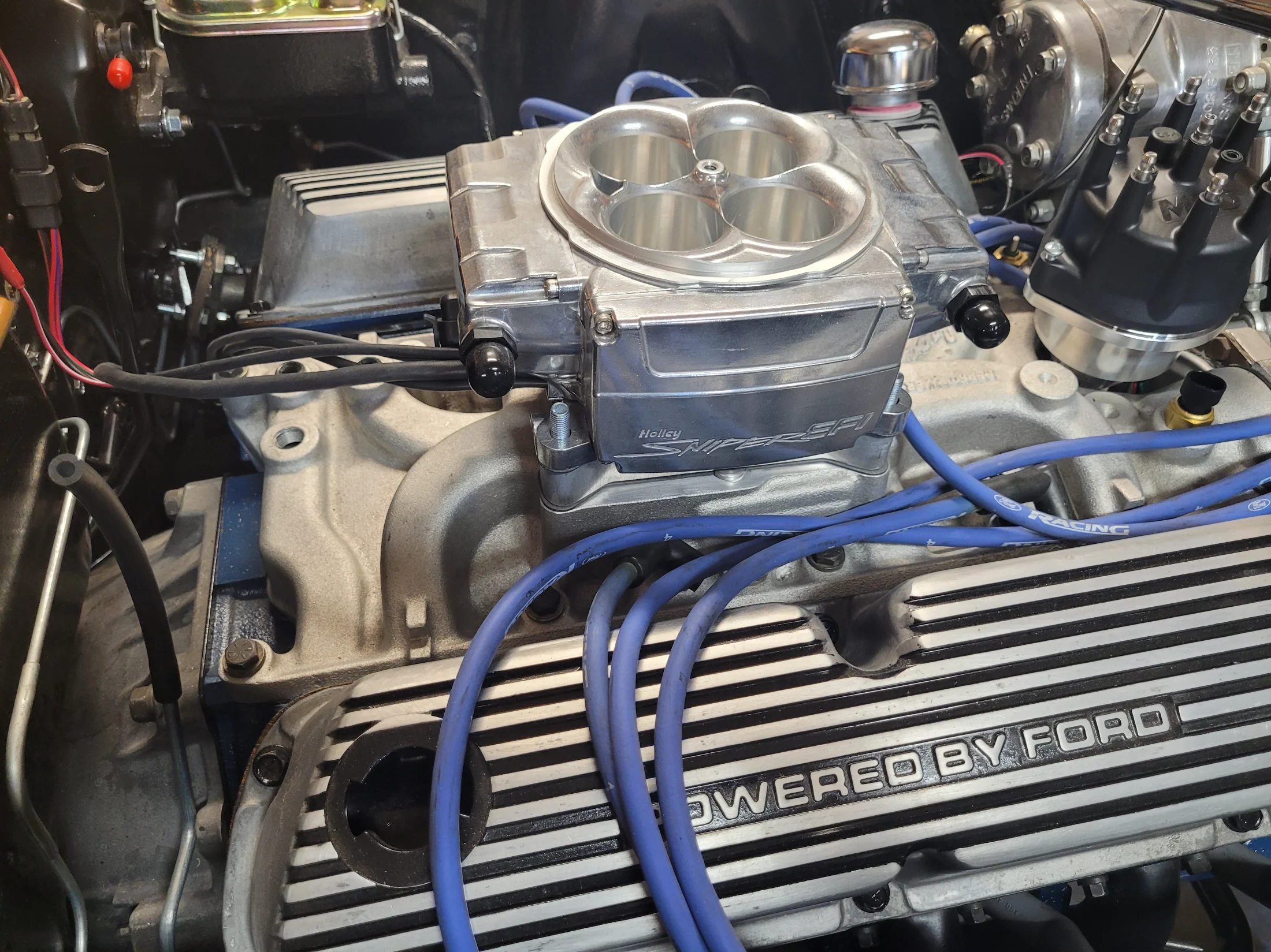

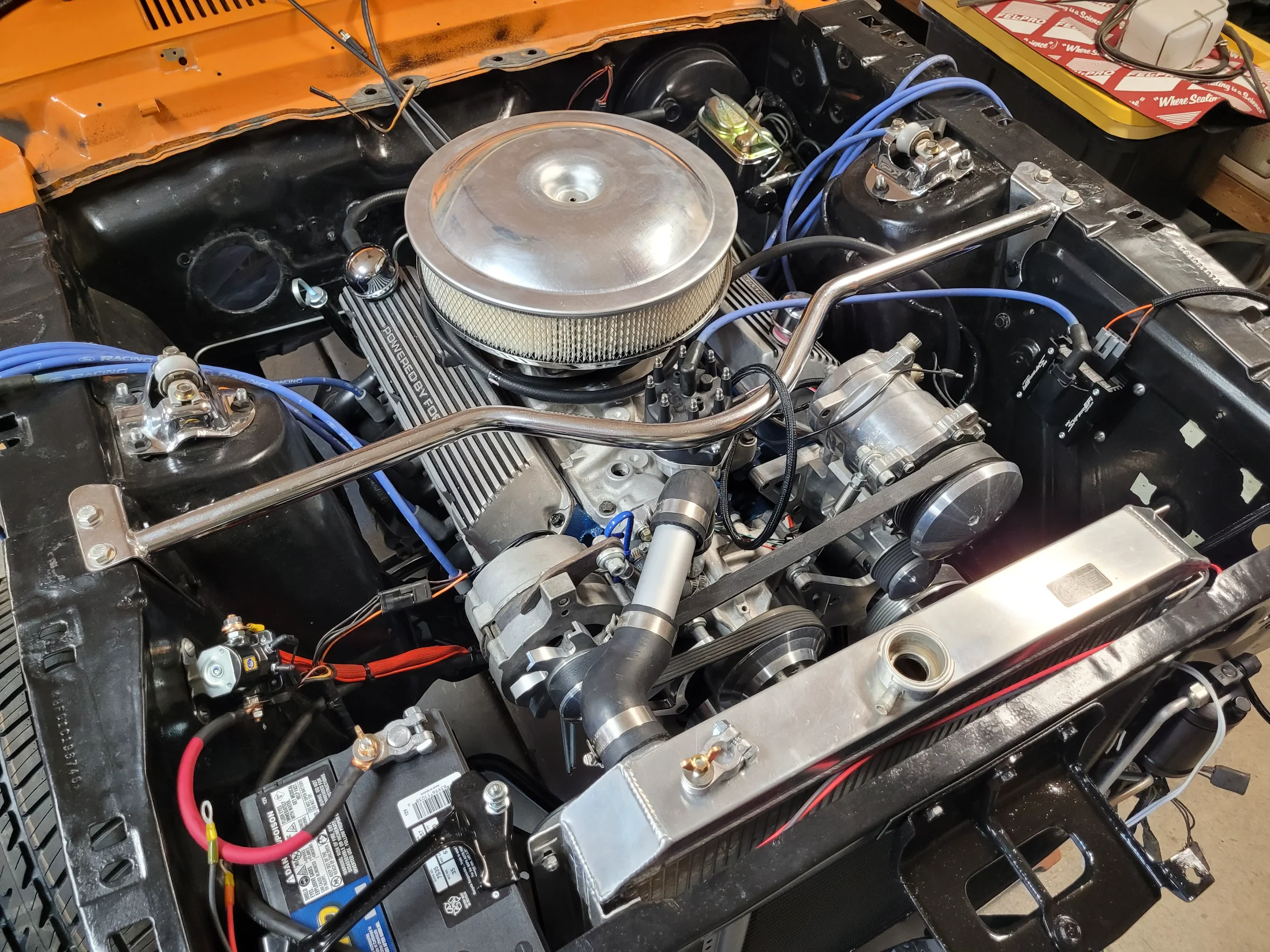

Added the shock tower brace.....mostly so I can mount up the rest of the Sniper and ignition boxes and make sure it all fits.

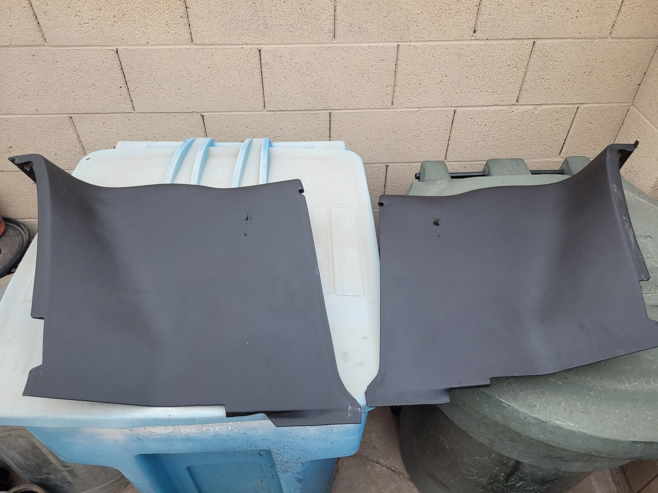

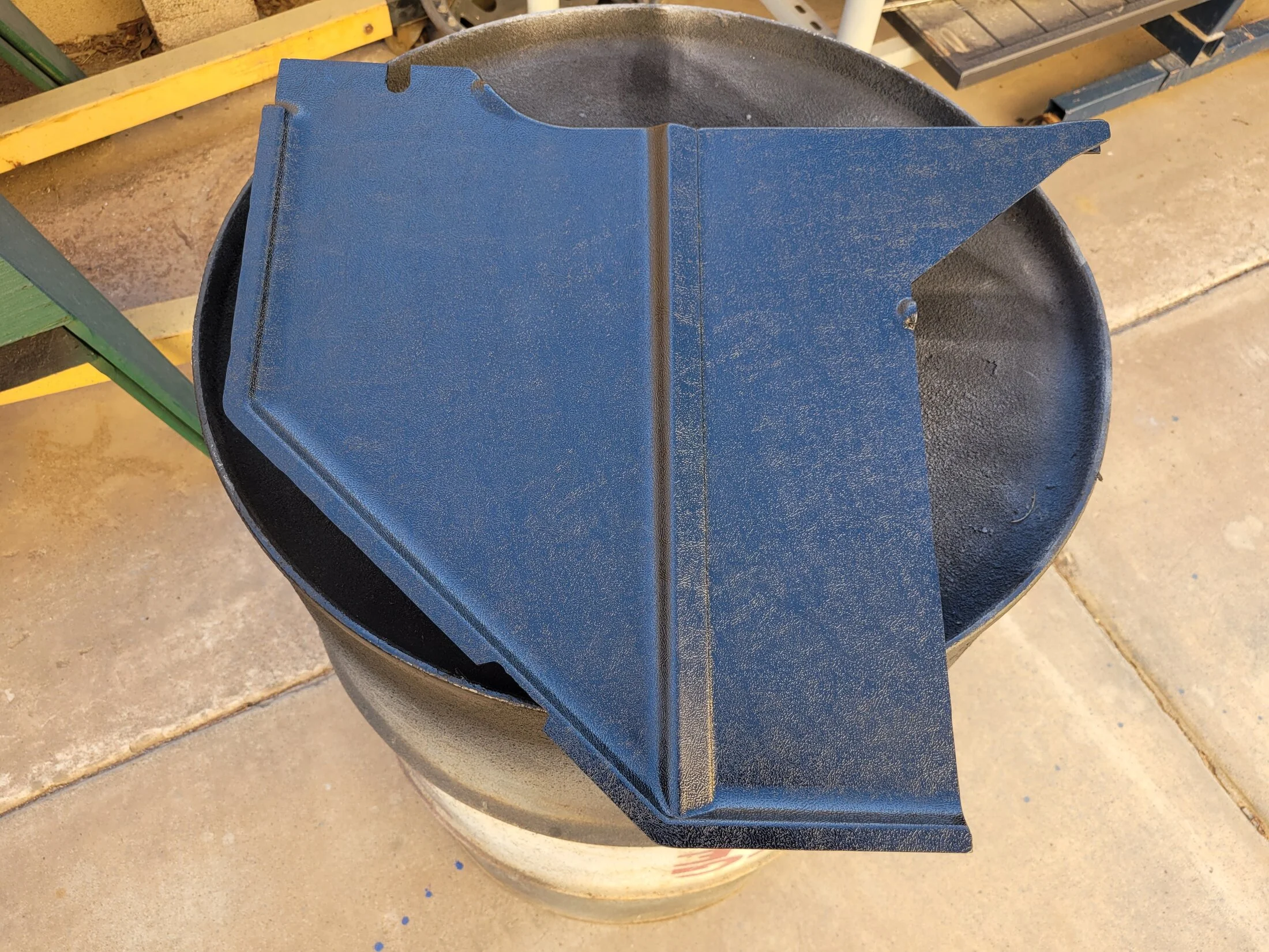

Inventoried the interior pieces. The original kick panels were falling apart. Luckily had some new ones in the stash. They were blue, so I used the vinyl interior dye paint stuff and made them black. They turned out pretty good.

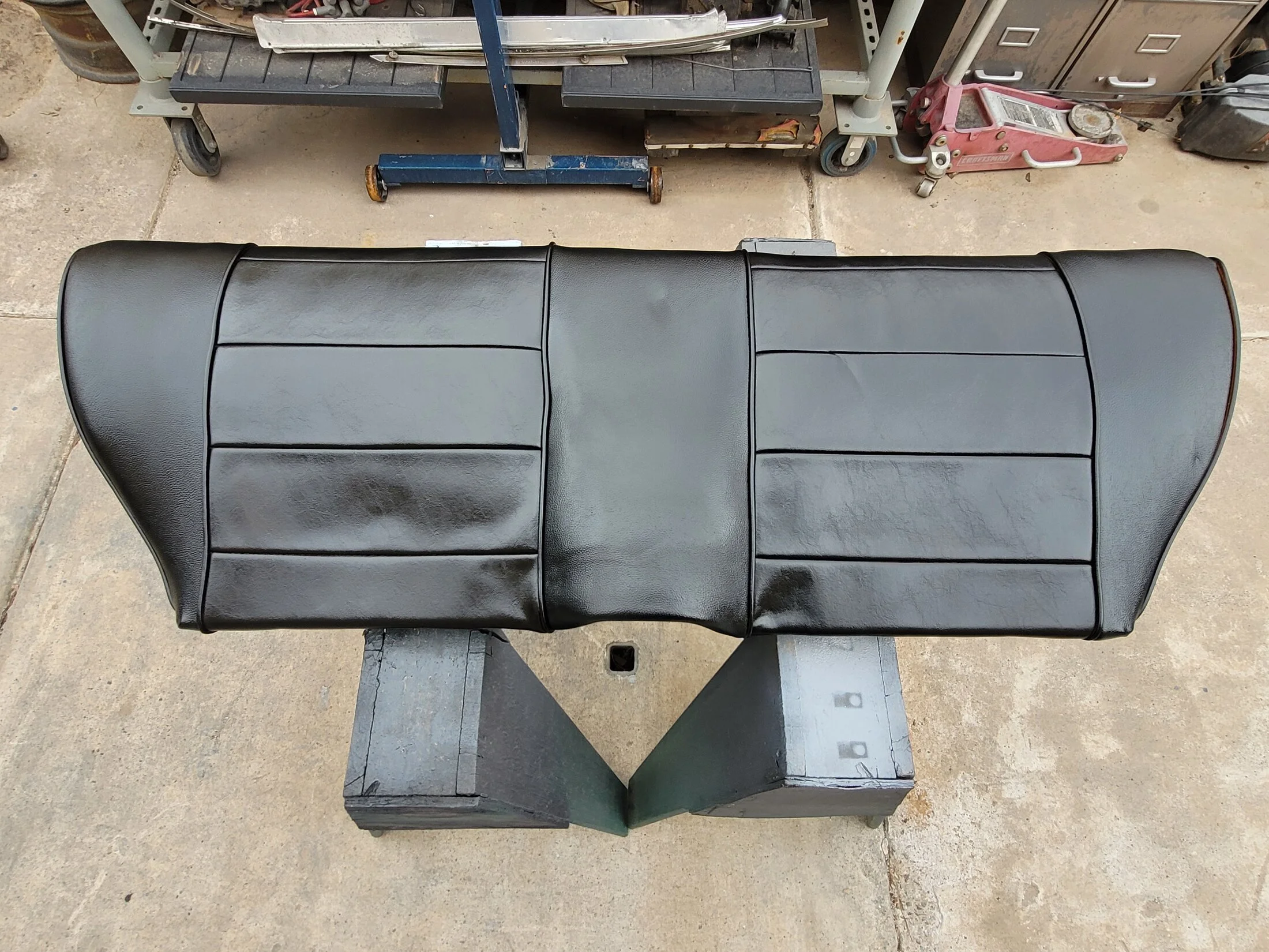

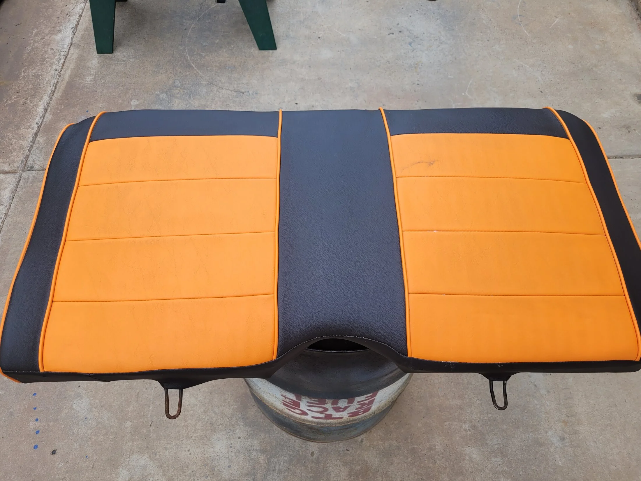

Today was overcast and not too hot. I cleaned, prepared, and vinyl died the back seat. It turned out pretty good and is way better than the orange.

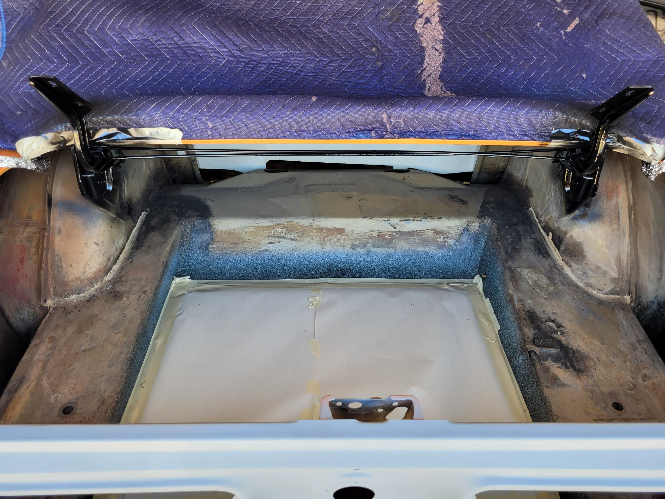

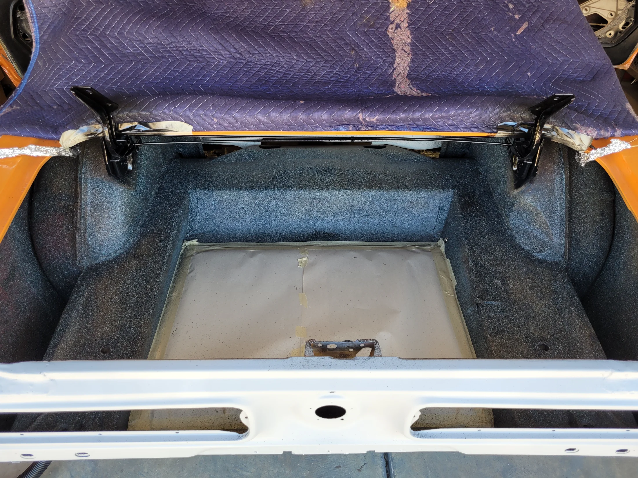

Found more paint locally and gave it a few more coats. I think it turned out pretty good. I like the contrast with the gray fuel tank and black hinges. The trunk lid and trunk jam will all be blue.

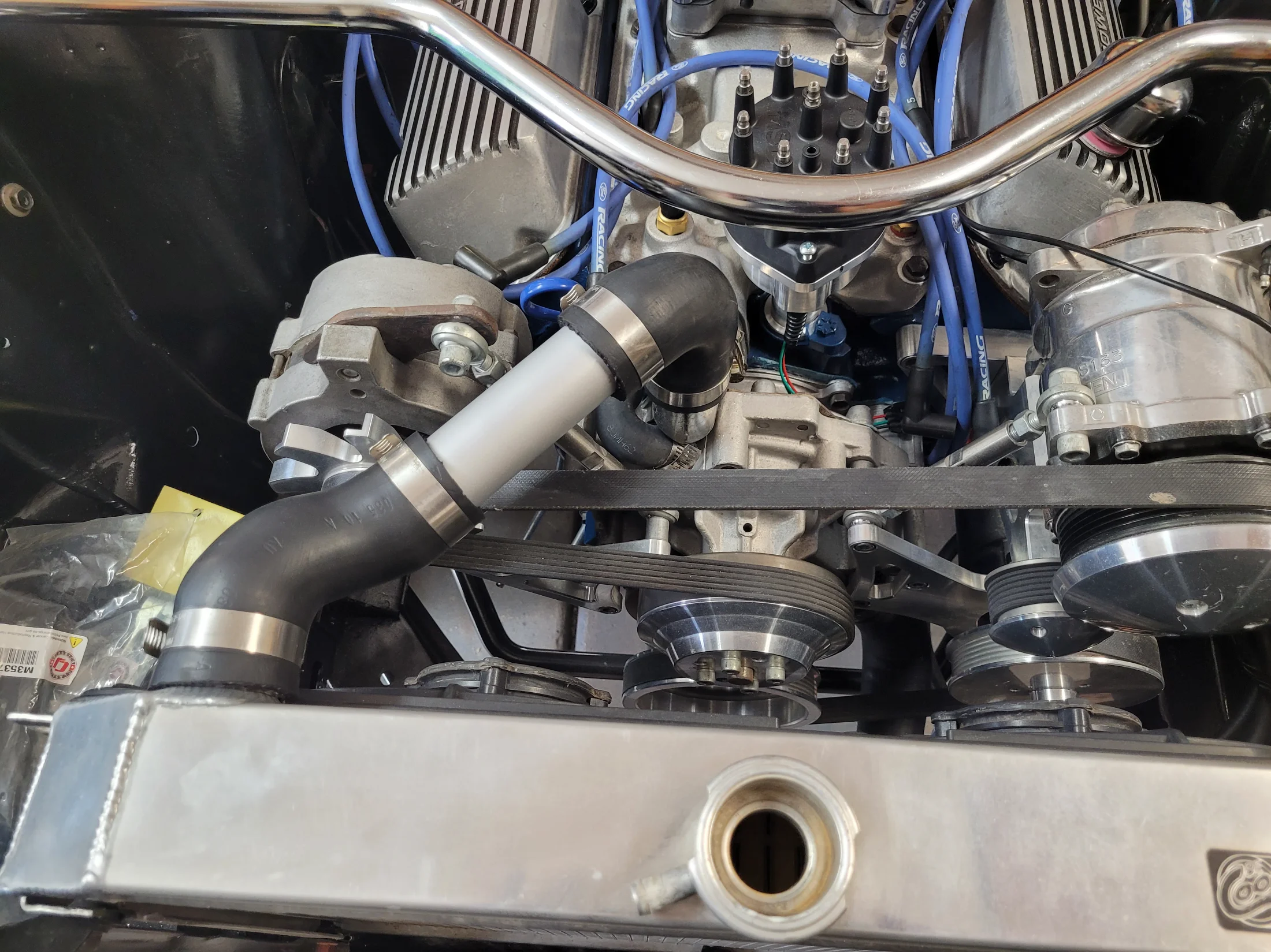

Only picture worthy item is my solution for the upper radiator hose. I welded a bead at the ends of the tube to help the hose clamps.

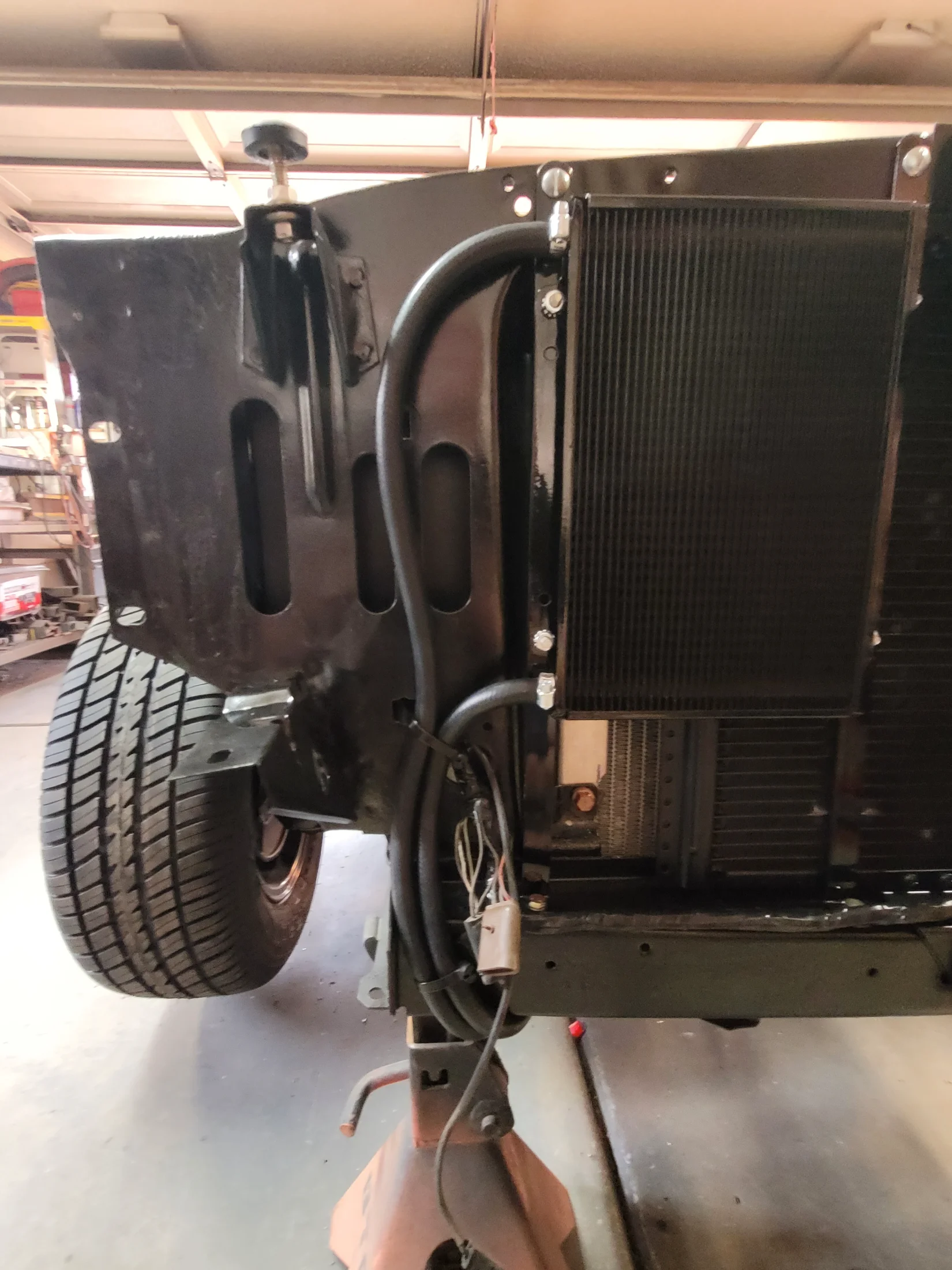

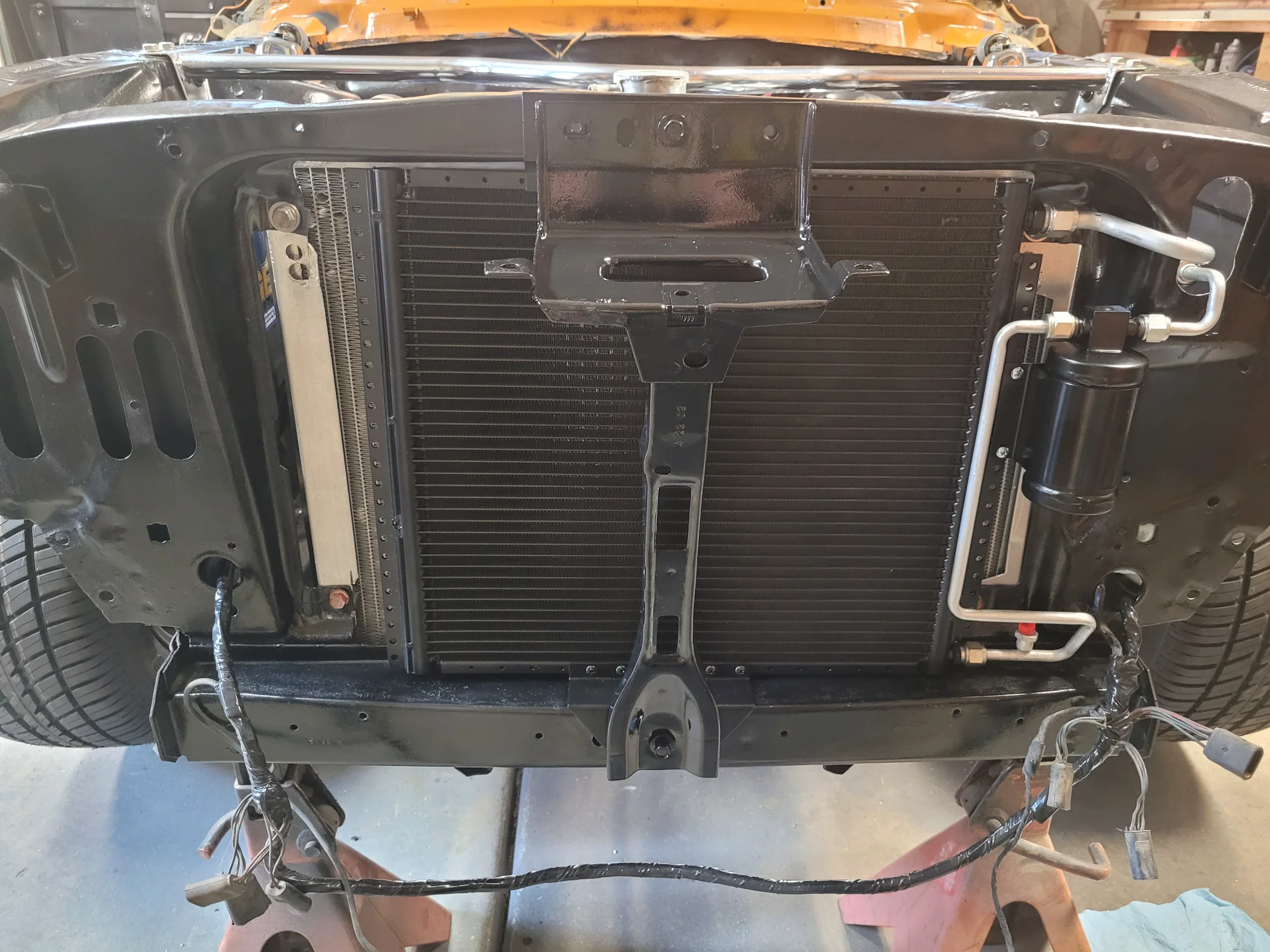

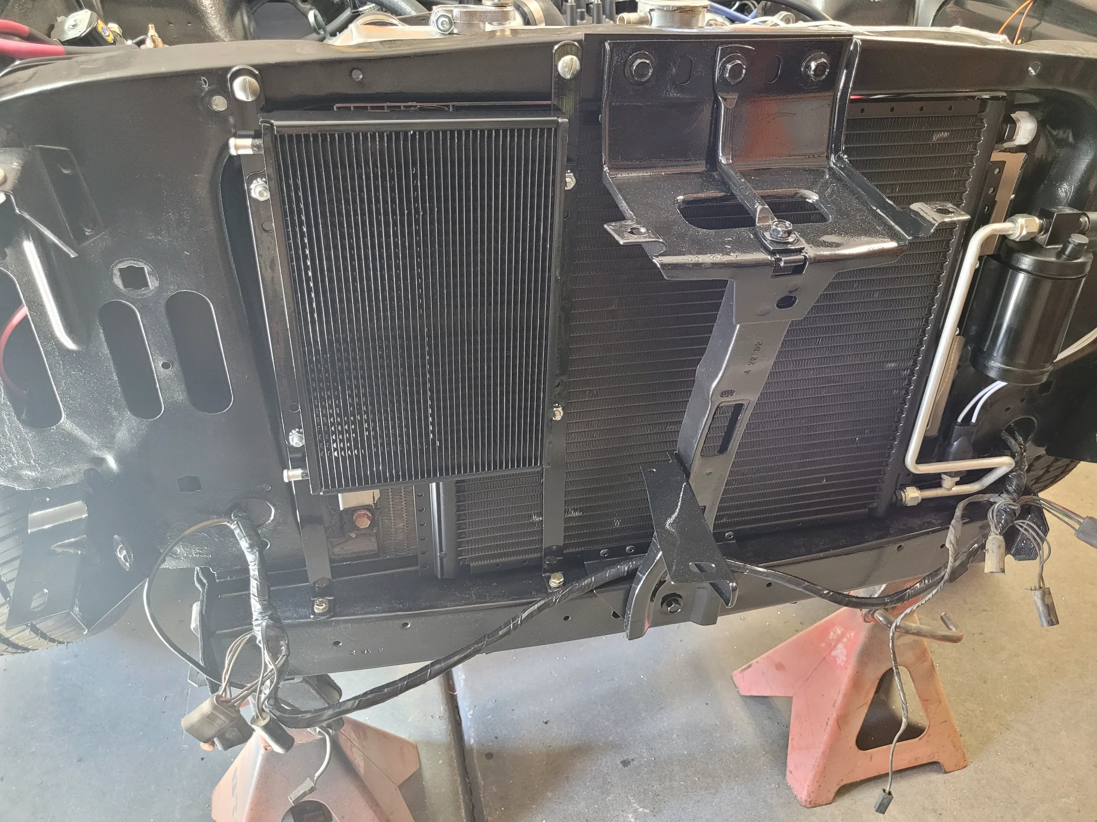

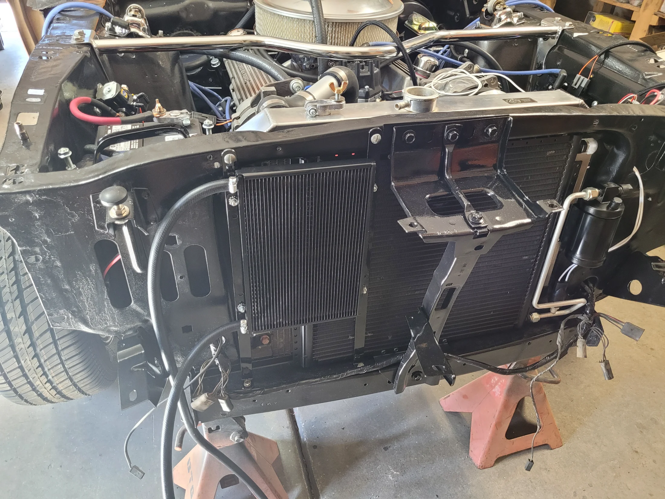

Working on the air conditioning system. Got the condenser, dryer, and some lines mocked up. There's a factory indentation in the core support that needed to be opened. Fits good so far.

Got the condenser mounted for good with pressure switch and harness. Mounted a new voltage regulator. Gonna focus on getting all the engine bay stuff mounted. Then hose and wiring routing.

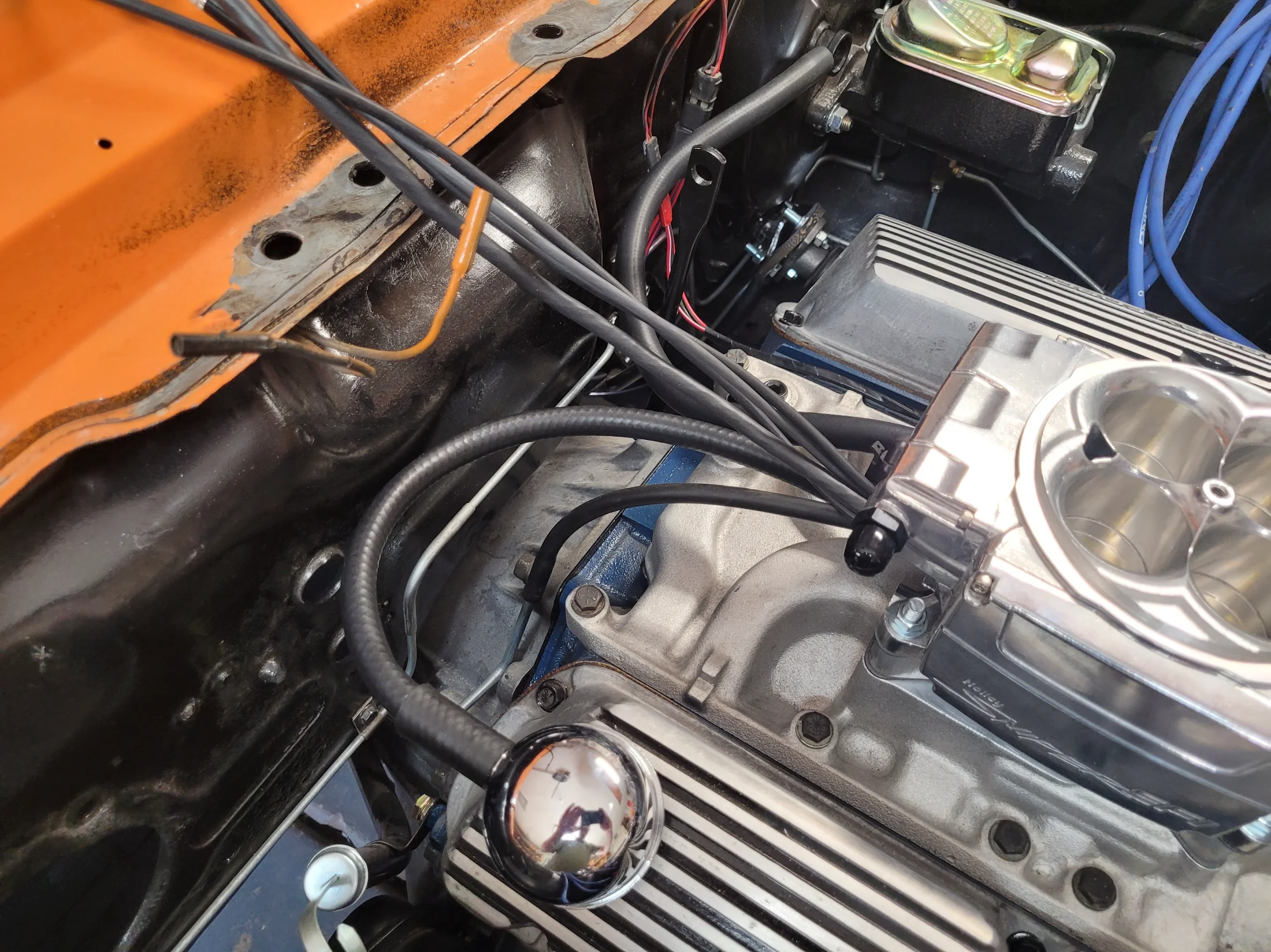

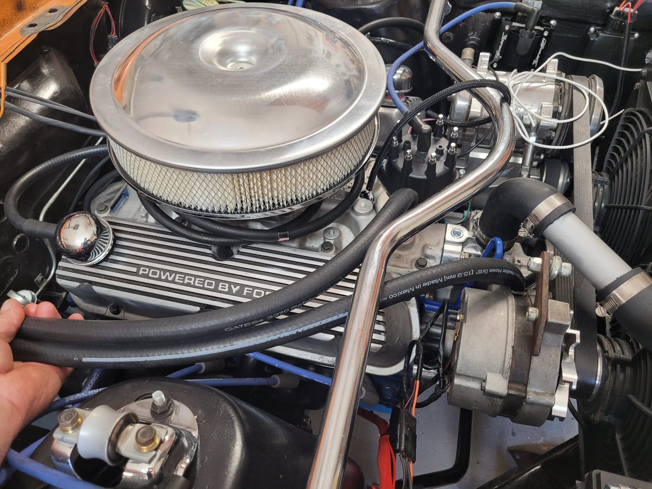

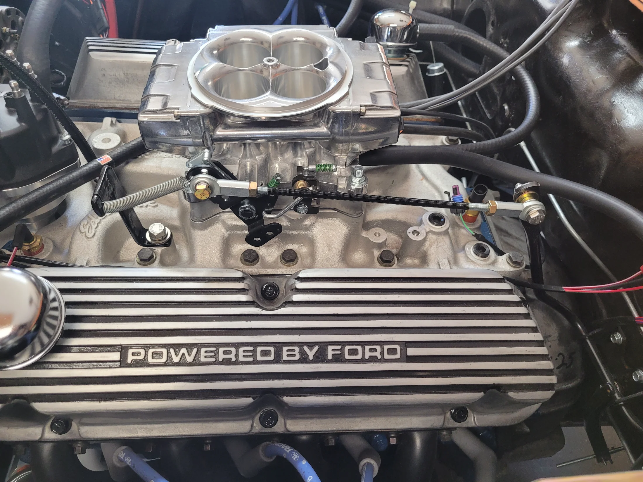

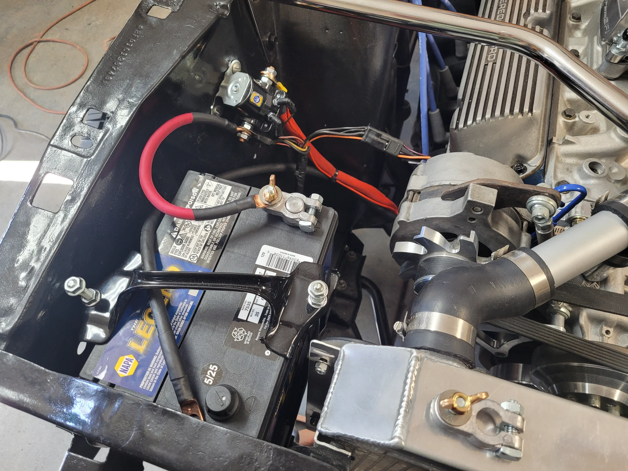

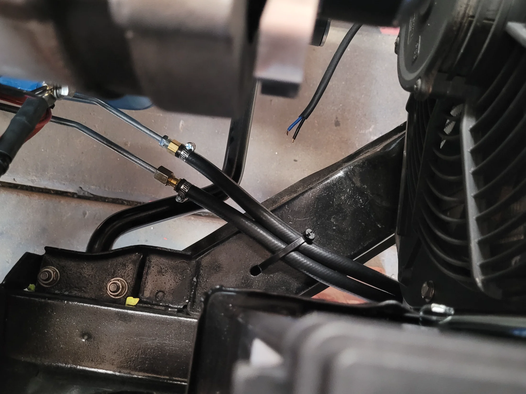

Working on loose ends. Starter is now bolted in and wired. Main engine ground is done. Got the pcv and brake booster hoses attached. Transmission module too. Working on wiring mock up to figure out where to mount the ignition box and coil (Sniper stuff). Planning routes for AC hoses too.
