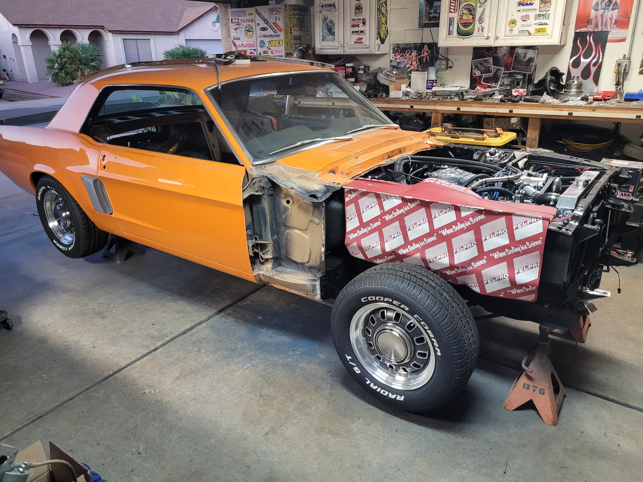

Ford The Brentstangs.....68 Mustang build
Mini update. I added all the juices except for brake fluid. So far, nothing is on the floor.....lol

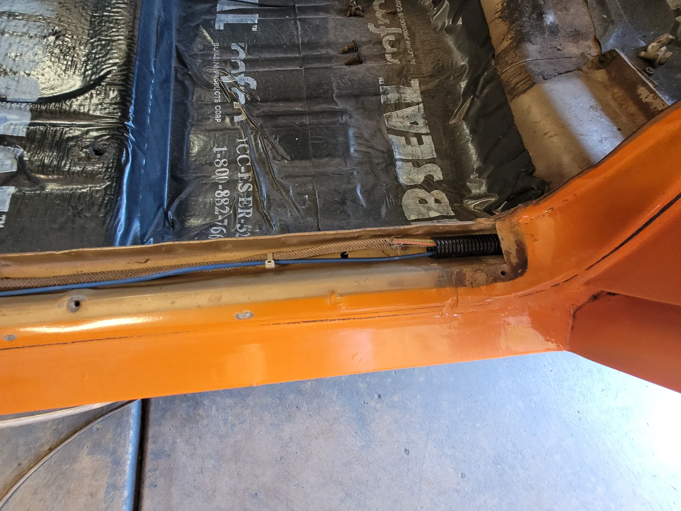

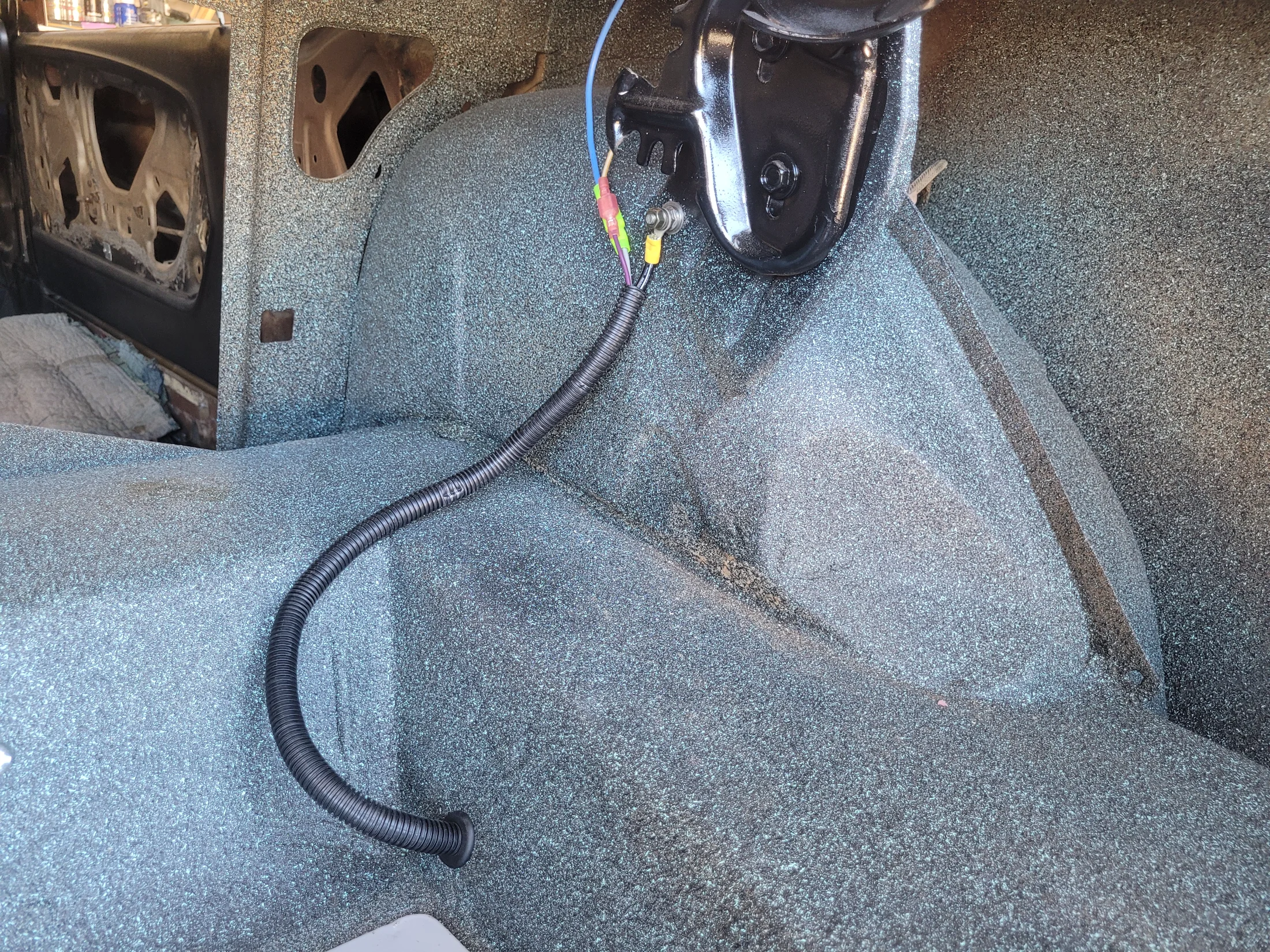

Unfortunately there's an oil leak at the rear of the motor. Being discouraged, I finished the fuel pump and sender wiring. I routed the wire with the rest of the factory wires. I terminated everything in the trunk.

I placed the front fenders on just to get started on fitting the Shelby nose parts.
