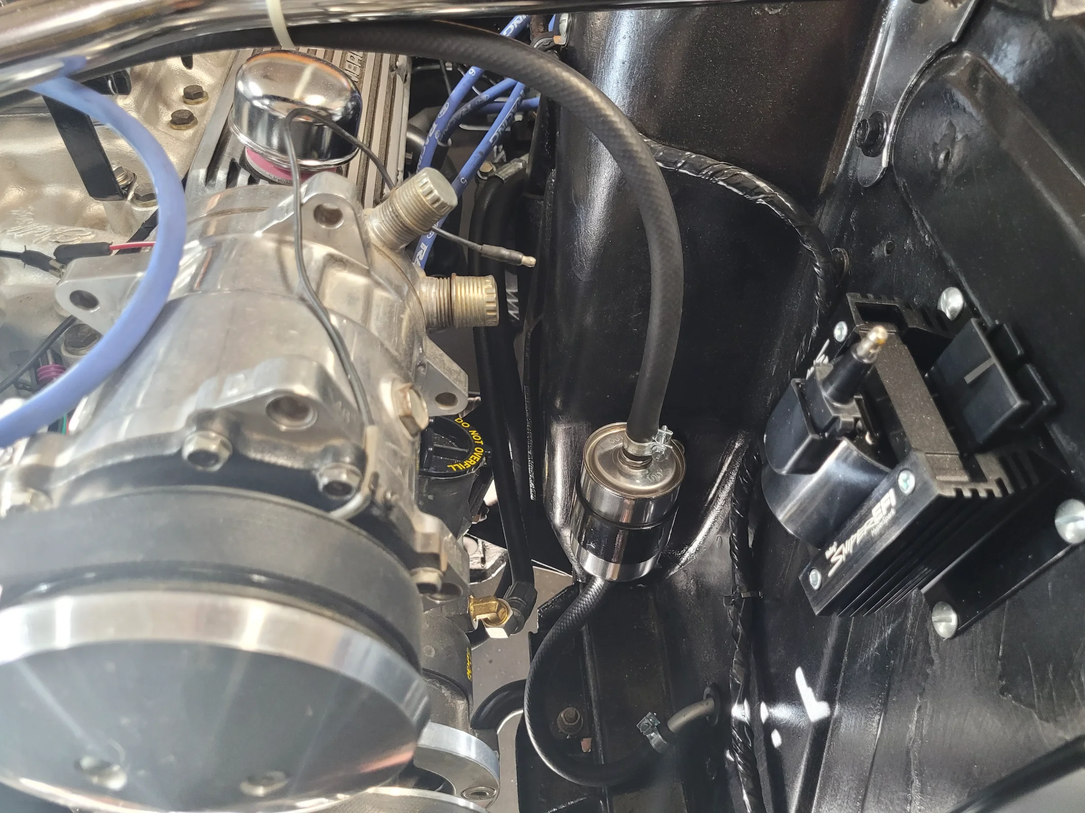

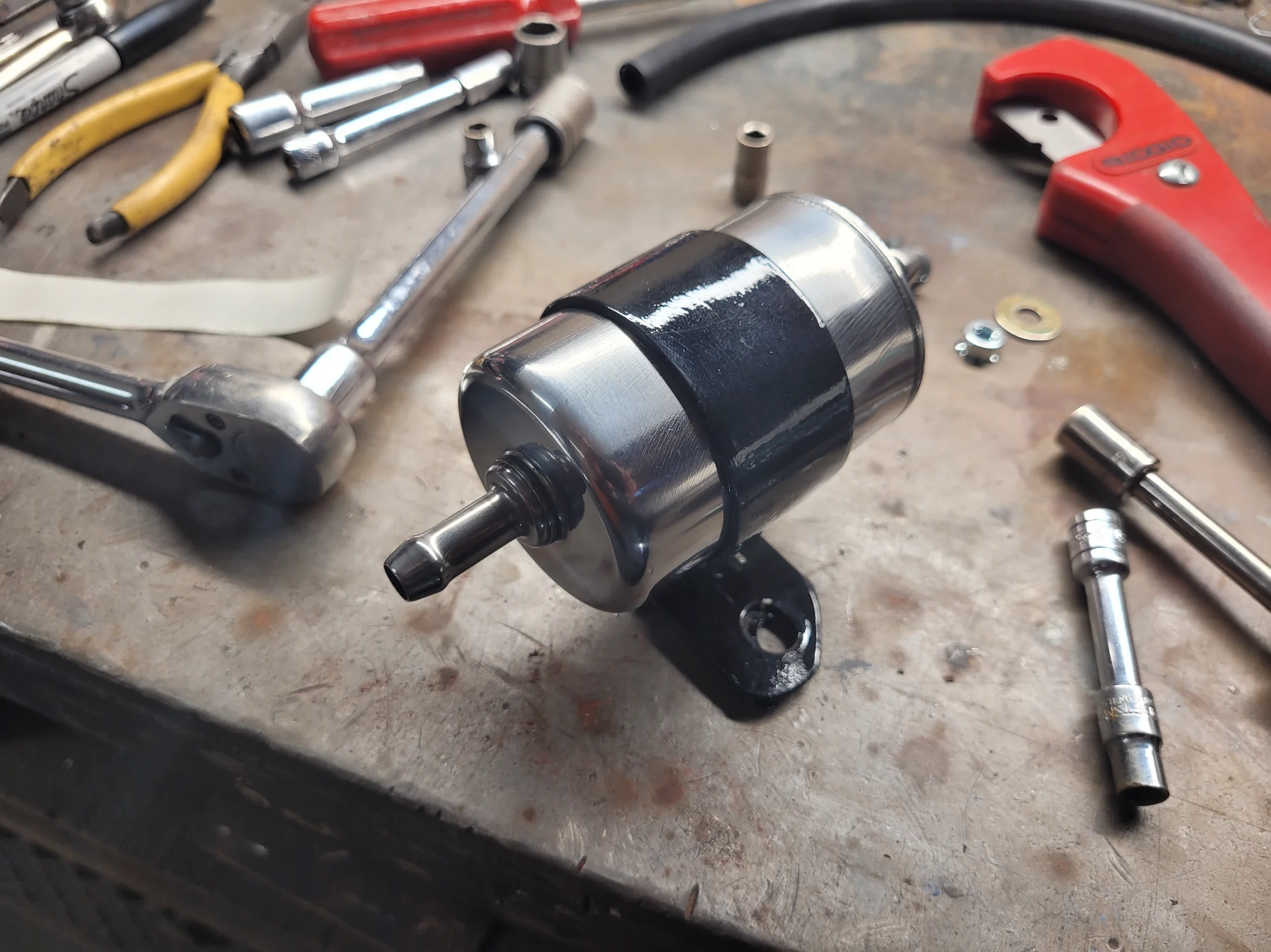

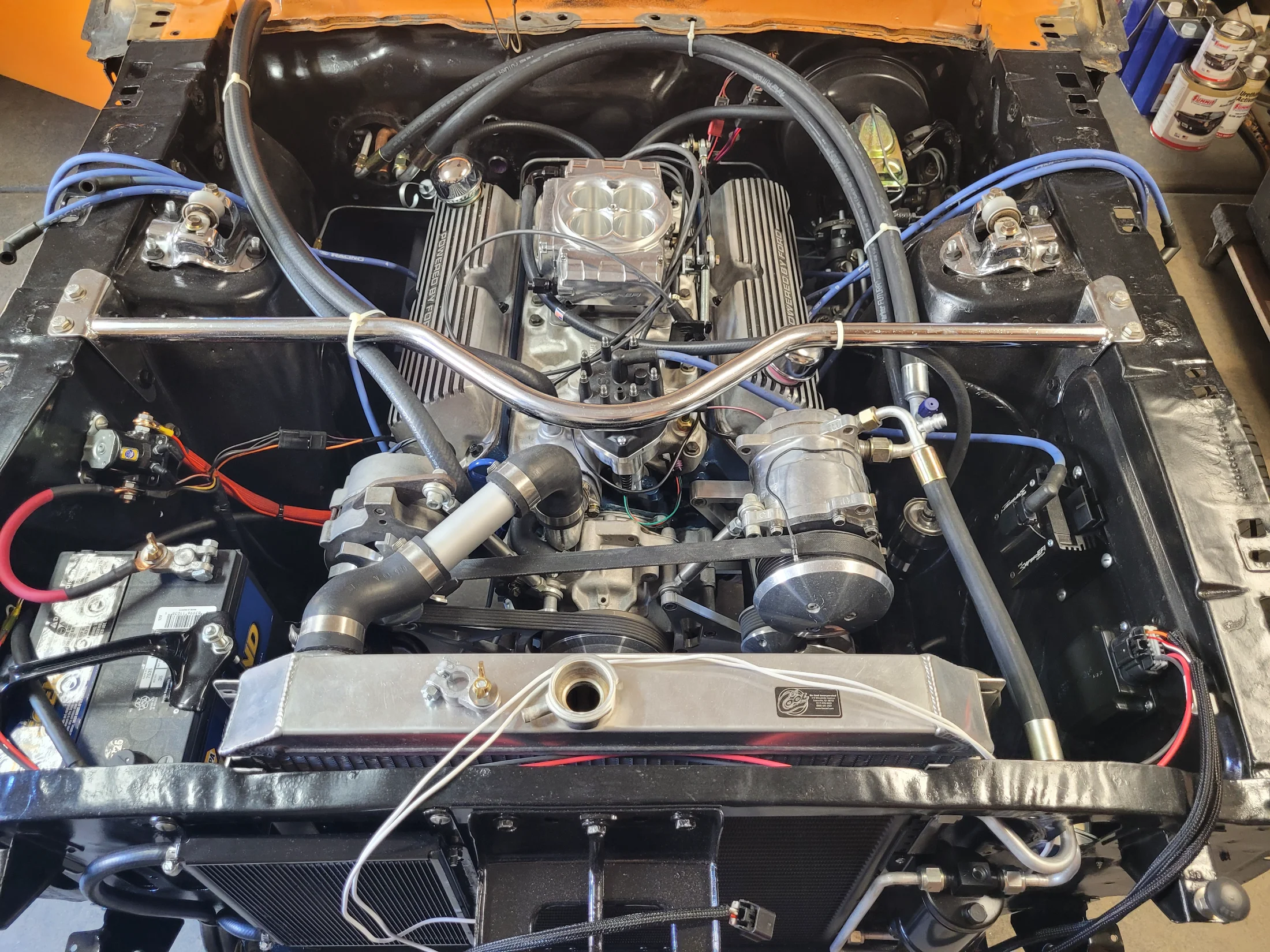

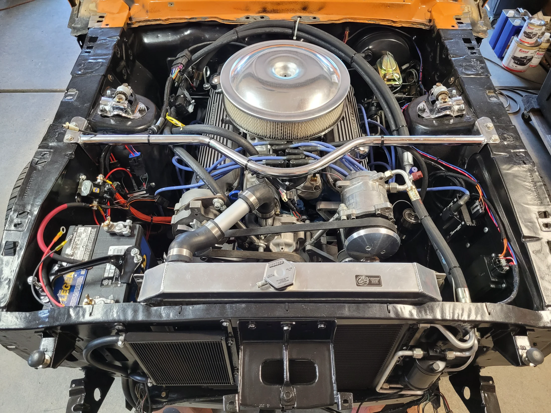

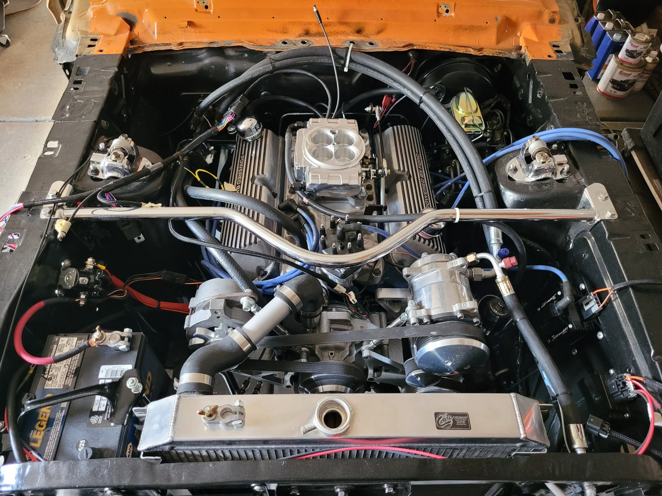

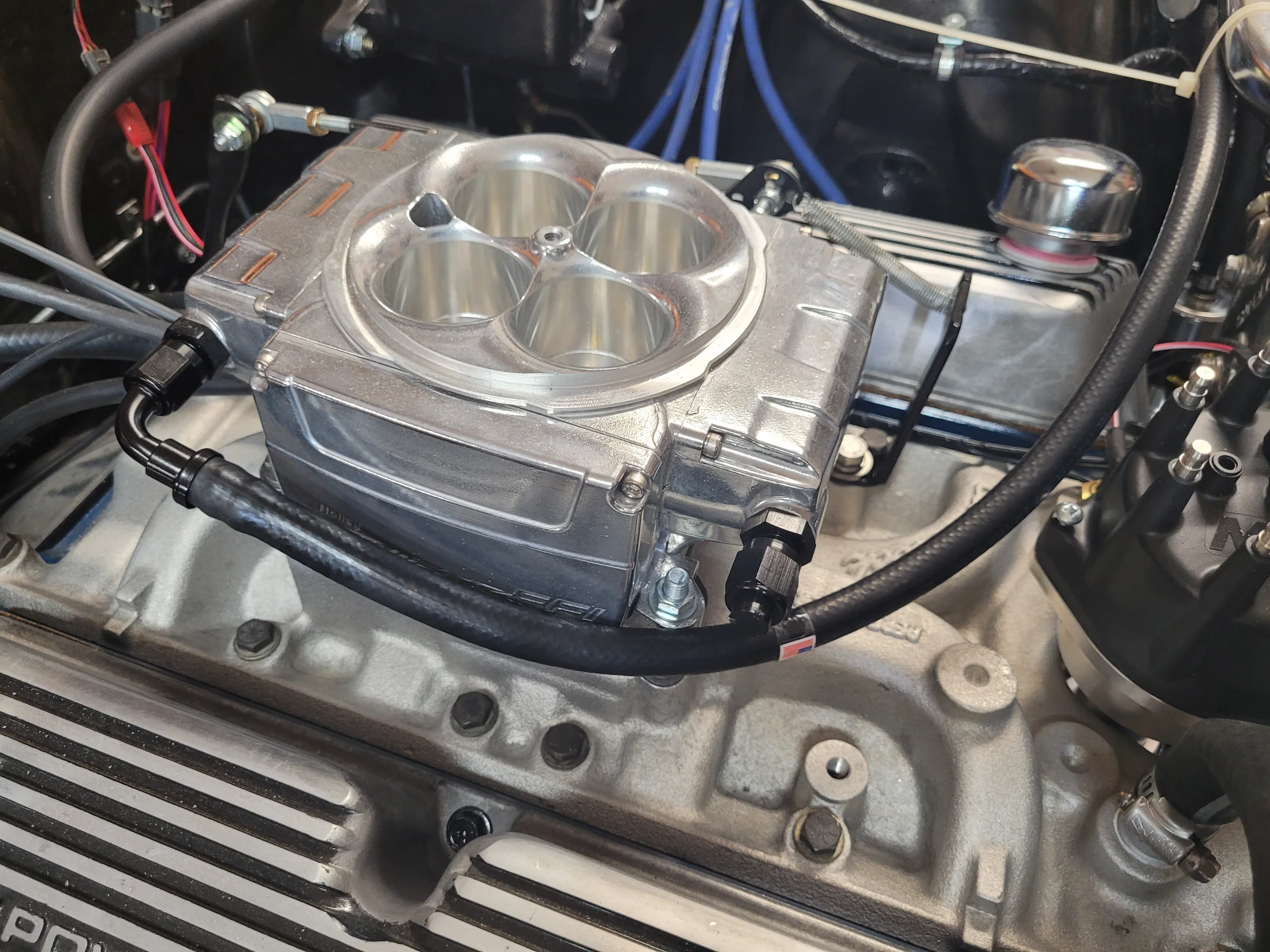

Fuel system plumbing is complete. I repurposed a coil mount into a fuel filter mount. Since I have the in tank fuel pump and regulator, it converts the setup into a dead head type. Capped one side of the Sniper and used a 90 on the inlet.
Once everything is routed under the hood, I'll use all black zip ties to tidy it up.

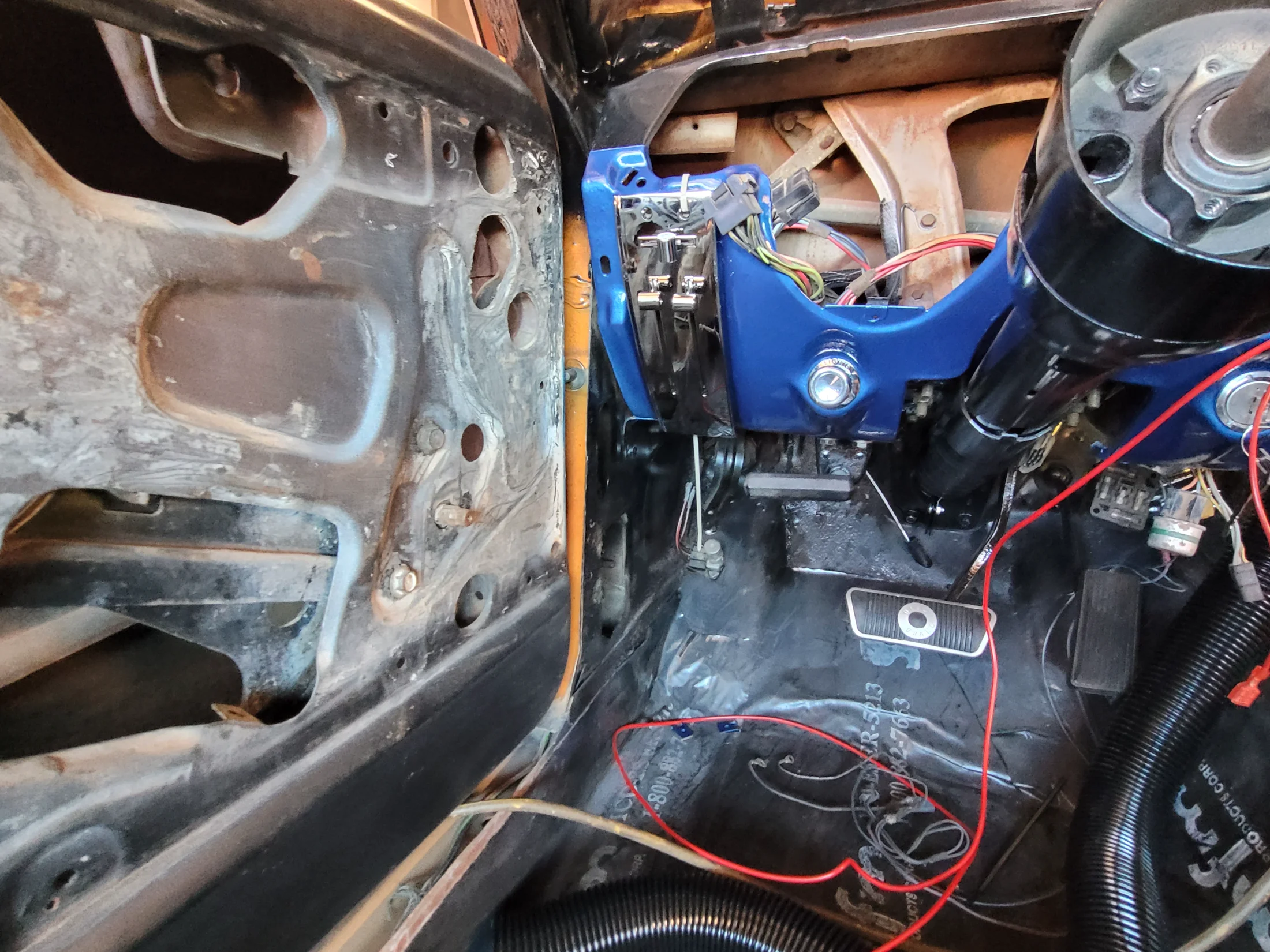

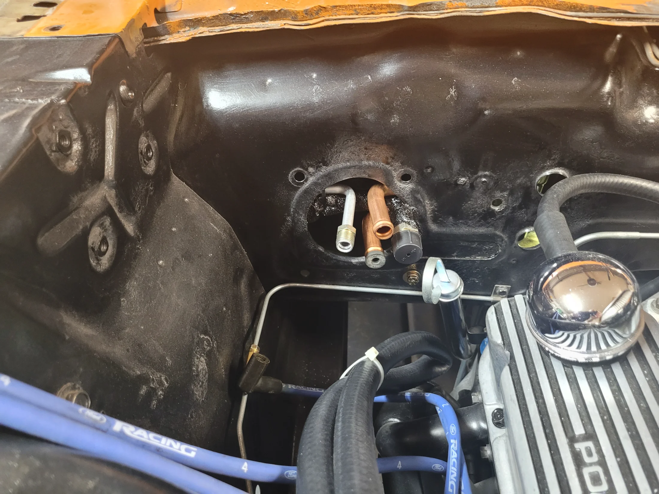

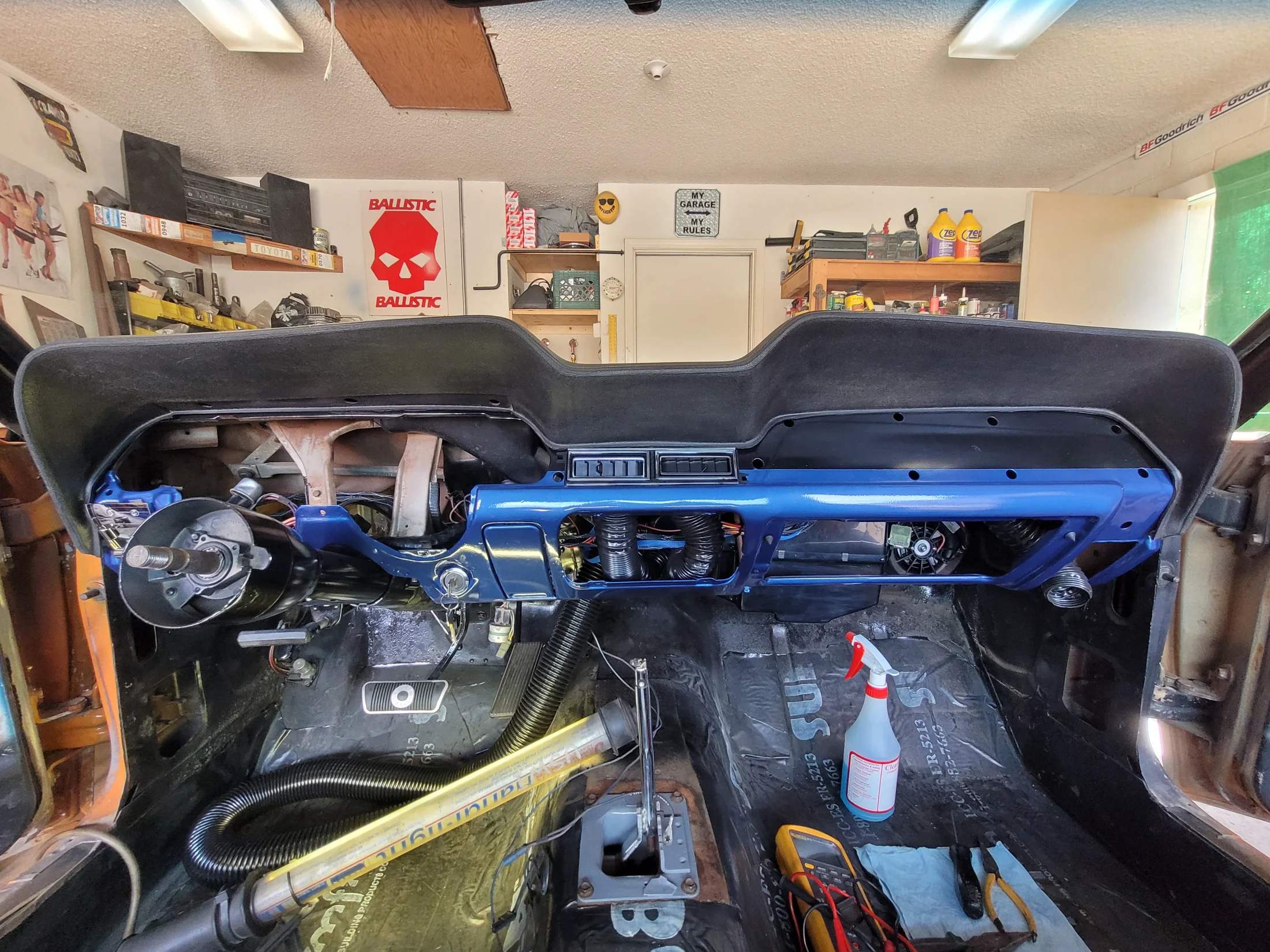

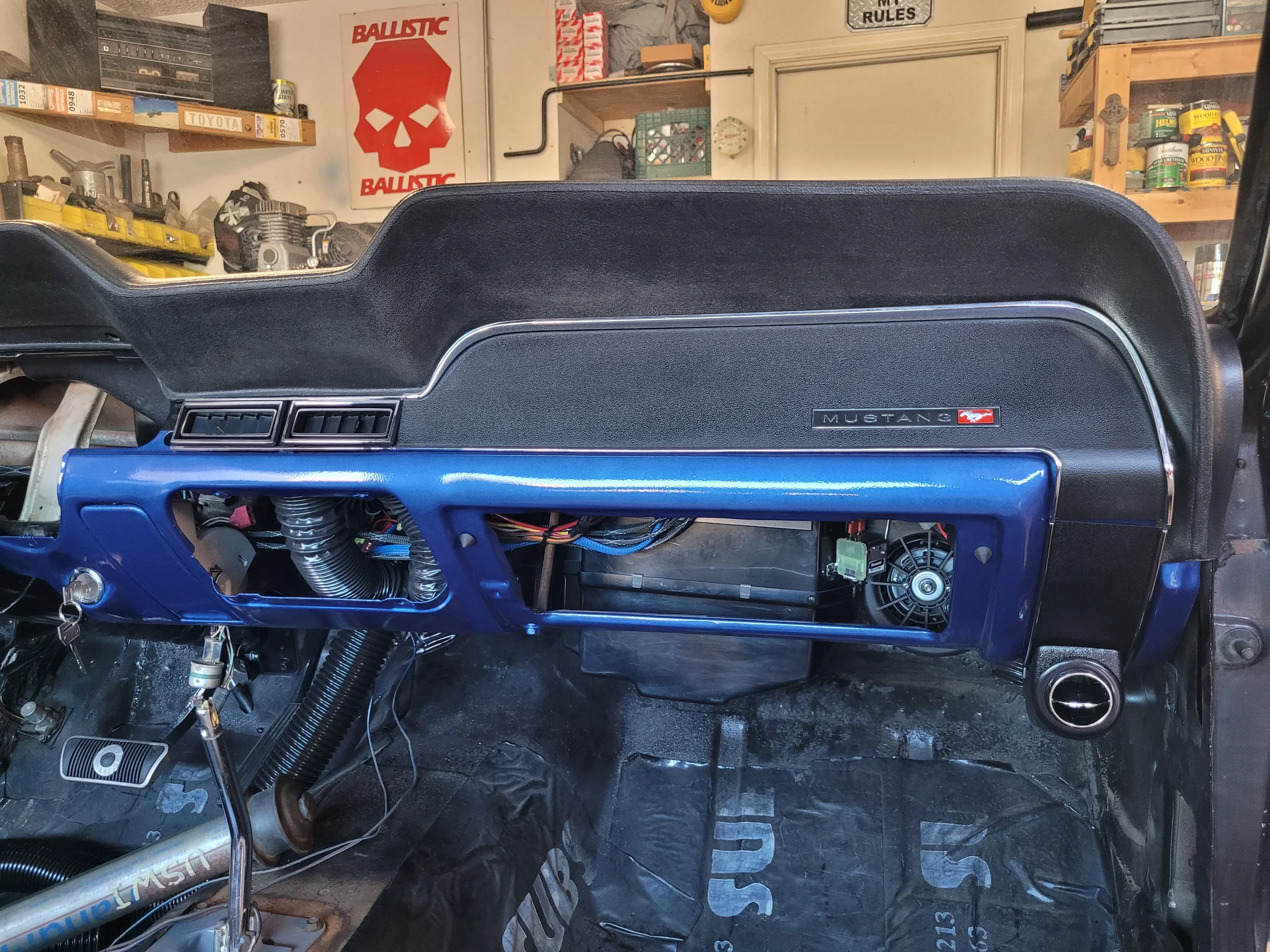

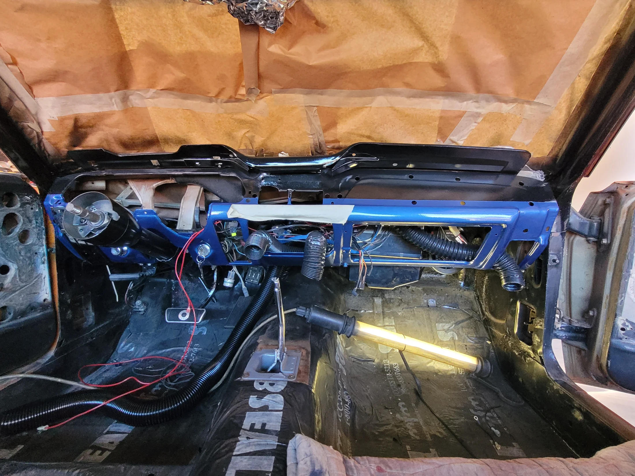

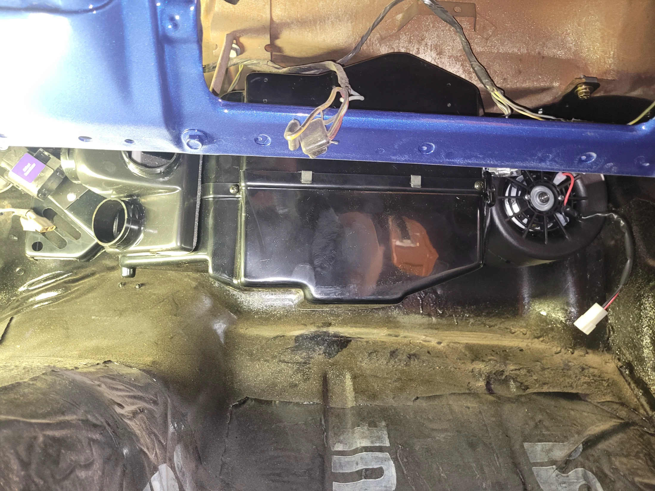

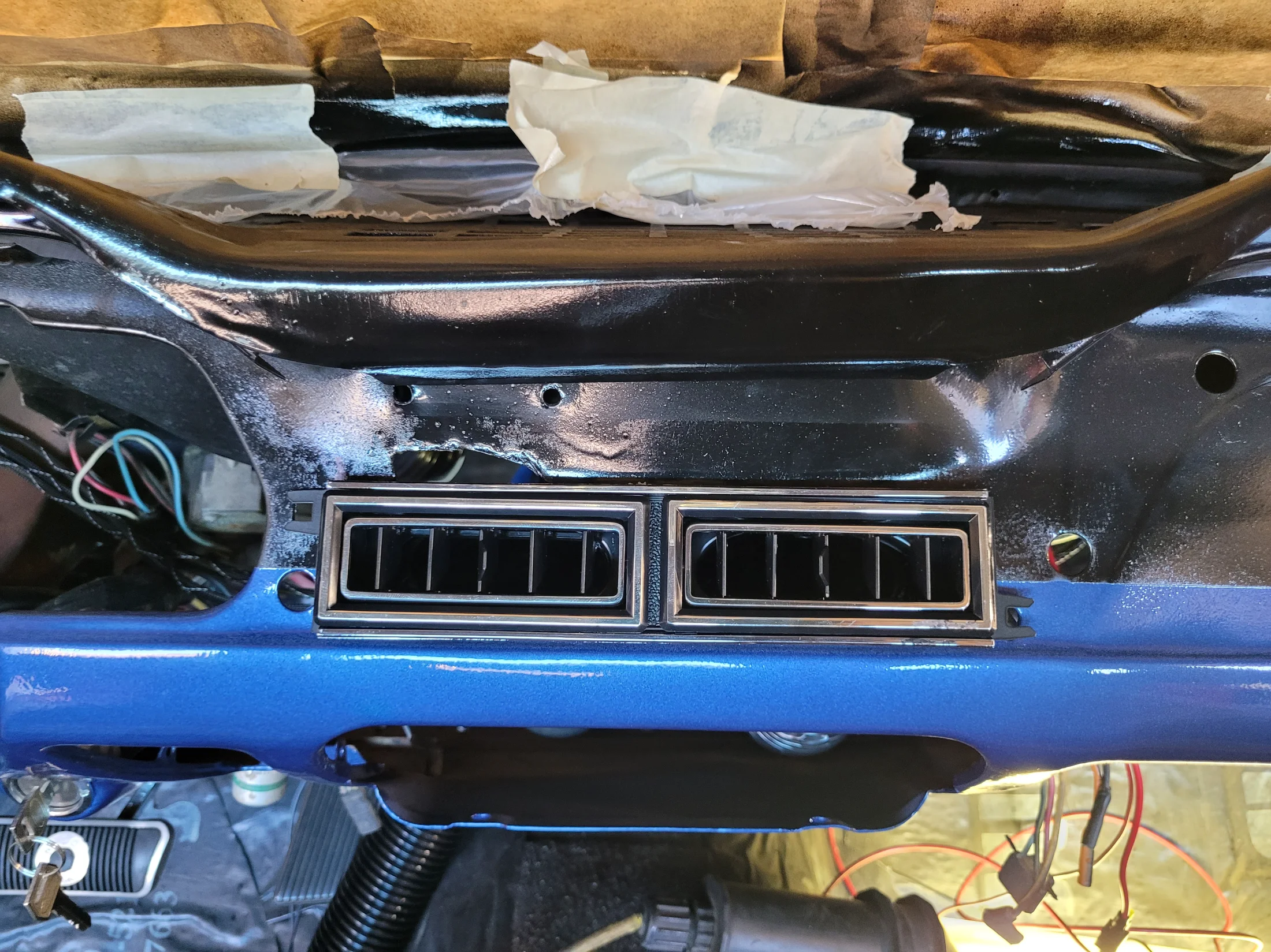

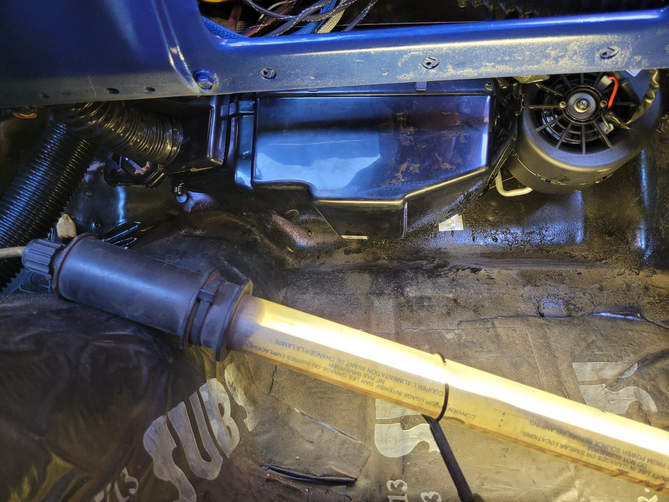

Got the hvac unit loosely mounted under the dash. The lines will come out the center of the firewall hole when the unit is lifted into the correct place. For now, it let's me figure out all the hoses. I will get them crimped tomorrow.
Got the lines all trimmed down ready for crimping. Bummer is the one line and fitting is interfering with the transmission dip stick. The ac cannot move so, I'll have to figure out a solution for that.
The white zip ties are only for mock up. Once the export brace is installed, it will hide the lines and give me a support point.
Huge thanks to my friend Jay for helping out today. The hvac is mostly complete except mounting a few vents and the wiring. All hoses under hood are crimped and installed as well. We tested all the servos and blower motor as well. Progress is good today.

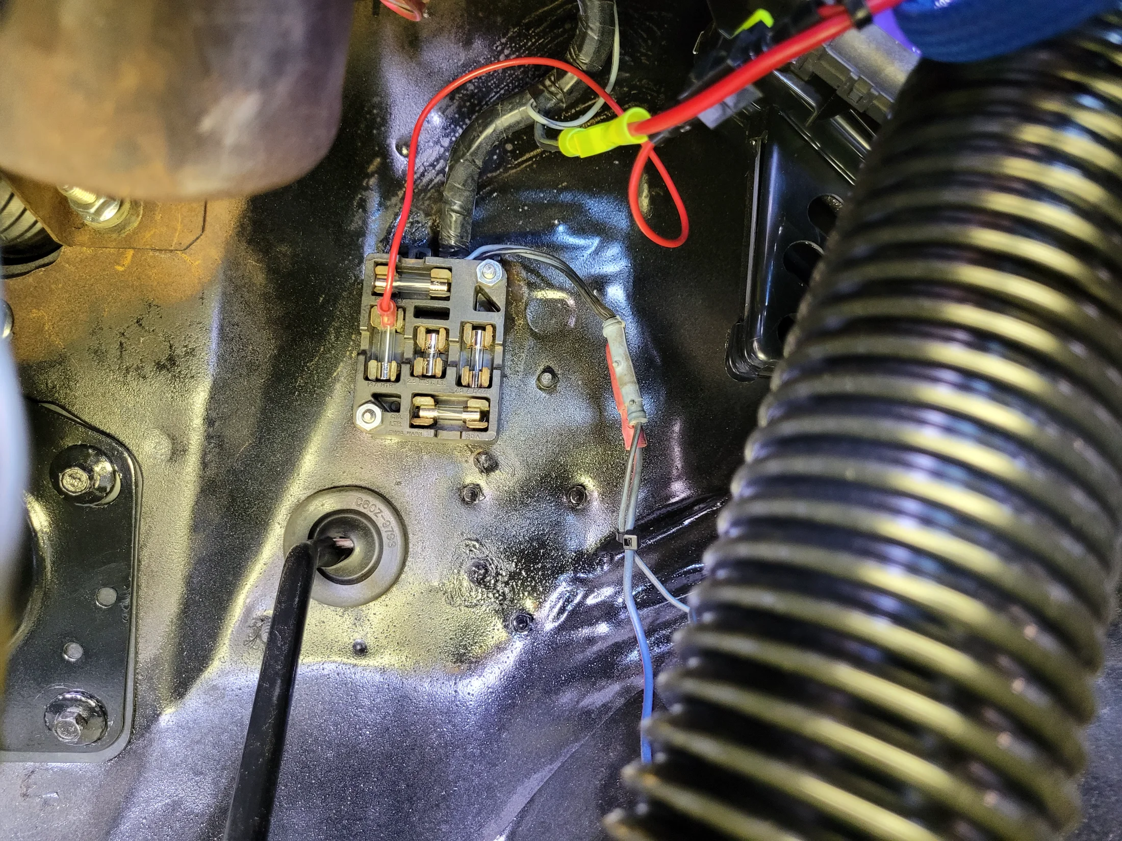

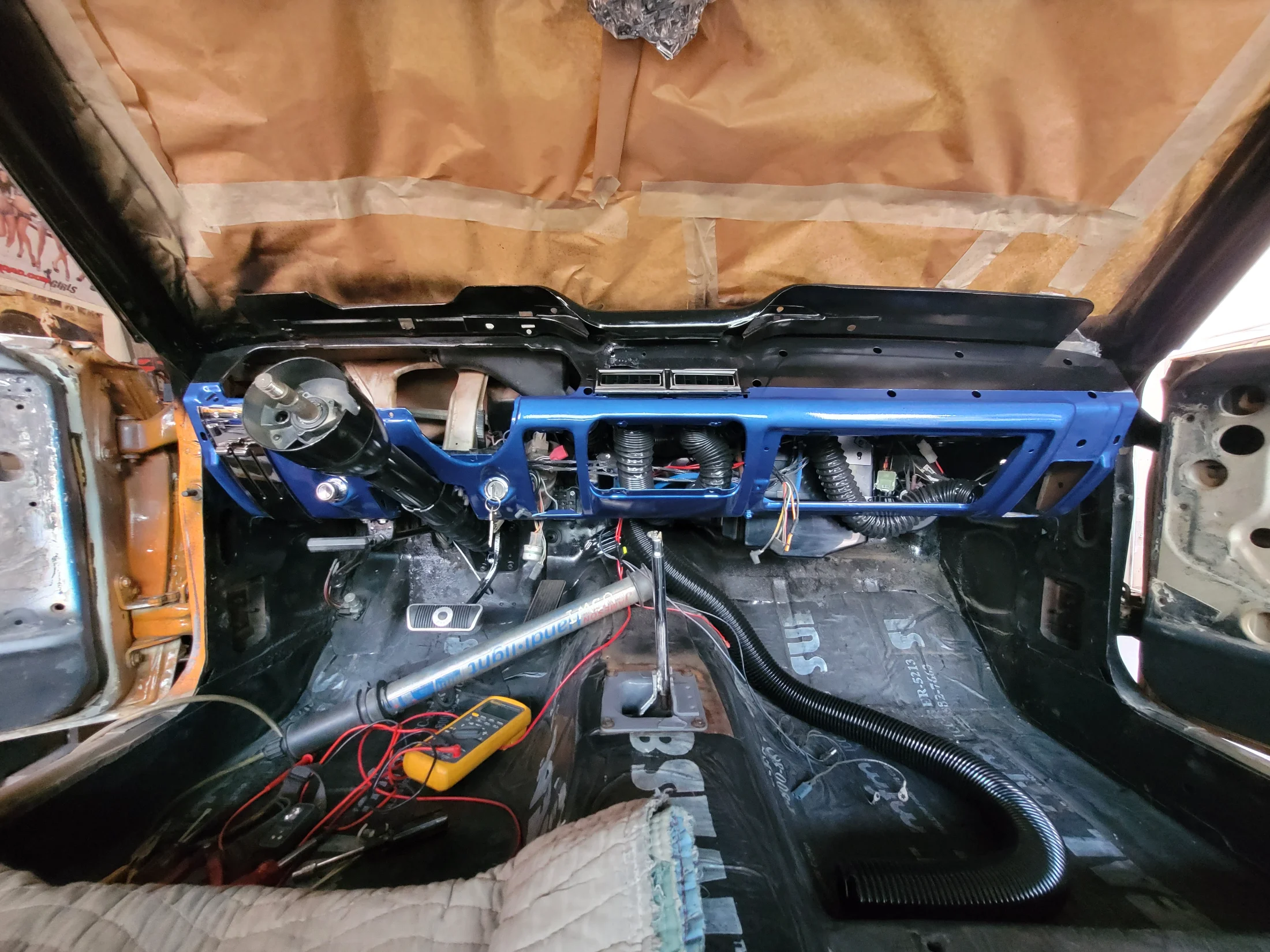

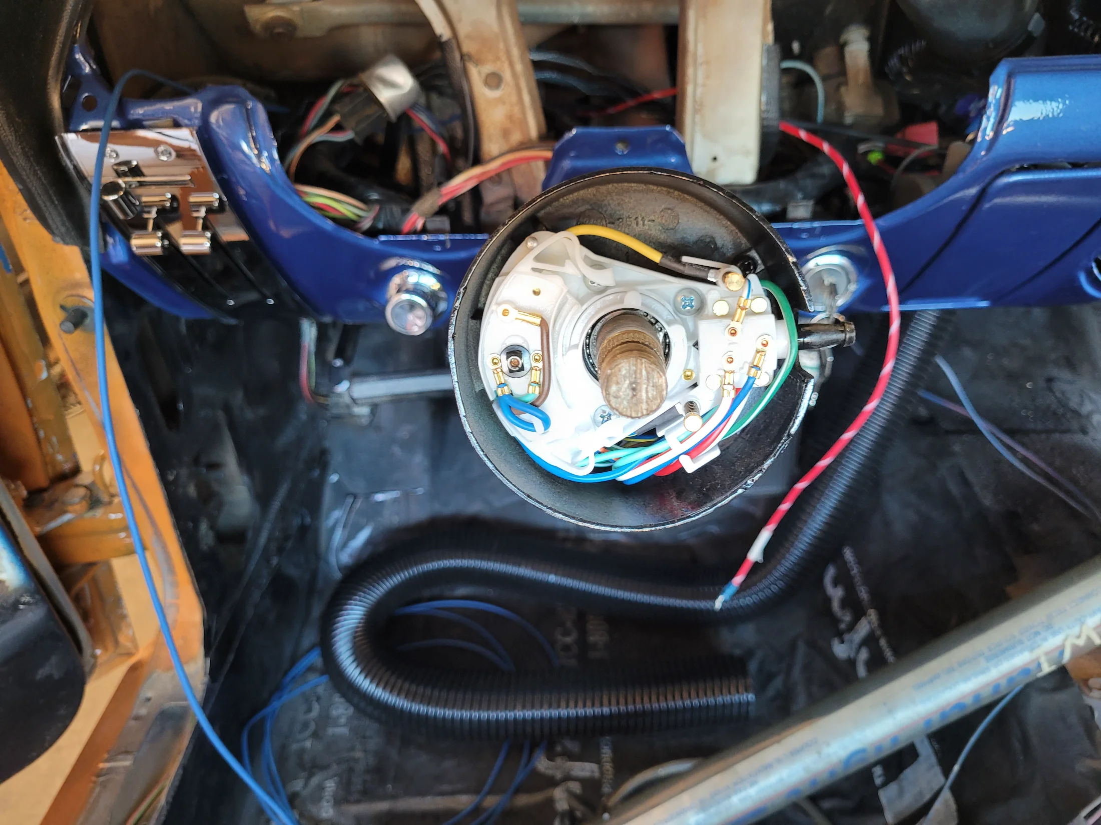

Got the new hvac system all wired up and connected to the stock Mustang wiring harness. It was in good shape surprisingly. Just needed some clean up. I also cleaned up the fuse block and installed all new fuses.
I connected the battery for the first time today. No smoke or issues so far. I tested the blower motor and all the venting options. Worked great.

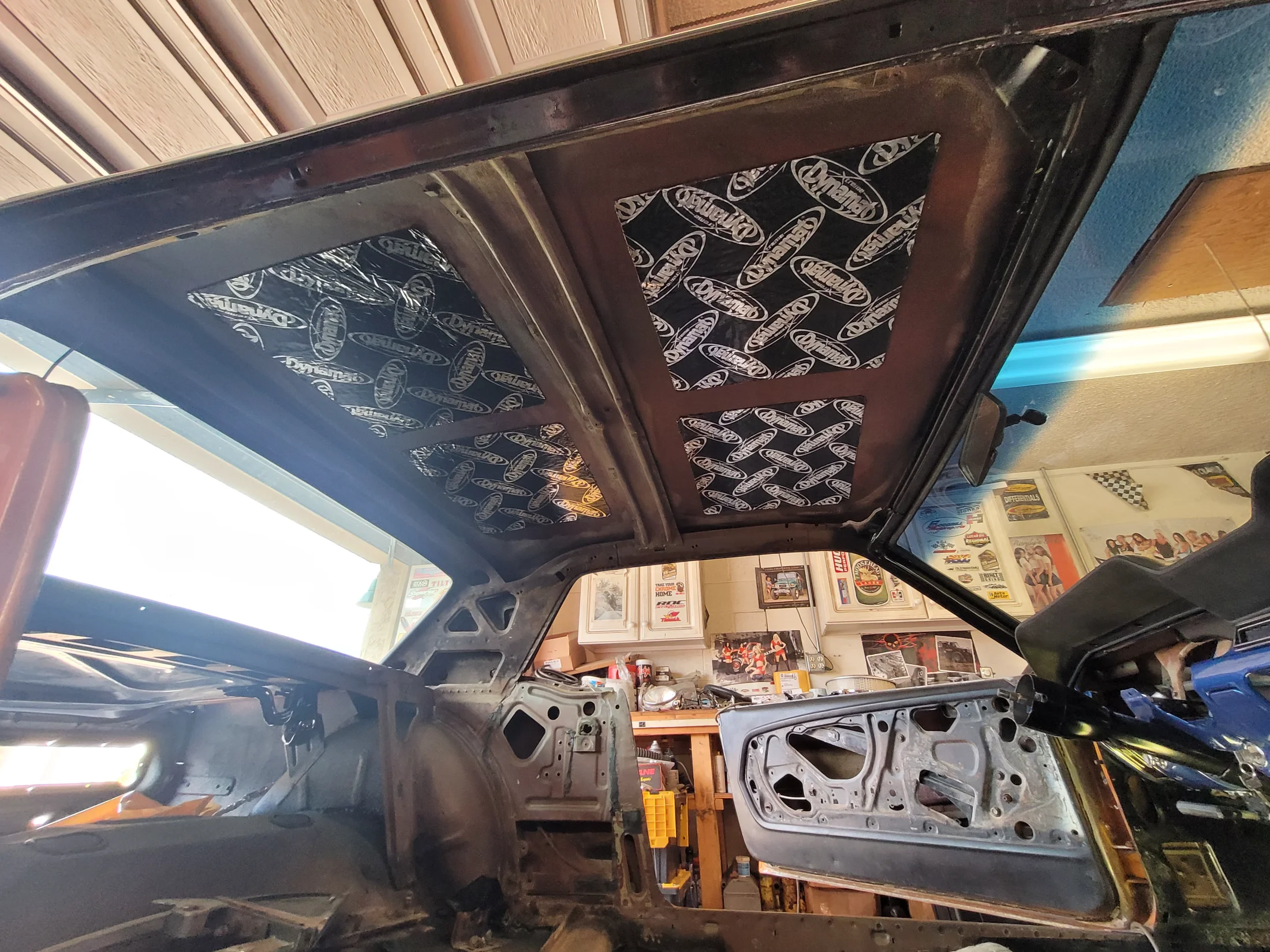

Then.....since I had a Dynamat roof kit that came with the car. I installed that cause it was easy and provided instant gratification.

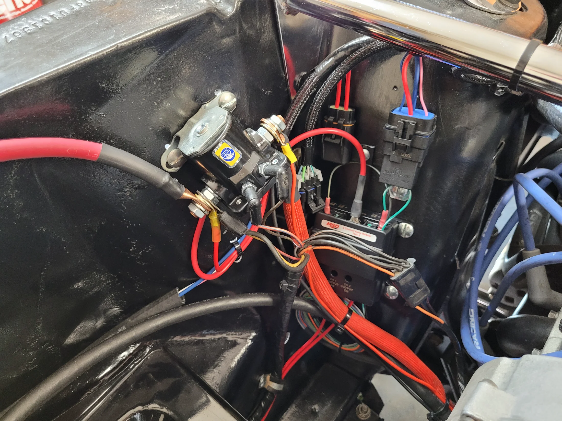

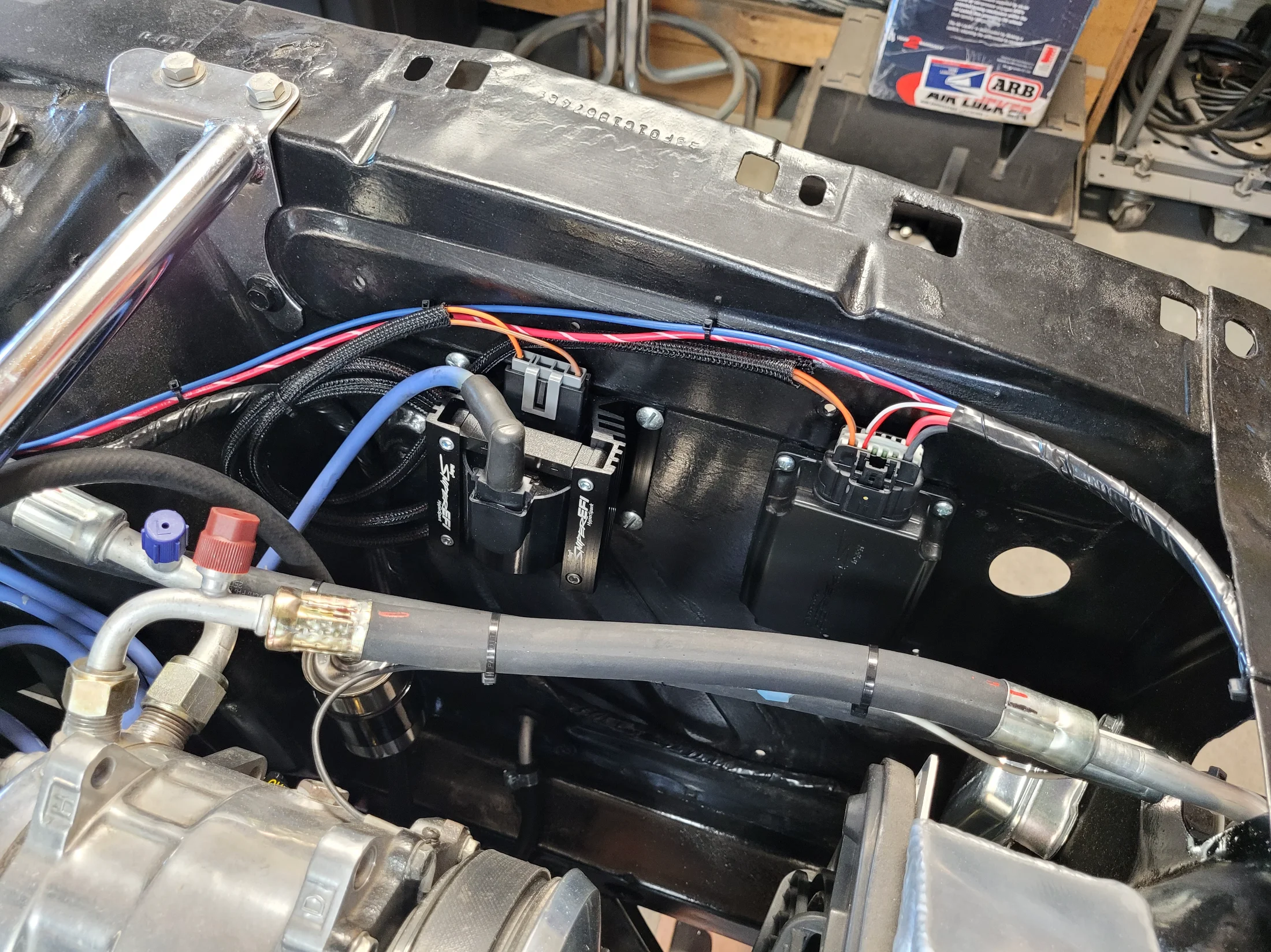

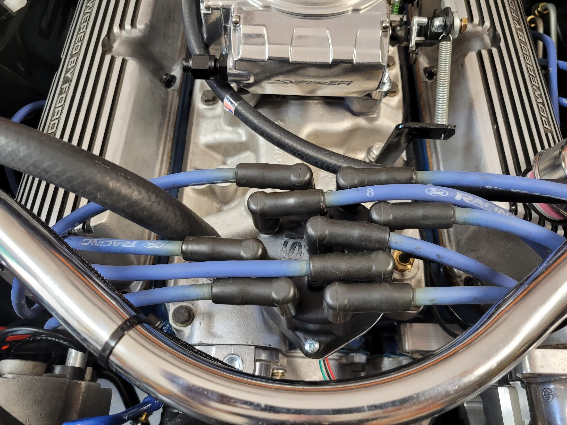

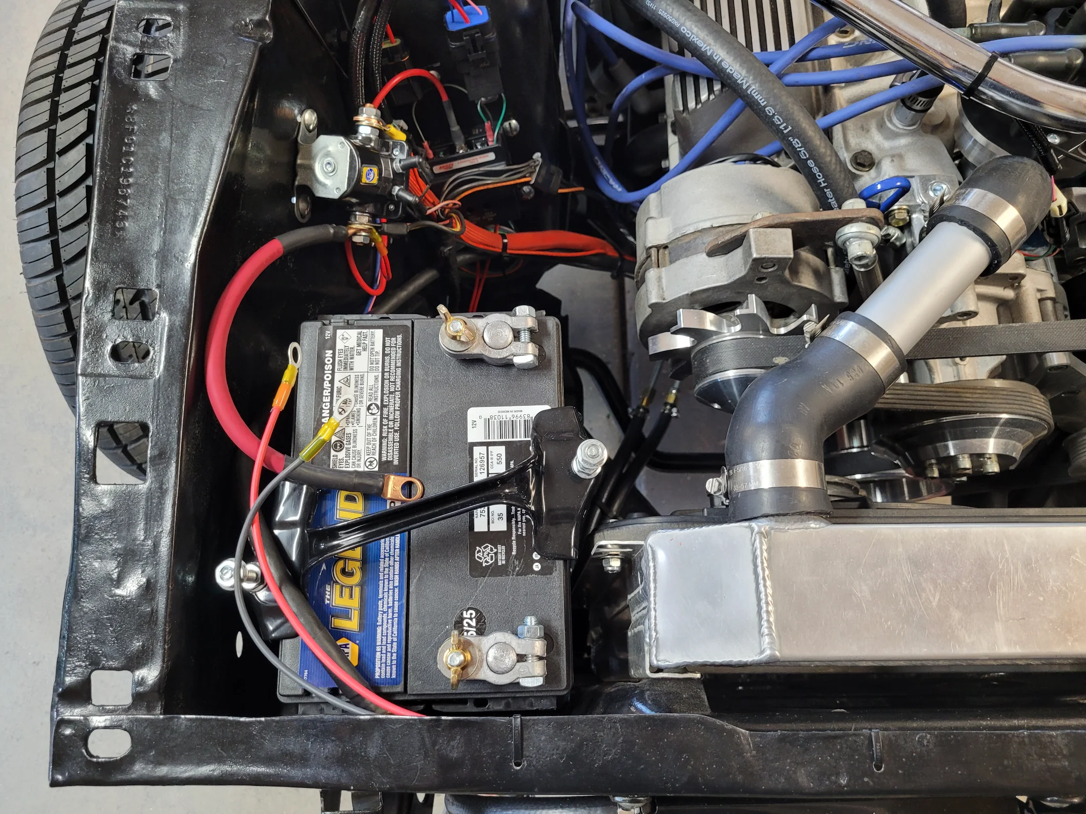

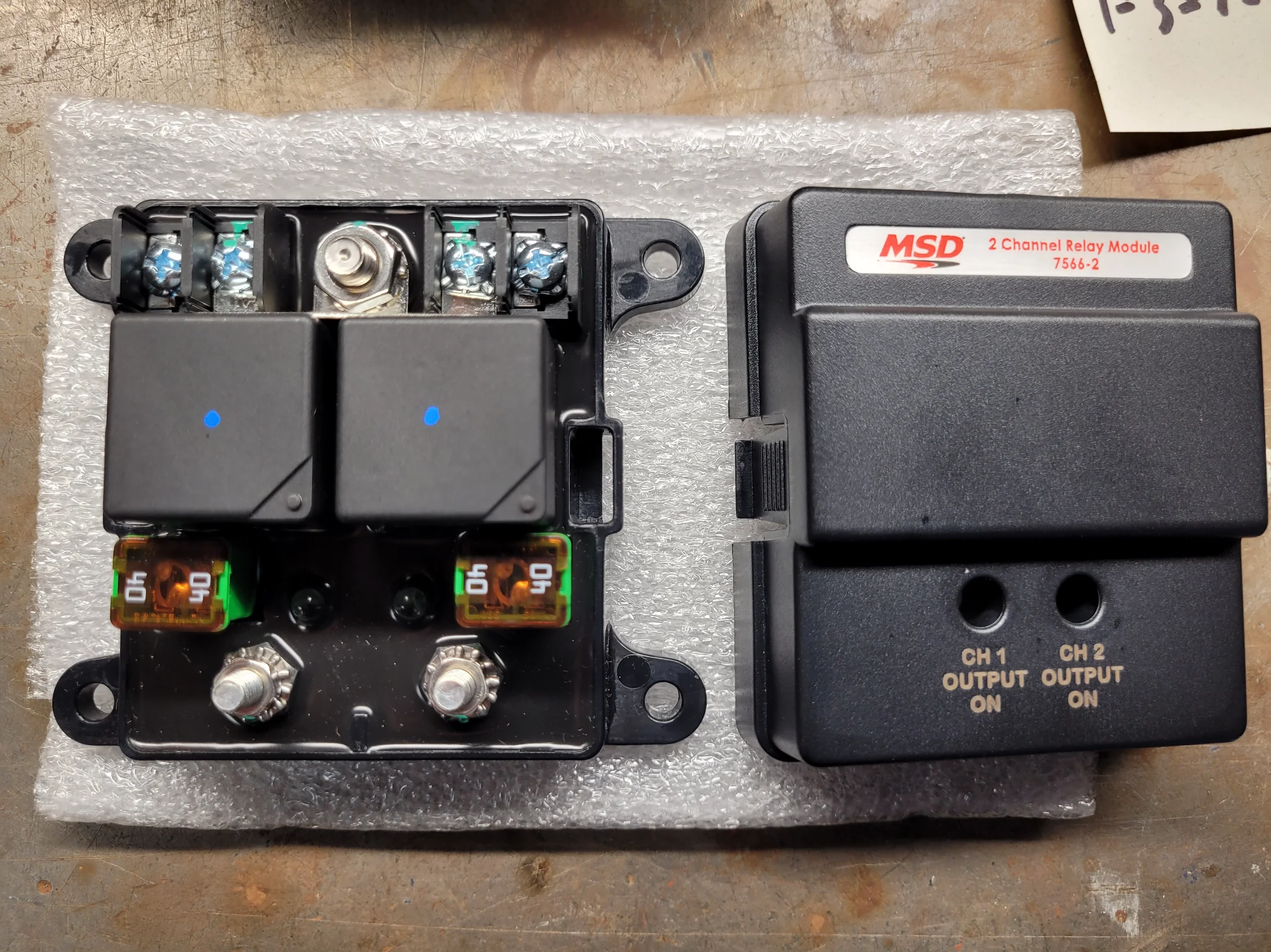

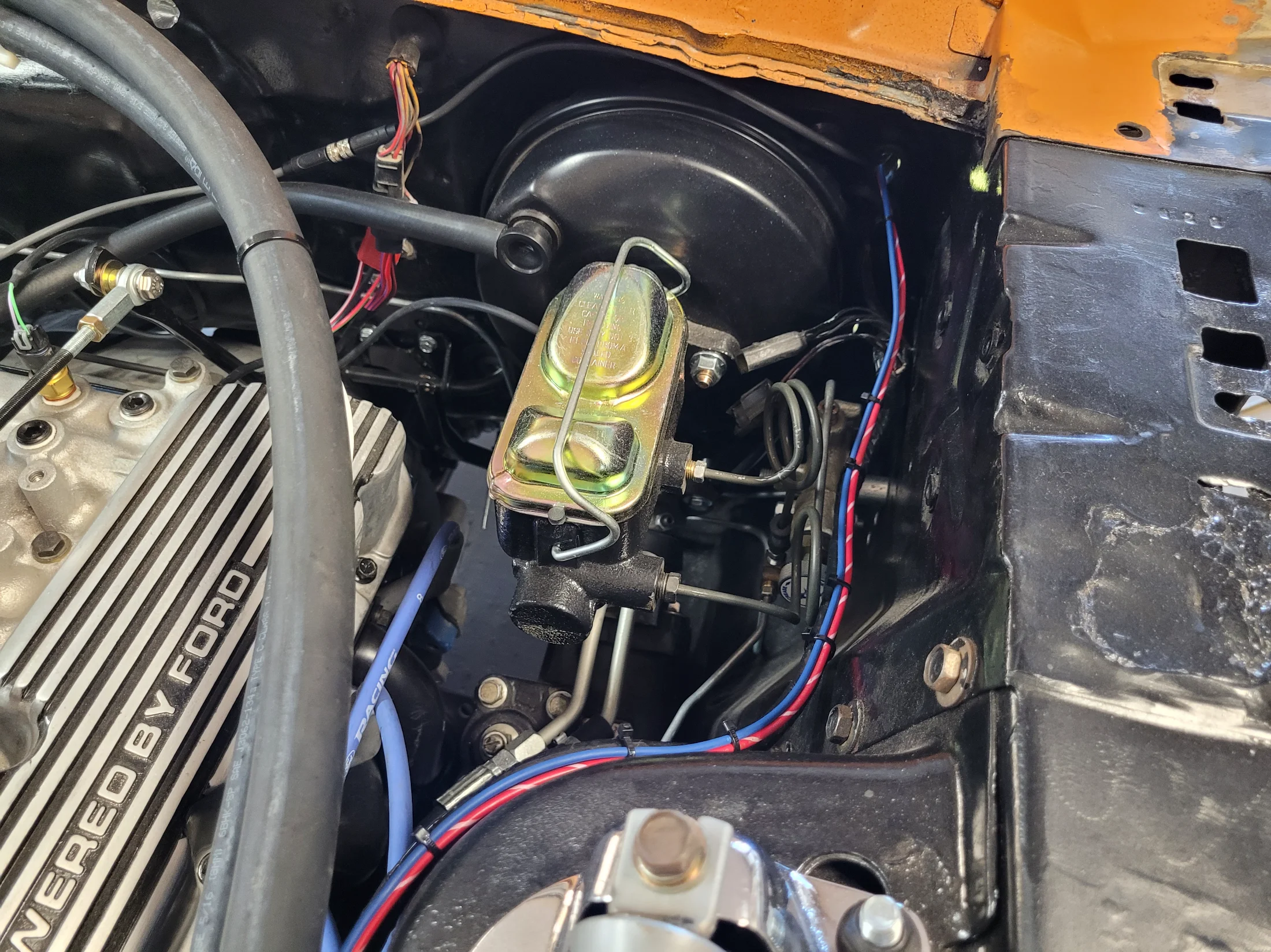

Worked on the Sniper efi wiring and ignition stuff today. Used this cool MSD 2 channel relay unit to power the dual electric fans on the radiator. It's looks kind of busy cause this engine bay seemed to fill up fast.
Spark plug wires laid in nicely.

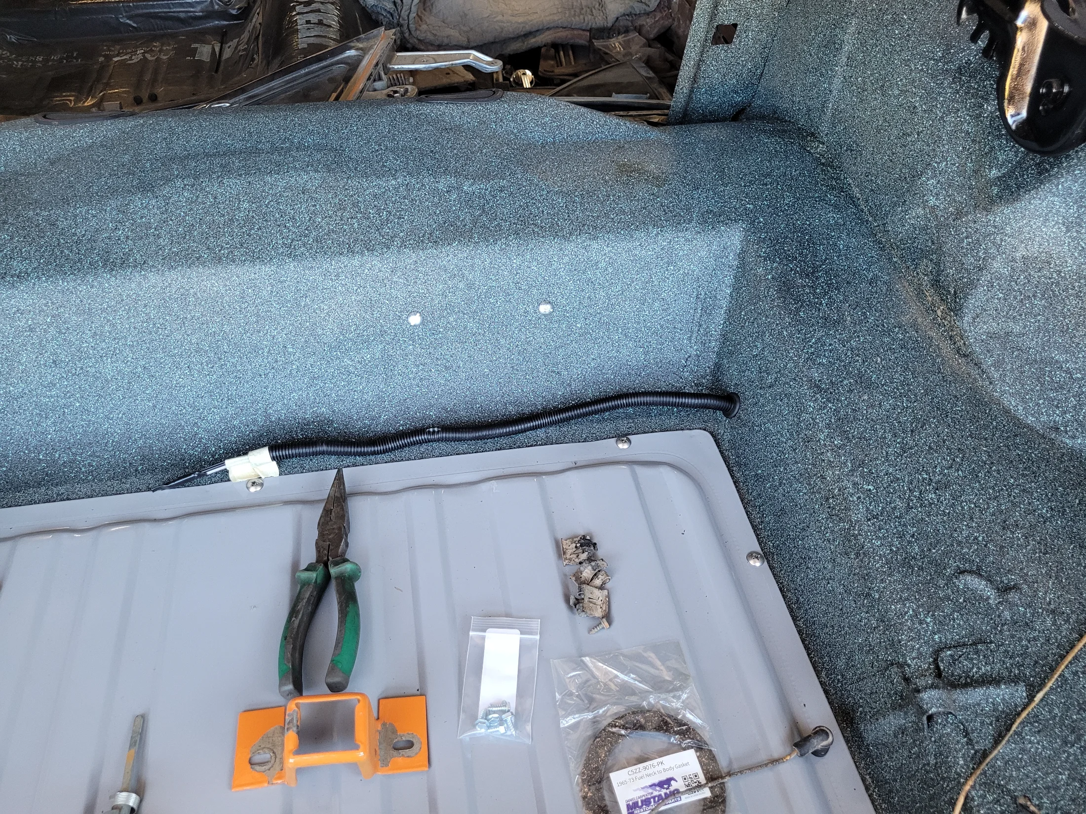

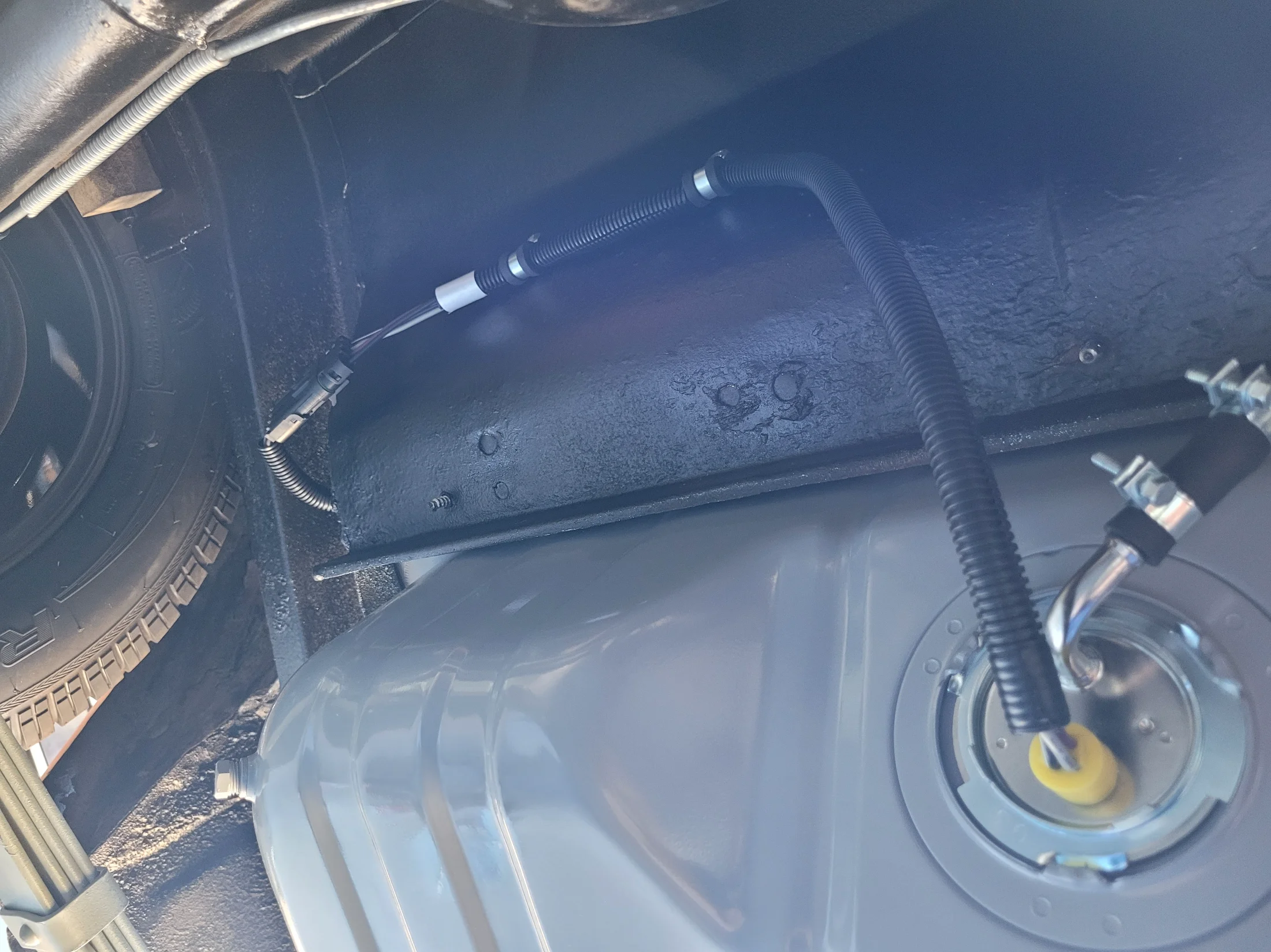

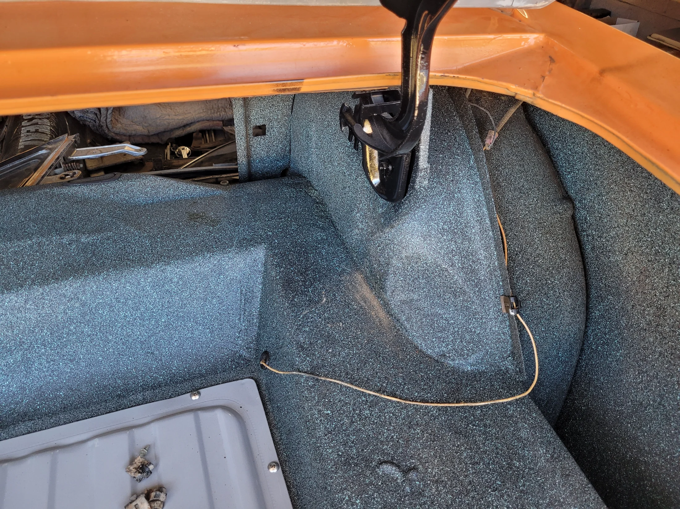

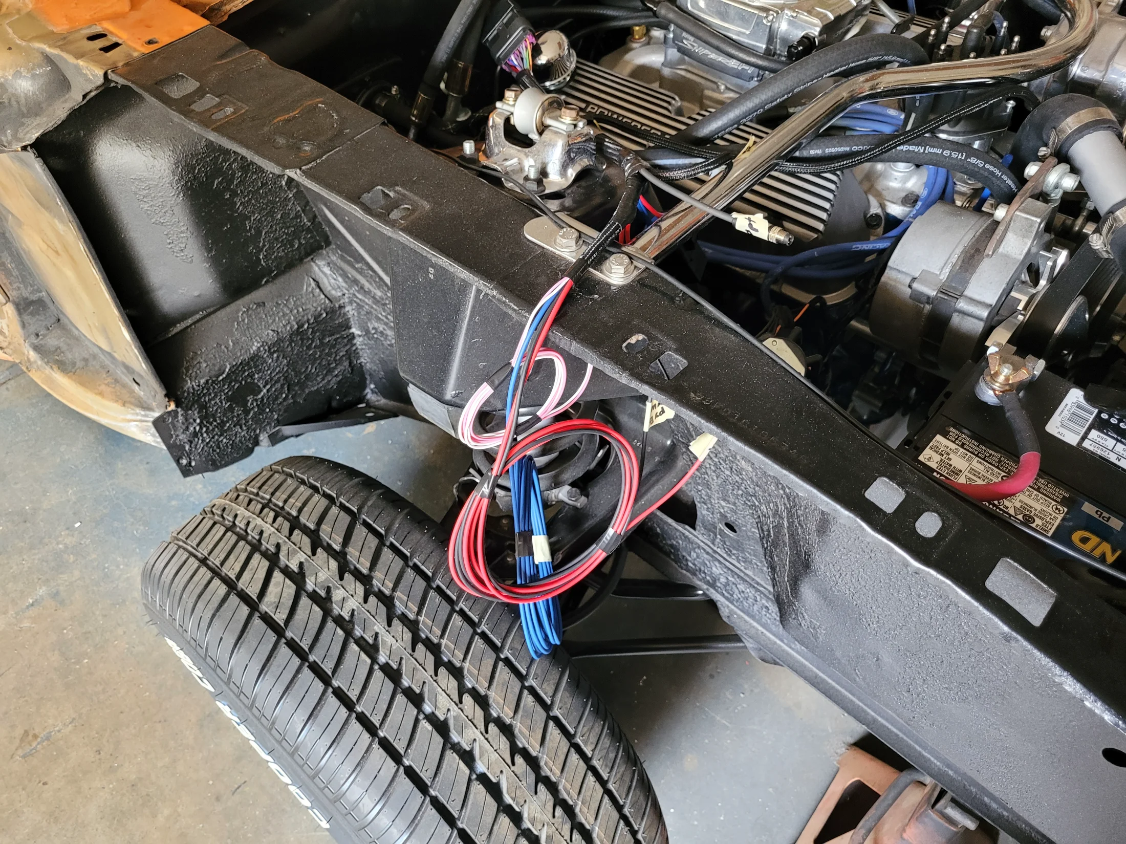

I was gonna be lazy but decided to get a few more things done. I finished wiring under the car. Used the Holley pump harness and routed that into the trunk. Still need to connect a few wires.

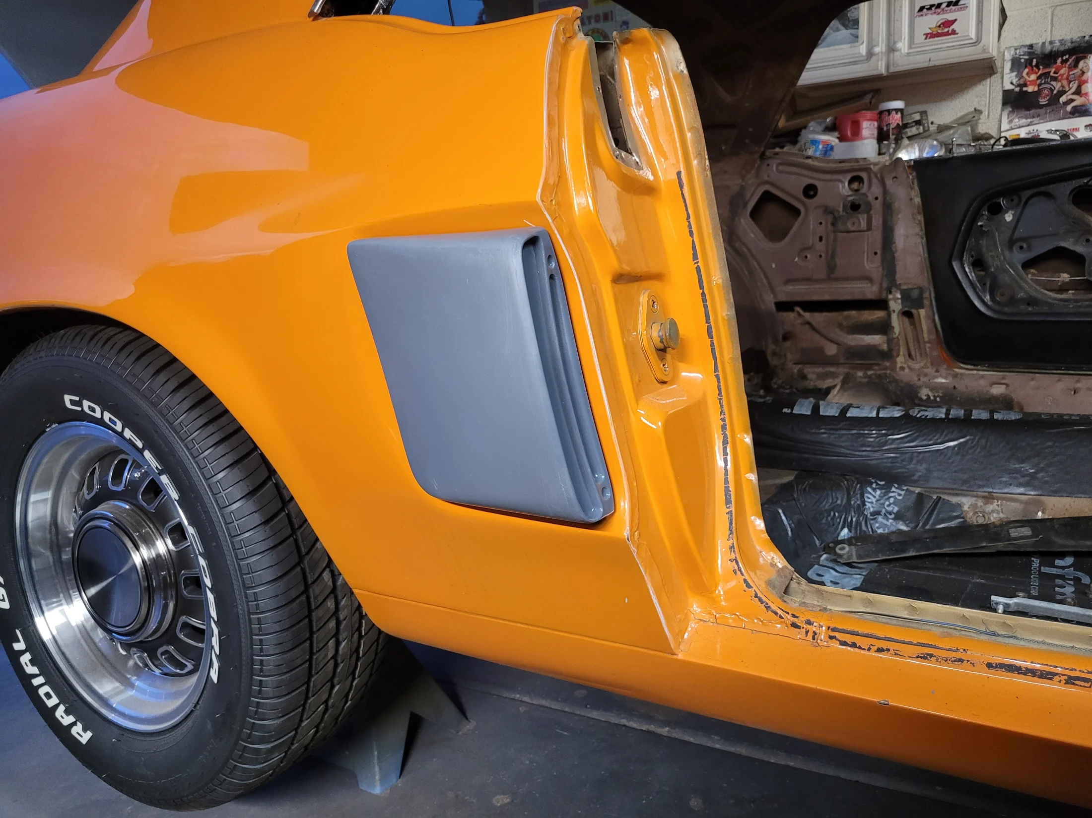

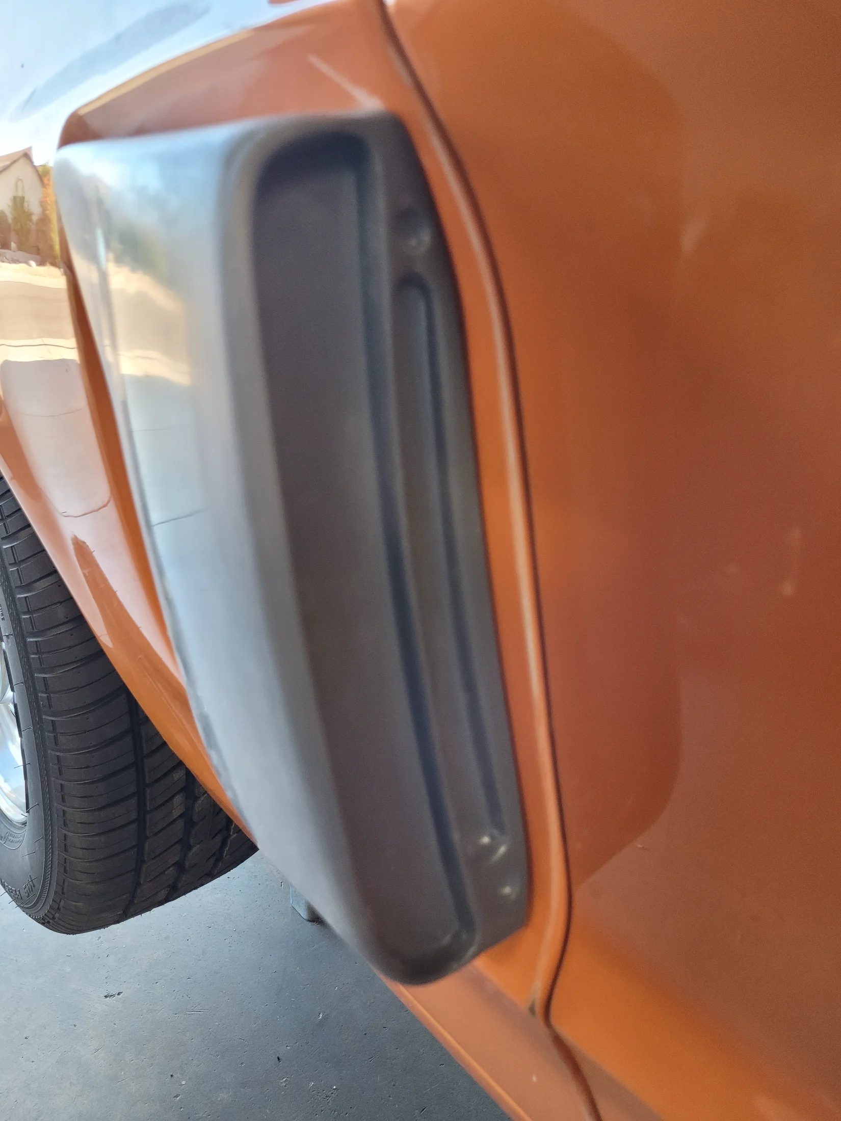

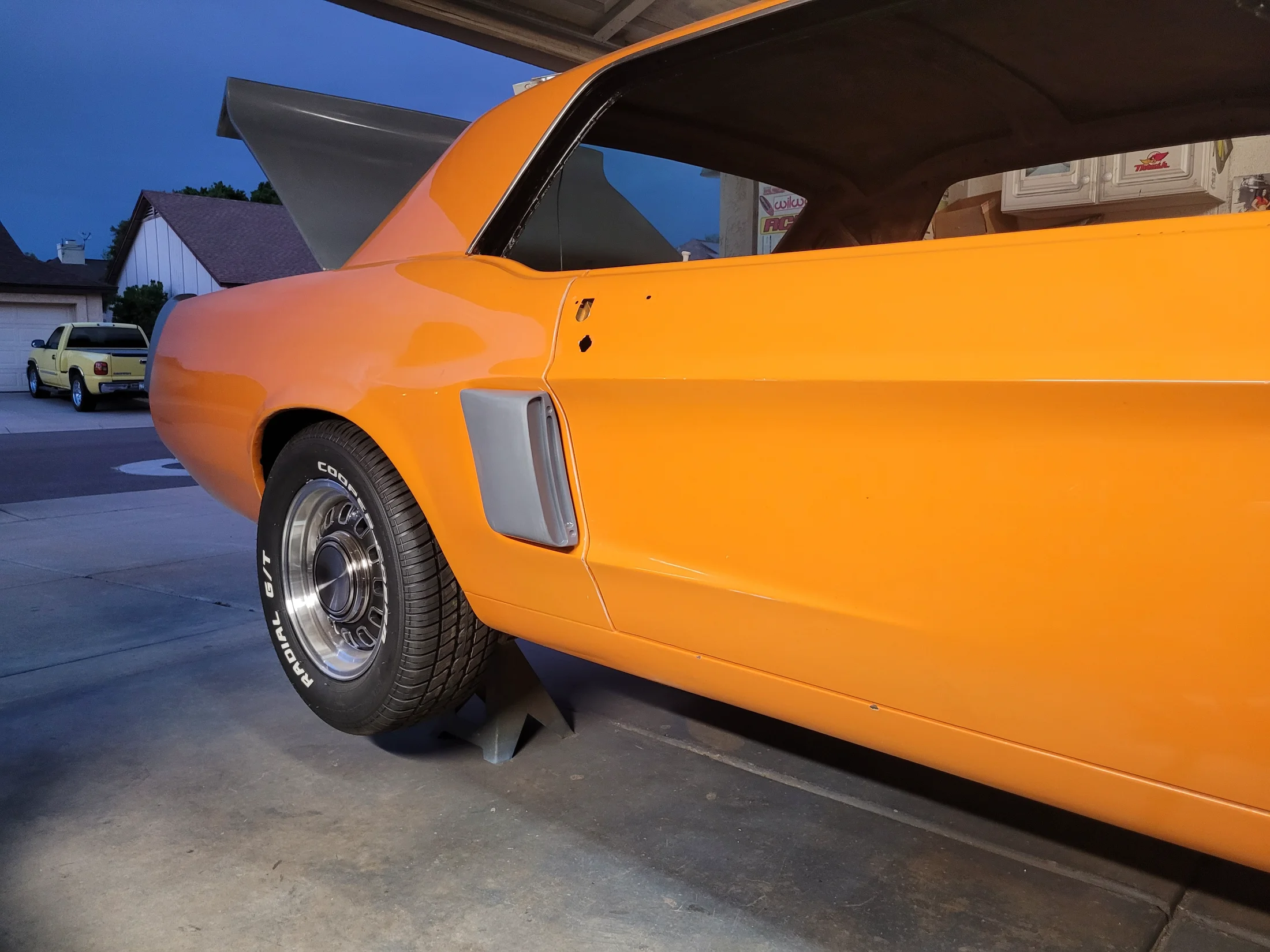

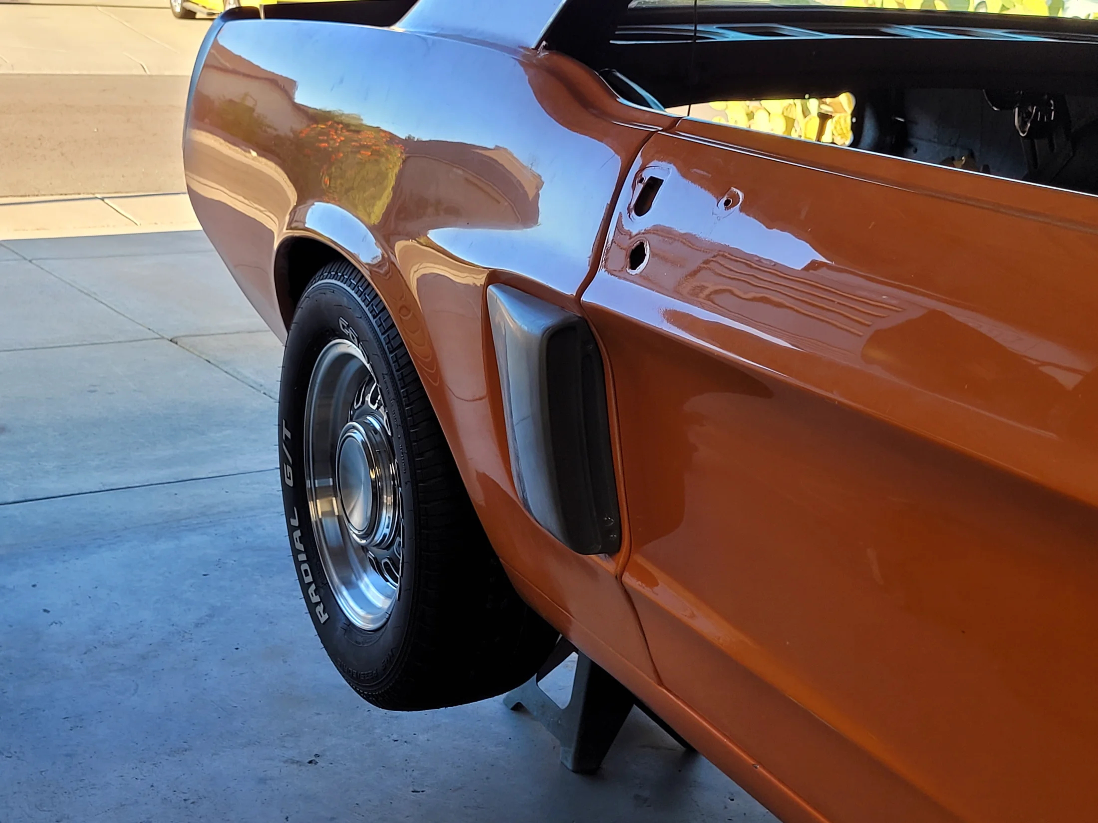

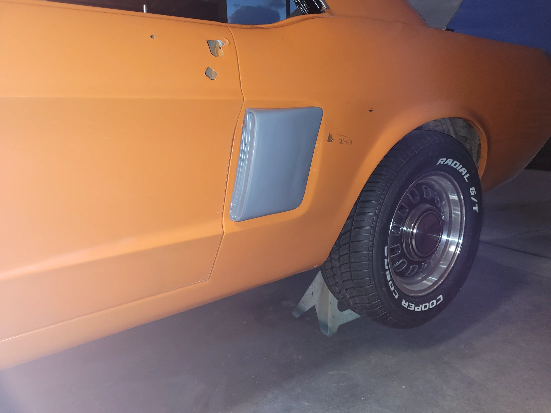

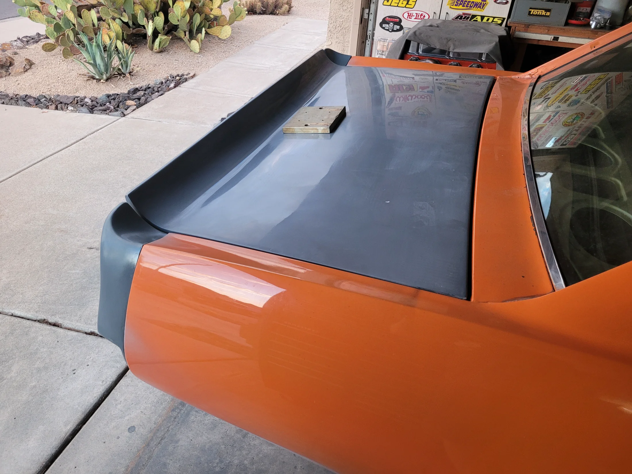

Then I fiddled with making the side scoops fit better. Alittle fiberglass dust and I got the passenger side fitting good.
